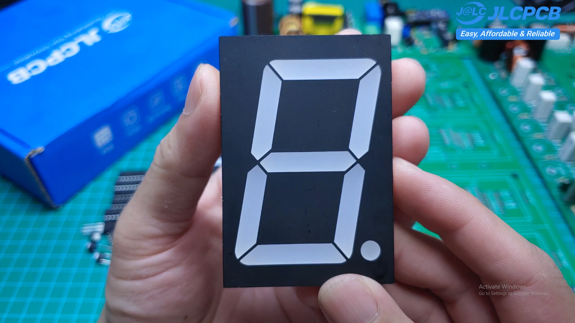

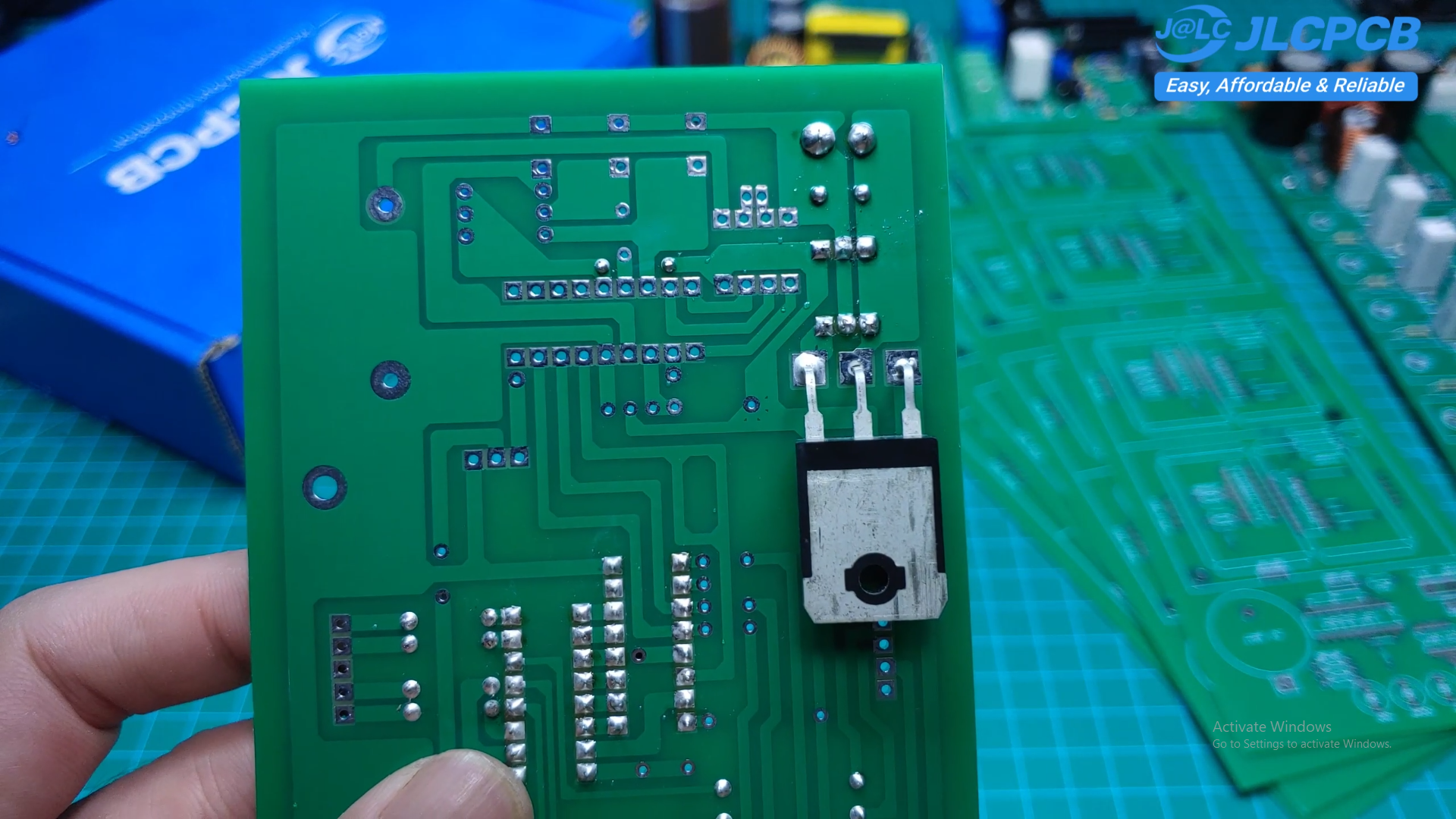

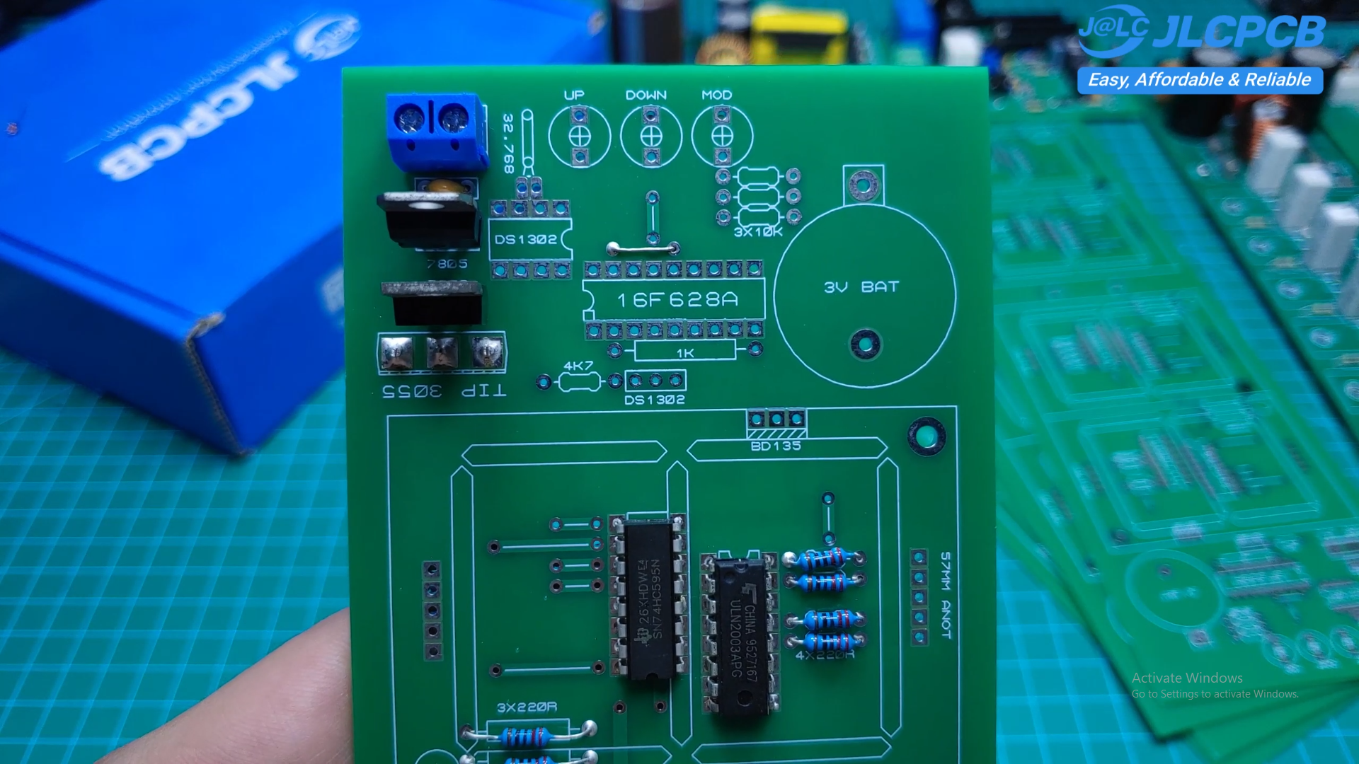

This project is a 3-Inch 4-Digit LED Digital Clock designed around the PIC16F628A microcontroller. The goal was to build a simple, reliable, and low-cost clock using commonly available components while maintaining excellent visibility with large 3-inch seven-segment LED displays. With PCB from JLCPCB

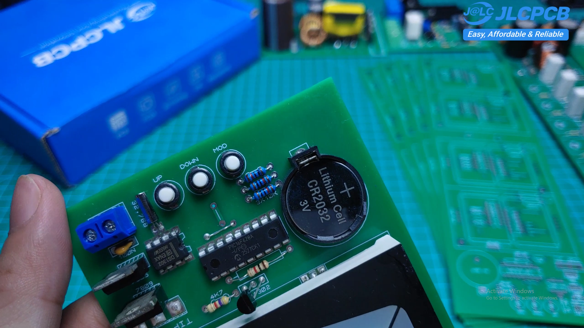

Besides displaying the current time, the clock also measures ambient temperature using the DS18B20 digital temperature sensor. Timekeeping is handled by the DS1302 Real-Time Clock (RTC), with a CR2032 backup battery ensuring that the time is preserved during power outages.

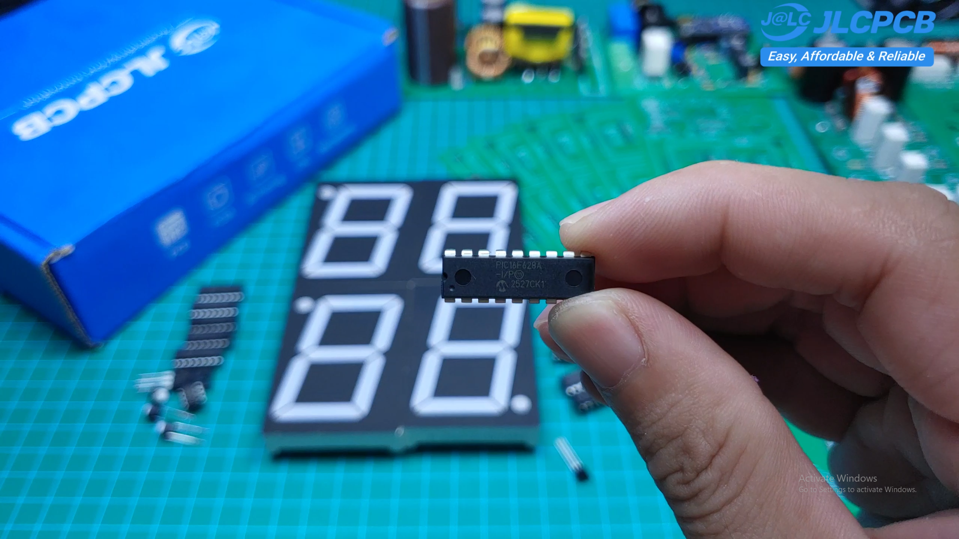

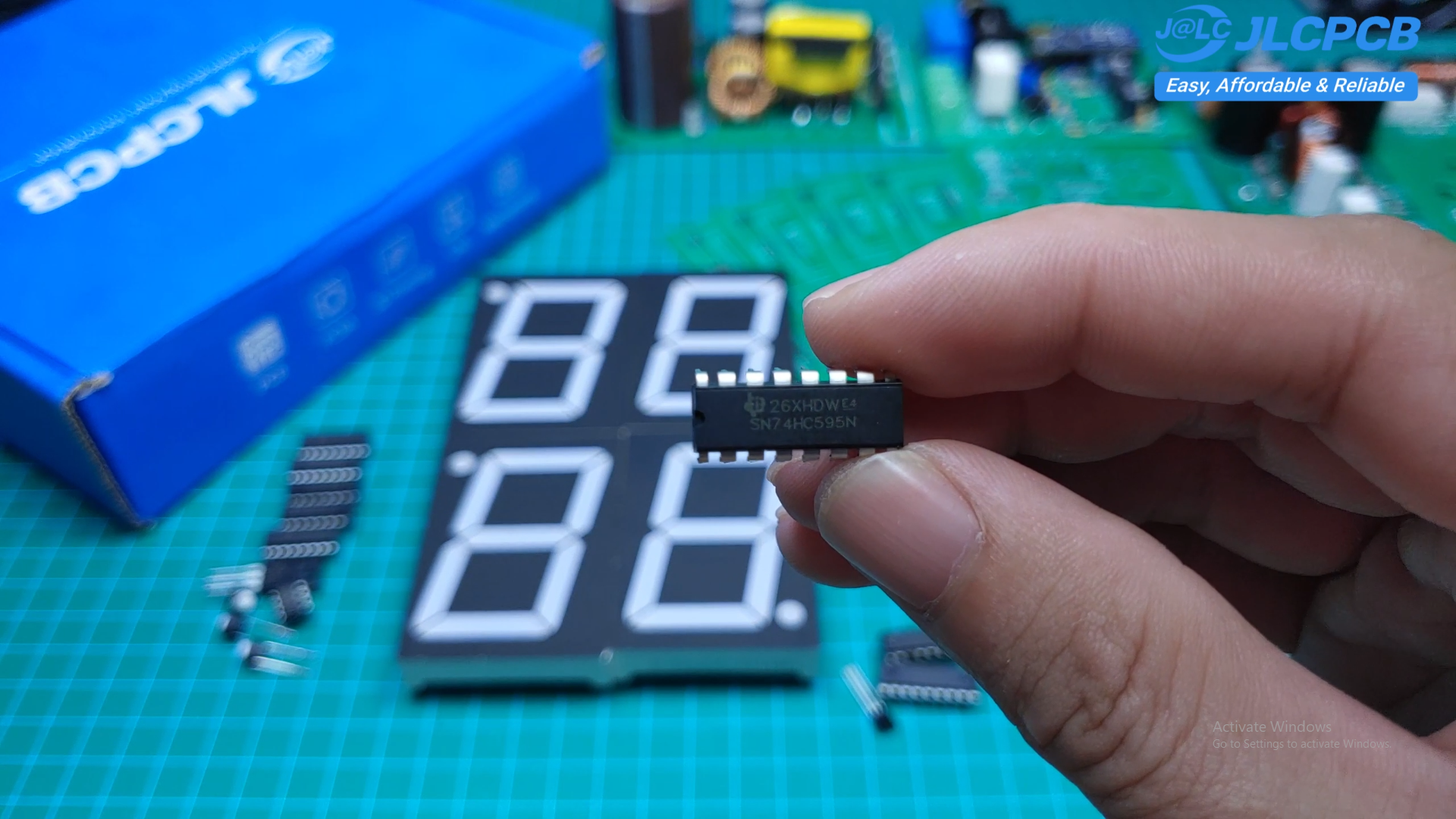

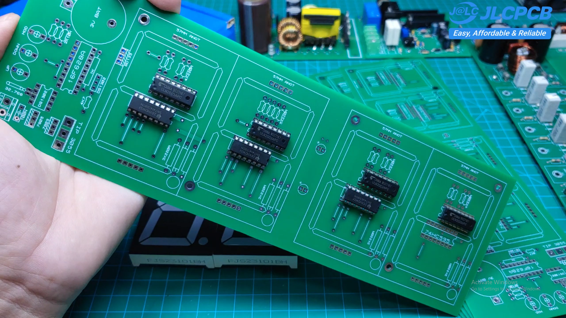

One interesting aspect of this design is that the large LED displays are driven using only 74HC595 shift registers and ULN2003A Darlington driver arrays, without requiring dedicated LED driver ICs. This keeps the hardware simple, inexpensive, and easy to reproduce.

    Hardware
    The project consists of the following major components:
    • PIC16F628A Microcontroller
    • Four 3-inch Common-Anode 7-Segment LED Displays
    • 4 × 74HC595 Shift Registers
    • 4 × ULN2003A Driver ICs
    • DS1302 Real-Time Clock
    • DS18B20 Digital Temperature Sensor
    • CR2032 Backup Battery
    • Push Buttons for Time Adjustment
    • 5V Logic Supply
    • 9V LED Supply
    The circuit uses two separate voltage rails:
    • 5V for the microcontroller and logic circuitry
    • 9V for the LED display
    This allows the large LEDs to achieve good brightness while keeping the logic section stable.
