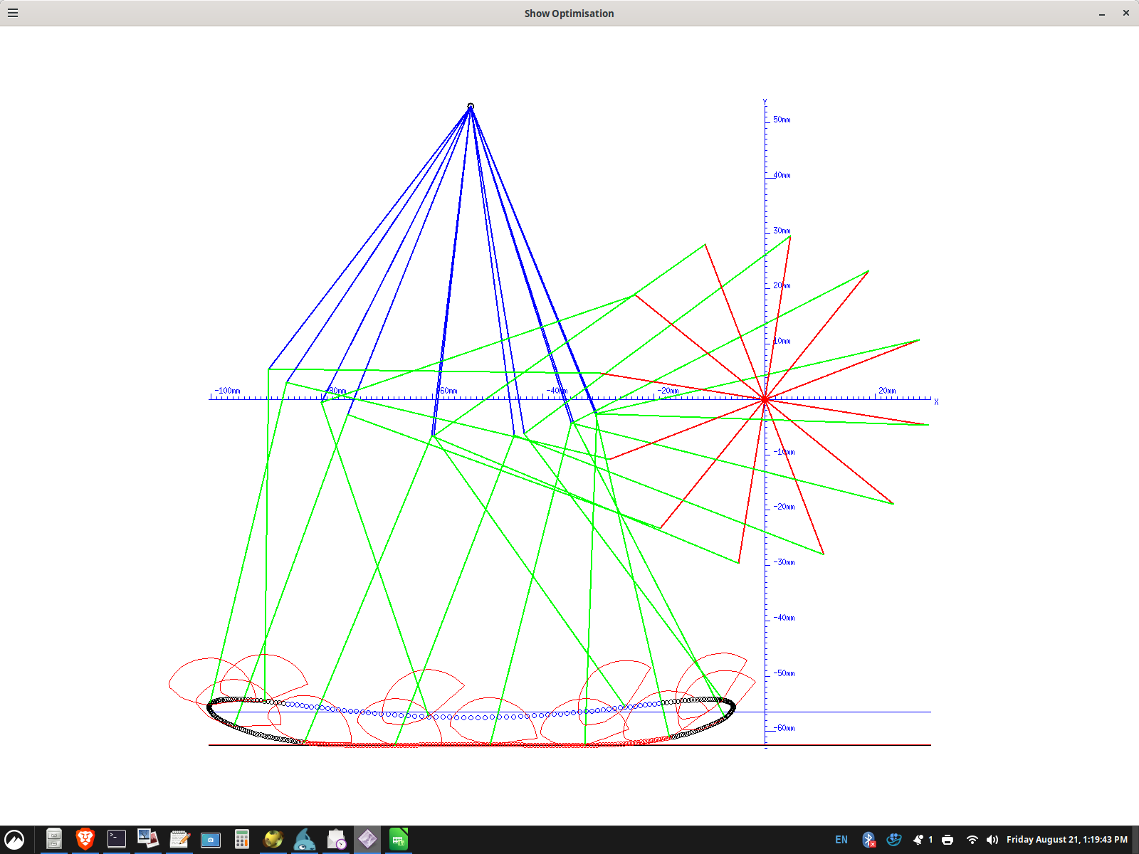

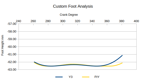

    After several days of reworking the optimisation code, some preliminary results.
    First was to use the current optimal model and the impact of the optimal foot:
    The main improvement was the extension of the useful window to the rear (to the right) of the down stroke. To take advantage of this I need to recalculate the 120 degree window, and then optimise.
    Here is the result of optimisation if the window is not moved and the other constaints are  removed:
    Not ideal, as the non-custom foot curve (Y3) is worse but compensated by the custom foot.
     Still the oscillation of the down stroke has been reduce.

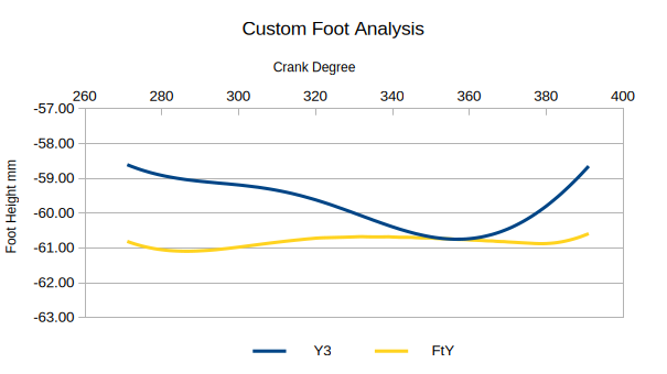

    Finished the the Optimisation code.

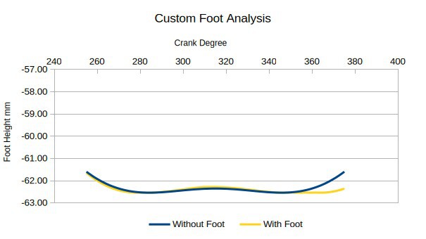

    Best option seems to be taking the current optimisation and sliding the foot down window:
    The foot peak to peak "wobble" has been reduced from 0.94 mm to 0.48 mm:

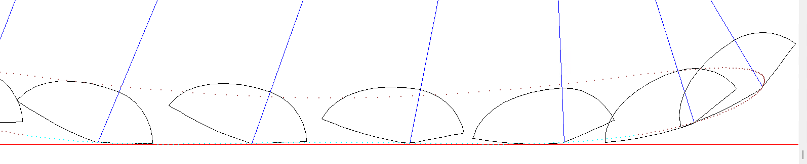

    Foot Optimisation
    Struggled to work out how to do this. Not that I did not know the general shape.
    The problem is the solution is specific to the walker design:
    Finally worked out a method:
    But now I have to reoptimise the foot with the walker at the same time.
    After this reoptimisation, I will get the parts lasercut.

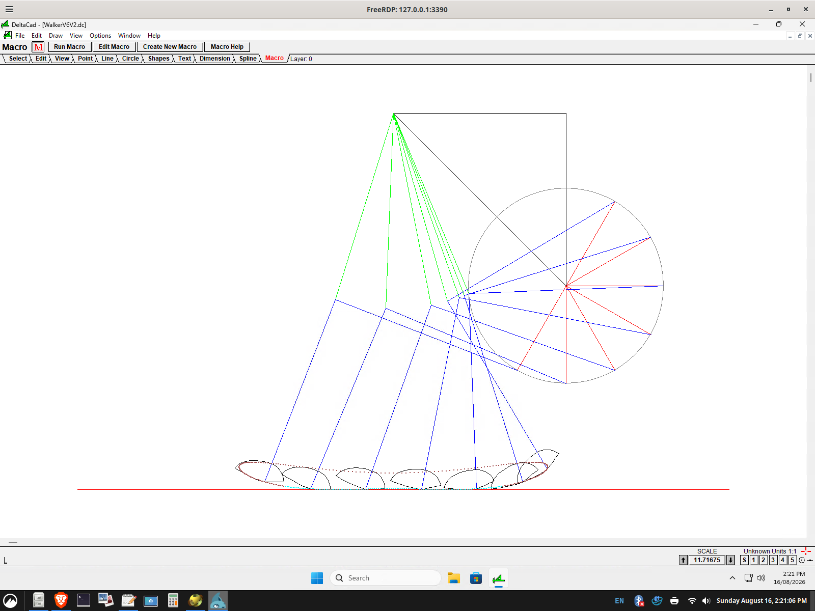

    Boolean Shape Options for DeltaCAD
    Delta CAD is now deceased. A shame!
    It has a persistent menu system that reduces the cost  key strokes and mouse clicks.
    Unfortunately the menu system was half finished. Still, it is very nice to use.
    While the GUI works with Linux just fine, the macro language does not.
    Now I run DeltaCAD in a VM. With two menu bars visible at all times, it is just one click to switch between Windows and Linux.
    After using OpenSCAD, I really like the boolean operations: union(), difference(), intersection().
    So I used Alan Murta's Generic Polygon Clipper (GPC, 2004) code and wrapped a DeltaCAD macro around it.
    It's magic, select a couple of shapes, run the macro, select your option, and a few seconds later, the selected shapes are replaced by the boolean operation shape.
    It saves so much time spent moving shape points over other shapes.

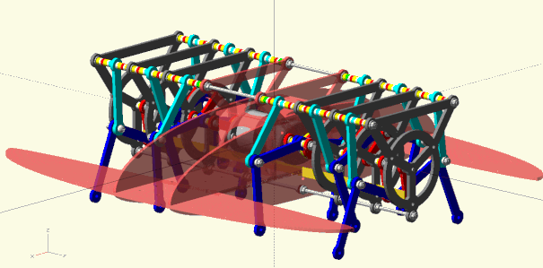

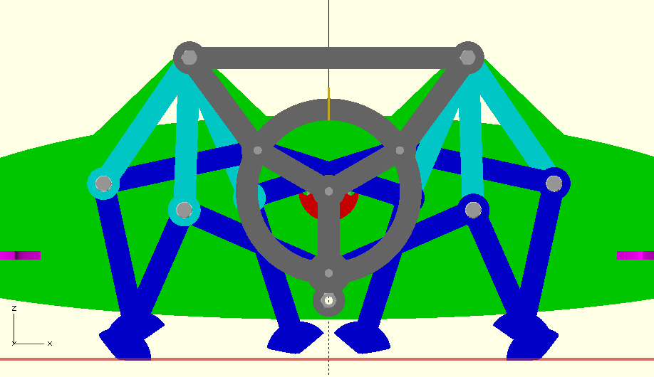

  • Building an OpenSCAD 3D Model and Animation
    agp.cooper07/22/2026 at 08:48 0 comments
    Learning OpenSCAD (work in progess)
    Using the WikiBooks OpenSCAD User Manual Strandbeest (https://en_wikibooks.org/wiki/OpenSCAD_User_Manual/Example/Strandbeest), as a base, I reworked the code (it has lots of bugs) for a 4 Bar and add
    3D offsets.
    It is still a work in progress:
    Here is a 3D GIF of a three leg walker (one side):
    Removed the cogs and replaced with a side crank. Only one of the axles need to be driven:
    Next is to add spacers or washer between moving parts:
    Notes:
    • The two colours Red and Yellow are inference fits to the rods. The other as sliding fits.
    • The spaces are 25% of the plate thickness but this is not that important.
    • The design has been changed to a "side-rod" drive. The two driven shafts are now centrally located.
    • Now I need to design the motor mounts and the internal cargo space.
    Update:
    • Refactored the code to make creation more systematic and easier to debug.
    • Replaced most of the individual spacers and shim code with a function and a list.
    • Added cross-rod reinforcements and motor mounts (had to make the body a little longer).
    • To coupling the motors to the drive rod, I will use a flexible tube.
    Refactored the code and removed hacked code. Now able to rebuild with parameters except for the stepper motor. Cool to be able to shop online for some Teflon washers and adjust the walker for the washer thickness that was available.
    To do:
    • Controller board mounts.
    • Battery mounts.
    • Sensor mounts.
    • And more.

    Finding an initial feasible solution
    Fortunately we can start with DIY Walkers solution (but at half scale):
    • Axle: (0.0 mm,0.0 mm)
    • Hip:  (-48.0 mm,33.0 mm)
    • Crank L1: 30.0 mm
    • Thigh L2: 60.0 mm
    • Idle    L3: 40.0 mm
    • Shin   L4: 70.0 mm
    • Knee Angle: 90.0 degrees
    Here the foot trace down range is 120 degrees between the green markers and 180 degrees inclusing the green markers:
    Note how the foot trace slow down near each left/right extremes, and is very fast when the foot up.
    Extending the Flat Bottom Range
    The first major objective identified was the need to have a flat bottom (as much as practical):
    While this objective has been meet for 120 degree range (suitable for a three leg walker). How ever foot lift has been lost.
    A Symmetry Constraint
    For symmetry, the difference between each Y point at each horizontal extreme is minimise, using:
    • DeltaY = ABS(Yfwd-Ybwd)
    • Minimum mid-section upper and lower range of 10.0 mm
    Here is the result:
    Using this as an initial feasible solution, we can impose a flat bottom:
    The final walker parameter are:
    • Hip:  (-53.1 mm,52.5 mm)
    • Crank L1: 30.0 mm
    • Thigh L2: 60.0 mm
    • Idle    L3: 59.3 mm
    • Shin   L4: 60.0 mm
    Reducing the minimum mid-section upper and lower range to 5 mm for the final result:
    Note the flat bottom has been optimised for 120 degrees
    The same design as imported into a CAD package:
    Note the cyan bottom range is for 180 degrees.
    This is what I see after my optimiser runs:
    Clearly the 4 bar linkage can be used for a three foot (120 degree) walker, but its use would be best for relatively smooth floors as the minimum clearance is about 5.0 mm (for a 94 mm step).
    The cyan vertical range (for 180 degrees) is about 3.5 mm, suggesting a two foot (rather than three foot) walker is possible, but perhaps some what bumpy ride.
