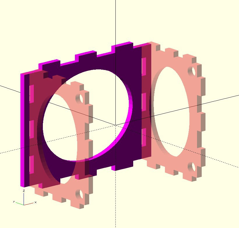

To implement Slot and Tabs, I wrote Function Slots(). Easy enough, create some slots, translate them to the edge in question and take the difference:
// Add Slots for Bulkhead mirrorCopy([1,0,0]) translate([cgap/2-5,0,0]) rotate([0,0,90]) slots(wgap,plateThick,3);-
Worked fine until it does not!
Spent a day working through this, the answer was a vertical version of slots to avoid the rotation:
Slotting
The slotting code work with odd and even matching slots or tabs:
// Make Slots for edge joins module xslots(l,d,n) { let(m=n%2) let(w=l/(2*n+2*m-1)) for(i=[1-n:2:n-1+0.001]) translate([i*w,0,0]) cube([w+0.01,d+0.02,3*d],center=true); } module yslots(l,d,n) { let(m=n%2) let(w=l/(2*n+2*m-1)) for(j=[1-n:2:n-1+0.001]) translate([0,j*w,0]) cube([d+0.02,w+0.01,3*d],center=true); }-
For example, adding slots and tabs using tab = 3 and slots = 4, to bulkheads:
// Add Bulkheads color("Red") mirrorCopy([1,0,0]) { translate([cgap/2-5,0,0]) rotate([0,90,0]) difference() { cube([wgap,mgap,plateThick],center=true); // Add Tabs on Sides mirrorCopy([1,0,0]) translate([wgap/2-plateThick/2,0,0]) yslots(mgap,plateThick,4); // 4 slots and 3 Tabs // Add Tabs on Top and Bottom mirrorCopy([0,1,0]) translate([0,mgap/2-plateThick/2,0]) xslots(wgap,plateThick,4); // 4 slots 3 and Tabs } }-
First the bulkheads with edges oversized:
First set of slots cutout:
Second set of cutouts:
Other cutouts:
So the trick here was to use n=3 for tabs and n=4 for slots, keeping d=depth and l=length the same.
Note: (1,2) and (3,4) and (5,6) etc, are matching sets.
Now some matching slots in the Top:
color("Magenta") translate([0,mgap/2-plateThick/2,0]) rotate([90,0,0]) difference() { cube([cgap,wgap,plateThick],center=true); // Add Tabs to Vertical Support mirrorCopy([0,1,0]) translate([0,wgap/2-plateThick/2,0]) xslots(cgap,plateThick,4); // Add Slots for Bulkhead mirrorCopy([1,0,0]) translate([cgap/2-5,0,0]) rotate([0,0,90]) xslots(wgap,plateThick,3); // Add Top Cutout scale([(cgap/2-3.5-3*plateThick)/(wgap/2-3*plateThick),1,1]) cylinder(h=3*plateThick,r=wgap/2-3*plateThick,center=true); }-
And finally, assembled and checked for fit:

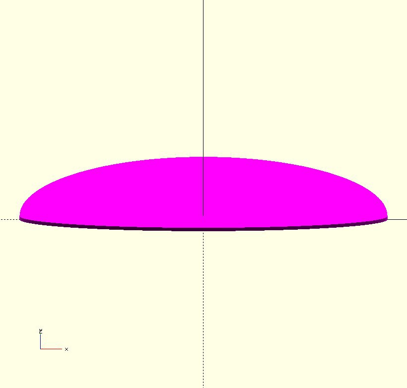

The Elliptical Wing Function
The method for mathematical shapes is two step, first the function:
// Bumpers function ellipticalWing(a,b,c) = [for(e=[0:3:360]) if (e<180) [a*cos(e),b*sin(e)] else [a*cos(e),c*sin(e)] ];then the polygon/extrusion:
// Make an Elliptical Wing (Bumper) linear_extrude(height=plateThick,center=false) polygon(ellipticalWing(wgap/2+4*sgap,50,10));-
The Bumper (an elliptical wing):
AlanX
