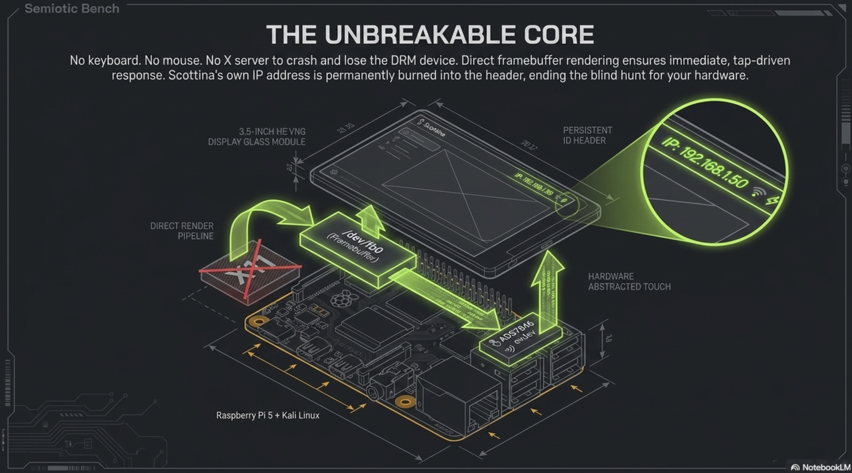

    Log 1 mentioned "render directly to the framebuffer" as one of six ground rules and moved on. It deserves its own post, because this is the decision that almost every other design choice in Scottina traces back to.
    Why not just run Xorg like everybody else?
    The obvious path for a touchscreen kiosk is a desktop stack: Xorg or Wayland, SDL or Qt, a browser or a toolkit on top. I tried variations on that and kept running into the same wall — anything that can lose the DRM device eventually does, and on a 3.5" panel wired over SPI, "eventually" shows up as a frozen or blank screen at the worst possible bench moment. The only approach that's proven reliable on this hardware is the boring one: own /dev/fb0 directly.
