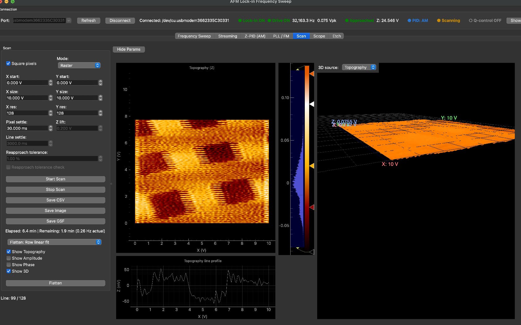

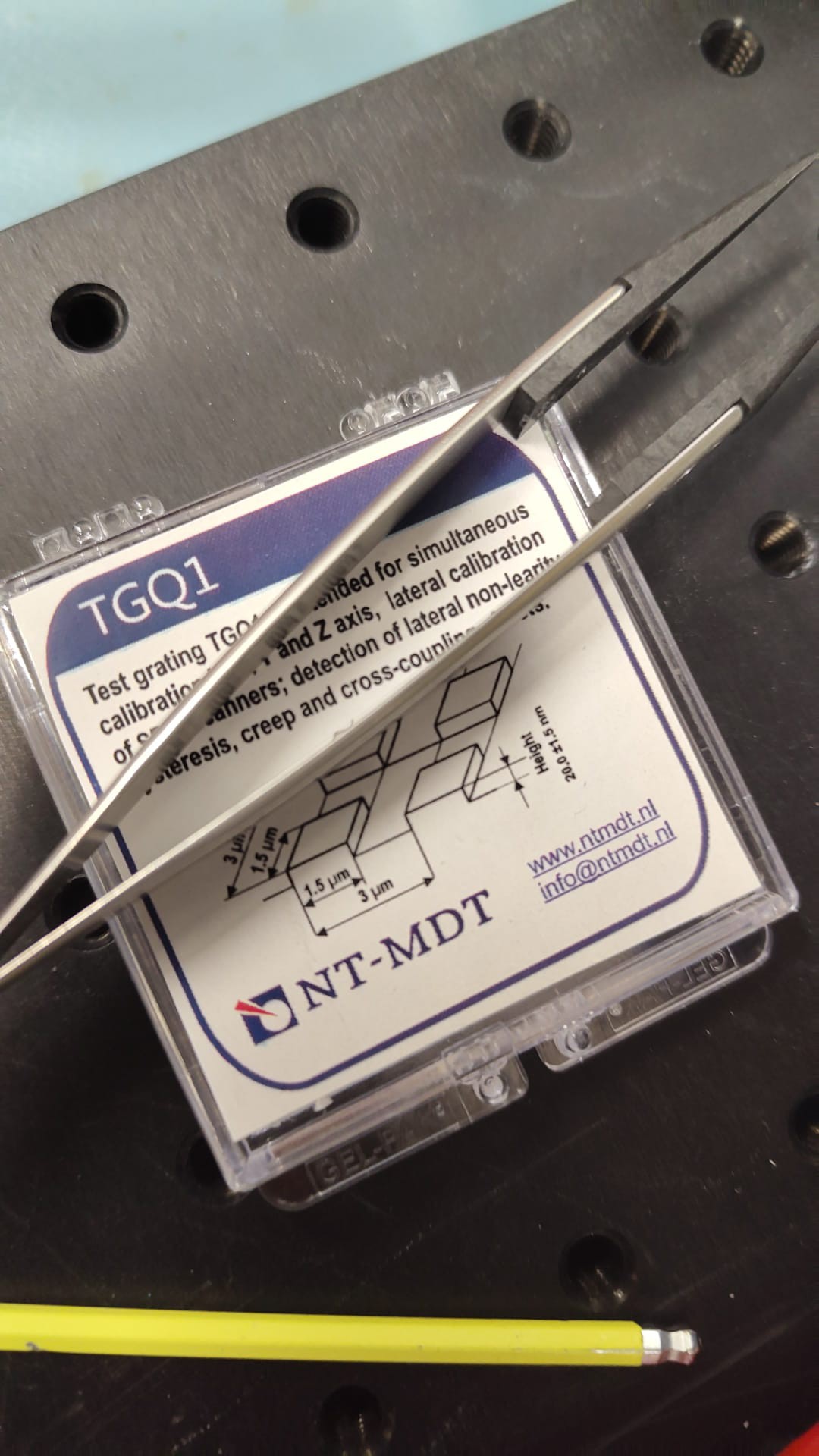

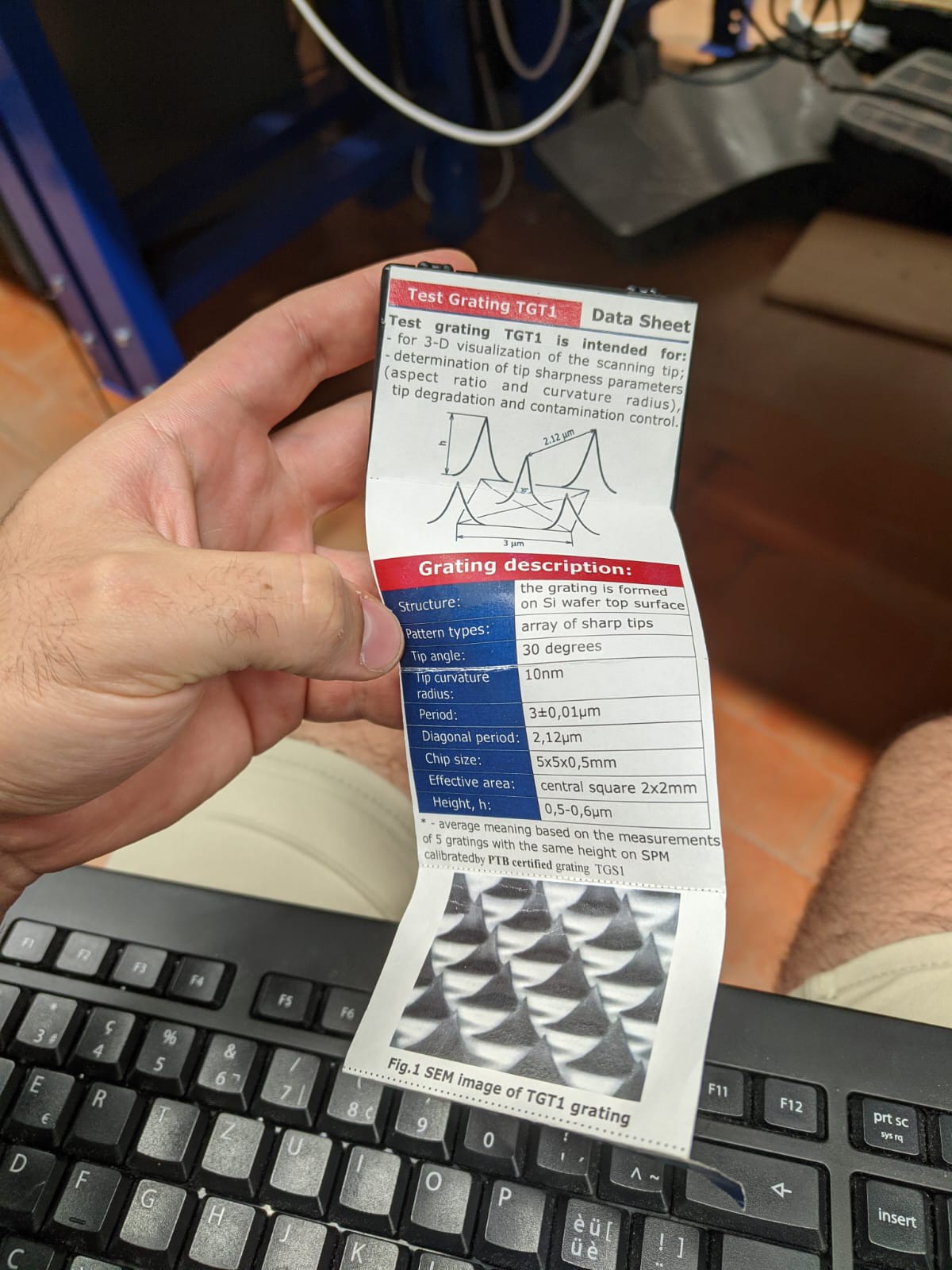

    Now for the cool stuff. The images shown are from AFM calibration grids one has steps of 20nm which really require a decent AFM to see. I also tried to image a graphene device with some wires coming out. Bigger calibration grid is quite easy to see. Some examples of images are below
    This is the image below

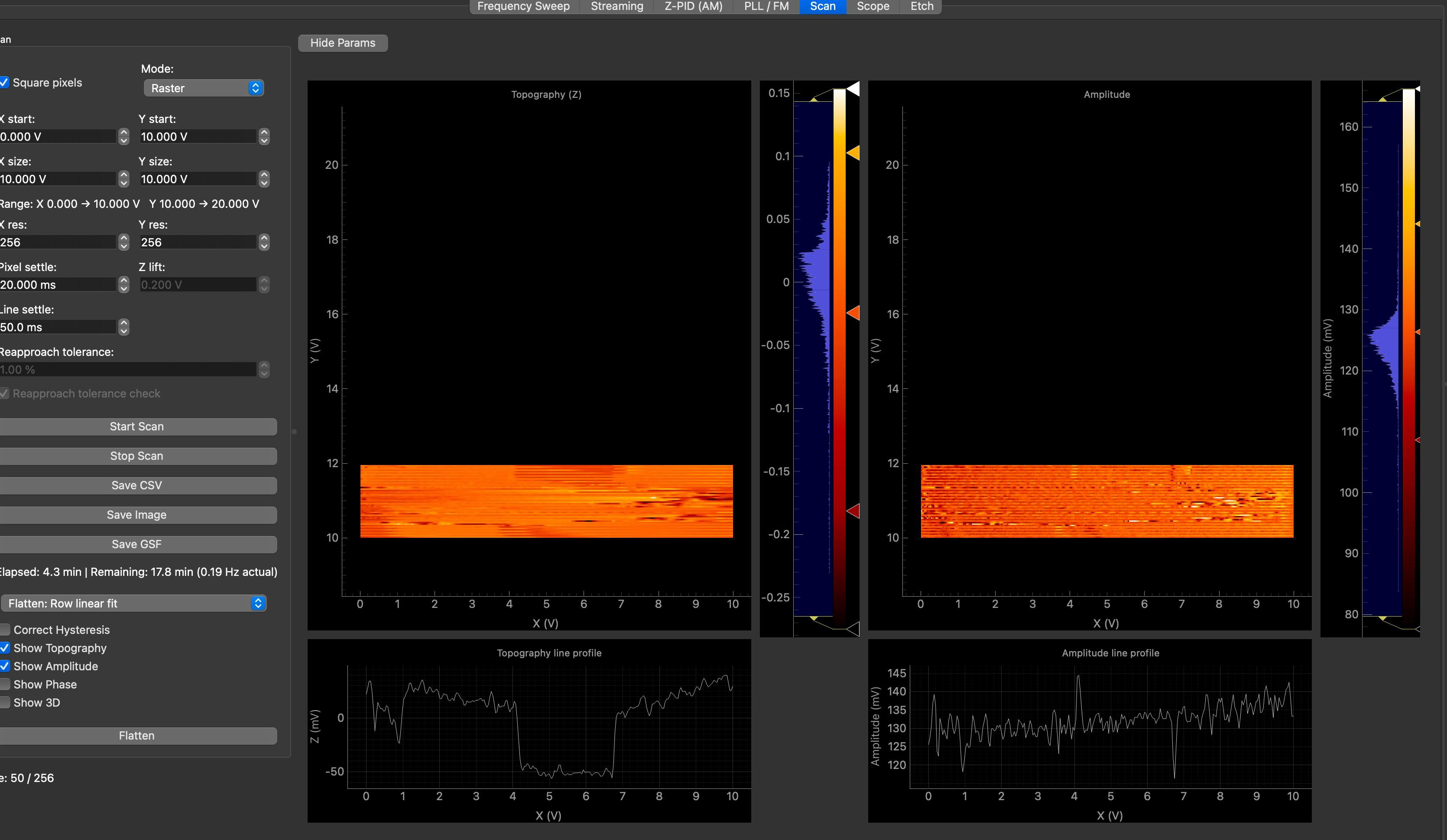

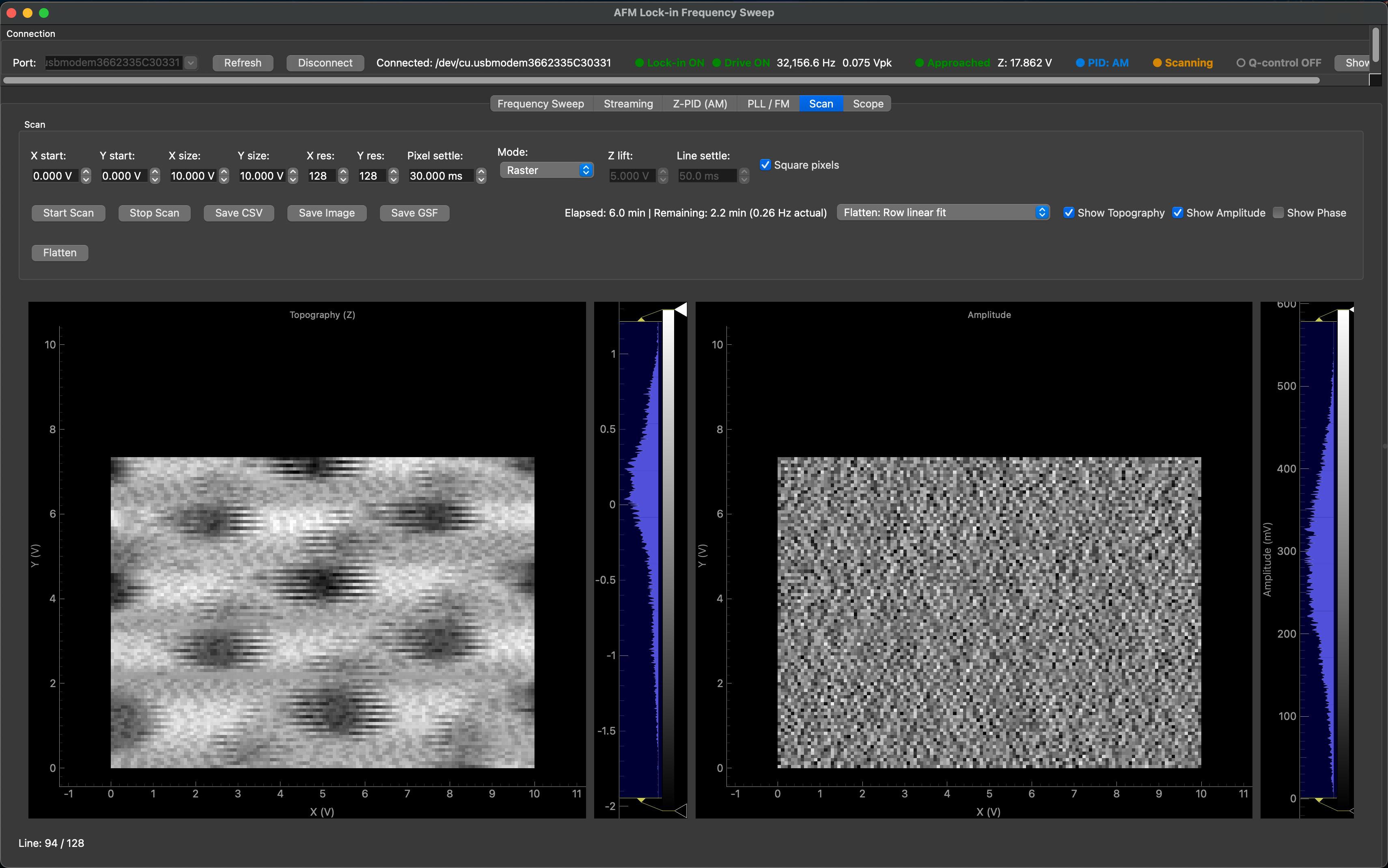

    as you can see the forwards and backwards scans during the raster scan have different sizes (the backwards scan is stretched in comparison with the forwards one) I believe this is the piezo hysteresis in the stage. This is fixed by scanning in a single direction. That is, once you reach the end of the forwards scan, you lift the tip move it back reengage the PID and scan again, this unfortunately adds some time to the scan but fixes this issue more or less.

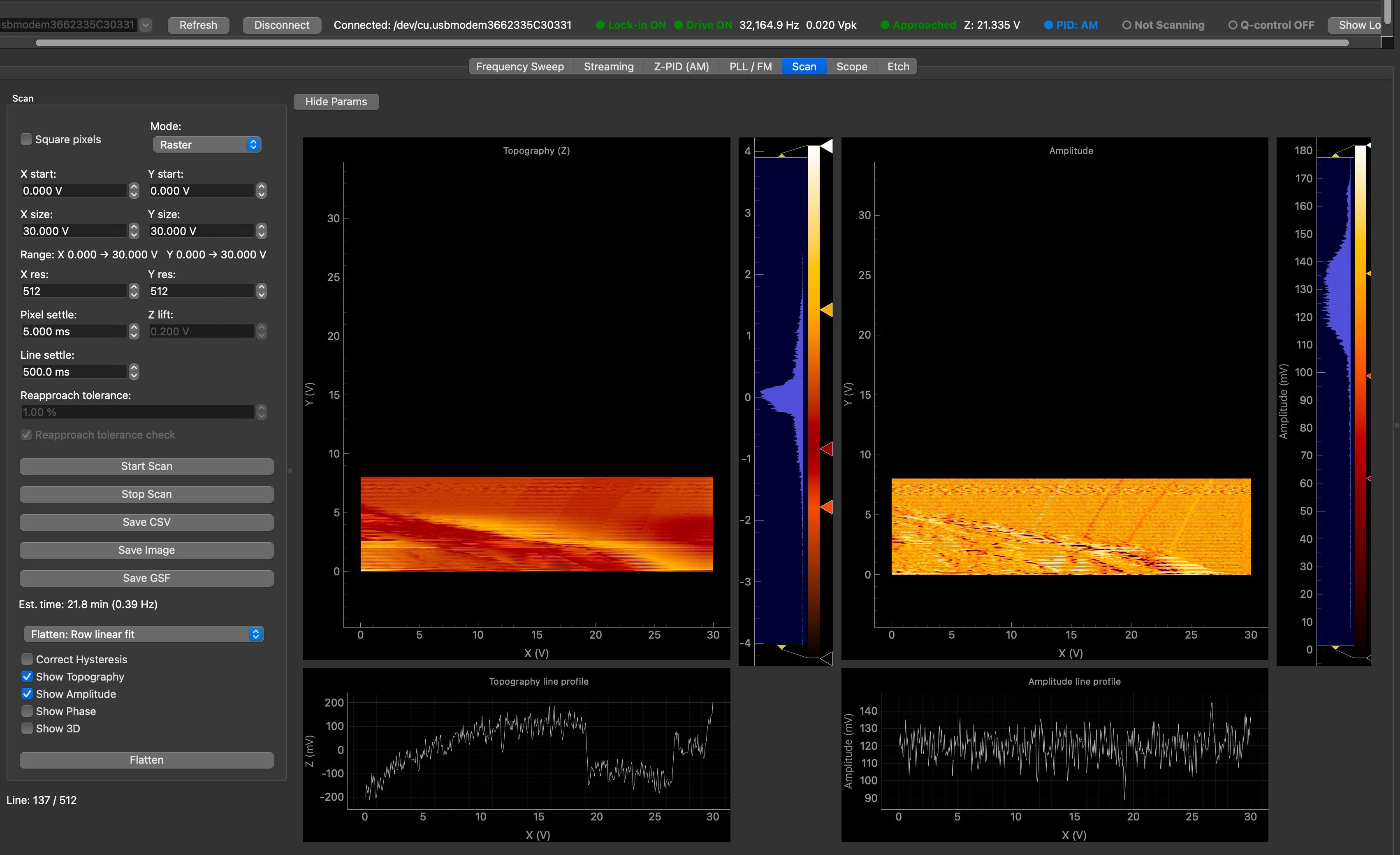

    New images I took are now with improved noise from shielding on the tuning fork wires leading to the transimpedance amplifier (TIA) and below you can see a 20nm step from the calibration grid with 20nm high 1.5um wide squares
    Here is an example of the 20nm step with improved noise. The previous steps looked like this:
    With the improved shielding on the tuning fork wires to the TIA the same 20nm step is much cleaner. I believe now I am limited by environmental vibrations due to my damping being a bike inner tube, to see atomic layers, I likely need and enclosure and the setup suspended by springs with eddy current damping from magnets similar to Dan Berard's STM. but I would say this is pretty good already for most applications like looking at cells or DNA.

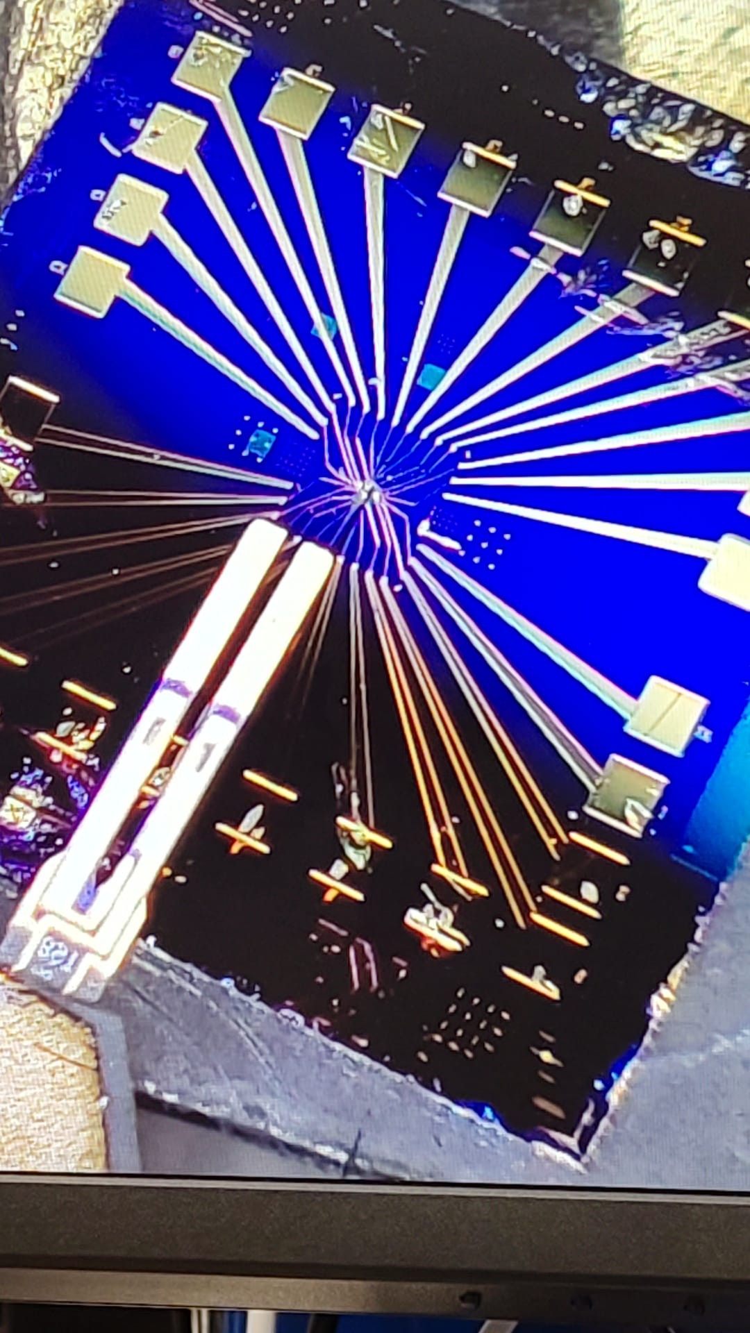

    I also imaged the connections wires to a graphene device kindly given to me by a friend where you can see 10s of nm high wires, It's a little hard to see in the topography image without better processing in gwyddion but you can see the e-beam evaporated gold wires coming out from the graphene flake in the amplitude scan quite well.
    below is the setup the device is in the middle of the wires
    Here is the optical microscope image
    I believe this image is on one of the edges of the flake, as I didn't have a great microscope to check where I was and the tip is moved with a hand micrometer stage. With only 15x15um scanning range and the images taking a while it's hard to hit the actual 10ish um device (I didn't have too much time that evening). However, it is still possible to see the 10nm high wires and the graphene should be quite thin as well.
