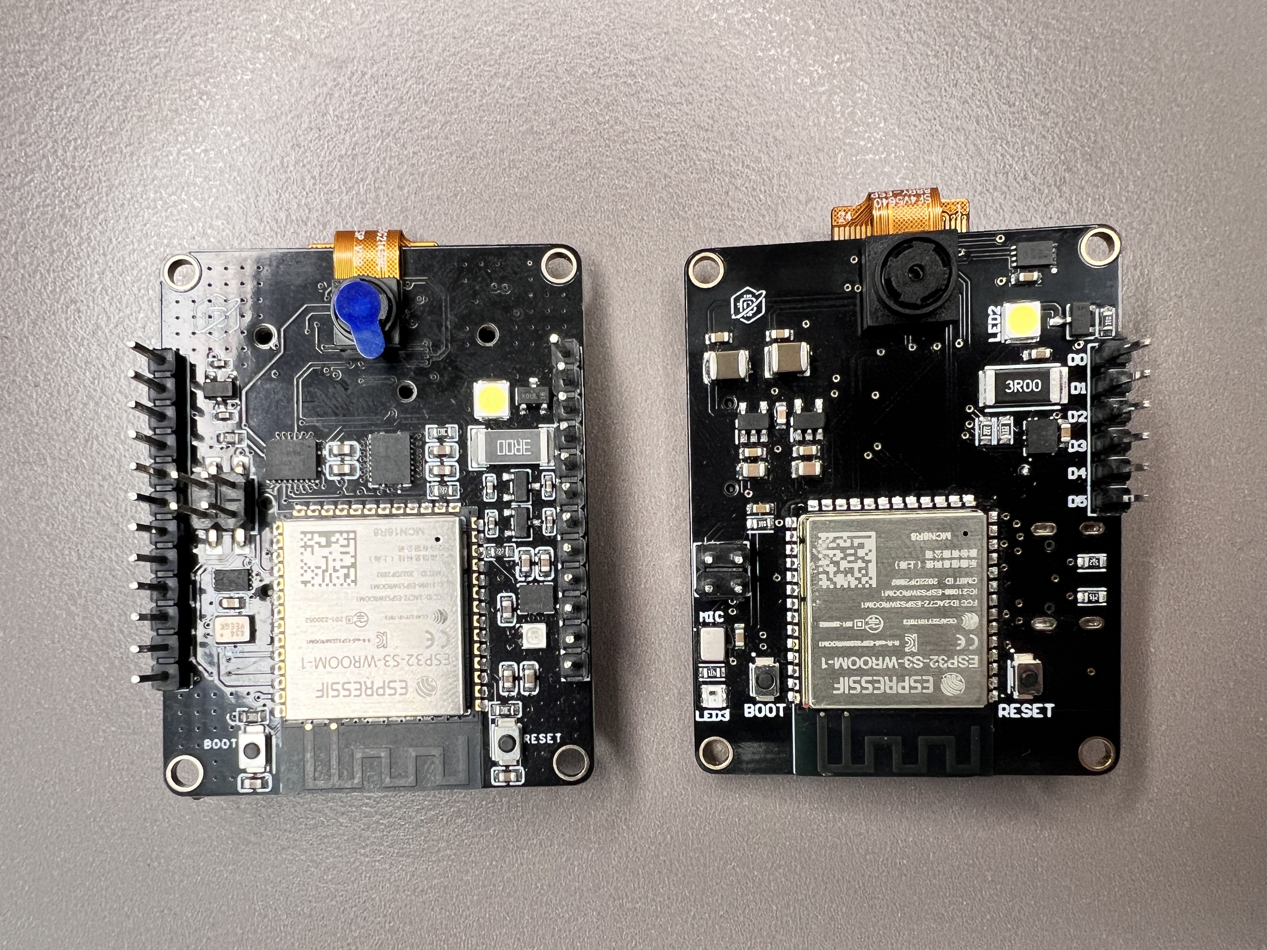

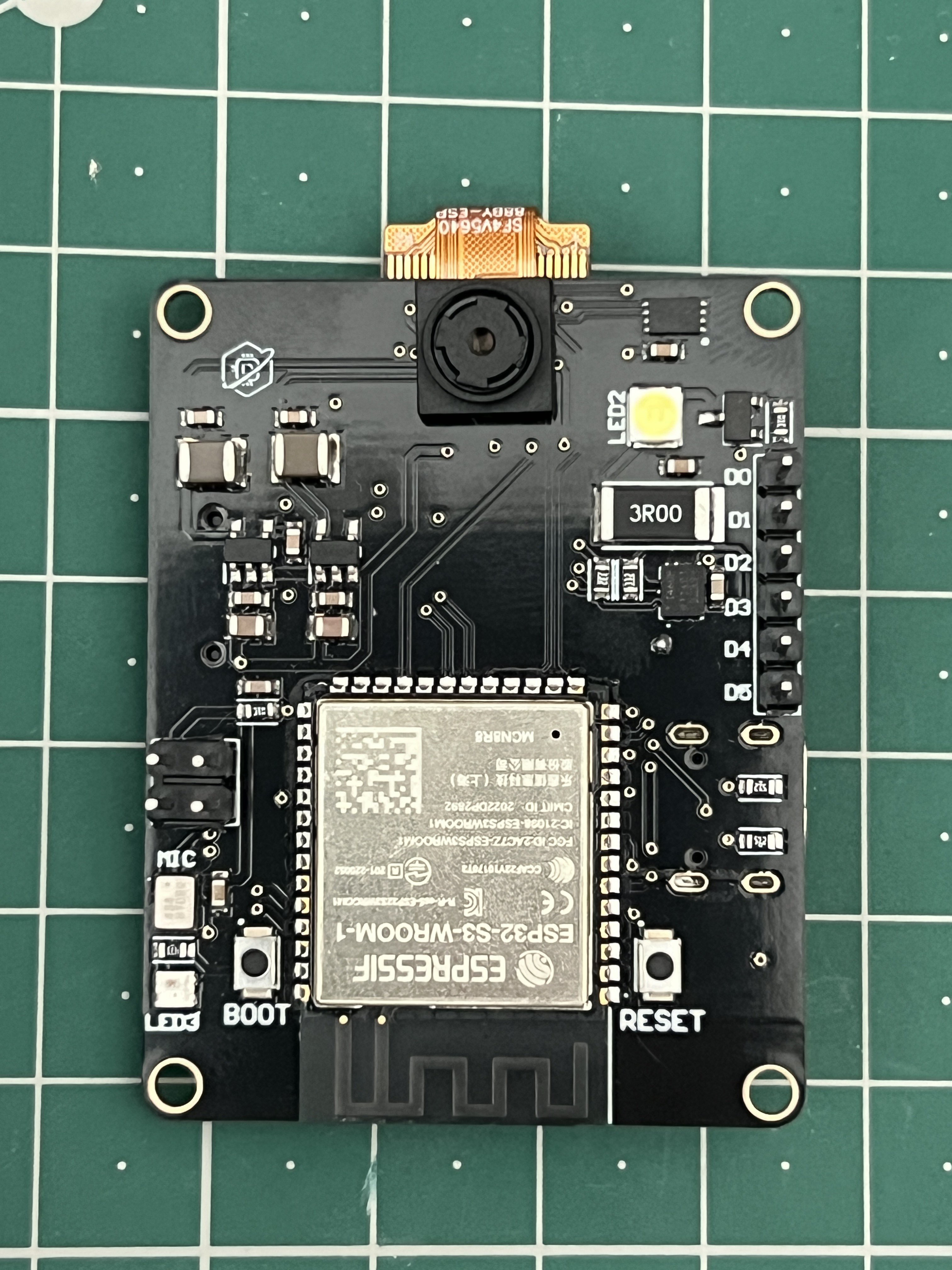

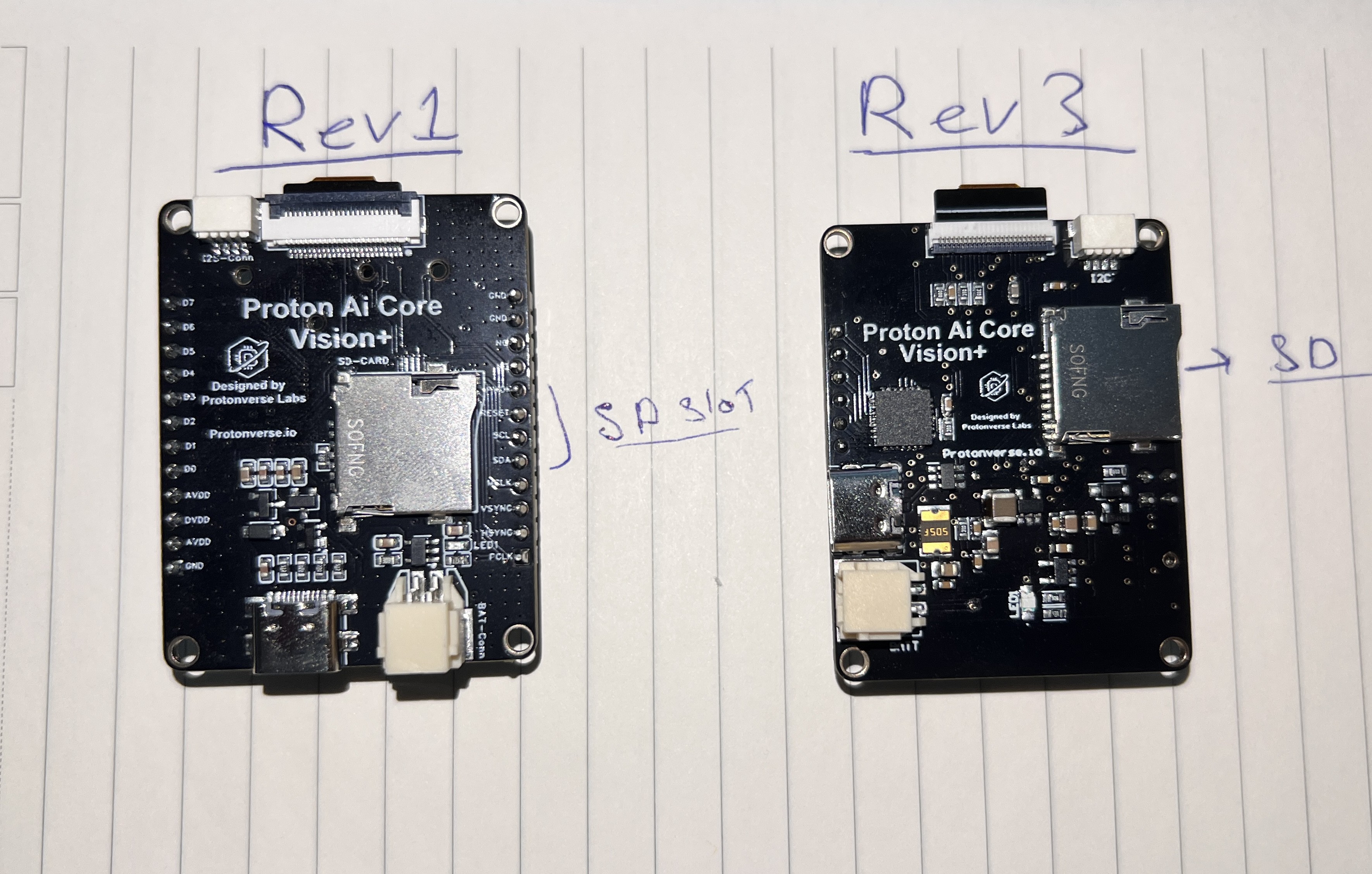

Three revisions, and the first one was posted here to be taken apart
About a year ago I published the first prototype on r/esp32. Two criticisms came back repeatedly:
microSD placement. The socket was somewhere that made the card awkward to reach and fought for space with everything around it.
The antenna keep-out under the WROOM module. This was the serious one.
The ESP32-S3-WROOM-1 has its antenna printed into the module. Espressif specifies a keep-out region underneath and around it — no copper, no ground plane, no traces, no components — and the antenna end is supposed to overhang the edge of the carrier board. Put a ground plane under there and the antenna detunes and range collapses. The first revision did not respect that properly.
Both drove revision two. The keep-out fix is not a patch you apply later. It changes where everything else on the board is allowed to sit, so it forced a re-plan of the whole layout.
Revision three is the first one where all the peripherals run simultaneously. That sounds like a low bar. It was most of the work.
