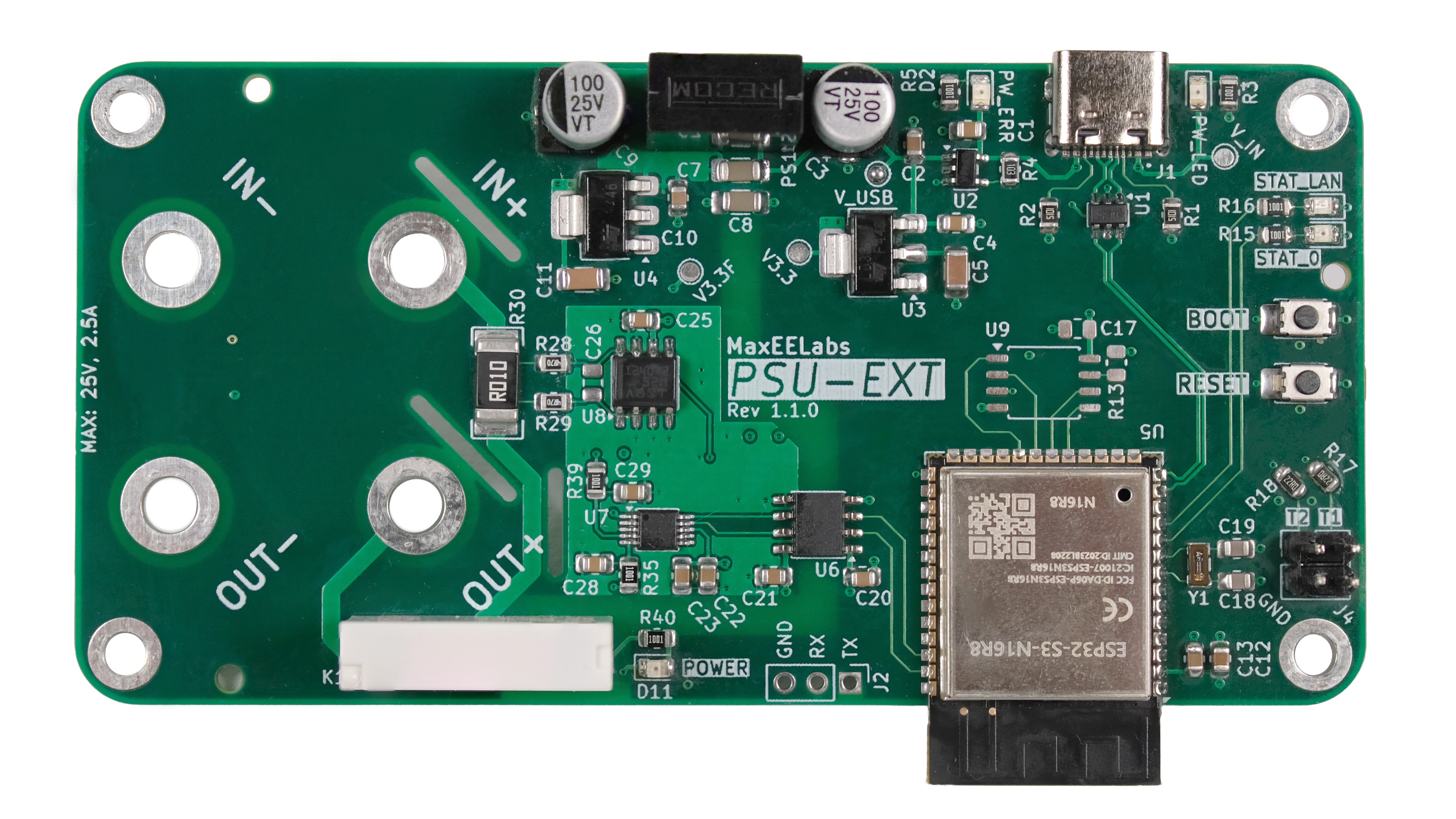

Overview
PSU-EXT sits inline between a bench power supply and whatever it's powering. It measures voltage, current, and power, switches the output on and off through a relay, and speaks SCPI — the command language bench instruments use — over both USB and Wi-Fi/TCP.
A browser dashboard sits on top: live telemetry widgets, OVP/OCP protection controls, a raw SCPI console, and a JavaScript scripting IDE for running sandboxed automation sequences against the device. Hardware, firmware, and the dashboard's backend and frontend are all in the open.
It started from a plain annoyance: our own bench PSU already did the one thing it needed to do — supply power — but everything around that was manual. Watching the display meant standing at the bench. Logging meant writing numbers down. Scripting anything wasn't really on the table. PSU-EXT is what we built to sit inline and take care of that part.
Spec at a glance:
Operating range0–25 V, 0–2.5 A
Board size100 × 50 mm (3.94 × 1.97 in)
Control connectionUSB-C (power and data)
ControllerEspressif ESP32-S3
Measurement front endADS1115 ADC + INA240 current-sense amplifier
IsolationIsolated I²C bus + isolated DC-DC (measurement domain)

  • Adding Auto-ranging to the PSU-EXT Analog Front End
    Maxim Pavlov • 09/13/2026 at 05:34 • 0 comments
    PSU-EXT sits between an existing bench power supply and its load. It measures voltage and current and controls the output path with a relay. This update follows the development of its voltage measurement front end, from fixed converter settings to automatic range selection and programmable acquisition speed.
    The existing design works with a fixed programmable gain amplifier (PGA) setting and a fixed analog-to-digital converter (ADC) rate. Its DC voltage accuracy is:
    • ±(0.1% of reading + 2 mV) from 1 V to 24 V
    • ±(0.5% of reading + 2 mV) below 1 V
    That gives us a useful starting point. The next step is to use more of the ADS1115's capabilities: select a measurement range automatically and let the acquisition speed suit the task. Following that idea through the firmware led to two additions to the analog circuit: voltage buffers and a negative-rail output bias.
    Making the Converter Settings Programmable
    The ADS1115 has several full-scale input ranges. A smaller range gives a smaller voltage step per ADC count, which is useful when measuring low voltages. Autoranging lets the firmware select a narrow range for a small signal and move to a wider range as the signal rises.
    The updated firmware uses three ranges: ±0.256 V, ±0.512 V, and ±2.048 V. These are voltages at the ADC input, after the voltage divider.
    The range selection code moves one range at a time. Separate thresholds for moving up and down provide hysteresis, so a reading near a boundary does not repeatedly switch ranges. This excerpt comes from components/measure_svc/measure_prov_ads1115.c:
    uint8_t index = current_index;
    if ((index + 1U < ADS1115_RANGE_COUNT) &&
        (adc_voltage_u4 >= ADS_RANGES[index].hysteresis_top_u4)) {
        ++index;
    } else if ((index > 0U) &&
        (adc_voltage_u4 <= ADS_RANGES[index].hysteresis_bottom_u4)) {
        --index;
    *next_index = index;
    Each input keeps its own range index. The firmware can therefore choose a range independently for each measured signal.
    Acquisition speed is  now programmable too. The driver accepts the ADS1115 rates of 8, 16, 32, 64, 128, 250, 475, and 860 samples per second. For example, these cases encode two rates into the configuration register:
    case 128U:
        *bits = (uint16_t)0x04U << 5;
        return ESP_OK;
    case 250U:
        *bits = (uint16_t)0x05U << 5;
        return ESP_OK;
    These settings control the converter rate. The update rate for a complete set of measurements also depends on channel scanning and settling conversions.
    The new Standard Commands for Programmable Instruments (SCPI) command exposes this setting to users:
    CommandDescription
    MEASure:ADC:RATE <SPS>Set the ADC conversion rate in samples per second
    MEASure:ADC:RATE?Read the selected rate as an integer
    Following the Signal Back to the Divider
    During development of the programmable-rate mode, changing the ADC rate also changed the voltage reading for a steady input. The current channel, driven by an INA240 current-sense amplifier, stayed stable in the same experiments. That difference pointed us toward the circuit driving the ADC.
    Each voltage channel uses two 160 kΩ resistors above a 20 kΩ resistor. The nominal division ratio is 17:1. At a 30 V input, the divider produces about 1.765 V while drawing about 88 µA.
    Rsource = 320 kΩ || 20 kΩ ≈ 18.8 kΩ
    The ADS1115 uses a switched-capacitor input. Its input loading interacts with the resistance of the source driving it; The ADS1115 datasheet describes this behavior. The observed rate-dependent shift made source impedance a practical design consideration for the new operating modes.
    Adding a Buffer
    The revised design places a TSZ122 dual precision operational amplifier between the voltage dividers and the ADC. Each amplifier channel is a unity-gain follower. The divider sets the voltage ratio, and the buffer provides a low-impedance signal to the converter.
    Measured voltage
        160 kΩ
        160 kΩ
     +----> TSZ122 follower...

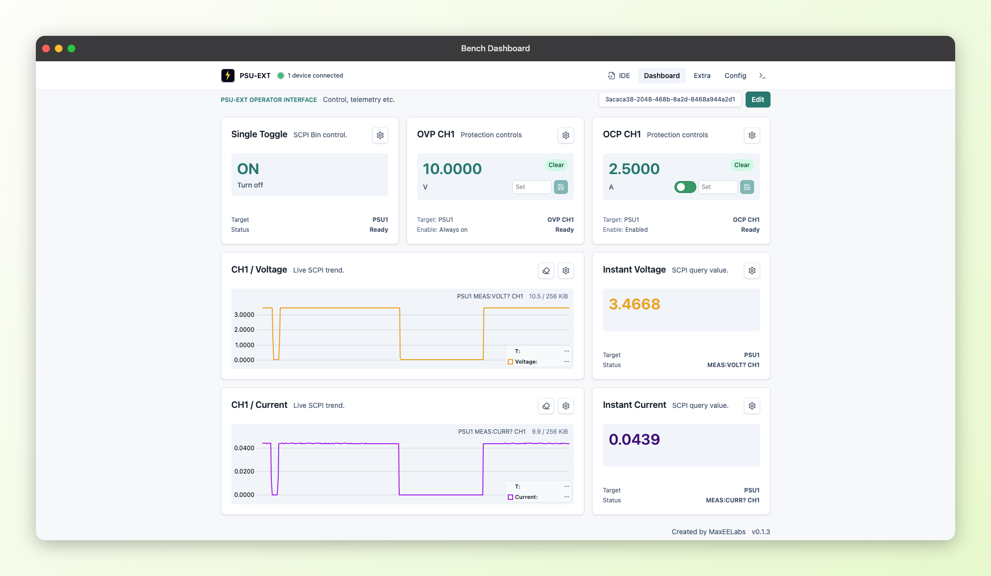

  • A Tour of the PSU-EXT Dashboard
    Dzmitry Dydyshka • 08/30/2026 at 17:09 • 0 comments
    Prerequisite
    Getting a device connected and the PSU-EXT Dashboard open follows the Installation section of the psu-ext-software README.
    The Tour
    From there, here's where the dashboard itself stands today: a three-column grid built from a catalog of six widget types:
    • Single Value (displays a live SCPI reading);
    • Single Toggle (switches something on or off using SCPI commands);
    • Protection Control (watches a threshold and flags whether it's tripped);
    • External Triggers (hardware input pins to SCPI actions);
    • Timer Queue (runs a queue of timed relay actions);
    • Chart (plots SCPI query over time)
    PSU-EXT Dashboard WIth All Types of Widgets
    Getting the Grid Ready to Look Around
    A toolbar "Edit"/"Done" (1) button unlocks dragging, deleting, and adding widgets. The Add widget catalog (2) lists eight entries mapped to the six widget types (three of those eight are the chart's fixed sizes). "Reset" (3) restores the default layout
    Whatever layout you build persists locally in the browser.
    PSU-EXT Dashboard First Visit
    One fact applies to every widget type before we tour them individually: each widget picks its own target device independently, so a single dashboard isn't locked to one PSU-EXT unit. You can mix cards pointed at different connected devices on the same grid.
    Single Value and Single Toggle: The Two Simplest Widgets
    Single Value and Single Toggle are the two simplest widgets on the grid, both sized 1x1.
    Single Value is a read-only display of one cached SCPI query result: a number plus a unit label, for example "5.1431 / V".
    Single Value Widget
    Single Value Widget
    Single Value Widget Settings
    Single Toggle is a button that turns something ON or OFF — enabling a channel's output, say — and shows which state it's currently in: it checks a SCPI status query to know whether the thing it controls is ON or OFF right now, and clicking it sends one SCPI command for ON and a different one for OFF.
    Single Toggle Widget

    What PSU-EXT Is: One Module, Firmware, and a Dashboard
    Concretely, here's where that thinking has landed so far. PSU-EXT sits inline between a bench power supply and a load, measures voltage, current, and power, and controls the output path with a relay. That's the current physical shape the five points above have taken.
    "PSU-EXT" isn't just that board, though — it's three pieces that work together, each its own repo:
    - Hardware — the module itself
    - Firmware  — runs on the module
    - Software  — the companion stack that talks to the firmware over USB or the network
    Separate repos, one product, moving in parallel.
    Here's what it's built on right now:
    PSU-EXT Board
    PSU-EXT Board

    Firmware & softwareOpen hardware, firmware, and software — not closed or vendor-locked
    Control transportsSCPI over both USB CDC and Wi-Fi/TCP
    AutomationBuilt-in scripting IDE and reusable dashboard widgets
    Instrument scopeWidgets adapt to other SCPI-capable gear too, not locked to this one instrument
    PSU-EXT Dashboard
    PSU-EXT Dashboard
    What...
