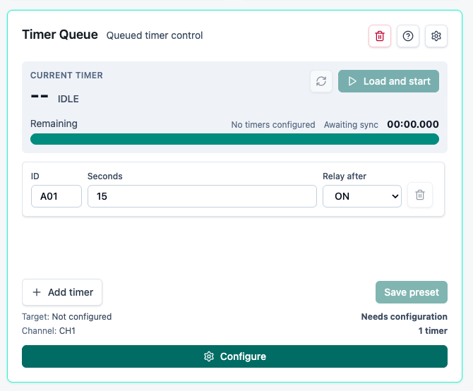

(`TIMer`)"TIMer:ADD CH1,<id>,<seconds>,<0|1>" queues a delayed relay transition; "TIMer:STATus? CH1" reports whether that queue is idle, running, paused, or tripped. Trigger

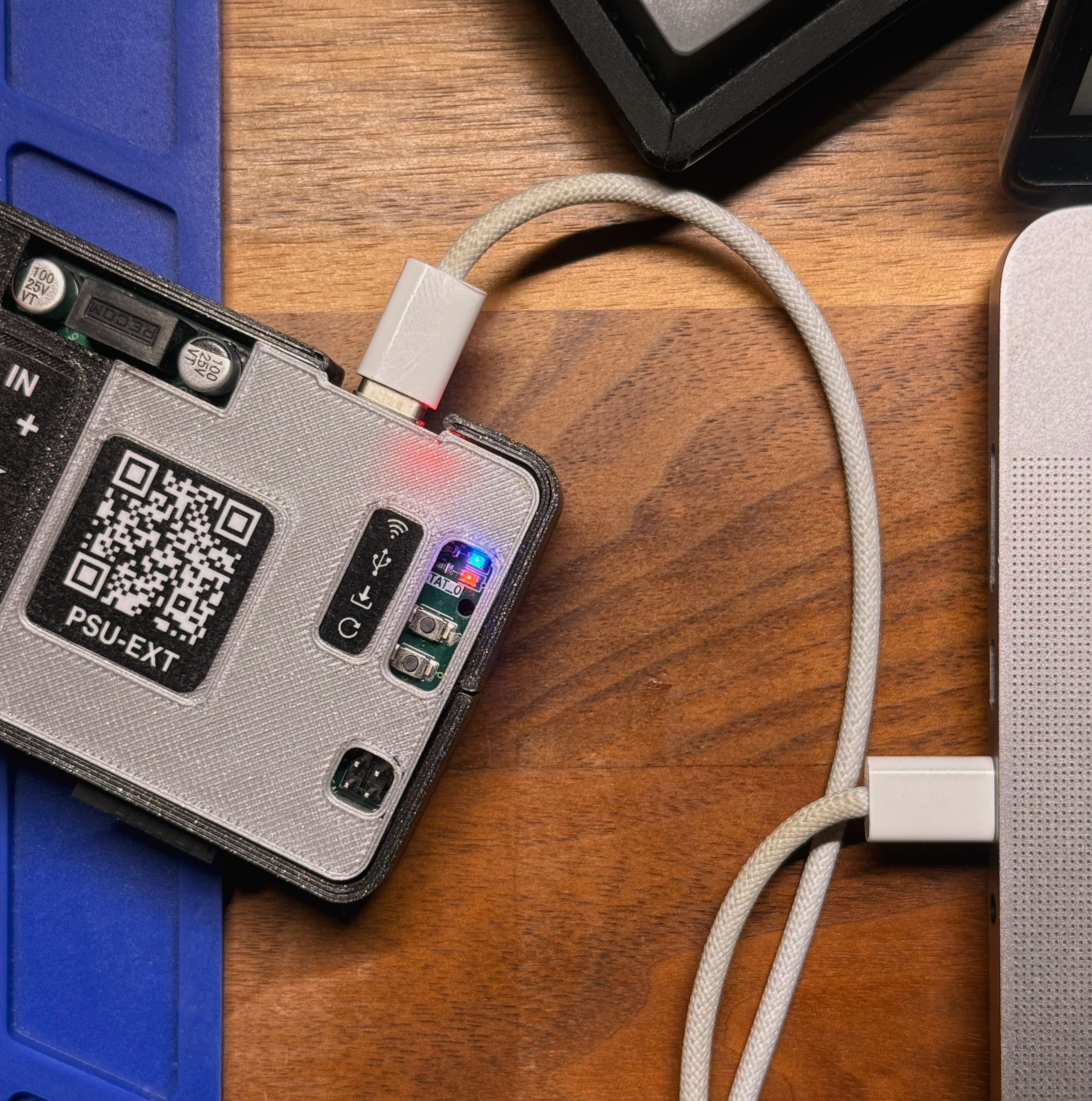

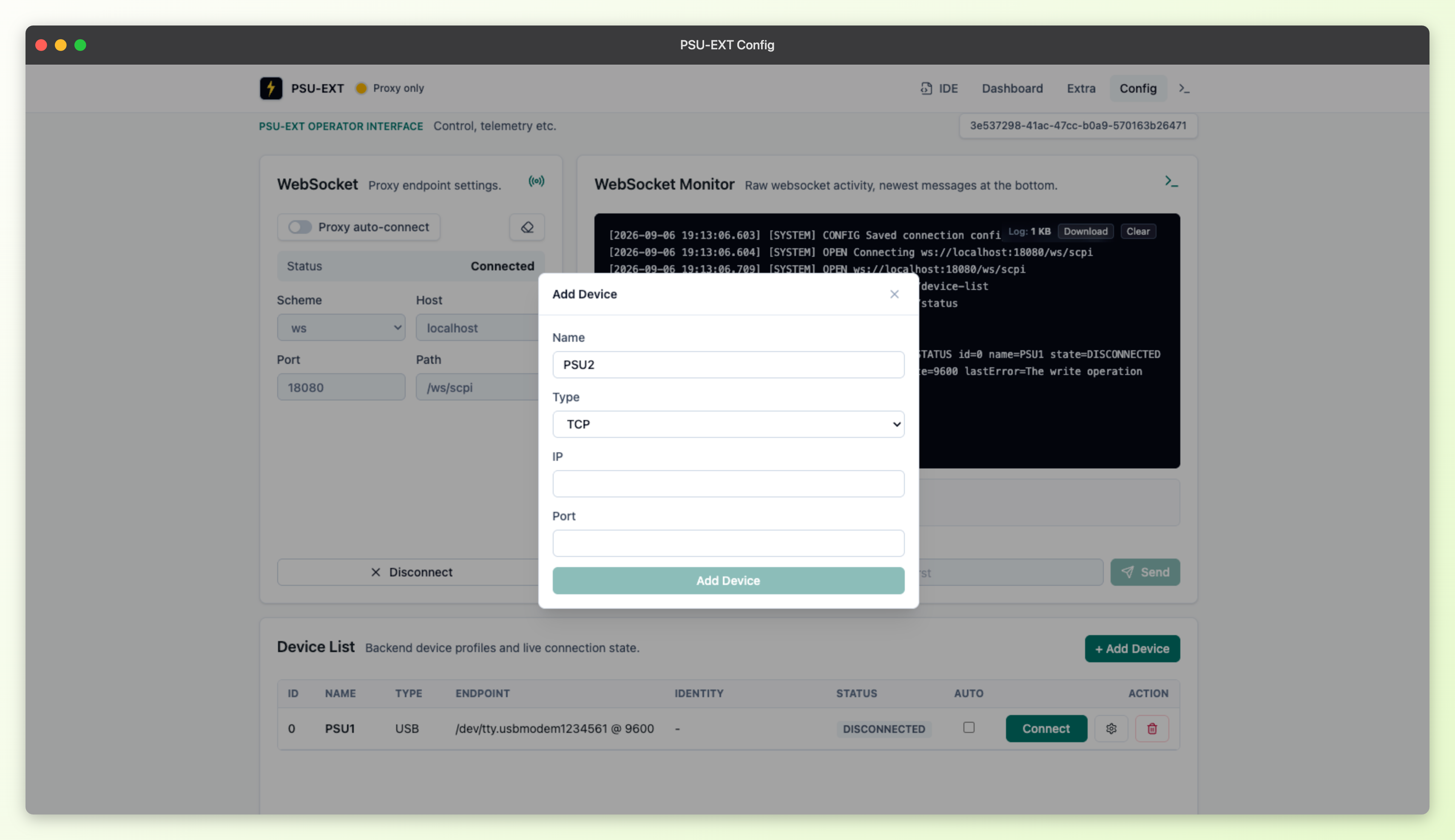

Adding a device starts from the dashboard's Config page: the "Device List" widget carries a "Add Device" button that opens a form offering the same TCP/USB choice. The device profile it creates is saved server-side rather than in the browser, so it's still there the next time anyone opens the dashboard, from any browser.
Our TCP transport's default target is "192.168.4.1:5025".
USB connects as a standard USB-CDC virtual COM port, so it shows up like any other serial device once plugged in.We also have two independent physical status LEDs, one per connection: a red LED on GPIO17 for USB status and a blue LED on GPIO18 for Wi-Fi status. Each lights solid once its connection is up. Wi-Fi additionally shows a slow breathing ramp while it's connecting; USB has no connecting state of its own, just connected, failed, or off. Both use the same fast-triple-blink-then-pause pattern to signal a failure, and both go dark when idle.
![WiFi and USB Connection LEDs WiFi and USB Connection LEDs]()
WiFi and USB Status LEDs

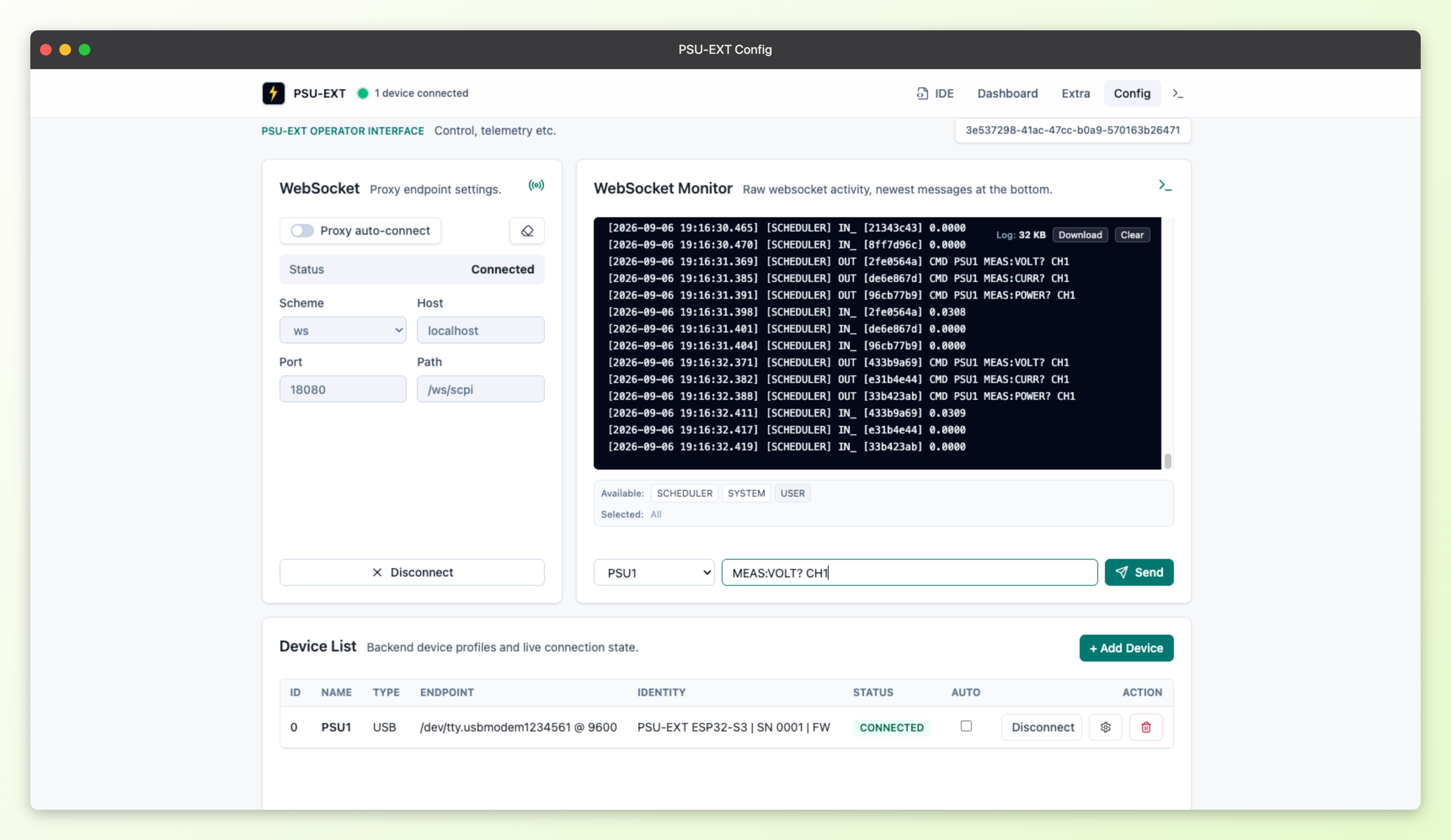

Both transports behave identically from the bridge's point of view — connect, send a command, wait for a reply if it's a query — so the bridge itself doesn't care which one a device is using. The dashboard's live telemetry charts poll frequently - each poll a "CMD <device> <query>" request — and running all of that over one persistent connection avoids the overhead of opening a fresh one for every query. The built-in SCPI console widget rides the same bridge: a command typed there goes out over the identical channel as the charts' polled queries.
Under the hood, that channel is a single WebSocket endpoint, "/ws/scpi", carrying a simple text envelope. Inbound frames use a "REQ <uuid> <payload>" format:
REQ 3f9c... /connect TCP-Bench-1 REQ 3f9c... MEAS:VOLT? CH1Slash-prefixed commands (`/device-add`, `/device-list`, `/device-modify`, `/device-delete`, `/connect`, `/disconnect`, `/status`) handle device management; anything else is forwarded as raw SCPI text.

Timer Queue is a 2x2 widget that lets you queue up to ten timed relay actions in sequence, so you can cycle an output on and off over a schedule without writing a script. The code caps it at:
MAX_TIMERS = 10
The widget's config is hardcoded to CH1, so every timer in the queue acts on CH1's output relay — the same relay that Single Toggle's "CH1 Output" example switches. Each timer carries an ID of up to three characters, a duration in seconds, and a relay-after setting of ON or OFF: once that timer's duration counts down, CH1's output relay switches to whichever of those two states the timer was set to.
A timer must be saved as a preset and loaded onto the device before Load-and-start actually runs it — the widget makes that explicit, showing "Preset not loaded" until you've loaded it, then "Loaded on device" once it is.
![Timer Queue Widget Timer Queue Widget]()
Timer Queue Widget

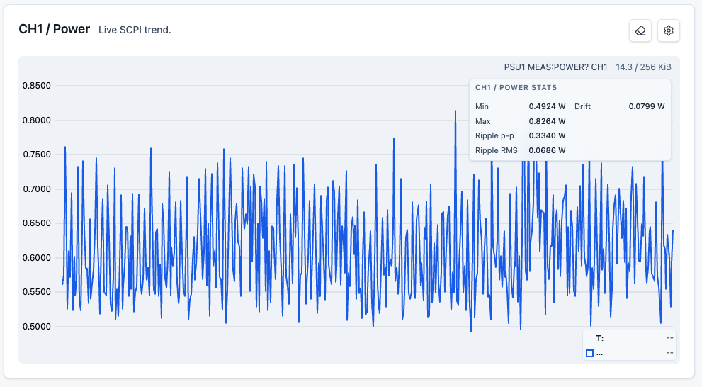

Chart: Trends Over Time, in Three Fixed Sizes
Chart comes in three fixed sizes — 2x1, 2x2, and 3x2.

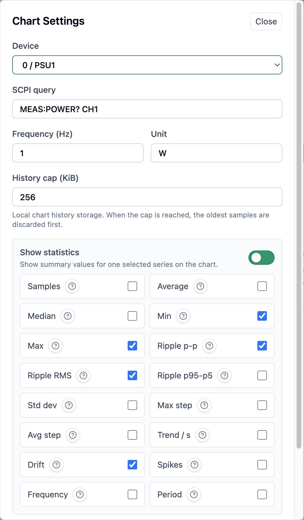

Each chart plots one or more SCPI query series over time, and each series carries its own device, query, and line color.
History is capped to a local byte budget, and the widget shows how much of that budget is currently used right in the header — "43.7/ 256 KiB" in one of our captures, for example. An eraser-icon action clears that history. There's also an optional statistics panel on this widget.
Chart Widget
![Chart Widget Settings Chart Widget Settings]()

Concretely, here's where that thinking has landed so far. PSU-EXT sits inline between a bench power supply and a load, measures voltage, current, and power, and controls the output path with a relay. That's the current physical shape the five points above have taken.
"PSU-EXT" isn't just that board, though — it's three pieces that work together, each its own repo:
- Hardware — the module itself
- Firmware — runs on the module
- Software — the companion stack that talks to the firmware over USB or the networkSeparate repos, one product, moving in parallel.
Here's what it's built on right now:
Operating range 0–25 V, 0–2.5 A Board size 100 × 50 mm (3.94 × 1.97 in) Control connection USB-C (power and data) Controller Espressif ESP32-S3 Measurement front end ADS1115 ADC + INA240 current-sense amplifier Isolation Isolated I²C bus + isolated DC-DC (measurement domain) ![PSU-EXT Board PSU-EXT Board]()
PSU-EXT Board
