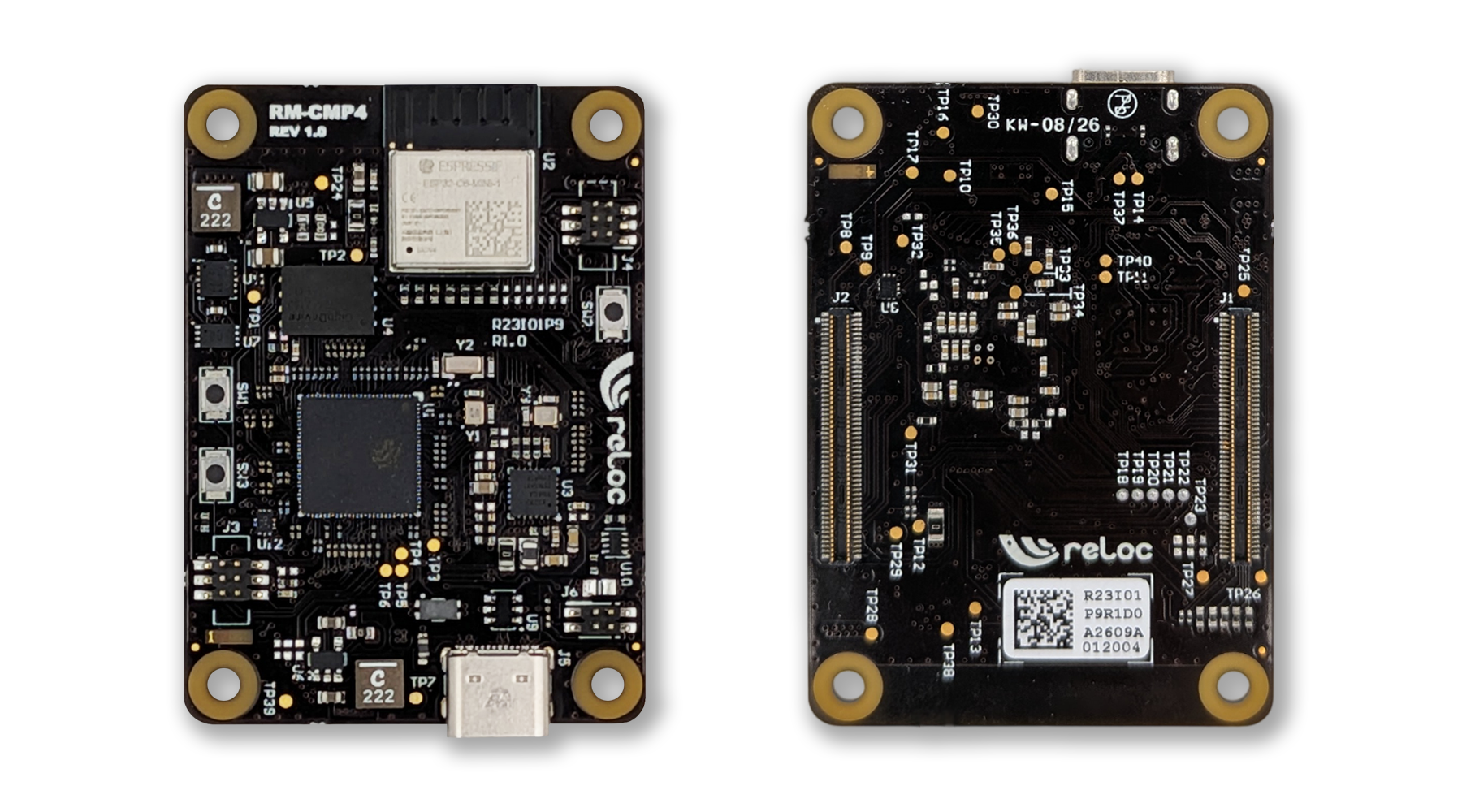

We ported DOOM to SCINTIX P4 (an ESP32-P4 + ESP32-C6 module in the Raspberry Pi CM4/CM5 form factor) and then let Claude Sonnet play it. The game runs on a 1024×600 MIPI-DSI panel, hardware-scaled to 30 FPS by the P4's PPA; a small WebSocket "lockstep" API + an MCP server expose the running game to an LLM. The agent is deliberately limited to what a human sees on screen — a raycast depth fan across the field of view, on-screen enemies in line of sight, an ASCII automap of discovered walls, plus "door ahead" and "you're blocked" hints — and issues moves, turns, fire and use. Fully open source.
The setup. SCINTIX P4 is a system-on-module with an ESP32-P4 (dual-core RISC-V @ 400 MHz, MIPI-DSI, a 2D pixel-processing accelerator, USB) plus an ESP32-C6 for Wi-Fi/BLE, in the Raspberry Pi CM4/CM5 form factor. DOOM renders to a 1024x600 DSI panel; the 320x200 frame is scaled to full screen by the P4's PPA with a zero-copy page-flip, holding a steady ~30 FPS. Input is USB keyboard / gamepad; audio is an ES8311 codec.

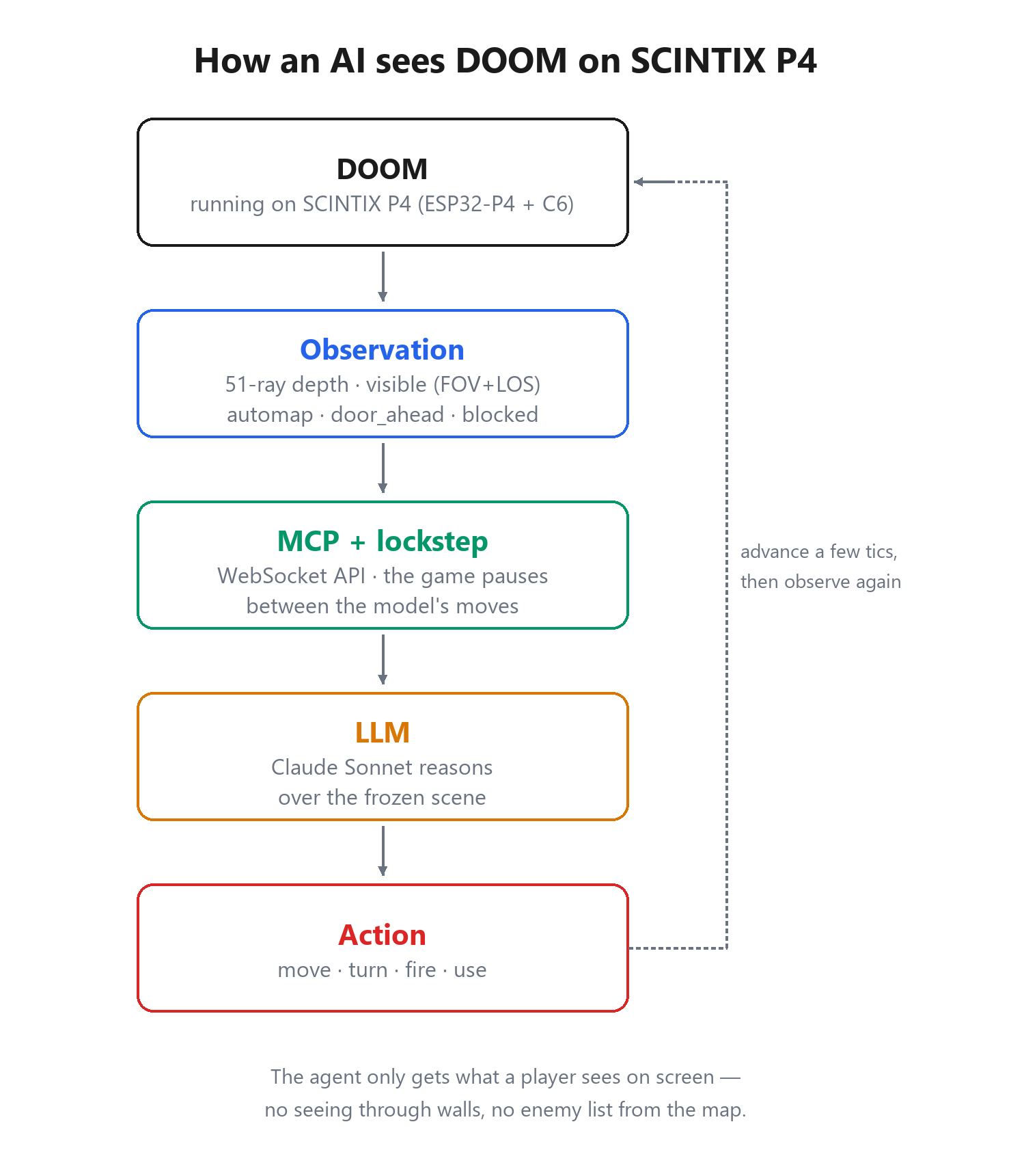

Letting an AI play. The interesting part isn't DOOM — it's how the model drives it. The firmware runs the game in lockstep: the agent sends an action, the game advances a few tics, and it gets back a structured observation, then the game pauses until the next move. A tiny MCP server wraps this so any MCP-capable client (Claude Code, etc.) can register the game as a set of tools — observe, move_forward, turn_left/right, fire, use, get_map — and just play.
Teaching it to see, honestly. The whole point is that the model gets only what a player sees on the screen — no cheating:
- a 51-ray depth fan across the field of view (the "depth" of the rendered image), so it can judge distance and spot openings;
- visible things — only enemies/items on-screen and in line of sight, left-to-right, never through walls;
- an ASCII automap showing just the walls it has already discovered (like the in-game map);
- door_ahead — a closed door in view (so a re-shut door reads as "press use again," not a solid wall) — and blocked — your last move made no progress.
The bug that mattered. Early on the model kept swapping left and right. The reported bearings were sign-inverted relative to the docs, and the facing angle didn't match the map. We made positive = right everywhere and turned the heading into a compass aligned with the north-up automap — after that it navigates instead of headbutting walls. We also learned the movement looks "jerky" on purpose: lockstep pauses the game between the model's moves, so the marine moves in little bursts.

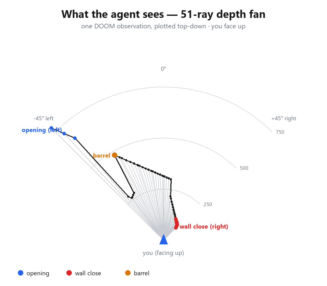

    The hard part wasn't the plumbing, it was the perception. The model gets only what a human sees on the screen — no reading enemy positions out of the map, no seeing through walls. Concretely, each observation carries: a fan of raycast wall distances across the field of view (the "depth" of the rendered image); the things actually on-screen and in line of sight, ordered left to right; an ASCII automap showing only the walls it has already discovered; and two hints — door_ahead (a closed door in view) and blocked (your last move made no progress).
    We started with a coarse 7-ray depth fan, and the agent kept walking into things — doorways and wall edges fell between the rays and were simply invisible. Bumping it to 51 rays across the field of view made the world legible: a ray suddenly much longer than its neighbours is an opening.
    The bug that taught us the most: the agent kept swapping left and right. It turned out our reported bearings were sign-inverted relative to the docs, and the facing angle used a different convention than the map. Once we made positive = right everywhere (things, walls, doors) and turned the heading into a compass aligned with the north-up automap, it stopped headbutting walls and started navigating. door_ahead got the same care — it points at the centre of a door, and reappears as "press use again" when a door has re-shut, instead of being mistaken for a solid wall. blocked was reworked too, projecting movement onto the facing axis so that sliding sideways along a wall still counts as "not getting where I'm pointing."
