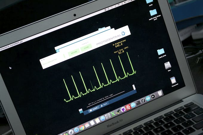

What we are now interested in is the distance between two R peaks in a continuously displayed or recorded ECG measurement. The time it takes for the heart to produce two consecutive R peaks is known as the R-R interval and which is of significance for HRV studies.
