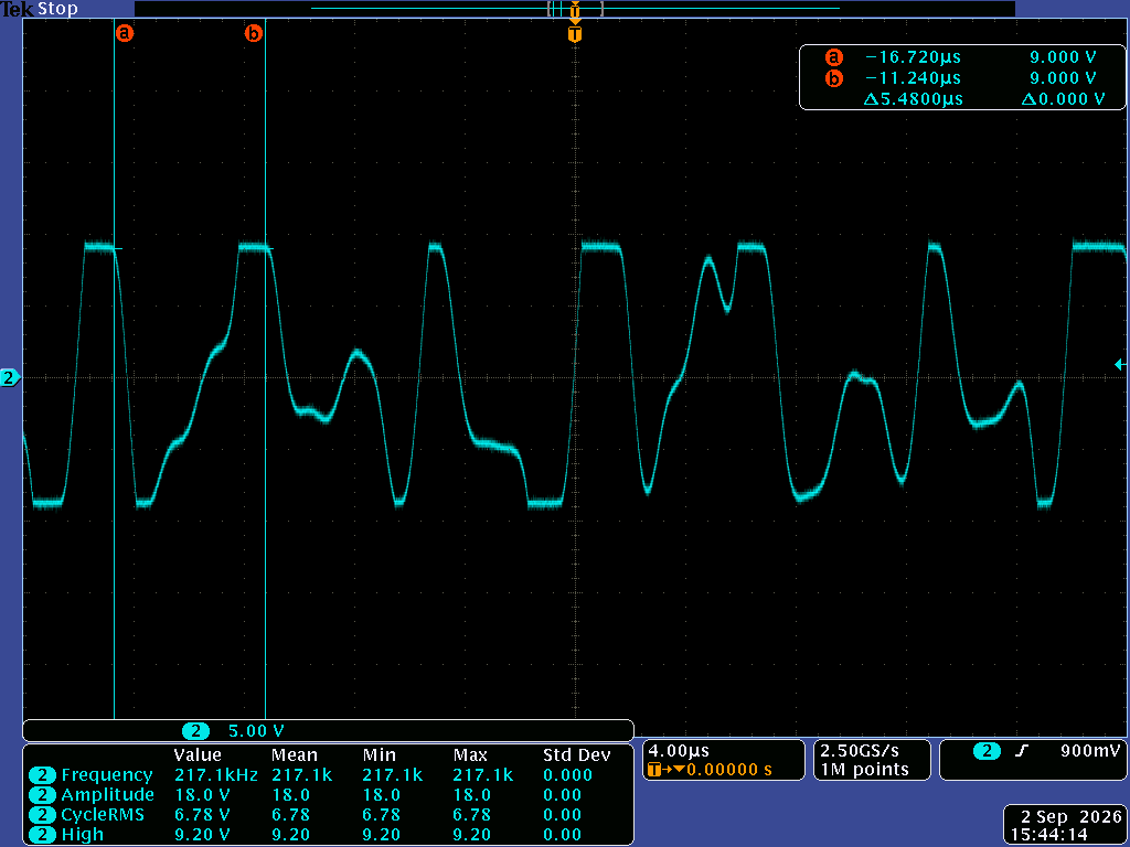

    2. A CT can also function as a transformer and impress a voltage on the secondary proportionate to the number of turns. This occurs with AC noise on the open primary, and is usually sourced from the inverter or charger (in that order). The resulting RMS value on the Sense(+) node can be substantial and will materially reduce the sensitivity of the integrator. C108 functions as a simple low-pass filter to reduce the noise profile to a level that maintains an adequate noise margin.
      1. The above trace shows the amplitude of the noise pickup on the unconnected secondary of the CT installed on my system's grounding conductor. The peaks are clamped by the zener diodes embeded with the CT.

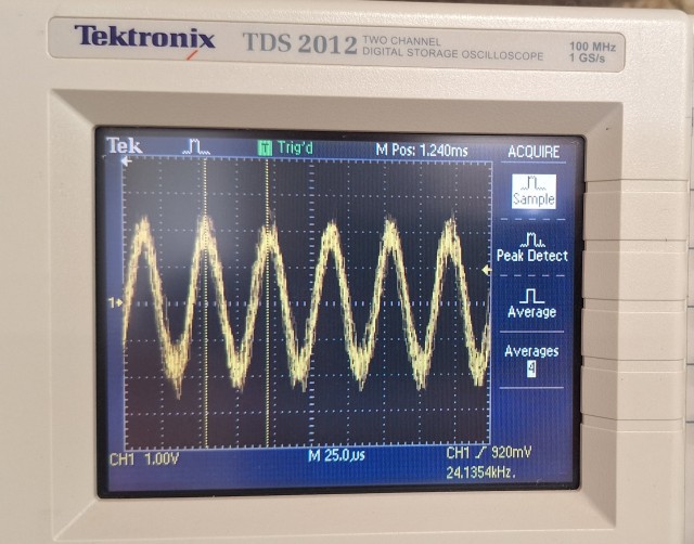

      2. This trace shows the injected 24kHz signal with low-pass filter C108. This image was taken in the operating system with the inverter supporting a 3kW load.
    3. C108, D105, and D106 are deliberately embedded at the current transformer to minimize the current loop & noise footprint.
