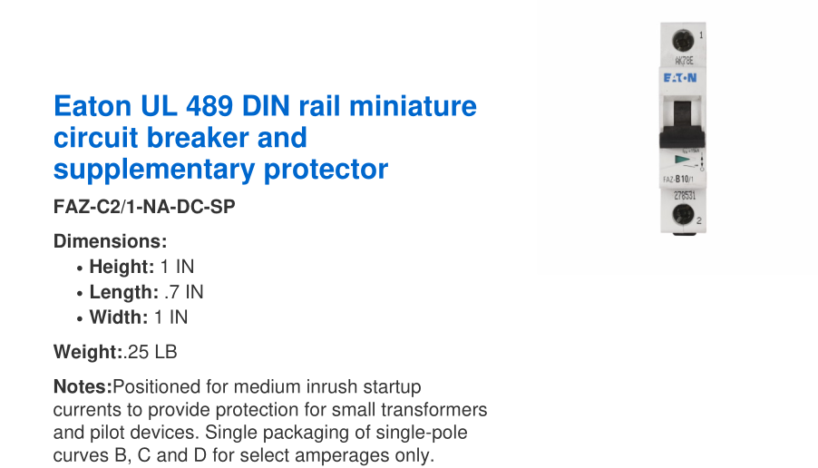

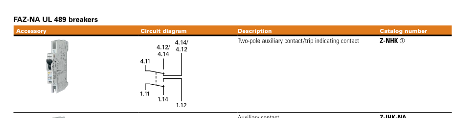

A safe rapid shutdown requires disconnecting the DC energy sources, typically the battery & charger, so the opening of two low-voltage circuits is required. This can be accomplished using a ganged DC circuit breaker or by electronic means.
Ganged DC circuit breaker This method implements a DC circuit breaker rated for a few amps and ganged to an auxiliary contact unit (the breaker must havean interrupt rating of 10kA or higher). The breaker is placed between the grounding pole of the battery bus bar and the grounding conductor.
An example from Eaton is their UL 489 DIN rail solution for a cost of ~ $170.
