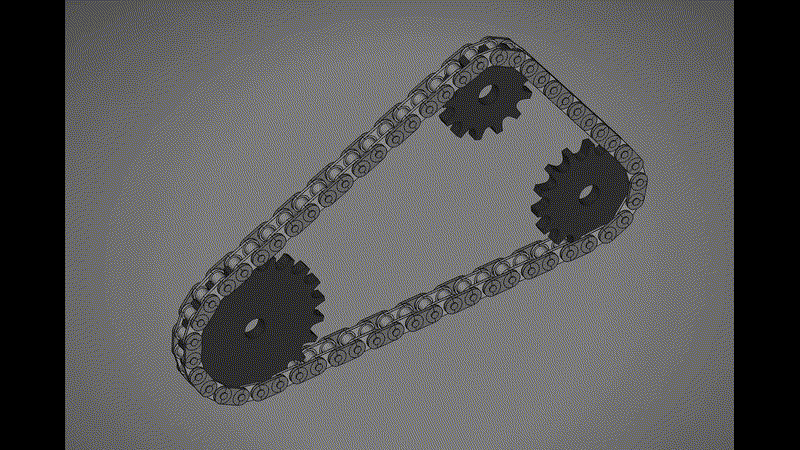

The plan is to create a simulated FreeCAD model so that all the geometry can be checked before going ahead into the fabrication stage. Parts will be made and arranged by means of Python macros created with the help of an LLM. So far so good.
  • Testing Macro Drawings
    GOAT INDUSTRIESan hour ago 0 comments
    First Macro drawing for FreeCad is just to check it can be done easily. It works. Here is the first Macro:

    doc_name = "Chain_Sprocket_13T_15T_Simulation"
    doc = App.newDocument(doc_name)
    # --- 1. System Parameters ---
    t1 = 13 # Left Sprocket Teeth
    t2 = 15 # Right Sprocket Teeth
    pitch = 9.525
    roller_diameter = 6.35
    bore_diameter = 10.0
    plate_thickness = 5.3
    num_links = 32 # Increased chain length to accommodate larger sprocket
    # Chain Link Specs
    inner_width = 5.72
    pin_diameter = 3.28
    link_plate_thickness = 1.3
    # Calculated Radii
    R1 = pitch / (2 * math.sin(math.pi / t1))
    R2 = pitch / (2 * math.sin(math.pi / t2))
    root1 = R1 - (roller_diameter / 2.0)
    root2 = R2 - (roller_diameter / 2.0)
    # --- 2. Iterative Solver for Exact Center Distance (C) ---
    # A closed chain requires a geometrically perfect loop length.
    L_target = num_links * pitch
    C = 85.0 # Initial guess
    for _ in range(50): # Newton-Raphson method for exact distance
        theta = math.asin((R2 - R1) / C)
        L_calc = 2 * C * math.cos(theta) + R1 * (math.pi - 2*theta) + R2 * (math.pi + 2*theta)
        C -= (L_calc - L_target) / (2 * math.cos(theta))
    # Final Path Geometry Variables
    L_str = C * math.cos(theta)
    L_arc1 = R1 * (math.pi - 2 * theta)
    L_arc2 = R2 * (math.pi + 2 * theta)
    L_total = L_arc1 + L_arc2 + 2 * L_str
