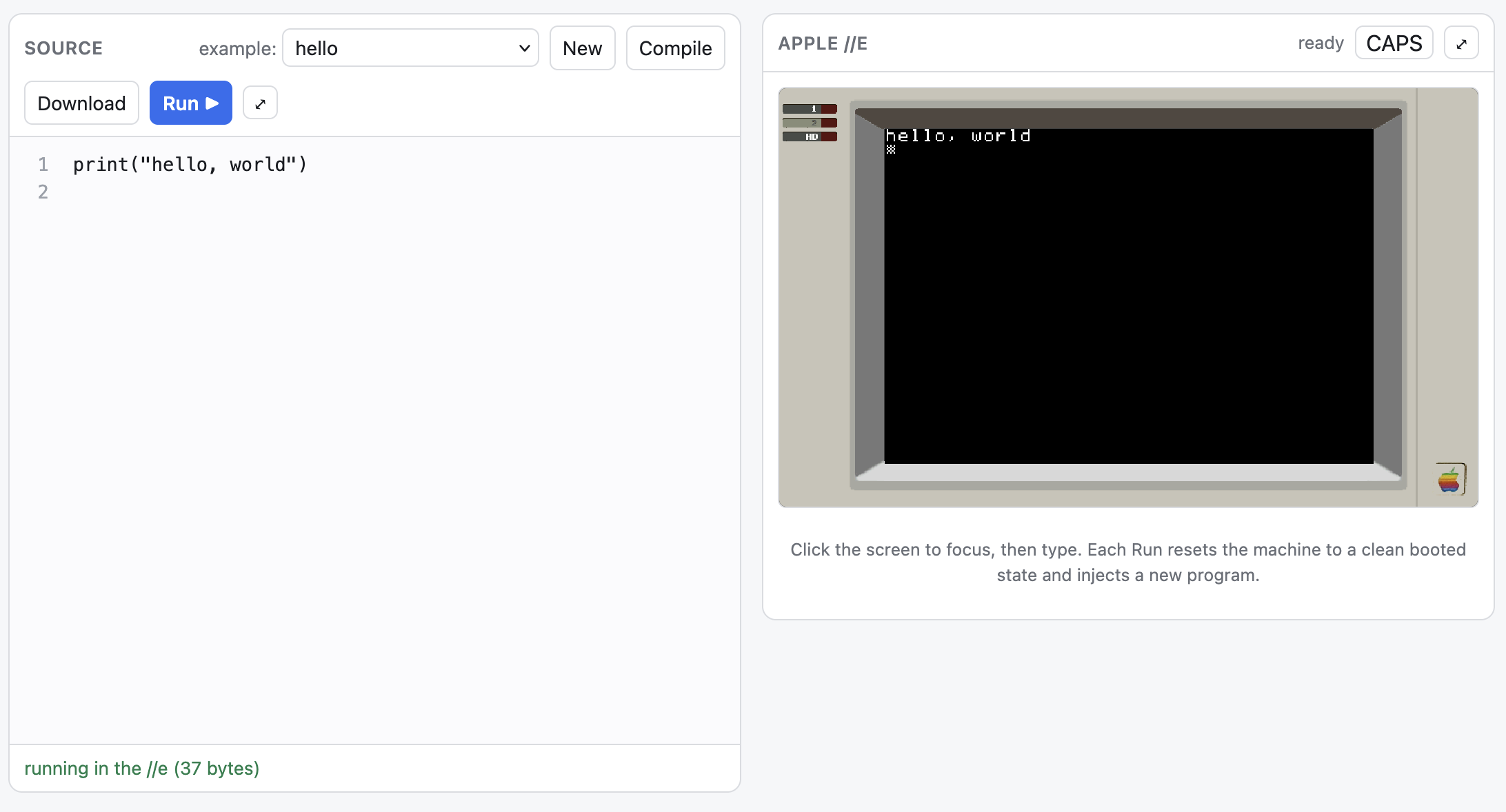

    So I've built on her work, bringing it to everyone in a simple, usable medium: the web.
    lua2e.k8s.jorj.org - the Lua2e playground
    Write LUA on the left, see it run in my 2e emulator on the right.
    I've included all of the example code that exists in her archive; go ahead and play the Snake game she fretted about wasting her time in her kitchen, or play the full port of the Integer Basic game AppleTrek, which stretches to use her full memory model that uses a RAM expansion card as-built. You can see her editor running, as I finished it off; or, run the artifacts that I've built on top of the whole ecosystem.
    Since Ms. Albright was keen to show how this ecosystem was better than the p-System, I thought there might be no better way to do that than to port Wizardy I, written in Apple Pascal, to LUA. There's a disk image called "Proving Grounds" which shows the capability.
    I thought the Wizardry series was nice, but it was really the Ultima series that I loved to play. So I've also built an Ultima-like engine in LUA, and crafted a simple scenario called Chippewa Falls, WI in which you play Ms. Albright, buying computer parts to take them to her school. It's maybe a 15 minute game as-is, merely as a demonstration of what is possible here.
    My last piece of code is her last as well: her Editor lives in two places, both in the "examples" section (so you can see the code itself) and as a disk image (where you can see it actually saving and restoring disk files).
    Lastly: this whole page is, itself, a full Apple //e emulator. It's a WASM compiled version of Aiie, which has graduated from its original Teensy 4.1 embedded emulator build (still maintained!) and is now a full cross-platform desktop emulator, as well has having this web version for the Lua2e playground. Drop any .woz disk image on the web page and it will boot; or give the URL fragment your own web-based .WOZ disk image and it will load.

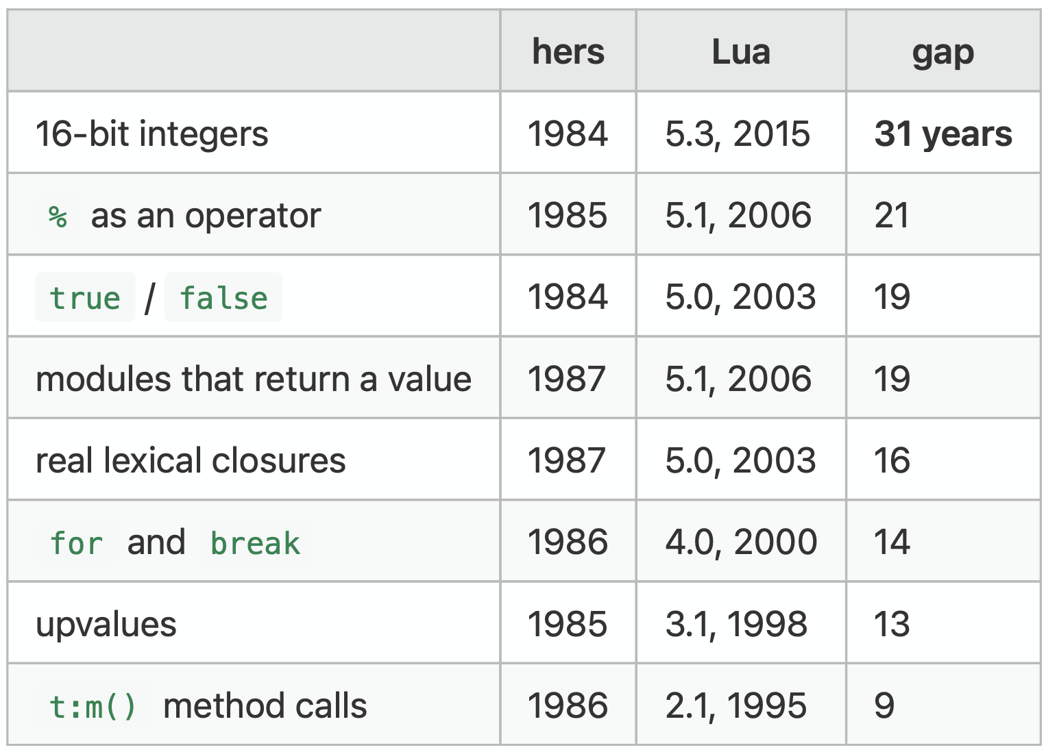

    By 1987 the language has for and break, table constructors, multiple assignment, t.x, t[k], t:m(), string escapes, real lexical closures, and arequire that hands you back a module. The compiler is 42KB of its own language and compiles itself - in a little over two hours at 1 MHz.
    So: is it Lua? Here is the comparison. You are free to make your own determination; it cuts both ways.
    Where she is ahead, with the Lua release that eventually got there:
    Plus, of course, self-hosting - which Lua has never had. Its compiler is C and always has been.
    Where she never arrives at all: repeat until, multiple return values, varargs, metatables, coroutines, floating point. All of those are in Lua, most of them from the first release.
    So I think this is not a story about someone who invented Lua nine years early. It is a story about someone who invented a different language, which I find much more interesting.
    And the unflattering reading deserves to be said out loud, because it is at least half correct.
    Several of the things she reaches early are forced by the environment she lives in.
    Integers because the 6502 has no FPU.
    No globals because there is no global table to put them in.
    One return value because the return protocol carries only one cell.
    I'd posit that constraint is doing a great deal of the work that looks, from outside, like foresight. But you're free to have your own opinions on the matter; art is in the eye of the beholder.

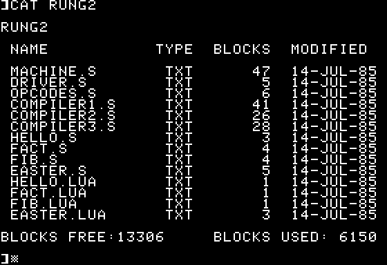

    Back to the Future opened on the third of July, 1985. The first compiler on this drive is stamped the eighth.
    She saw the movie, or she didn't. Five days later she started writing a compiler by hand, in her own bytecode, because that is still the only thing the machine runs. And when files start coming out the other side of it, they have a new name:
    Dot L U A.
    Now, I know what you're thinking. You're doing some mental arithmetic.
    The language you are thinking of was written in 1993, in Rio de Janeiro, by three very different people. The scholarly consensus here, which is to say me, alone, in a garage, has decided that this is purely a coincidence, for her name is Louise Ursula Albright.
    She spends three more weekends on this, and boy, does this become even more interesting.
    By this point, I'm really in to it. Late nights. Early mornings. Lunch breaks. Whenever I can find time to tear apart some of what she's done, I'm captive to her song.
    In August 1985 the compiler is rewritten in its own language as a single .LUA source file. The hand-assembled compiler is used exactly one more time, on the //e, to translate that source into bytecode. After that, the compiler compiles its own source, and what comes out is byte-for-byte what the hand compiler produced.
    4,202 bytes in. 4,202 bytes out. A shining piccolo in the vast array of kettle drums.

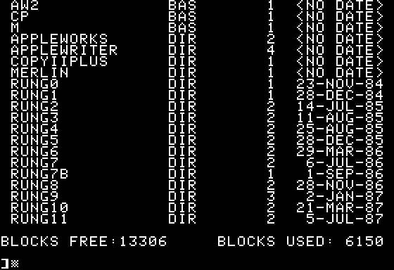

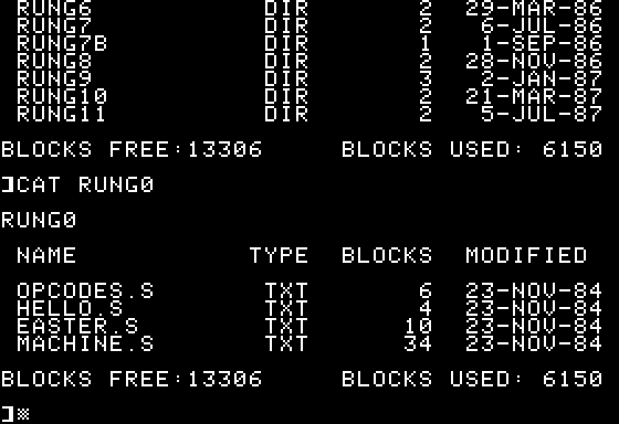

    Louise Albright did not call these rungs. She did not call them anything. It was me that painstakingly separated the files and reconstructed the narrative of what got built when; this is the organizational pattern that my brain applied to her data. Treat it accordingly.

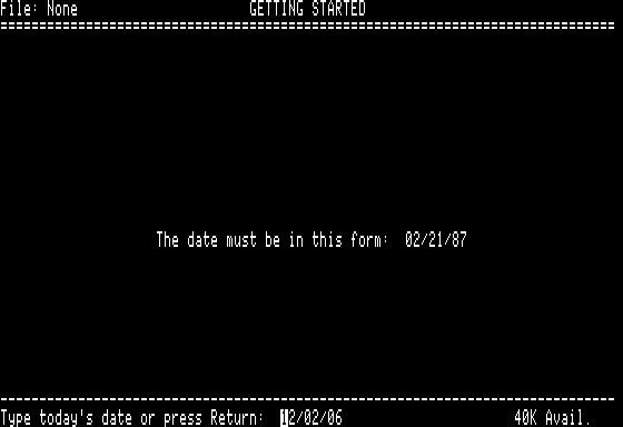

    In large part, I am the benefactor of her decision to buy a clock card. No, the Apple //e had no built-in clock; it had no way to, by default, timestamp files. Some programs asked you when you entered them what time and date it was.
    Others just blindly accepted that they had no idea.
    From what I see, I'm pretty sure she had a clock card. There's a fairly consistent set of dates, that play out a tune if you know how to look for the melody.
    Thanksgiving. Christmas break. Summer. Spring break. Labor Day weekend. Thanksgiving. Christmas break. Not one of them falls during a term. She built the entire thing on school vacations.
    The next rung is Christmas break, 1984, and its two outputs print like this:

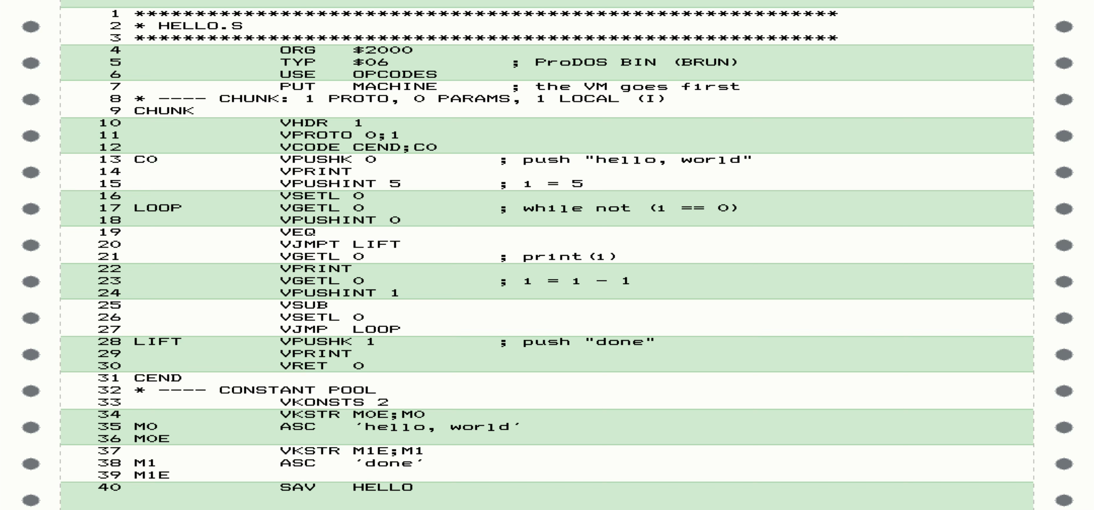

    So, back to what's in the drive image: the myriad .S assembly files were, at first blush, not particularly interesting.
    With Merlin already on the disk, and a bunch of .S files strewn around, there's nothing particularly interesting here. Yes, it's a bunch of assembly.
    ... for those that know 6502, that's all rather droll. She had something to do, did it, and I couldn't really care less about how. Not yet, at least.
    But once I looked at HELLO.S, I became... curious.
    Those are not traditional opcodes. What the heck *is* this? The 6502 has 56 instructions, which some of you will recognize on sight. Not one of those 56 is in this program.
    The trick, of course, is on line 6 where she does `USE OPCODES` - a set of macro definitions that still don't mean anything to me; then line 7, the `PUT MACHINE` is an include of the entire MACHINE.S listing.
    Wait a minute.
    She wrote a virtual machine.
    VM technology had existed in this form since the 1960s, and she wrote one in 1984, on a machine with 128 kilobytes, over a long Thanksgiving weekend, as far as anybody can tell, for fun.
    For those of you that did not make a face and smell the smoke when I talked about the RIFA caps: this is not the kind of virtual machine you're thinking of. That kind is backed by a gargantuan vendor product. This is the kind that pretends to be a processor that does not exist, so you can write code for the exact computer you wish you had.

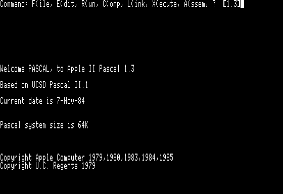

    To understand what Ms. Albright built in this drive image, you have to understand what she was reacting to.
    Pascal was designed by Niklaus Wirth in 1968 as a teaching language: strong typing and structure, deliberately forcing a programmer to think systematically about a program rather than just making it work. It was aimed squarely at two anti-patterns of the day, FORTRAN and BASIC goto-spaghetti, and the assembly and COBOL "just execute these instructions" style.
    Then UCSD had a problem. Computing work was being done on the university's big expensive central machines, while students increasingly had access to cheap microcomputers, and every microcomputer had a different processor and architecture.
    Ken Bowles's answer, in 1977, is the thing this whole project jives with: do not compile to machine-specific code. Compile to an abstract P-code, and build a virtual machine for it on each platform. In 1979 Apple shipped Apple Pascal and made it the language of the platform, and in 1984 the College Board made Pascal the AP Computer Science language, which is how it ended up in her classroom five periods a day.
    So why the hate? The p-System was a complete contained development environment: OS, editor, compiler, runtime, debugger, file management, utilities. The language was verbose and formal. The environment was heavy and difficult to work with from outside.
    You were either in Pascal, or you were outside of it. Working between the Pascal environment and the established ProDOS environment was truly messy.
    I worked in Apple Pascal once - the summer of 1985, just as Back to the Future hit theaters - and one of the reasons I loved that movie so much was that it helped me escape from it.

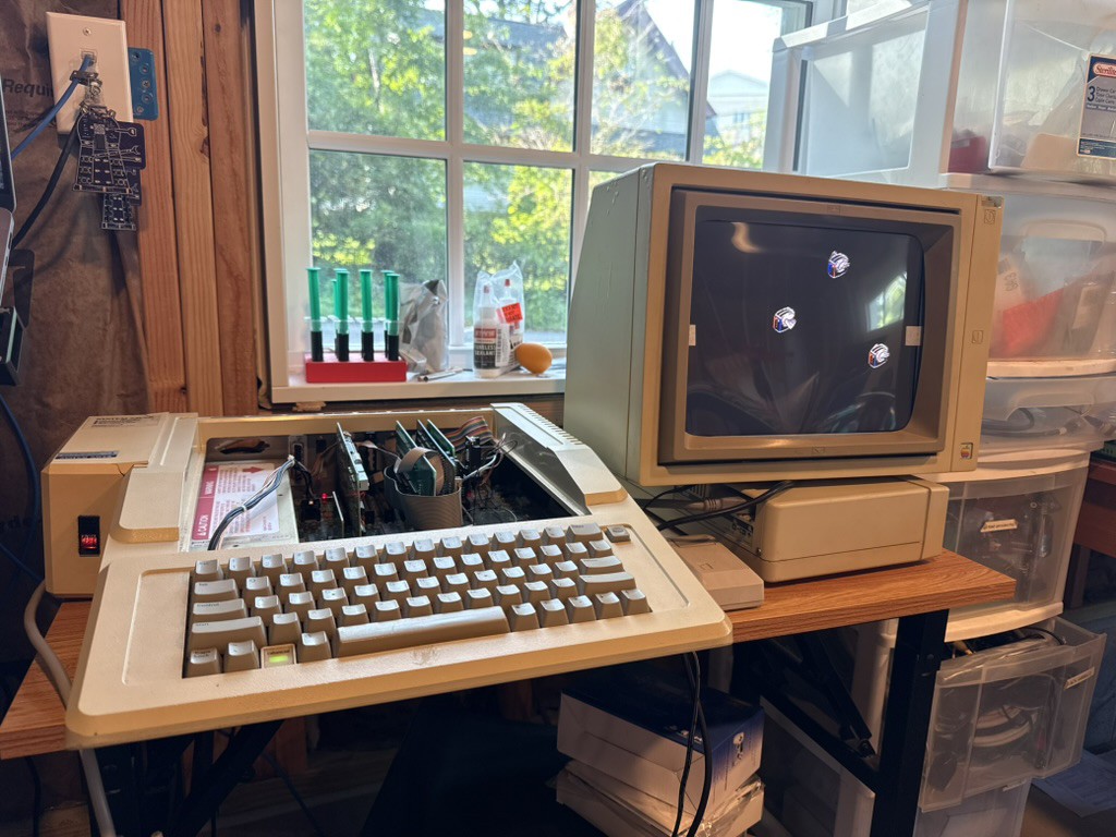

    So, 2026 comes around. I'm building a new workshop, moving old things out of storage, sorting stuff, picking up old projects along the way.
    And this is really the first time I spent any time at all looking at what was actually *in* that hard drive image.

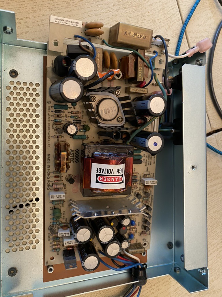

    The ProFile itself has failed; a capacitor on its logic board is probably shorted, and that's now another future problem. And the interface card needs its own repair saga... this story isn't about the hardware any more from this point on. It's about a hard drive image.

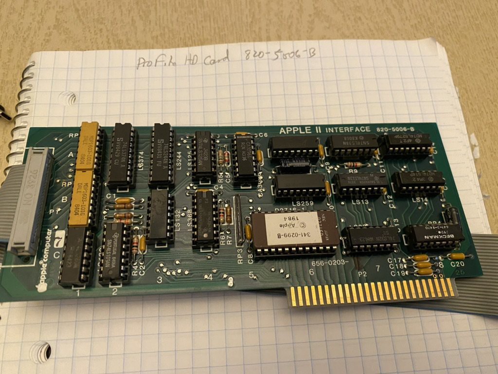

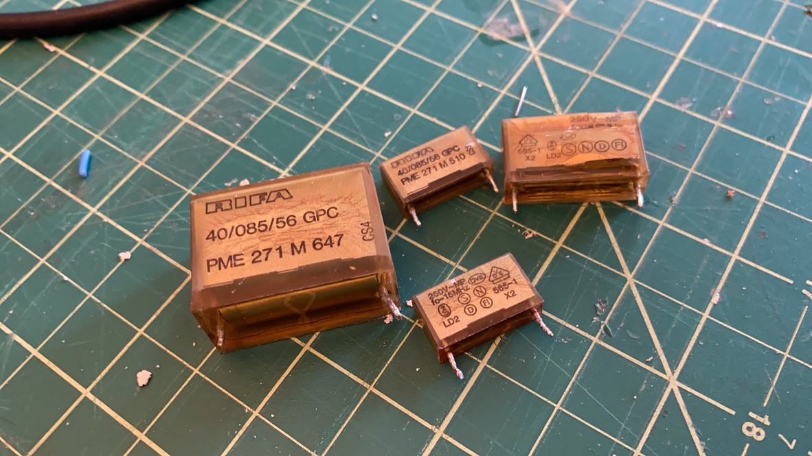

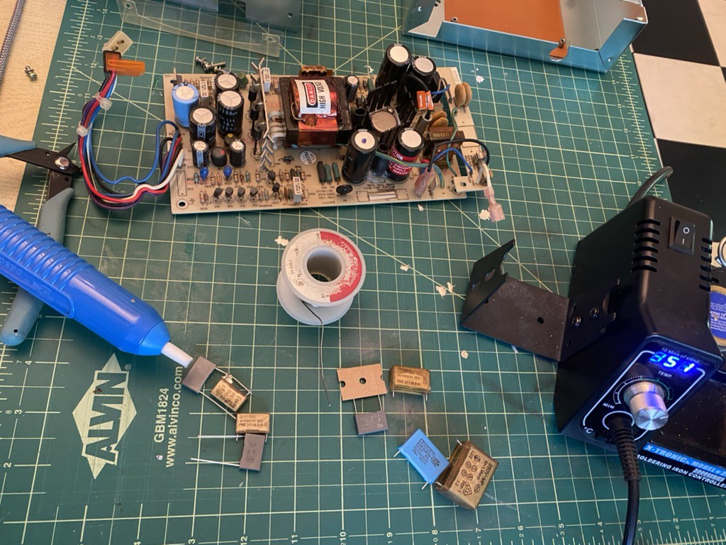

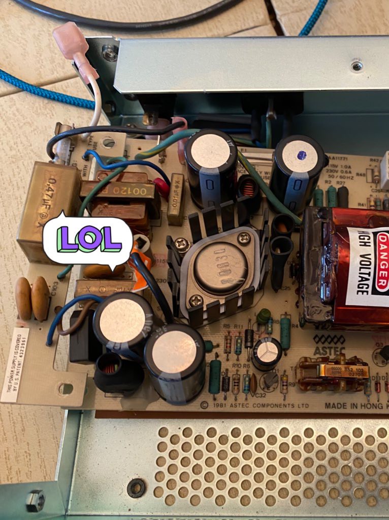

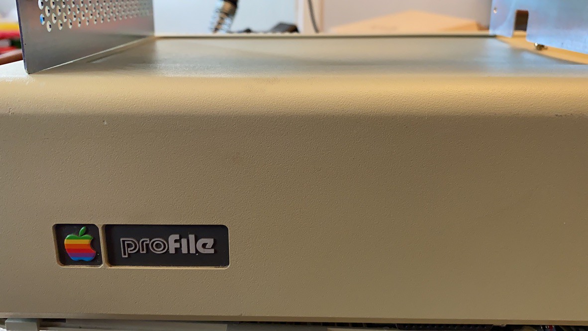

    The ProFile was Apple's first hard drive. Released in 1981, the WHOPPING 5MB version - targeted at the Apple /// - came in at about $3,500. The 10MB successor was more like $3,999 - roughly $17,000 in 2026 money, or about a tenth of a teacher's salary in 1984. Keep that in mind for the rest of this story; it will matter, later.

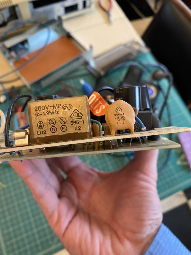

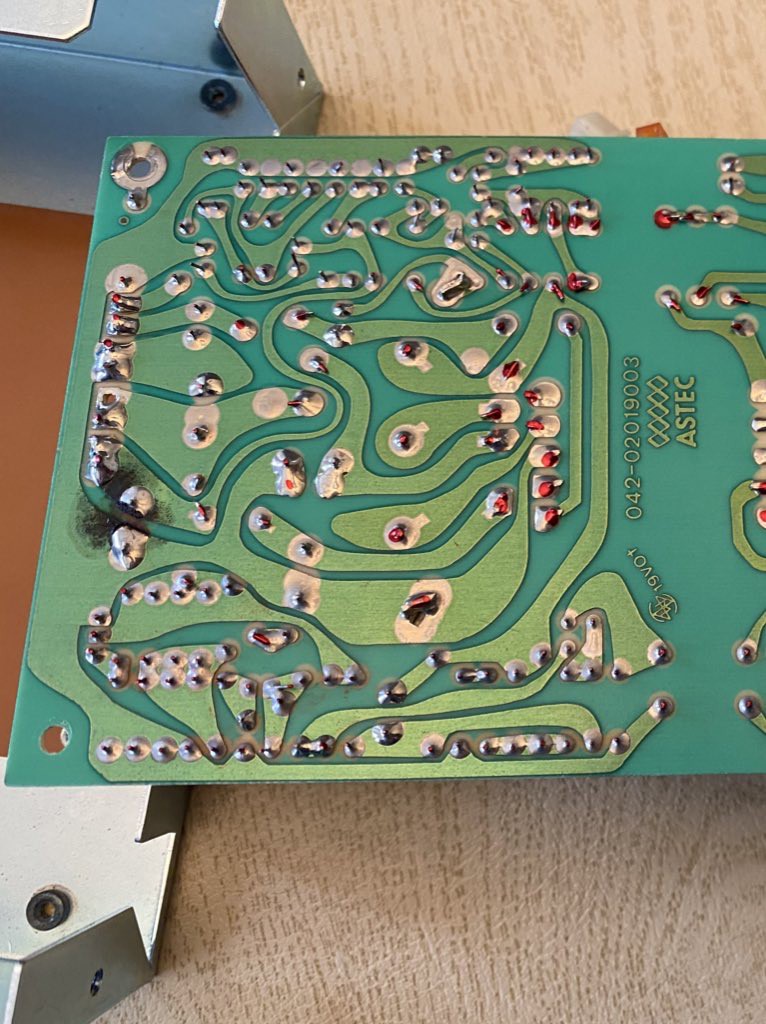

    So after cleaning it all up, giving it a quick visual inspection, and deciding it was time to power on the beast, it did something it had been waiting for 40 years to do.
    It let out the magic smoke.
    Now, I'm sure most of you reading this just made a face. And can smell the smell of those RIFAs. For everyone else: these are line filter capacitors, which, over time, crack, take on moisture, and eventually release a quantity of smoke that has been waiting since 1983 to leave. No explosion; more of a resignation. We're done.
    So I replaced them, of course.
    The sheer quantity of pictures I have of what should have been a terribly boring exercise should tell you something about my state of mind. This was not just something to keep me occupied; every facet of it was like an archaeological dig.
    And in the end, it worked! Which is to say, it powered up. Because it didn't actually work, which is worse: a thing that is dead, is a project. A thing that almost works is a time sink.
    Now, the thing hanging off the back is another project here, that I documented at the time - the ProFile 10 Teensy-based reader. The Apple itself wouldn't read it, spitting out a variety of error messages like this:

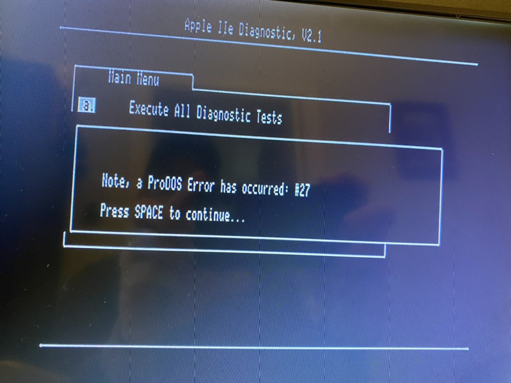

    ... not very helpful, so I split the problem in half. And the reader circuit told me which half was at fault - the drive itself clearly operated, so either the //e still had some problem or the interface card was an issue.
    The images I pulled off the drive went in to a folder to be forgotten for 5 years. The ProFile was prettily stacked with the rest of the //e, which got some use, but the ProFile was just for show. The interface card took up residence in an anti-static bag. And the rest of the pandemic played out around it.
