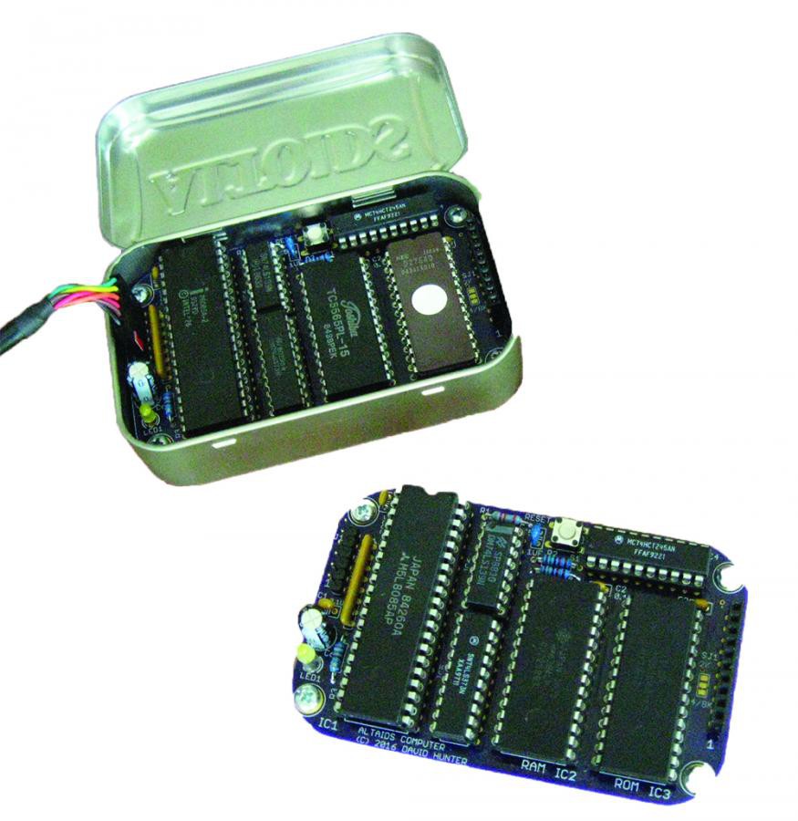

It is 50 years since the release of 8085 and tinyBASIC. Since I have some 8085 chips, I thought of making some simple and effective design.
There are many open source designs available online. Most of them uses many components which are not available now or having large area of board.
I was looking for something similar to Lee Hart's 1802 or Z80 design. I came across a similar design based on 8085 microprocessor.

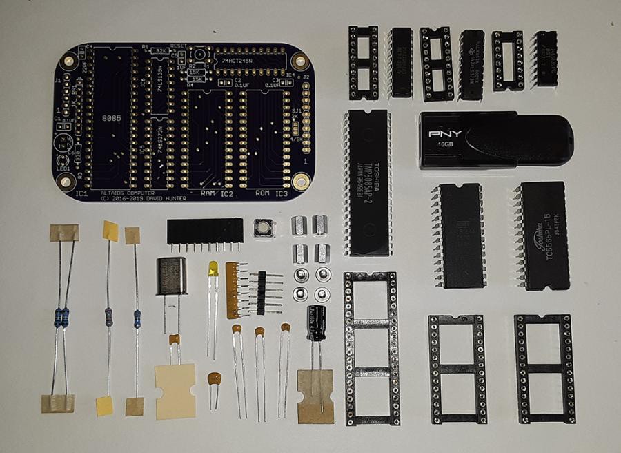

The board having only six ICs. Out of which three are just simple logic ICs.
There are only three main components in the design. Microprocessor, 8kB RAM and 8kB ROM. The computer operates at 4.9152MHz using external crystal. So it is very easy to make.
The good thing about this design is it comes with circuit, layout and monitor program. It fits into a Altoids tin. Due to small available space, the board was designed in four layers. But signals uses only TOP and BOTTOM layers and the inner two layers used as power planes which simplifies easy routing.
The technical article was published in march 2019 Nuts and Volts magazine. The 8085 computer was sold as a kit and currently not available.
As we see it uses very few components.
The assembled board looks like above picture.
It comes with inbuilt monitor program and tinyBASIC 1.0 with some additional commands.
