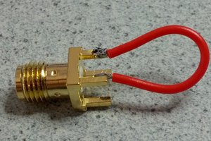

    On Saturday i swapped out the STM32F1 chip for the STM32F4 on a 95% built prototype board,  rather than scratch build a new one on the quick turn PCB's i'd gotten. All i had to do was carefully cut a couple of traces and put two 2.2uF caps on, i used a microscope and small knife to score away the traces. It's tougher than it seems, there are tools i've seen specific to that task, i've tried drills and snips etc, but this one was right a the leg of the IC.
    After cutting away the traces I added the two caps the STM32F4 needs, and some kynar wire, and booted it up, the JTAG didn't see it at first,  but seemed to be mostly an issue with the software side of things. A few unplugs and it worked fine.
    It ain't pretty but it worked. The blue kynar wires are going to the caps. The Red wire is because we hadn't built out the battery charger circuit on this board, since we weren't sure about the values, it was built on a separate PCB
