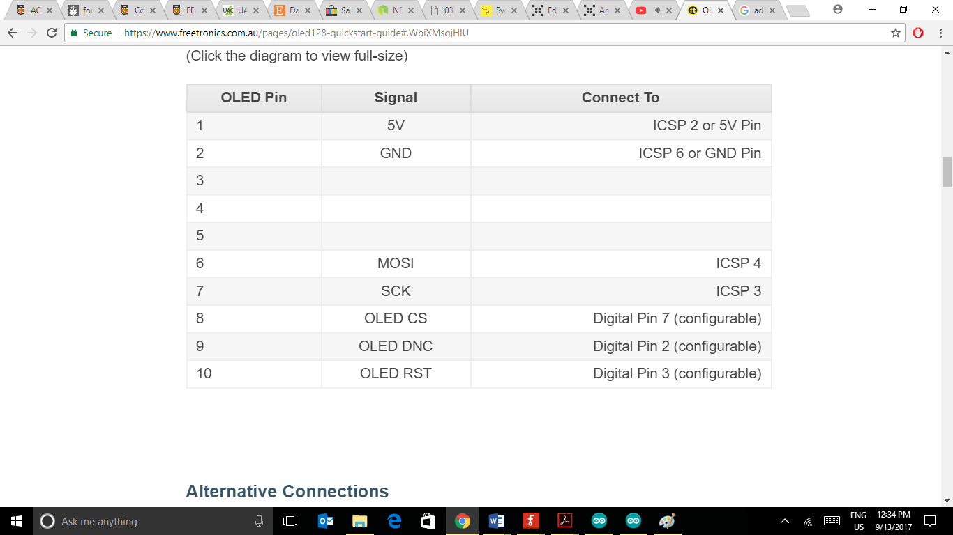

Libraries used:
FTOLED (Oled screen driver)
Austin Marandos
Derek Hahn
Anderson Antunes
So I've been working on a similar project. I recommend checking out crystalfontz. They have a color lcd for $5 that will take your display current from 14ma to 1mA. They even have an arduino library (havent tryed it yet, getting my parts this week) The issue you would run into is you would need to switch to 3.3V (with and buck or ldo regulator off the lipo).
