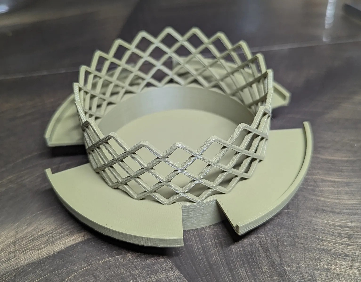

So, I had designed a 3d printed object that had a large, unsupported horizontal brim, and I needed to make a bunch of them.
I was happy with the overall design, but wanted to brainstorm ways to split it up or otherwise avoid having to support the overhangs. At first, I was trying to think of some way to split it and make the 2 parts screw together, or something like that.

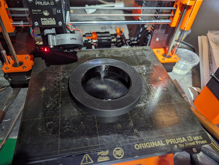

But then, The Idea hit. What if I designed a separate object that I could slip over the bottom, and print the horizontal brim onto?

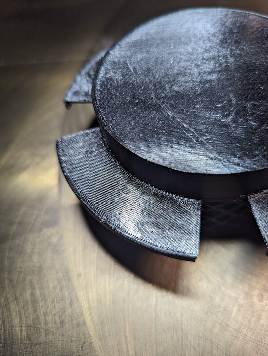

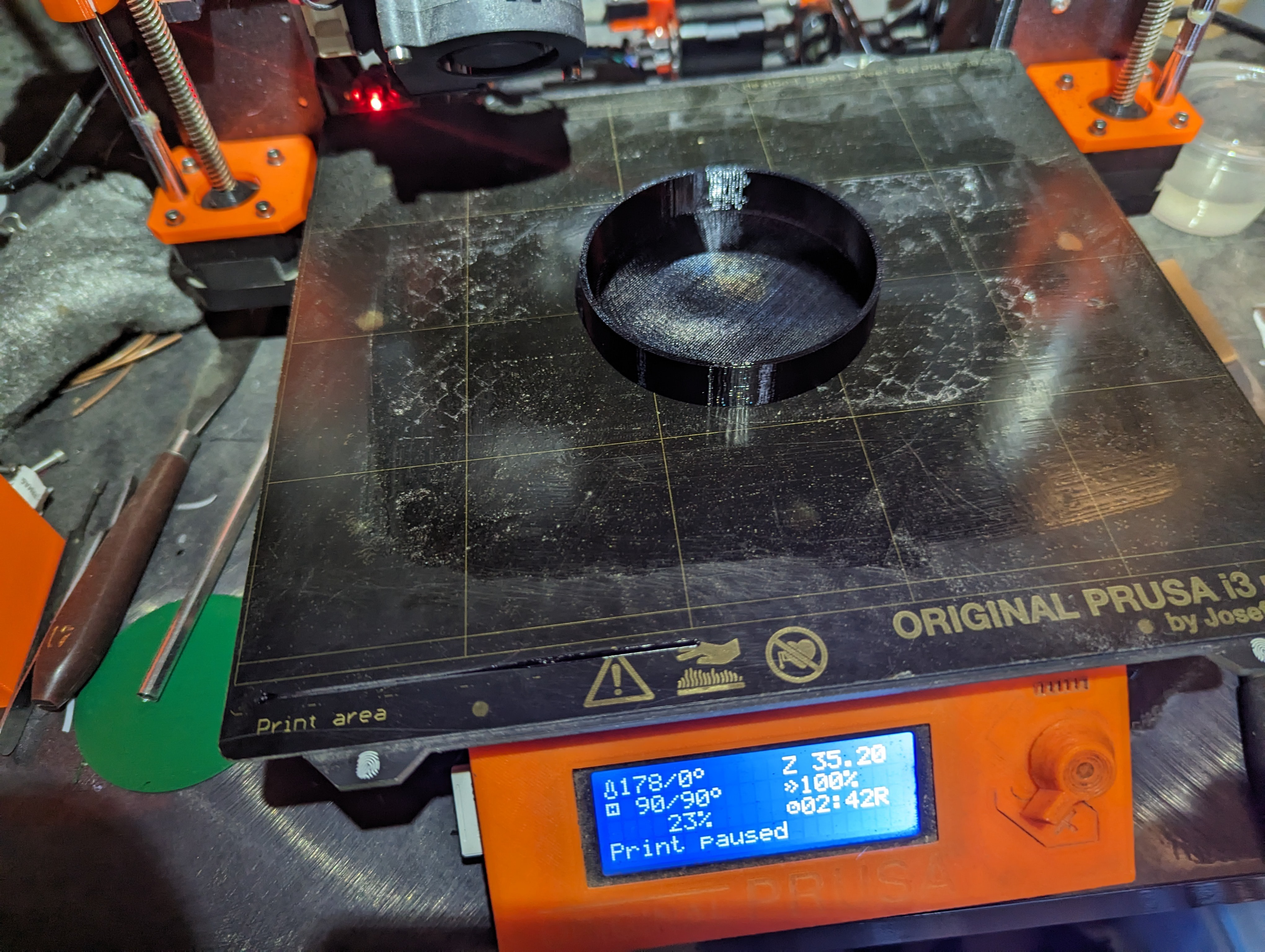

The overhang has a pretty decent surface finish. Not perfect, but better than you get with normal supports So I had successfully printed one piece, and was feeling confident and fired up another print. Once it got to the point where it pauses to let me add the support, I grabbed the support and tried to slip it over... only to find the support piece no longer fits over the base.
That brings us to problem #2 - the heated bed had partially annealed the ht-pla support part, causing it to shrink slightly in the x/y axes (and grow a bit in the z axis). I had designed it to be a pretty tight fit, so that slight bit of shrinkage made it difficult-to-impossible to slide it over the partially printed part.
So I scrapped that print, took some careful measurements of the annealed ht-pla support piece, and printed a new support part, with slightly adjusted dimensions, to try and account for the x/y shrinkage and z growth, and then pre-annealed the part. The annealed part was pretty close to the final dimensions I was targeting, so I fired up another print and gave it a shot.
The fit wasn't *quite* right, although it was good enough to at least finish that print successfully. So at that point, I tweaked the dimensions of the actual target part just a smidge, to better fit with the existing support piece. And it was off to the races. I've been able to print 15-20 pieces since, using that same support piece.
