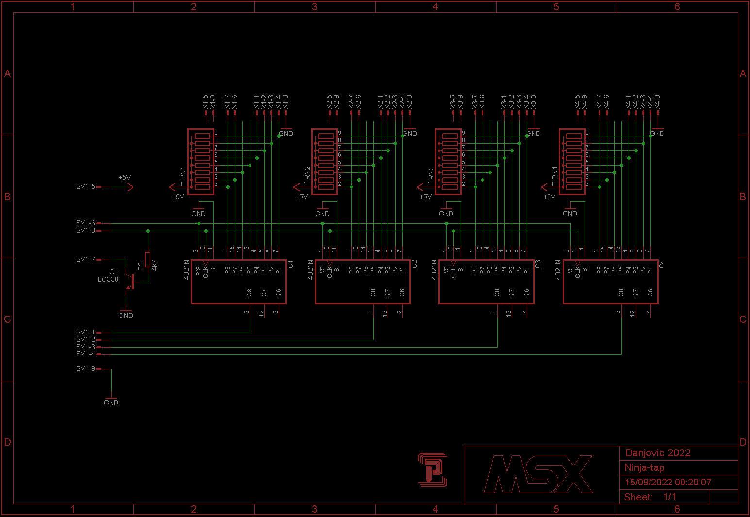

Keyboard Controller with Joystick for MSX
11/19/2022 at 10:49 • 0 commentsI have built the Atari 2600 controller keyboard DIY to develop an adapter and write a driver for MSX. The adapter aimed for simplicity but it does not provide any detection feature, requiring the user to without an action, either pressing a key or move the joystick to any direction, depending upon the peripheral connected on the joystick port.
If I give up the simplicity and add an Integrated Circuit and a bunch of diodes it is possible, though, to build an adapter that can support both the keyboard controller and a single button joystick, connected at the same time, using basically the same driver. And there's more: the joystick can still be read by Basic.
here's the circuit:
The rows of the keyboard connected at X2 are selected by the pins PULSE (8) and TRIGGER_B(7) (which is bidirectional). The default state of these pins are PULSE->0 and TRIGGER_B->1 which selects the common line of the joystick, thus allowing the single button joystick connected to X3 to be read using BASIC.
Detection is possible by Selecting the third keyboard ROW, then diode D5 will bring down the level on the TRIGGER_A line. The other keyboard rows will keep this line high.

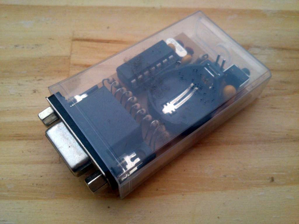

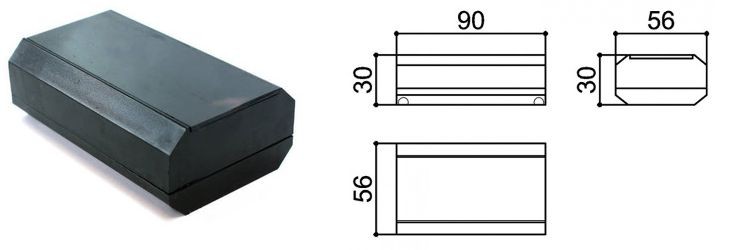

Shinobi Tap (3)
10/12/2022 at 17:45 • 0 commentsFinally managed to fit the circuit into the case. It was not even necessary to attach the board to the case using the standoffs.
Updated the Schematics and uploaded all to github page.

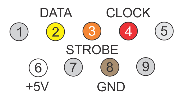

Shinobi Tap (2)

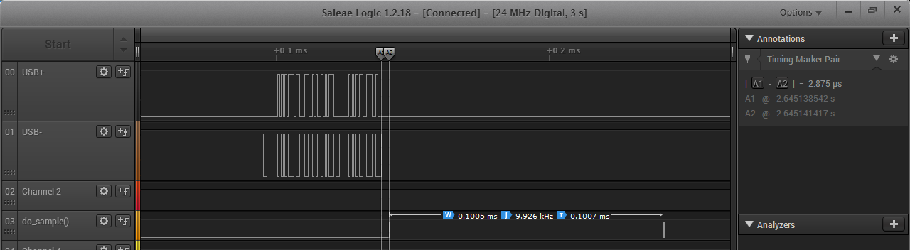

10/11/2022 at 04:45 • 0 commentsI have assembled a prototype for the shinobi tap and during the tests I came across a tricky problem: One of the famiclone controllers worked erratically when connected on position 1. All wiring was checked twice and it was OK.
Exchanged the port where the interface was connected and same results. Exchanged data wires from controllers 1 and 2 and same results.

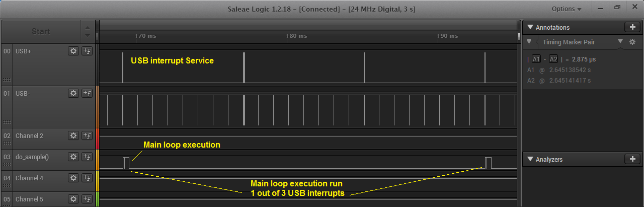

Observing the waveform on a scope it was noticed that the voltage briefly dropped when a button was pressed, instead of keeping low until the next clock pulse.
A closer observation on the waveform at the moment of a button press revealed the culprit: A short surge that happens when the voltage drops at the output and makes the clock ring. The same effect occurs with both controllers but only one of interpreted this as an extra clock.
On the other ports the ringing is barely noticed.
I was suspecting that the ringing was happening only on port 1 because of the proximity with a low impedance source (the electrolytic capacitor at the input). but some tests I have done later proved I was wrong.
I have tried without success:
- Added some capacitance to the Vcc line.
- Replace the VCC jumper wire with an inductor
- Added a 100 Ohms termination resistor on the pin 4 of the Port 1 (CLOCK)
- Add some resistance in series with the CLOCK out pin (3) of the HCT00
Later I noticed the the other controller (that works despite the ringing) produces the ringing when connected to ports 1 and 2 but not when connected to 3 and 4.
Another thing I have noticed is that when more than one controller had the same button pressed, the ringing was deeper and last a little longer.
Added a 100nf capacitor (value picked at random ) between CLOCK and the ground. This time the ringing disappear and the circuit worked despite the clock signals turned into triangles.
Then I have analyzed again the width of the clock pulse and the duration of the ringing to determine an RC constant to be added between the HC00 and the CLOCK line. The Clock signal takes 6us and the surge around 250ns.
Then I pick a 68 Ohm resistor and a 10nf capacitor to have a time constant of around 680us and added to the circuit, and now the ringing completely disappeared.
Wafeform of the ringing free clock signal
