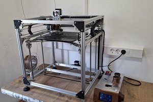

In this project, I make a big size 3d printer 400 x 400 x 400 mm for a collage project.

first, I made the whole model in software, a different part of the dimension of its part is attached in pdf which name is "dimension of parts"
a building of whole assembly for more reference see the YouTube video.

Oh wow, that's some really fine print quality! Good job!

Nice project! I like your heated bed solution.
