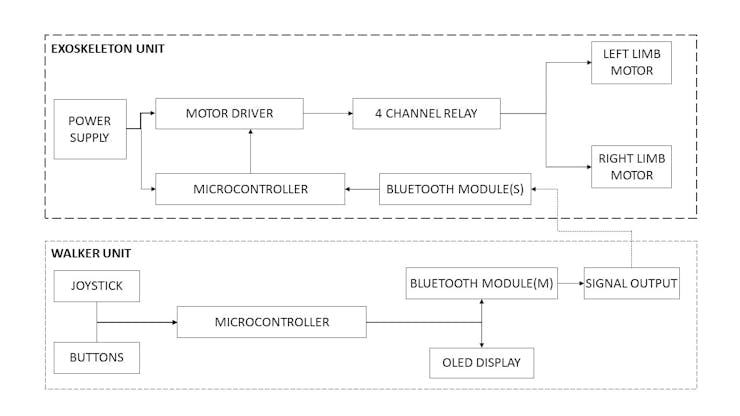

There are two parts in this project: 1 ) walker and 2) Exosuit system.
First, the walker has to be switched on and then the O-LED screen in the walker shows the menu to sit, stand, walk. The buttons can be used to select between different menus and joystick in the walker can be used to send signals for walking to Exosuit system. The entire system is communicated with paired Bluetooth.
You can refer to this block diagram:
Block diagram of entire system

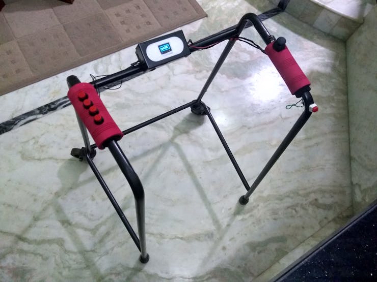

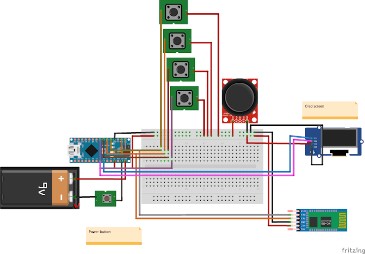

The Walker unit in this project uses an o-led screen for display, There are four buttons one for switching on the entire system other three are for selection of menu like walking, standing and sitting. Also there is an joystick connected to move forward and stop.
Also there is a Arduino Nano and a Bluetooth module to send signal to Exosuit system.
Connecting OLED with Arduino
Oled screen can be connected and we can display images. The Bmp file can be converted into Hex file and can be used in our code. You can refer this tutorial for understanding more about conversion of bmp file.
Images
Walker
Walker
Connection
Connect the components as shown in the schematic diagram
Arduino Nano OLED
GND ---------------------- GND
5V ---------------------- 5V
A5 ---------------------- SCL
A4 ---------------------- SDA
Arduino Nano HC-05( Bluetooth)
Rx ---------------------- Tx
Tx ---------------------- Rx
Arduino Nano Joystick module
A1 ---------------------- X pin
Arduino Nano Button
Pin2 ---------------------- Button 1
Pin 3 ---------------------- Button 2
Pin 4 ---------------------- Button 3
Pin 5 ---------------------- Button 4
Working (Walker)
The walker was made by cutting the front portion of normal walker and adding wheels in the two front legs.Holes for were made using drill machine. Grips were also added.
The Walker unit in this project uses an oled screen for display, There are four buttons one for switching on the entire system other three are for selection of menu like walking, standing and sitting. Also there is an joystick connected to move forward and stop.
walker working video

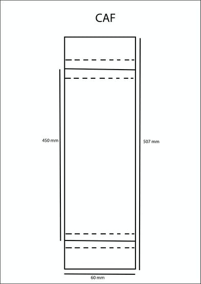

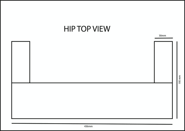

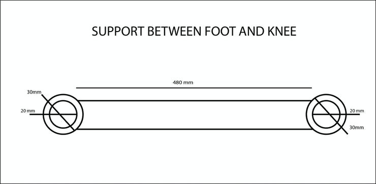

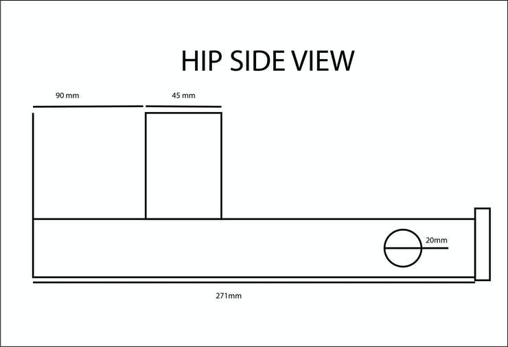

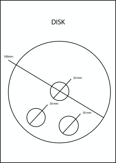

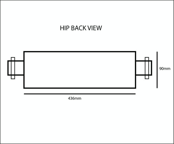

    Mechanical Structure fabrication and Assembly
    Refer the mechanical designs  provided and fabricate according to the dimensions provided, we used Iron sheets for fabrication. We are also working on Aluminum sheets which are light weight and strong .
    Mechanical Design
    The detailed design files are attached with this tutorial as CAD file.
    Fig 1. Diagram marking various parts of the exoskelton.
    Parts Description
    Parts Description
    Also refer to the below images to make the mechanical structure to be connected.
    The measurements and complete details are mentioned in the diagrams you can follow it and attach it together as seen in Fig 1.
    You can use  normal manufacturing techniques to replicate this design. You can also refer the Cad file to assemble all parts .
