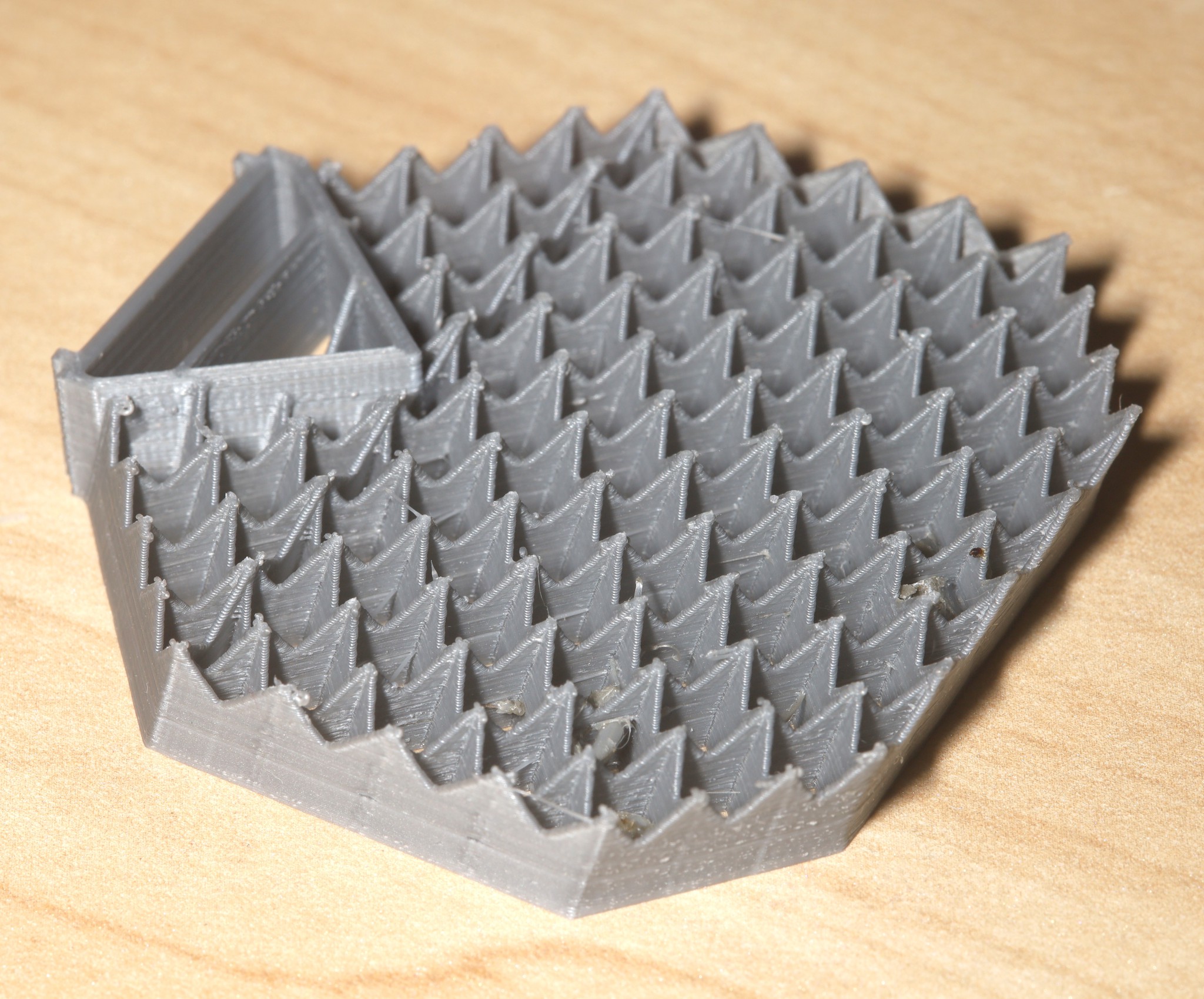

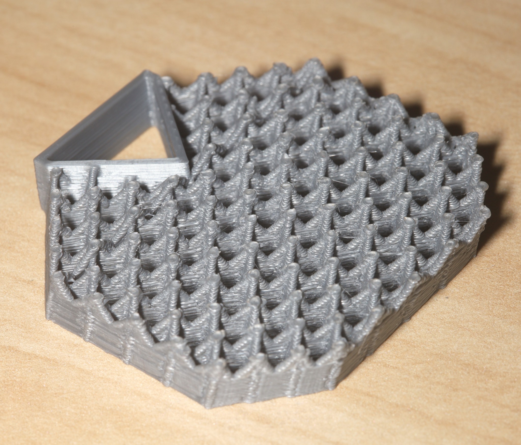

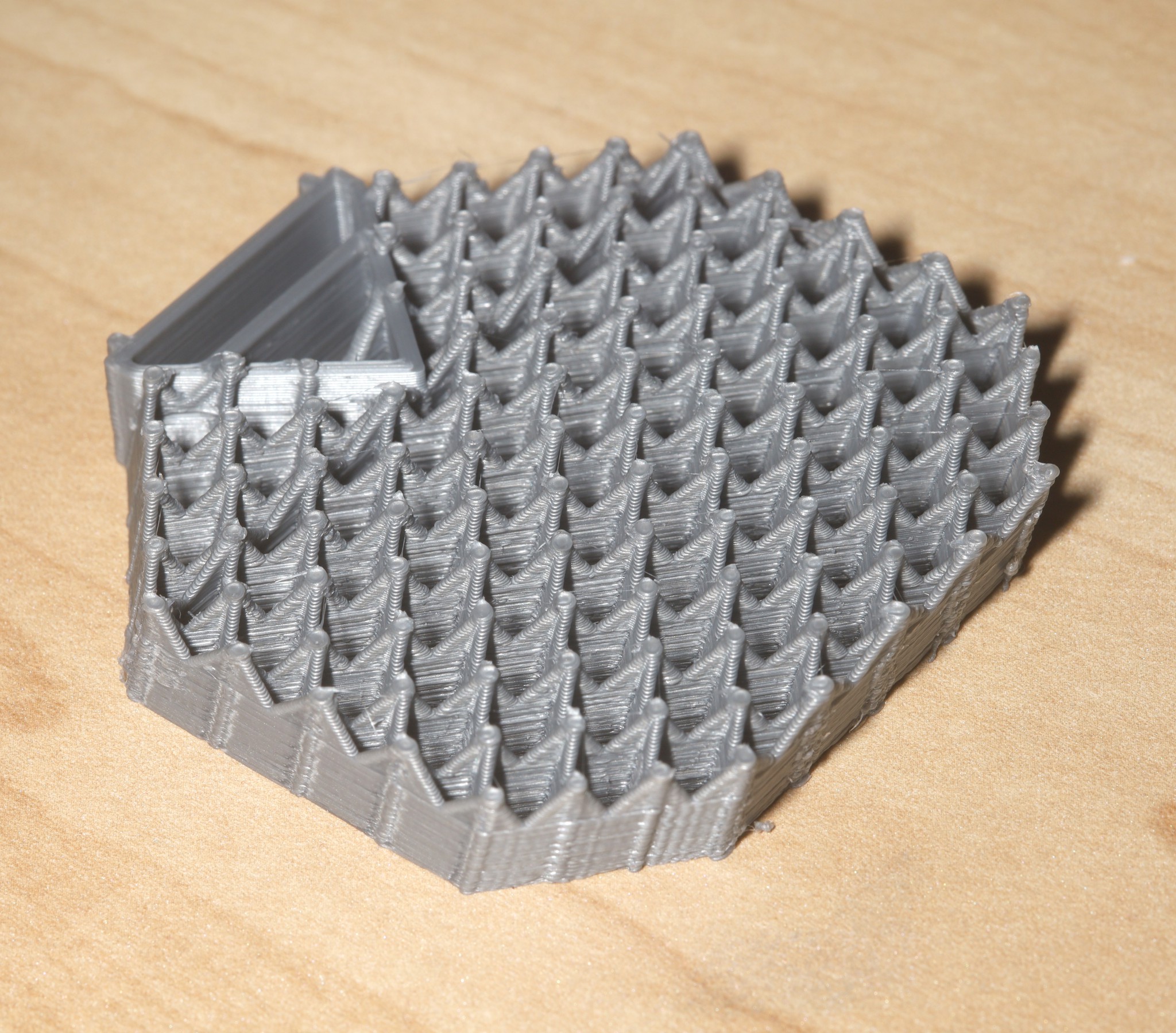

  • .3 line width from a .4 nozzle
    lion mclionhead05/12/2026 at 17:08 0 comments
    After much fussing with a .2 nozzle, it has been found that printing .3 line width from a .4 nozzle significantly clears up the results.  It doesn't require a nozzle change & it goes a lot faster than a .2 nozzle.  The lion kingdom's cheap .2 nozzles ended up having a persistent leak which couldn't be fixed.  The trick is to use a .2 layer height with the .3 line width.  The .2 nozzle required a .12 layer height.
    .4 nozzle .4 line width
    .4 nozzle .3 line width
    .2 nozzle .2 line width
    The ideal for this model would still be a .2 nozzle, but it would be expensive to solve the leaking.  It never could print walls thick enough for a structural part.

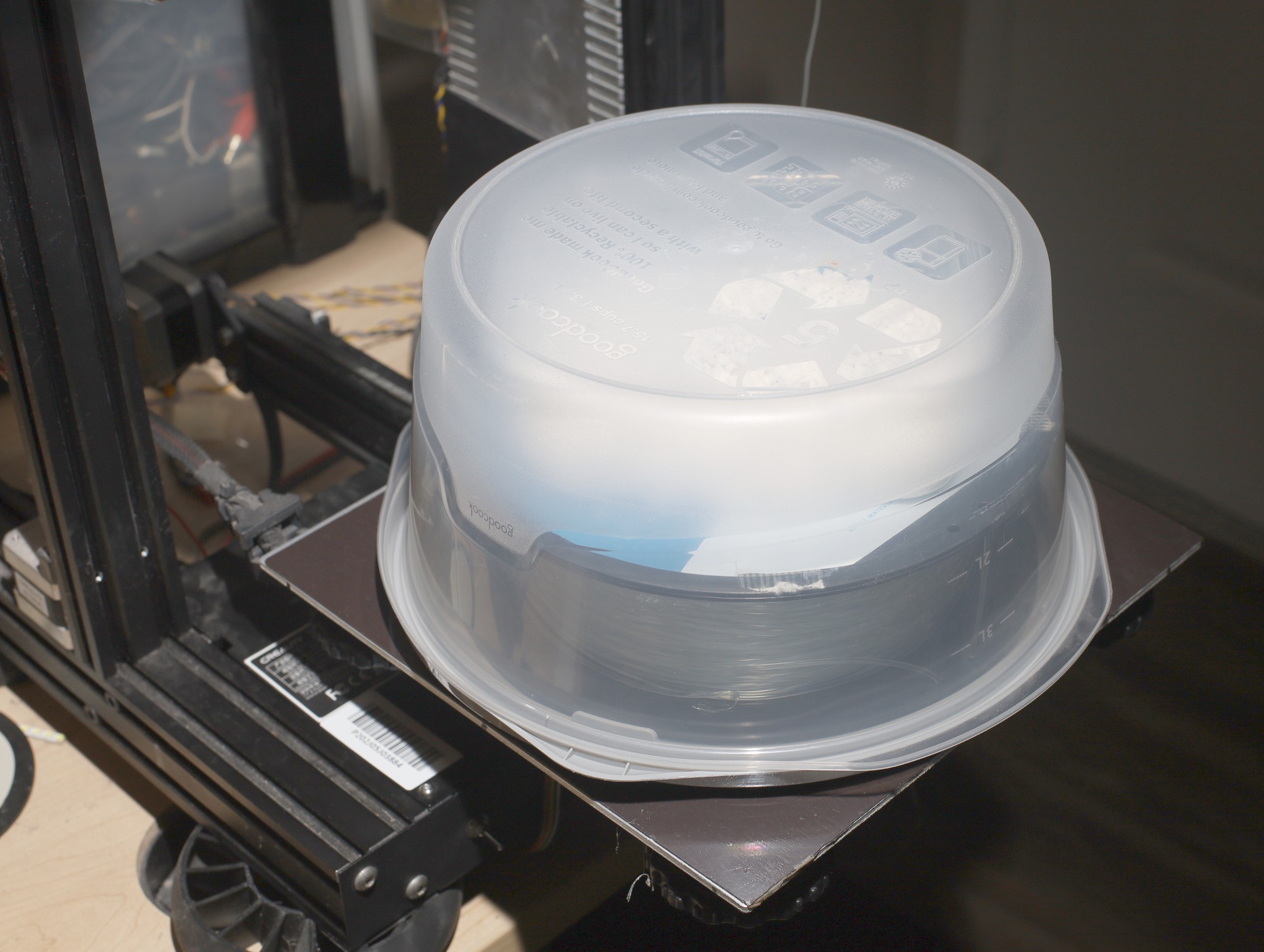

  • Filament drying
    lion mclionhead02/21/2026 at 19:14 0 comments
    After many experiments with solar filament driers, the best solution has been an enclosed thing on the bed.  The filament goes on the bottom.  A tub of calcium chloride goes on top.  There's a piece of cardboard to keep the desiccant from getting hot.  It's creating a distillation column.  The filament gets hot & the water condenses in the desiccant.  It seems to require a bed temperature of 100C for 1 hour with degraded levels of effectiveness as the temperature goes down to 70C.
    Others have tried circulating fresh air in an open container, but it's too humid.  An improvement might be a fan in the enclosed container.
    It's believed the solar filament drier wasn't effective because it didn't get hot enough.  Below 100C, TPU doesn't release any water.  PLA & PETG did better in the solar drier.  They might do better at 70C in the bed drier.
    An improvement on this would be gcode to turn it off after 1 hour.
    The trick with this is in hot weather, you don't want to run the bed heater at all & a solar drier becomes a better proposition.

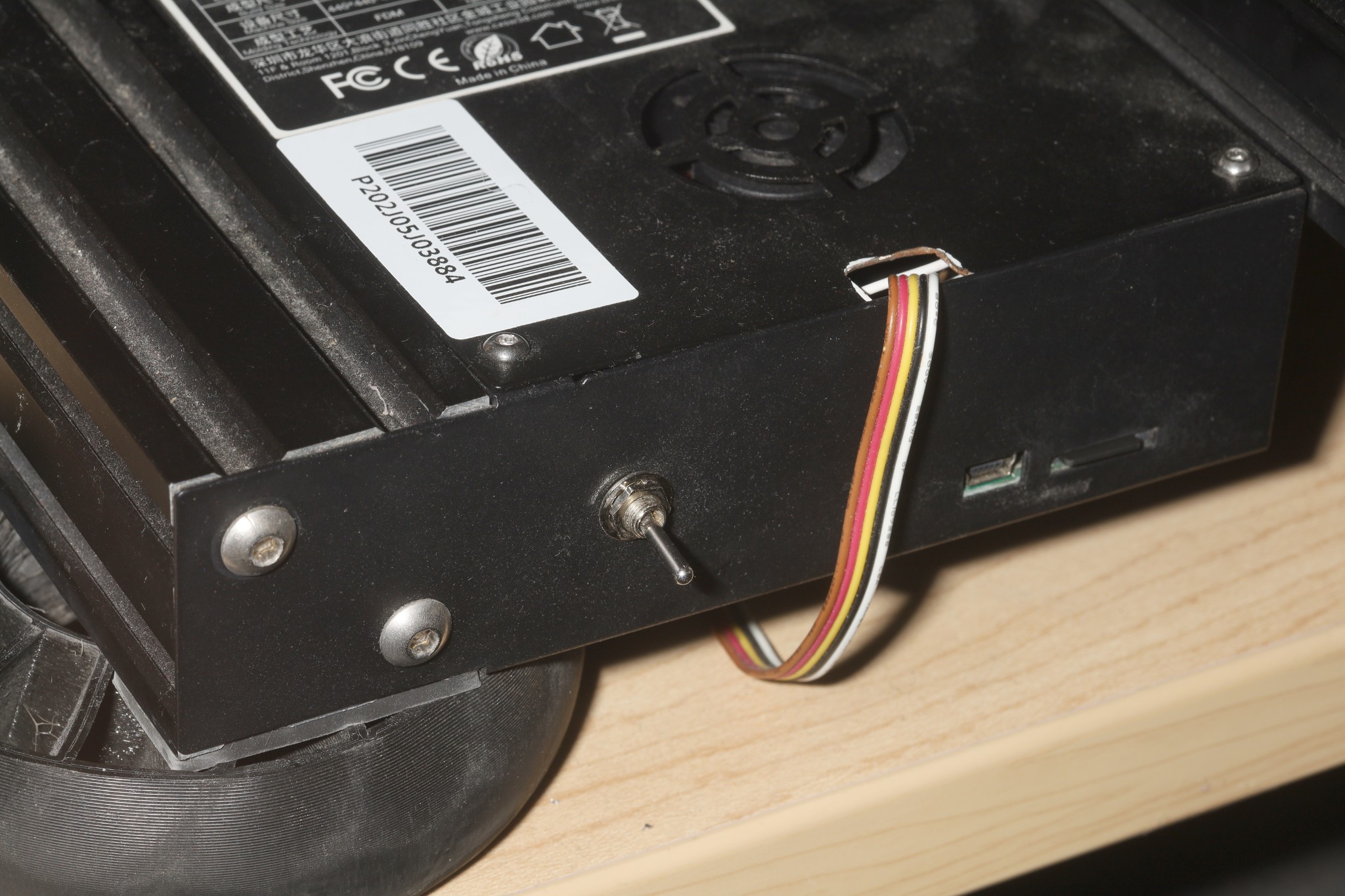

  • Hot end fan switch
    lion mclionhead02/21/2026 at 09:36 0 comments
    A way of killing the hot end fan was a long time coming.  For some reason, the MOSFET fan got a software controlled GPIO while the hot end fan was permanently powered.  The MOSFET fan could be controlled by a thermister & comparator but the hot end fan needs the gcode.  Helas, there probably wasn't enough memory in the 8 bit micro for fan firmware.
    The key need was a way to use the bed as a space heater & filament drier without sucking dust into the hot end.   Other benefits were speeding up the heating, preventing hot starts.

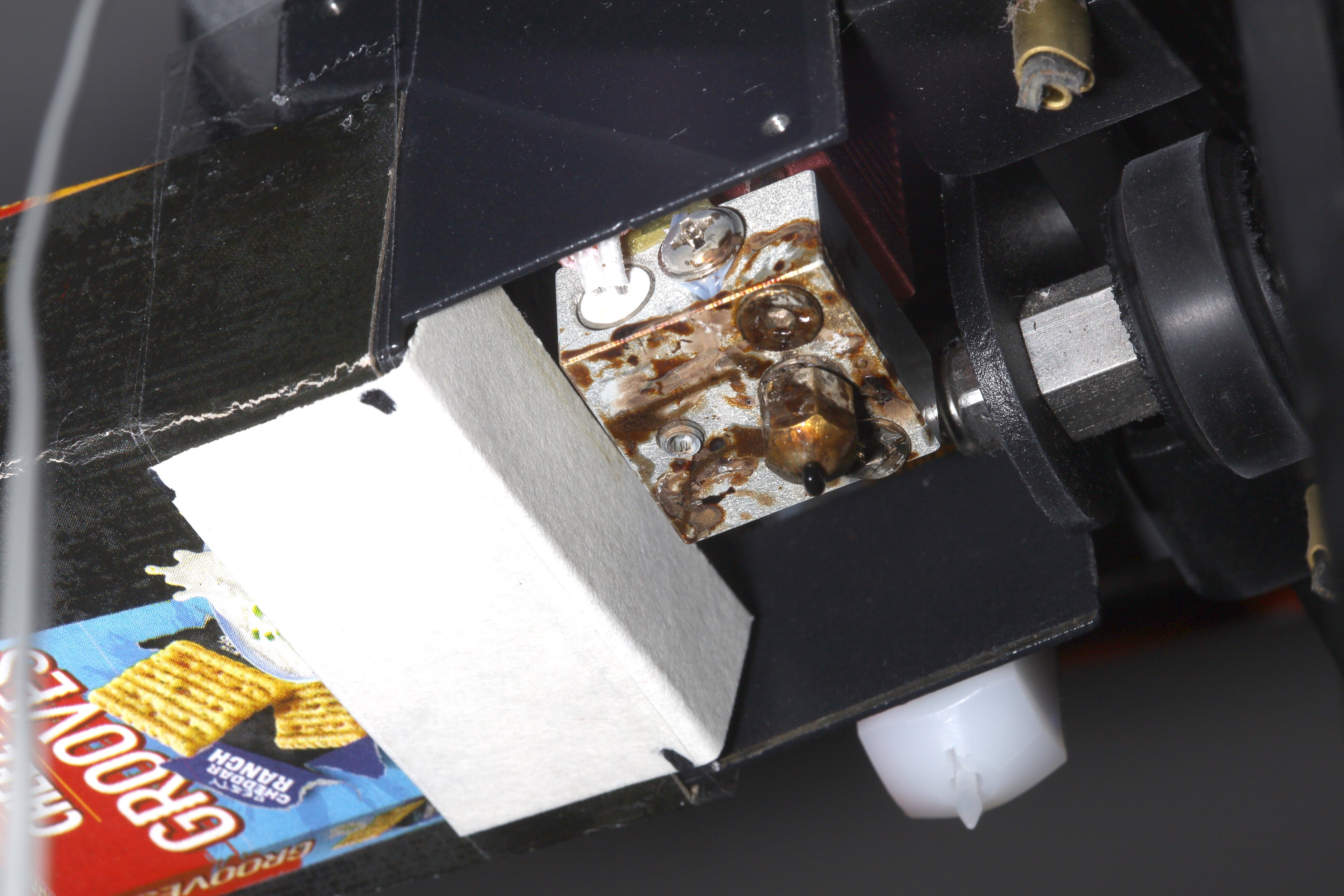

    lion mclionhead02/18/2026 at 08:53 0 comments
    To get better layer adhesion, lions print hard TPU, HT-PLA, PETG with the nozzle at 260C.  To further improve layer adhesion, there's no print cooling.  Basic PLA seems to max out at 220C before it clogs.  The trick with 260C is the Ender 3 can't reach it unless the airflow is blocked below the heat sink with a piece of cardboard.
    Then to manetain the heat break, you have to blow colder air at the unblocked part of the heat sink.  Lions do this with a cardboard air scoop to pull air from away from the bed heater.
    Even then, the nozzle clogs if the ambient temperature is over 90F.
    The thermocouple also tends to glitch during the start of the print.  Wiggling the wires & restarting the print usually stabilizes the thermocouple.  For expensive filament, it's better to start the print without filament, let it print air for a while, then restart with filament.
    The thermocouple glitches are believed to be caused by bad contact with the aluminum.  Removing & reinstalling the thermocouple sometimes improves it.  Some heating problems are caused by the ceramic element not fully contacting the aluminum.  Its set screw has to be tightened.

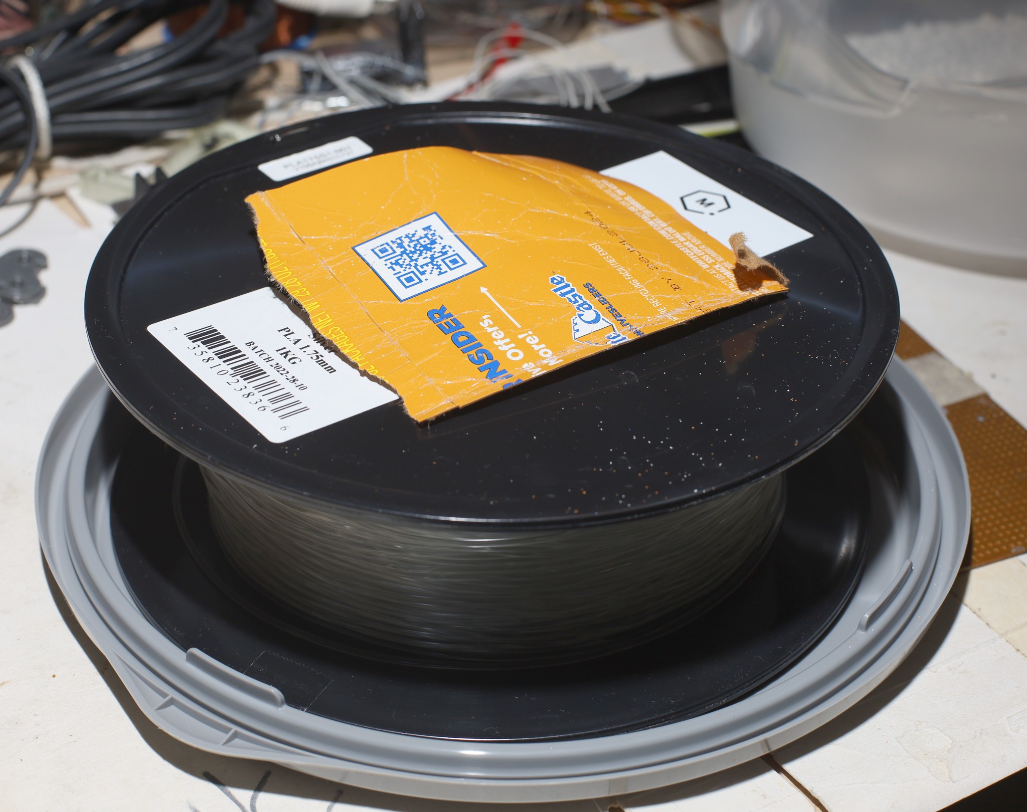

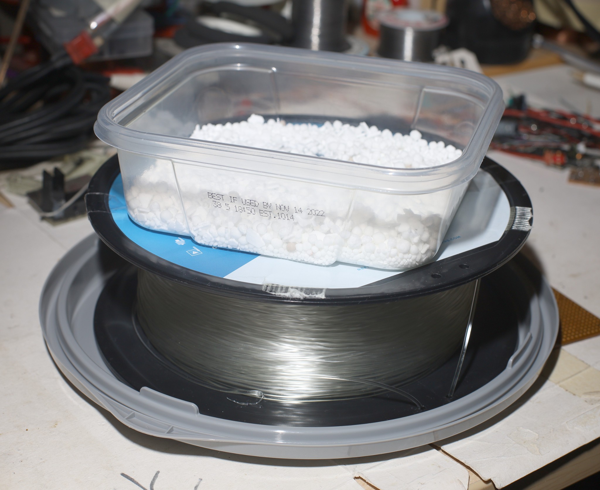

  • Storing filament
    lion mclionhead07/18/2023 at 03:50 0 comments
    is a difficult problem in a $3000 apartment. The lack of space & erratic temperatures make it hard.
    Rich gootubers can do whatever they want, but storing filament in the ambient air is not an option for us plebeians. It all becomes hydrated & useless.
    The lion kingdom started out by creating custom desiccant bags out of calcium chloride & paper towels, stuffing filament in 2 gallon ziplocs with desiccant bags.  Reusable desiccants & silica beads weren't good enough.  If the filament is too wet to be useful, there is a solar drier with circulating fan to heat & move air through the desiccant & filament.
    The desiccant had 3 phases.  When it was partially used up, the desiccant bags got hard but could still be broken up.  After a year, during a summer heatwave, it suddenly liquefied & released a goo onto the filament.  Definitely no use in a bowden tube.  It seems when the ambient temperature gets hot enough, the filament dumps its water & kills the desiccant.
    As the filament collection grew, this became unmanageable, so lions just poured desiccant in the ziploc bags.  The hope is a partial saturation would get detected before it turned into goo.  There's definitely a long term need for a way to store the desiccant & filament together without the 2 mixing.
    The well healed have standard air tight 25"x16" containers which open from the top.  The lion kingdom's $3000/month slice of inflation targeting heaven has only an 18"x18" area.  Sadly, there are no air tight containers in exactly that size.
    The growing filament collection makes it impractical to have a separate container for every roll or to have the rolls unstacked.  The best option would be a a side loading container with shelves.  There are no side loading air tight containers with shelves.
    There are $120 mini fridges with most of the space taken by insulation.
    There could be a shelf with multiple removable containers or ziplocs.
    A better desiccant container is needed which allows it to liquefy without making a mess.  It may just end up being a transparent cup & a matter of the operator keeping the container vertical.  It always took some care to keep the filament & desiccant separate in the ziplocs.  Accessing a roll always required taking off every roll above it, restacking them.  The cup could be sealed on 1 end with a paper towel, just in case.
    The cup could be fixed to the filament, making it a matter of keeping 1 assembly level.  Big tupperware containers storing 2 rolls might be easier to keep level.  The desiccant could be stored in a removable, clear container which is fixed to the tupperware.
    This container seems to be the standard one for filament aficionados.
    The only other container was this 2.5 gallon one.  It seems to take more space.
    Desiccant went into a $1 bottle.  The opening had to be cut off.  The paper towel is just in case it falls over.
    The case could be made for pouring desiccant directly in the container & having a spacer separate the filament from it.  The problem is if solar drying hardware goes in, it could rust.  There's enough room to stand up the bottle when the container is sideways.  The lion kingdom wants a modular solar drying package that goes into any container.  The transparent bottles are just laborious to fill & might not be as effective.
    There's not enough room for all 8 filament rolls in a $3000 apartment.  The tupperware might be applicable to solar drying, but ziplocs with the desiccant bottles might be the only way.  The best solution is turning to a custom cardboard roll, exactly sized for stock tupperware.  It might be wider & narrower than standard rolls.  It might be best just to keep pouring desiccant straight into ziplocs & stack filament so the desiccant hangs down 1 side of the stack.
