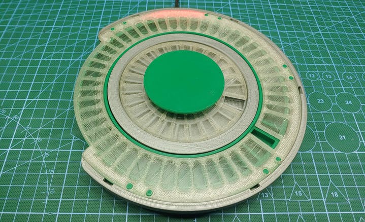

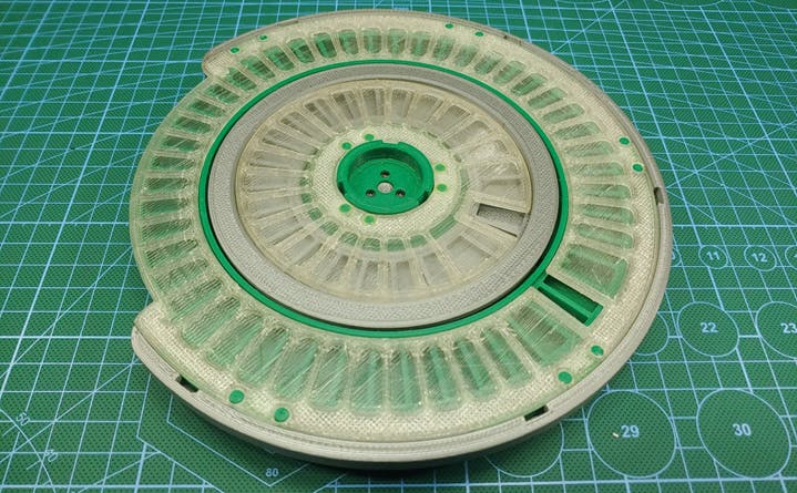

The Pick-N-Place Wheel is not just a 3D printed device, it’s a combination of three main elements: The 3D printed wheel itself which is the hardware, the rotary encoding and slot indexing; the electronics, and the control software in the form of a desktop application. The Pick-N-Place Wheel will not function as its intended without these three elements.

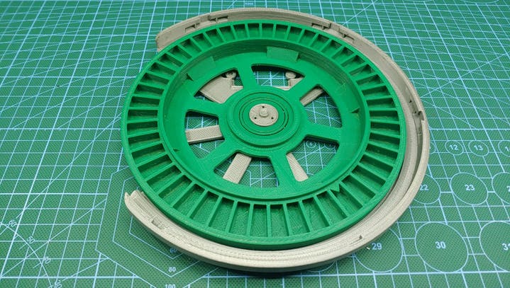

THE WHEEL

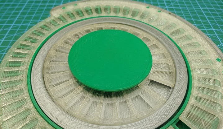

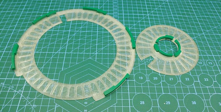

The wheel’s function is primarily to hold your components in indexed slots for when your populating a PCB, but it also doubles as the permanent storage for those components, thanks to the built in twist locking mechanism.
The wheel’s transparent top cover has a few flexible 3d printed tabs glued to it, this tabs fit into matching slots on the wheel, so that when you turn the top cover in one direction it creates a 1mm separation from the wheel (opened state), allowing the wheels to rotate freely during board population, and when the wheel needs to be stored away, the cover can be turned in the other direction which lowers it back down unto the wheel (closed state), sealing the components in their slots and preventing them from falling out or falling into another component’s slot. So instead of keeping components in the anti-static bags that they came in, the Pick-N-Place Wheel can be used to index and store them.
The Wheels of the Pick-N-Place Wheel

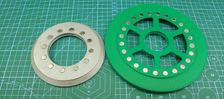

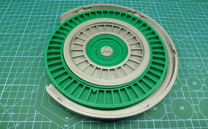

The Wheel is designed to hold two separately encoded wheels, one large outer wheel identified as wheel 1, and one smaller inner wheel identified as wheel 2. The image above shows the typical capacity of the wheel’s slots, each wheel has two versions, wheel 1 has a 48 and a 16 slot version, and wheel 2 has a 24 and a 8 slot version, this wheels can be combined in multiple ways to suit various types of PCB projects, the wheels with the higher slot counts are designed to hold a lot of small SMD components, while the wheels with the bigger slots are designed to hold bigger parts, like usb ports, leds, power inductors or connectors.
The placing surface where you’ll place the board you want to populate also has two versions to accommodate different board sizes. The image below shows all the possible configurations of the Pick-N-Place Wheel and their intended project types.

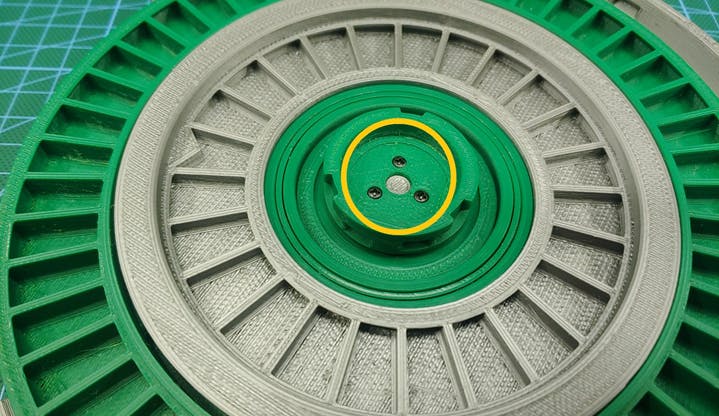

THE ELECTRONICS
The Pick-N-Place Wheel is built around wheel encoding and indexing which is facilitated by the electronics.

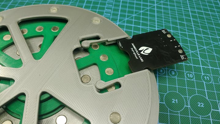

  • 1 × Pick-N-Place Wheel Board This makes rotary encoding and slot indexing possible on the wheel https://www.tindie.com/products/24720/
  • 1 × 6810 Ball Bearing Capacitors / Film
  • 1 × 16004 Ball Bearing
  • 1 × 16001 Ball Bearing
  • 1 × 50x 8mm x 1.5mm disk Neodymium magnets
View all 8 components
  • 1
    Step 1
    Setting up and Using the Wheel
    In order to use the Pick-N-Place Wheel, you'll need to go through the first time setup process, this process involves:
    • 3D printing and Assembling the wheel to suite your desired PCB project.
    • Generating the required Files for the App.
    • Loading and Registering the components into the Wheel's slots.
    Assembling the Wheel
    Step 1: Choose your desired wheel configuration.
    Step 2: 3D print the required wheels for your chosen configuration, as well as all the other required parts.

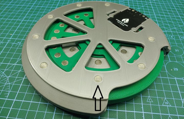

    Step 3: install the magnets on the wheels in an alternating pole configuration.
    Step 4: Glue on the locking tabs to the transparent top cover for wheel 1 and wheel 2.

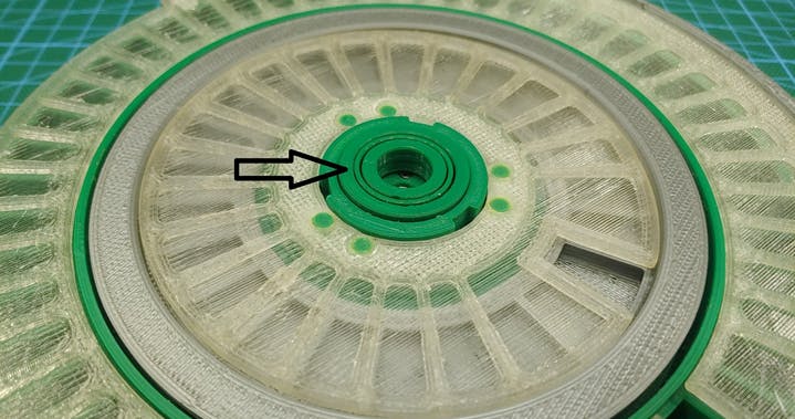

    Step 5: Install the 16004 ball bearing, followed by wheel 1.
    Step 6: Install the 6810 ball bearing to wheel 1, followed by wheel 2.

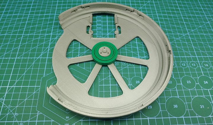

    Step 7: Attach the placing surface bearing holder to the wheel, and secure it with 3 m2 screws.
    Step 8: Attach the transparent top covers to the wheels, twist clockwise to lock them in the opened state or counterclockwise to lock them in the closed state.
    Step 9: Install the 16001 ball bearing, followed by the placing surface.
    You may also glue on a mat of some sorts to the placing surface, i use a 1mm silicone mat, this keeps the PCBs from sliding of the placing surface.
    Step 10: Install the Pick-N-Place Wheel board to the base of the wheel, simply push it into its slot until it clicks into place.
    Step 10: Attach the rubber base pads.
    Congratulations!!! , its a Pick-N-Place Wheel.

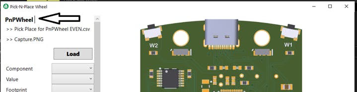

    Using the App for The First Time
    Once all the required files have been copied to their appropriate folders, the next step is setting up the wheel and the app for your first board assembly.

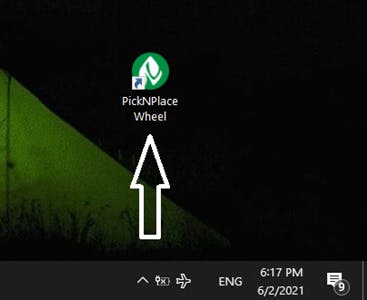

    First your going to want to launch the application.
    The Pick-N-Place Wheel Application interface
    Once the app opens up, click on the Load button, this will open up a dialog box, asking you to choose a project file.
    Navigate to the folder containing the csv and image and select any of them.
    After selecting the file, you will notice the image on the app change to the picture of your board, indicating that the required files have being successfully loaded.
    You’ll also notice that the file names are listed on the top right corner of the app.
    You can name the project (optional), by simply double clicking on New Board, and then typing in your desired project name.
    The next step is setting the columns from your csv file to their appropriate comboboxes in the app.
