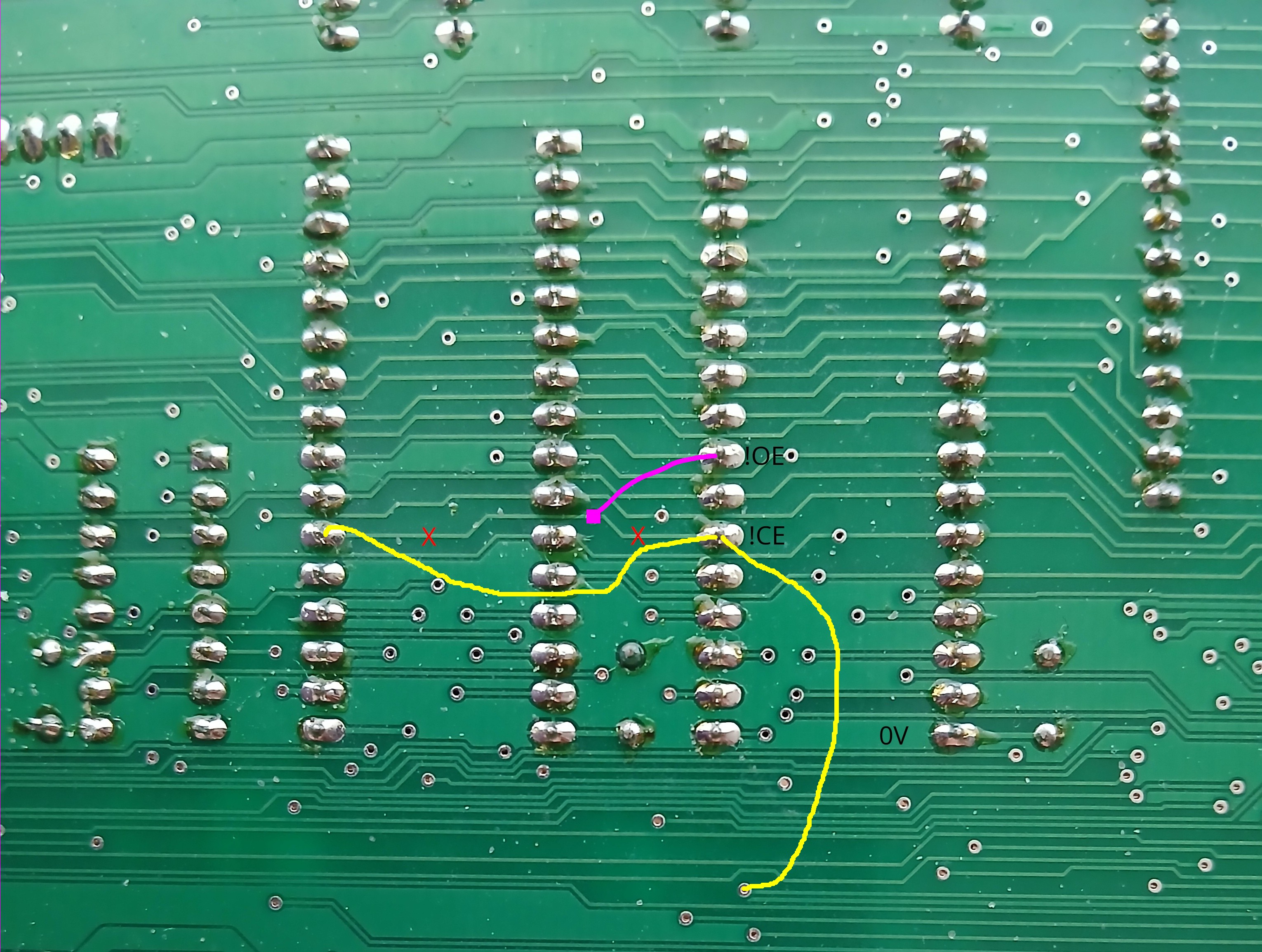

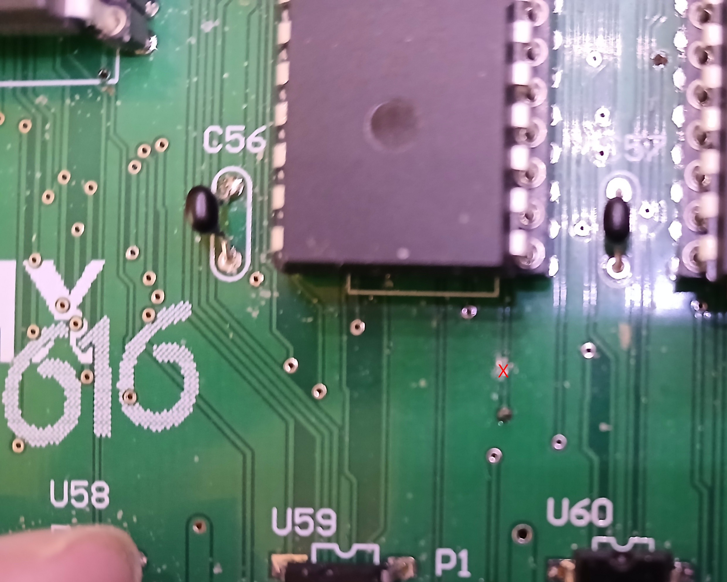

  • Disabling the bus error timeout
    Keith08/07/2026 at 18:02 0 comments
    I wondered if the bus error circuit was generating spurious errors.
    I guessed that bug-free running software would never access an invalid address, so it ought to be alright to disable bus error detection. So I did.
    I cut the track between U33B pin 5 and U24C pin 10, near to U33B, then tied the track to VCC.

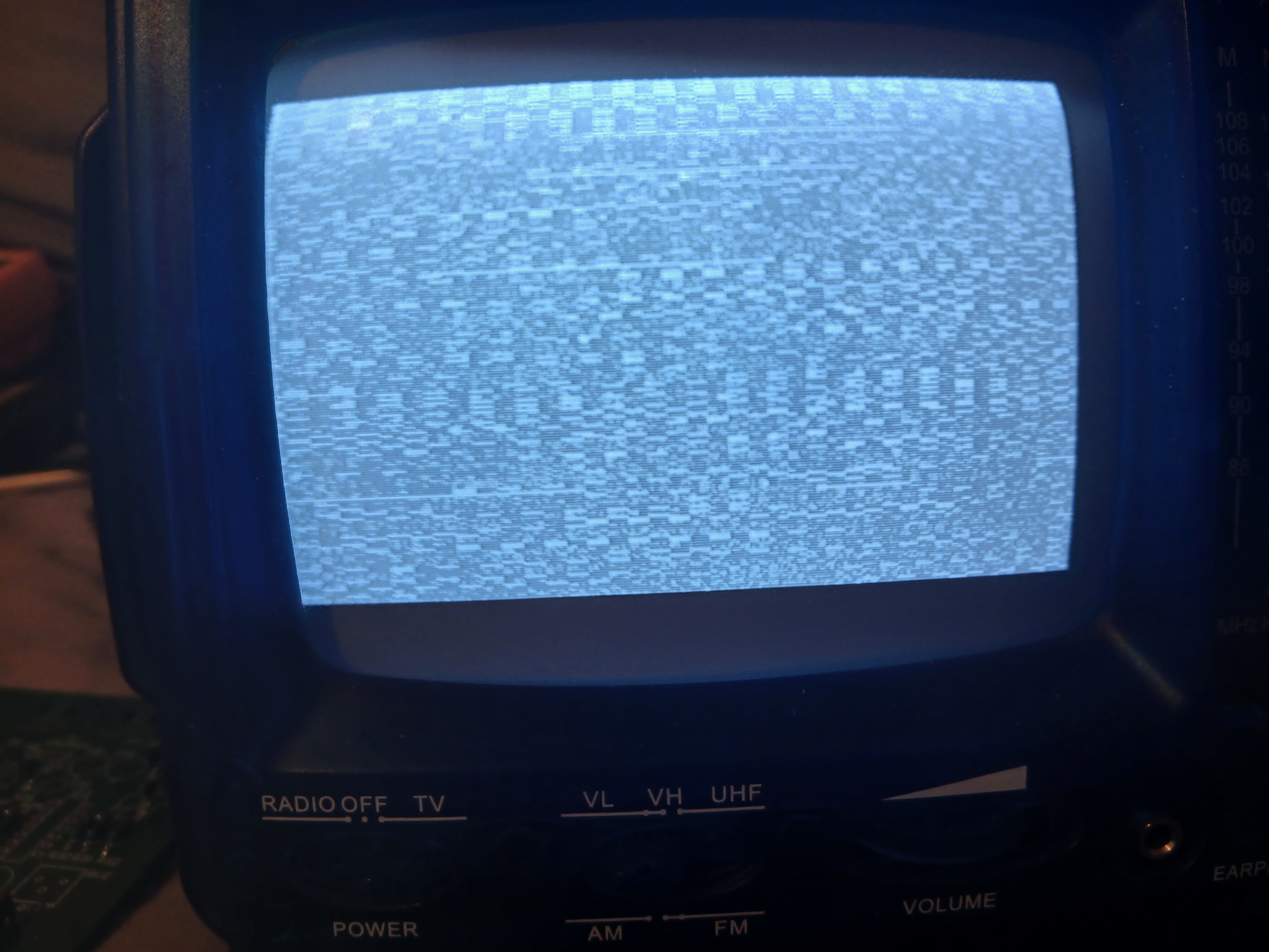

    Power on and ... nothing. Not even CRTC initialisation and screen start up.
    It looks like the bus error handling is essential to sweep the CPU into executing some valid code.
    But really, I would expect the code to present a sign-on screen before trying to access some expansion boards that may be present or not, and not have exception screens overwrite each other before locking up completely. It doesn't seem to be handling itself gracefully.

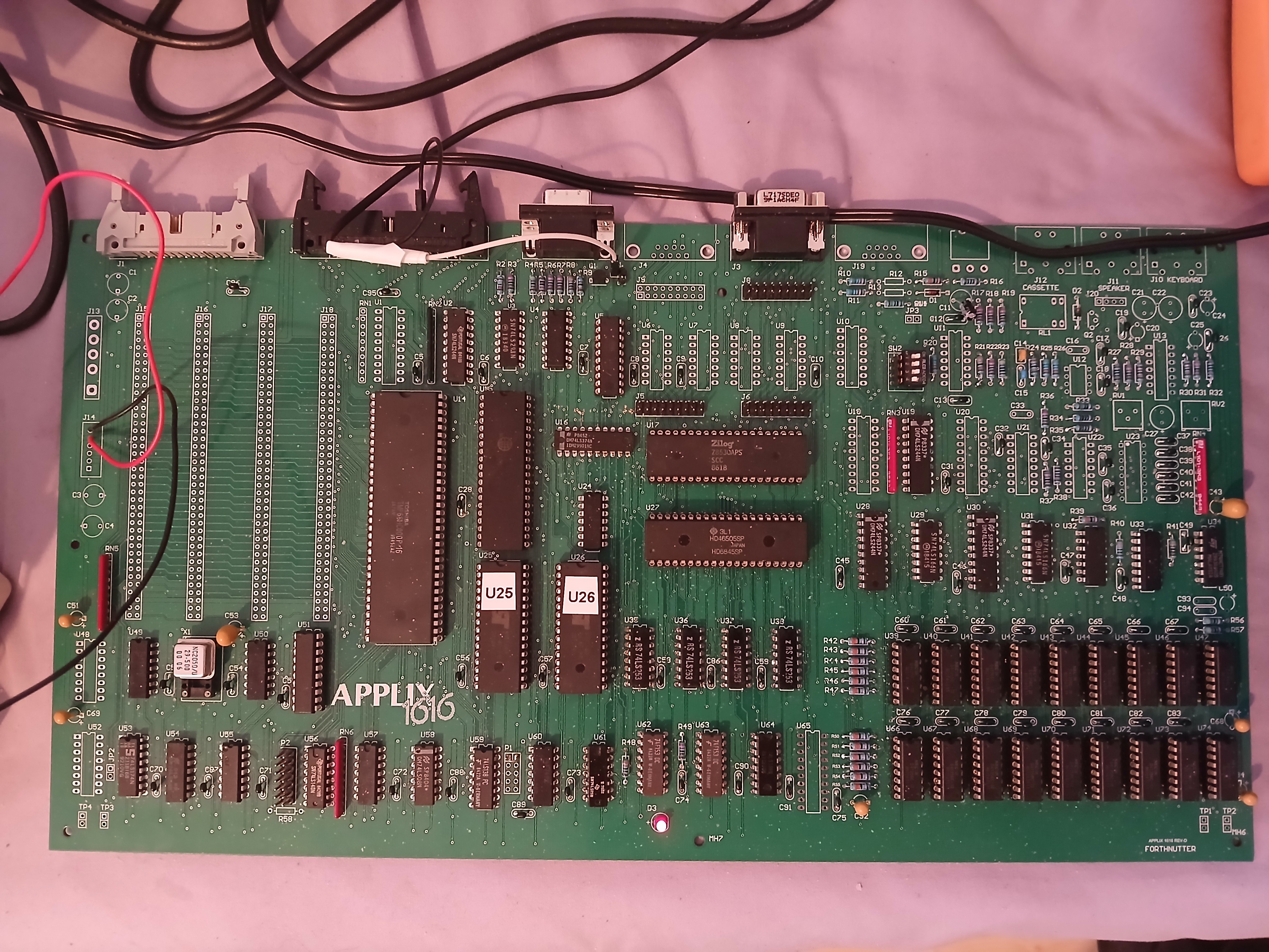

  • Electrical review
    Keith08/05/2026 at 00:40 0 comments
    Many people learn electronics as a join-the-dots exercise in textbooks written by academics who teach but seldom make practical products. Power lines are drawn with the same pencil-thin lines as signals, connections have zero resistance, inductance or capacitance, and so on.
    Your CAD system will check you have made all the right connections, but it won't tell you if your thin copper track is going to melt as soon as a power transistor gets switched on. Well, as of 2026, but one day AI will be able to do this.
    I have seen professional products designed by people with no appreciation of real-world current flow. Like the battery charger my employers once paid a lot of cash to a subcontractor to design. Heavy currents, thin wires... it did not blow up but it got hopelessly confused trying to measure currents. But that's another story,
    Back to the board we are looking at...
    Power rails
    The power enters on the left, next to the expansion slots. This makes sense because the expansion board could take a lot of current, but I have none so is is not an issue. Or cause of problems that the board is having.
    A good way of telling which chips are using the most current is to feel which are warm or hot.
    My NMOS CPU was rated at 8 MHz, and the board timings demanded at 10 MHz (or faster) part. I fitted a 16 MHz CMOS CPU, and that runs stone cold.
    The NMOS SCC ran warm even when idle, so I bought and fitted a CMOS version.
    The 6845 CRTC is also running warm, but that seems to be running without errors so it doesn't seem to be starved of power.
    DRAM is notorious for needing power, and huge gulps of it every time a row address strobe refreshes the charge on a row of capacitors. They are tiny, but there are many on a row and they need topping up in a fraction of a microsecond. Hence the huge current pulse, and the need for a decoupling capacitor for every DRAM chip.
    Some people say that you really need power and ground planes for serious RAM designs, but these extra layers push up the board price. So board designers have to take more care for two-layer boards.
    The Applix 1616 has the DRAM chips on the opposite side of the power inlet. So all those row-charging current gulps have to travel through the copper tracks across the board, dipping the rails of everything else on the board.
    The BBC micro got round this by having power input connections specifically for the DRAM chips. This might be something worth adding to the Applix board.
    Let's take a look at the voltage drops.
    First I set my PSU to deliver 5.2 volts on the power input of the board, then measure the voltage across the power pins of various chips.
    5.008  Input measured at J13.
    4.812 at CPU, ROM chips (3.76% low.
    4.816 at CRTC
    4.817 at SCC
    4.847 at furthest DRAM chip (the worst case) is 3% drop, which is acceptable.
    4.982 at U49
    4.986 at U5 and U51, the PAL chips
    4.990 at U2, , the IC nearest J13.
    With 5.2 volts at J12, furthest DRAM is 5.035 volts.
    So it looks like the 5V power is okay across the board.

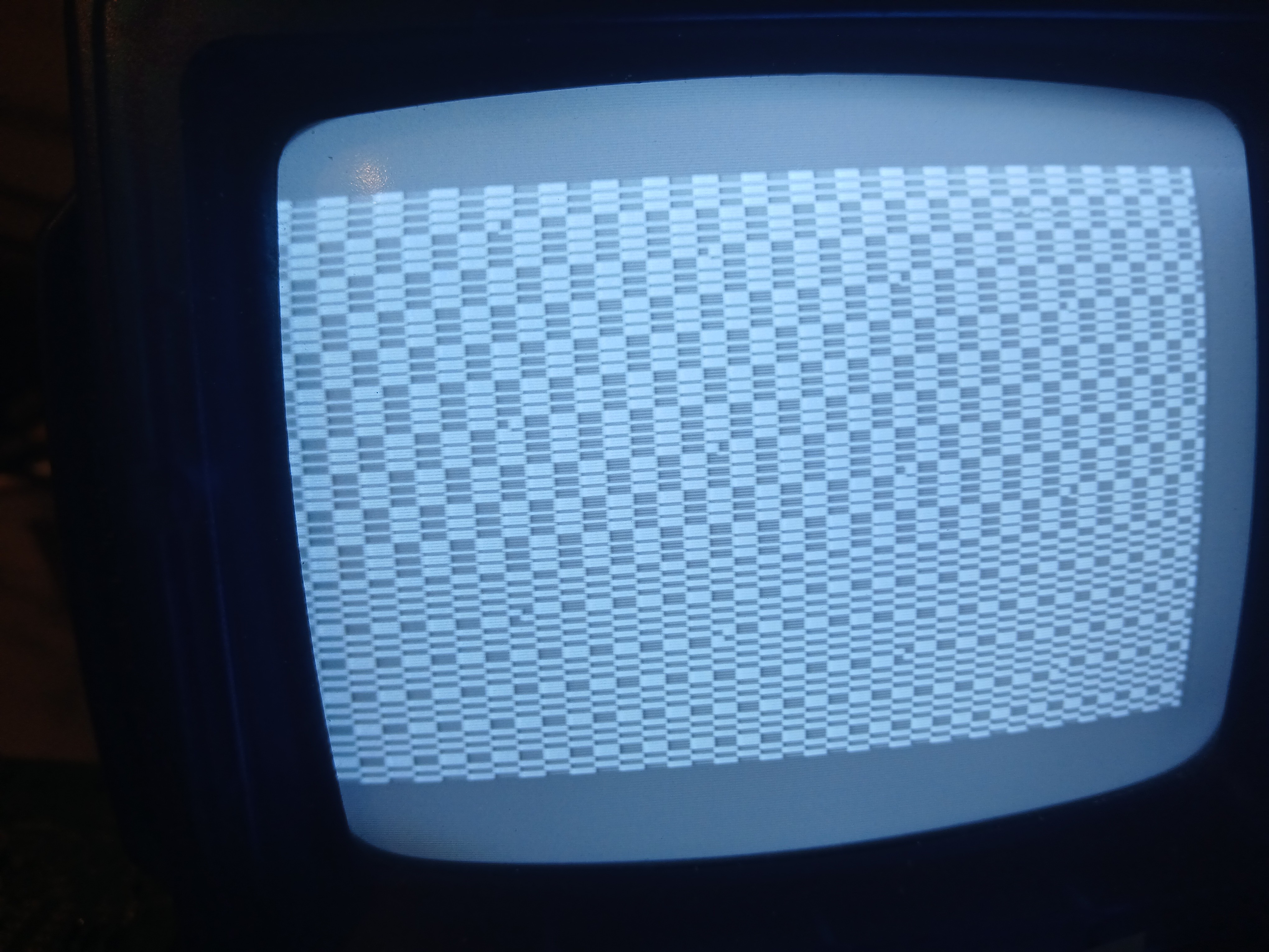

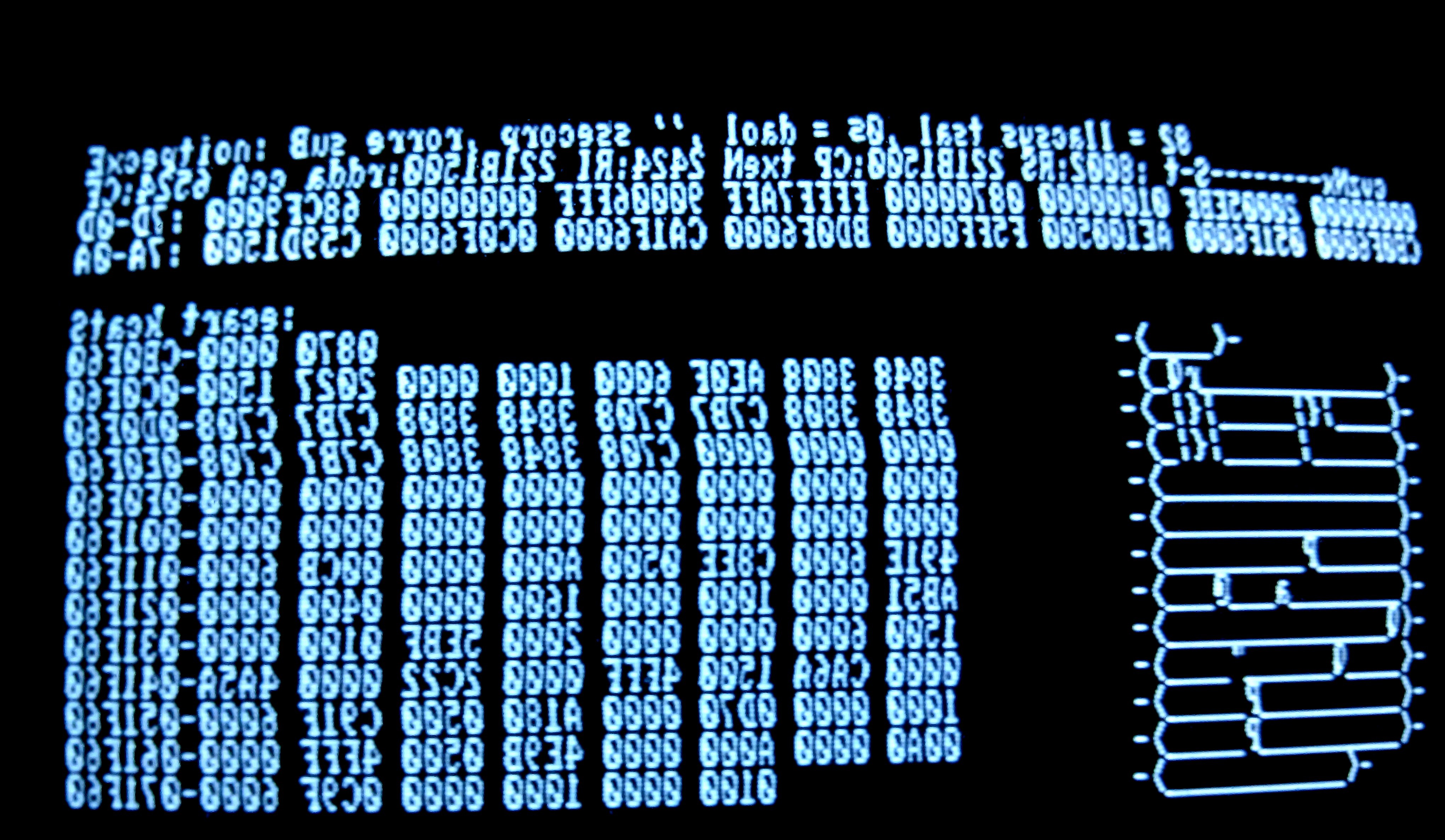

  • Fixing the reversed characters
    Keith08/02/2026 at 19:55 0 comments

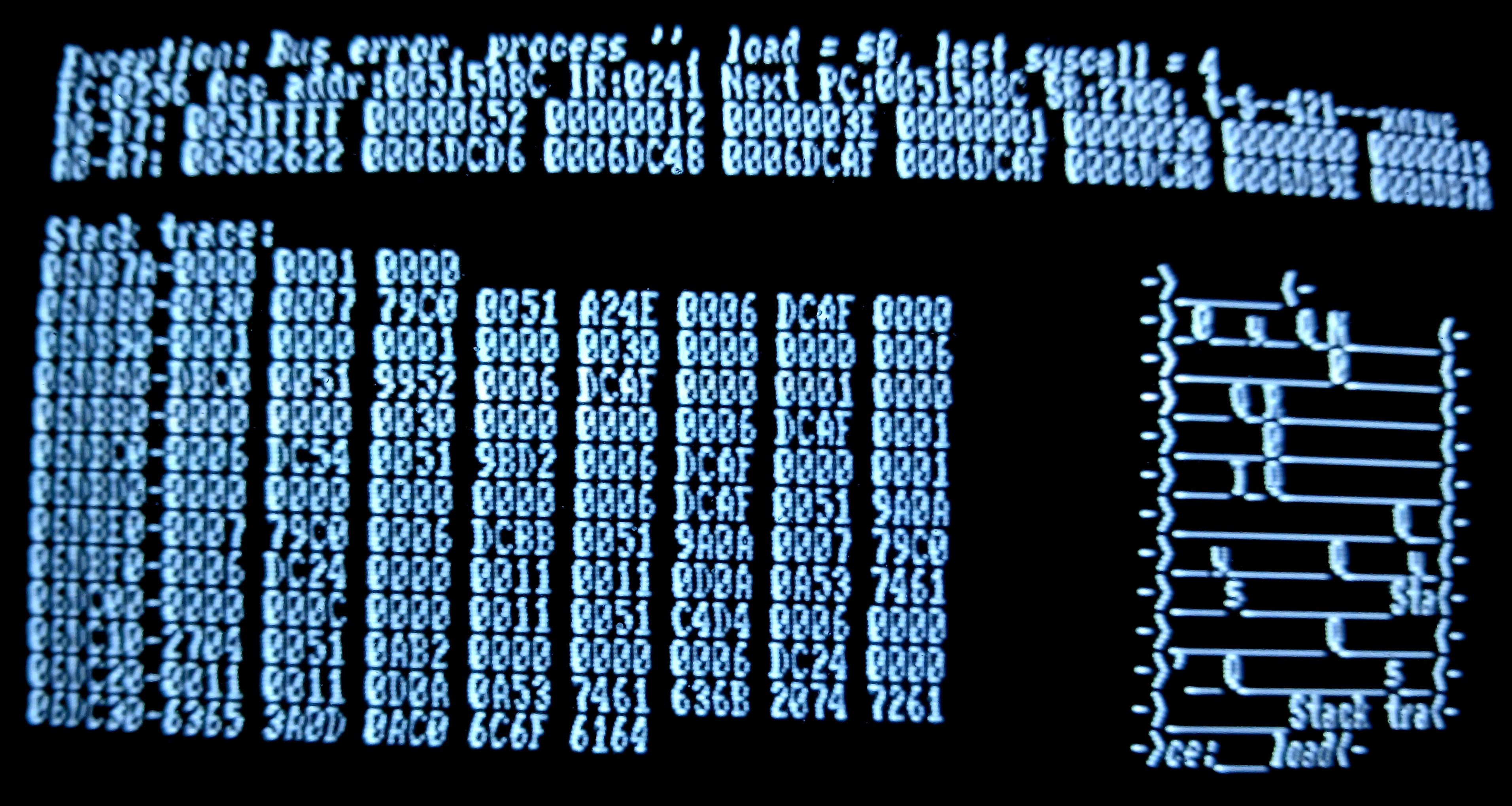

    I managed to reduce the blurring by simply turning the TV brightness down. The text became much more readable.
    The text translates roughly into this:
    Exception: Bus error, process '', load = $0, last syscall = 28
    FC:4256 Acc addr:0051B122 IR:4242 Next PC:0051B122 SR:2008: t-S--------xNzvc
    D0-D3: 0006FC86 00000000 FFF60009 FFA7FFFF 00000780 00000010 FBE50002 0????????
    A0-A7: 0051D95C 0006F0C0 0006F1AC 0006FODB 0000FF2F 005001EA 0006F150 0006?????
    Stack Frame:
    06F0BC-0000 0780
    06F0C0-0051 7202 0000 0001 0006 F0EA 8083 8483

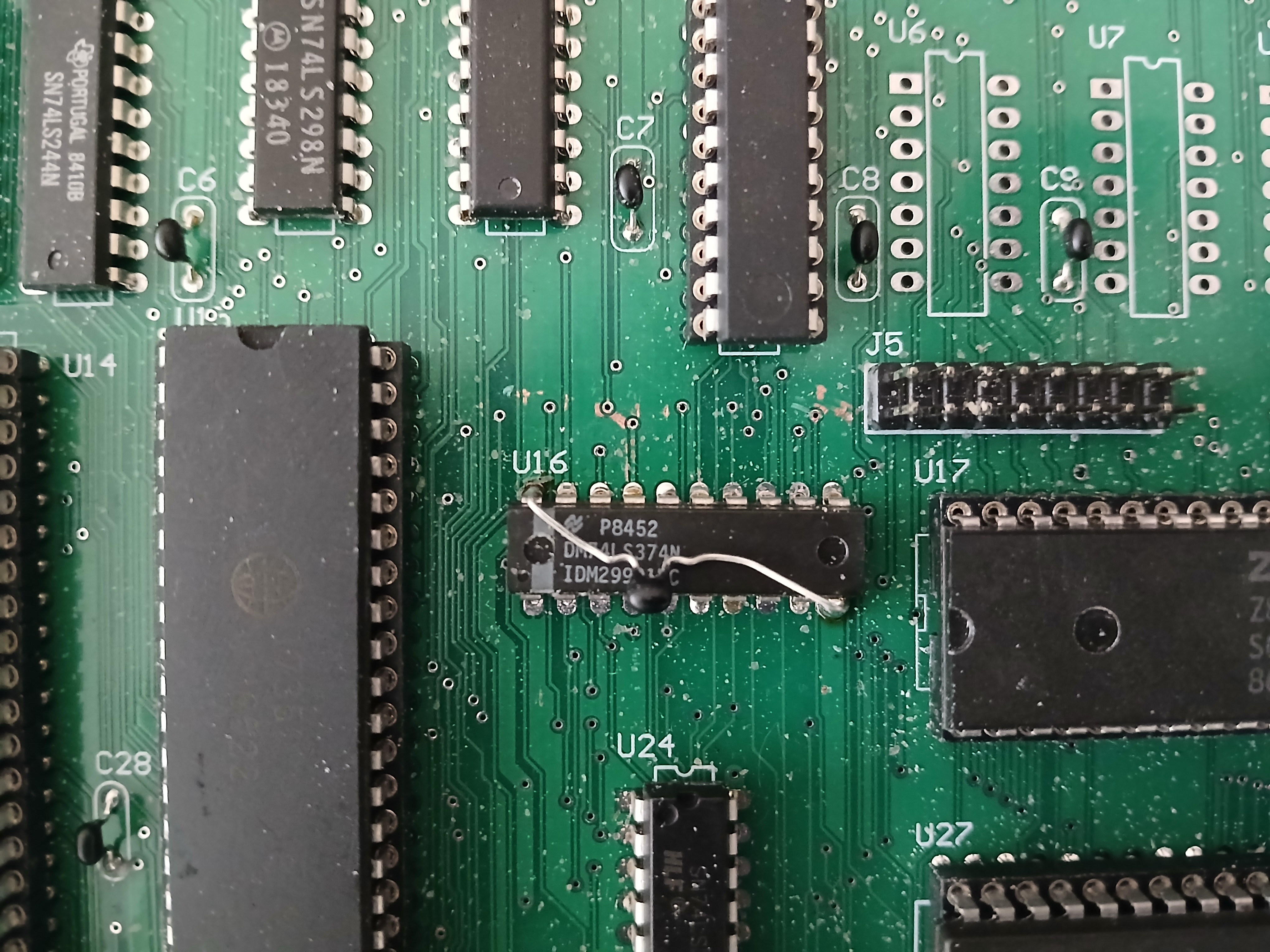

    With a stable screen, it looks worthwhile correcting the video shift-register error.

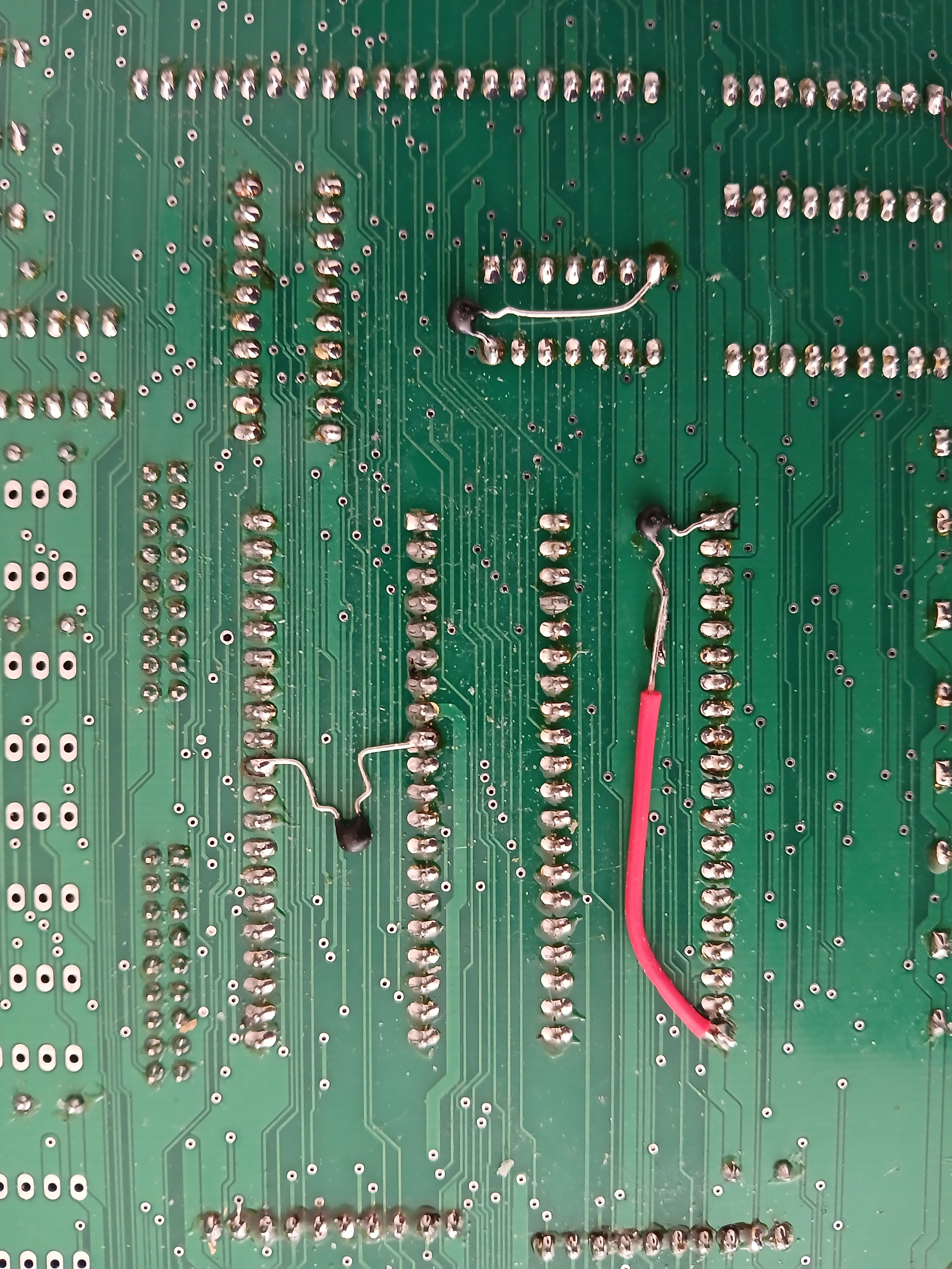

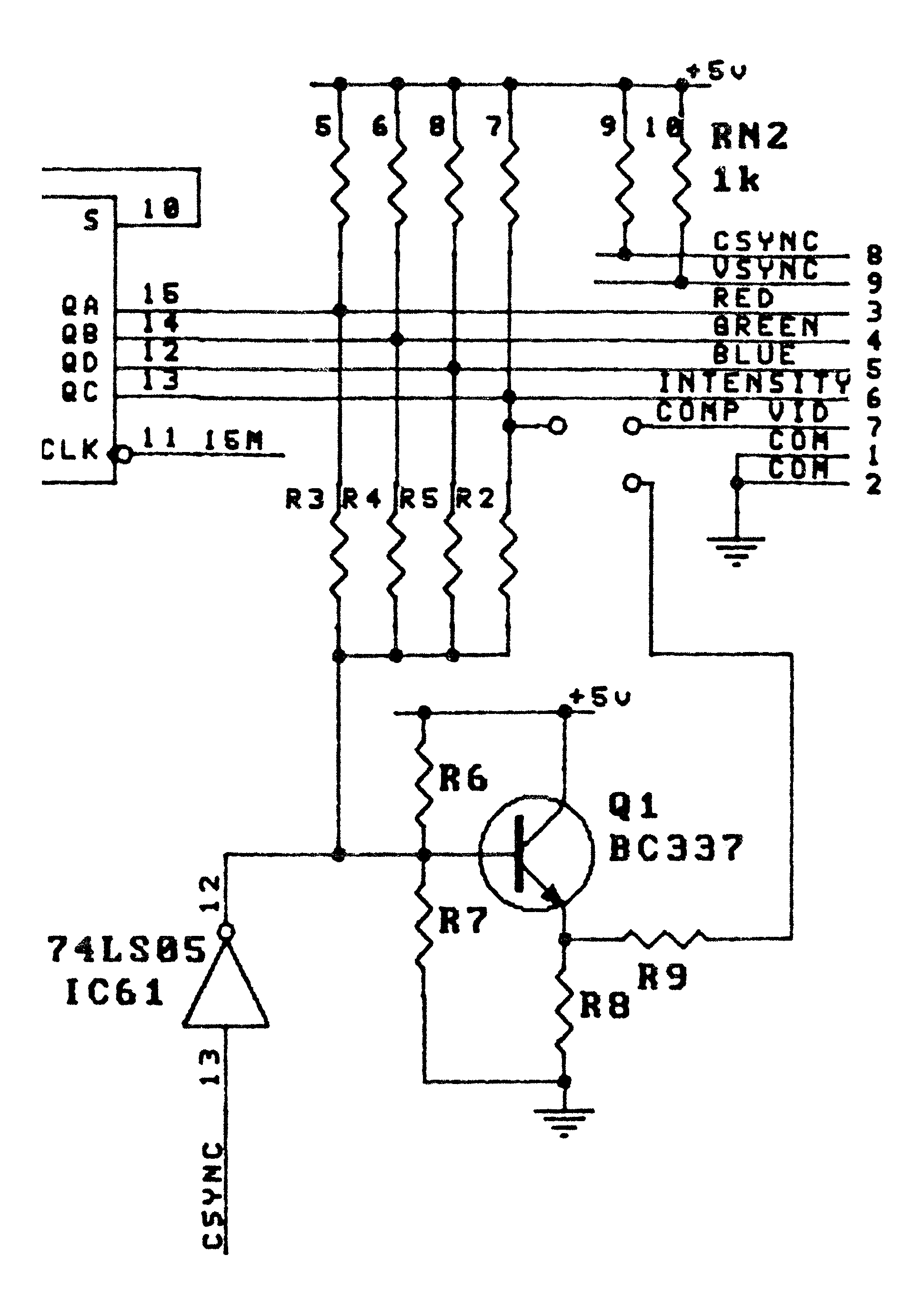

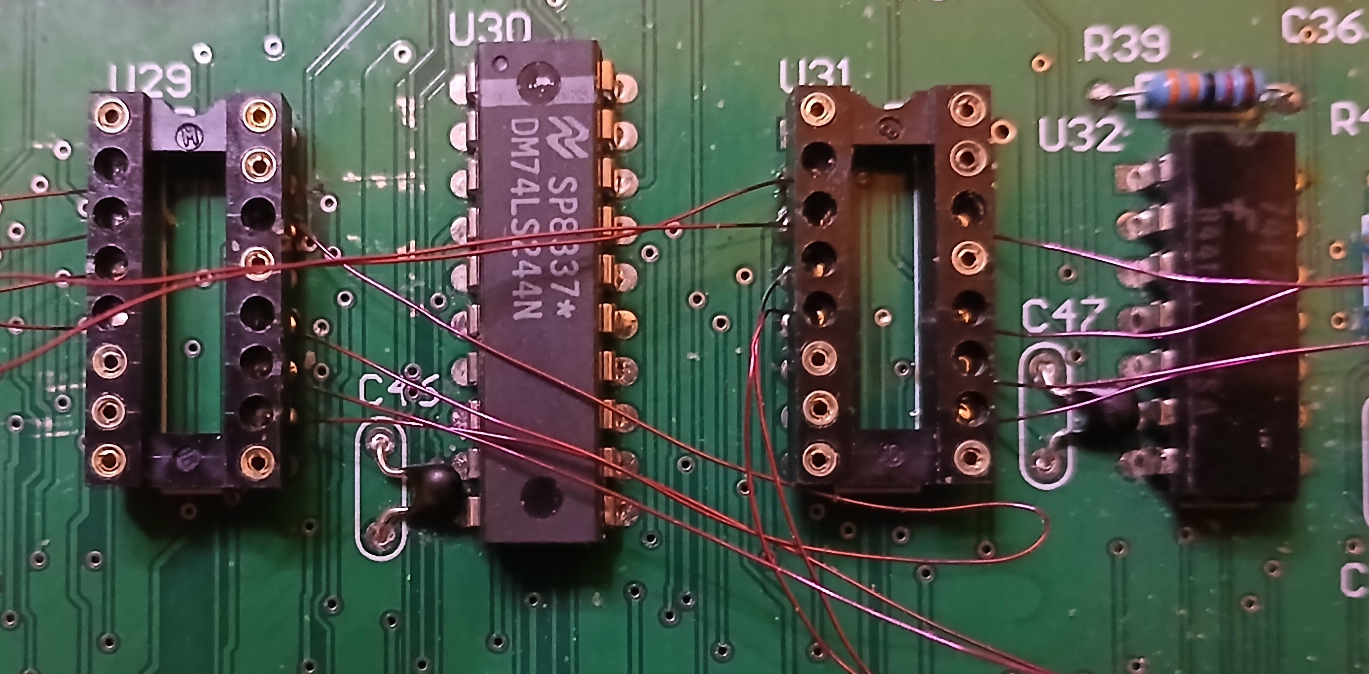

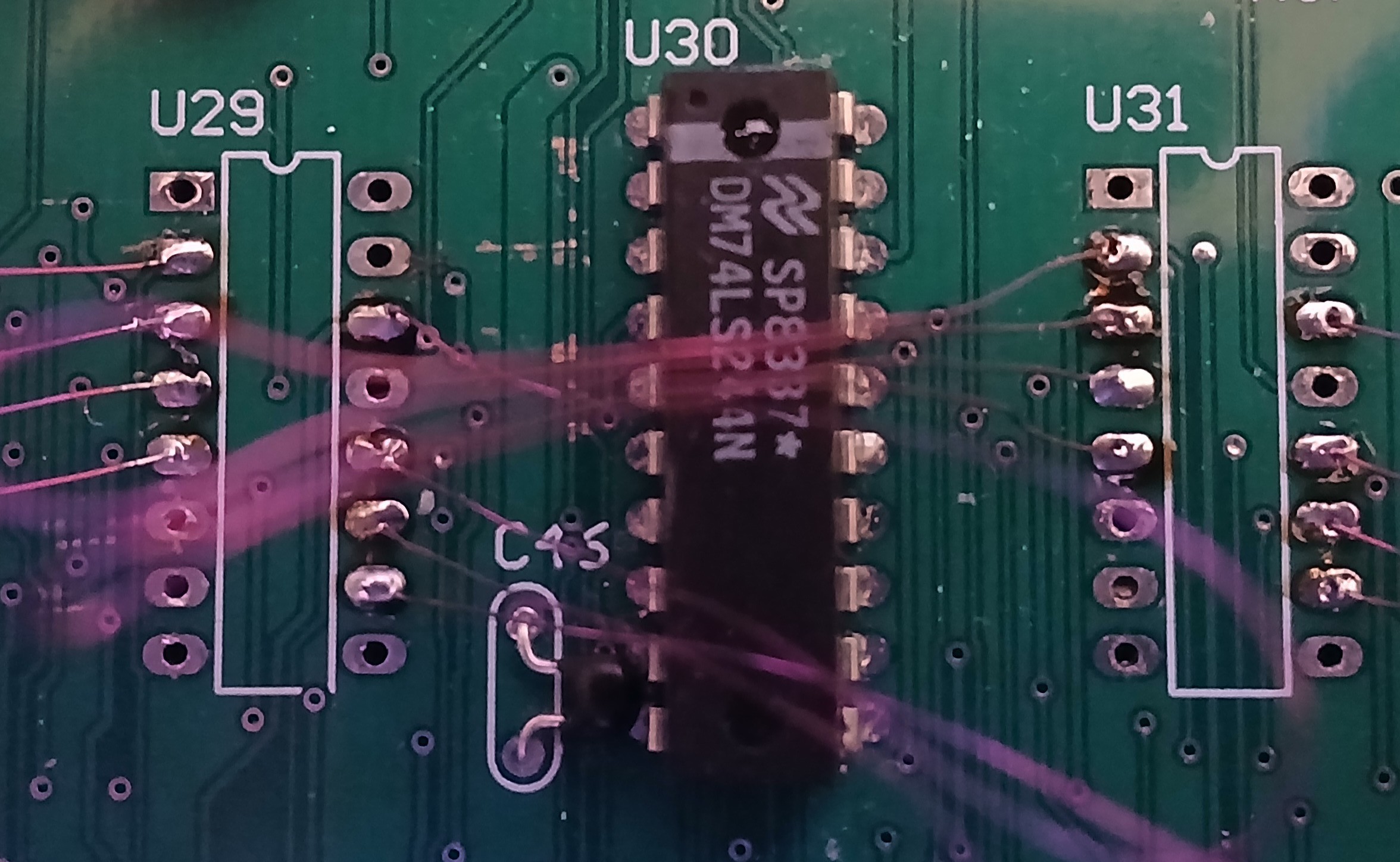

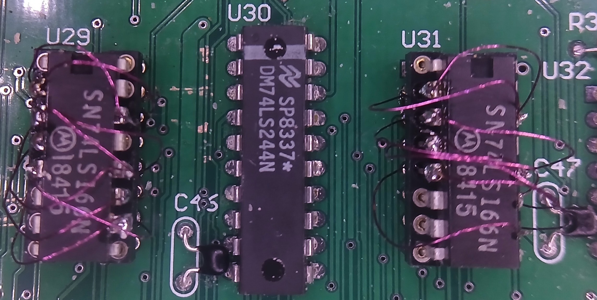

    The shift register sockets look like this:
    Blue are the correct connections on the chip pins, yellow are the wrong positions on the socket holes.
    Therefore, for each LS166 chip:
    • Isolate the blue pins by bending them out of the socket,
      or if they are soldered in then cut the legs off the board but leave pin stumps,
      and remove the pin material from the holes.
    Connect:
    • Hole 2 to pin 14
    • Hole 3 to pin 12
    • Hole 4 to pin 11
    • Hole 5 to pin 10
    • Hole 14 to pin 2
    • Hole 12 to pin 3
    • Hole 11 to pin 4
    • Hole 10 to pin 5
    I didn't manage to isolate the pins neatly, so I removed them, cleaned the holes  and did this.
    First add wires to the wrongly positioned signals:
    Then deplete the erroneous pins from some turned-pin sockets, then fit them:
    Then connect the wires to the right pins:
    Yes, it looks messy but it takes less space than forthnutter's correction board.
    With hindsight, it would have been easier to solder wires to the chips first, the poke them through the socket and PCB holes.
    I must have got all the wires right, because I get a sign-on screen with the letters the right way round:
    which immediately does at least two Exception screens before settling. This is a second:
    I get the impression the system is less stable than before, when it would usually just throw one exception.

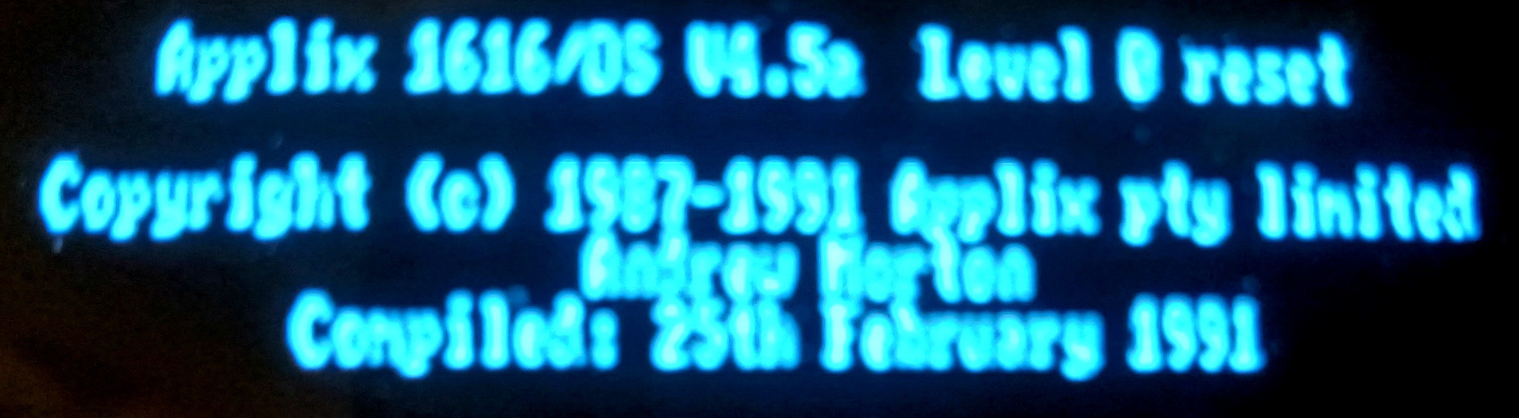

  • Programmable logic chip investigation
    Keith08/02/2026 at 17:51 0 comments

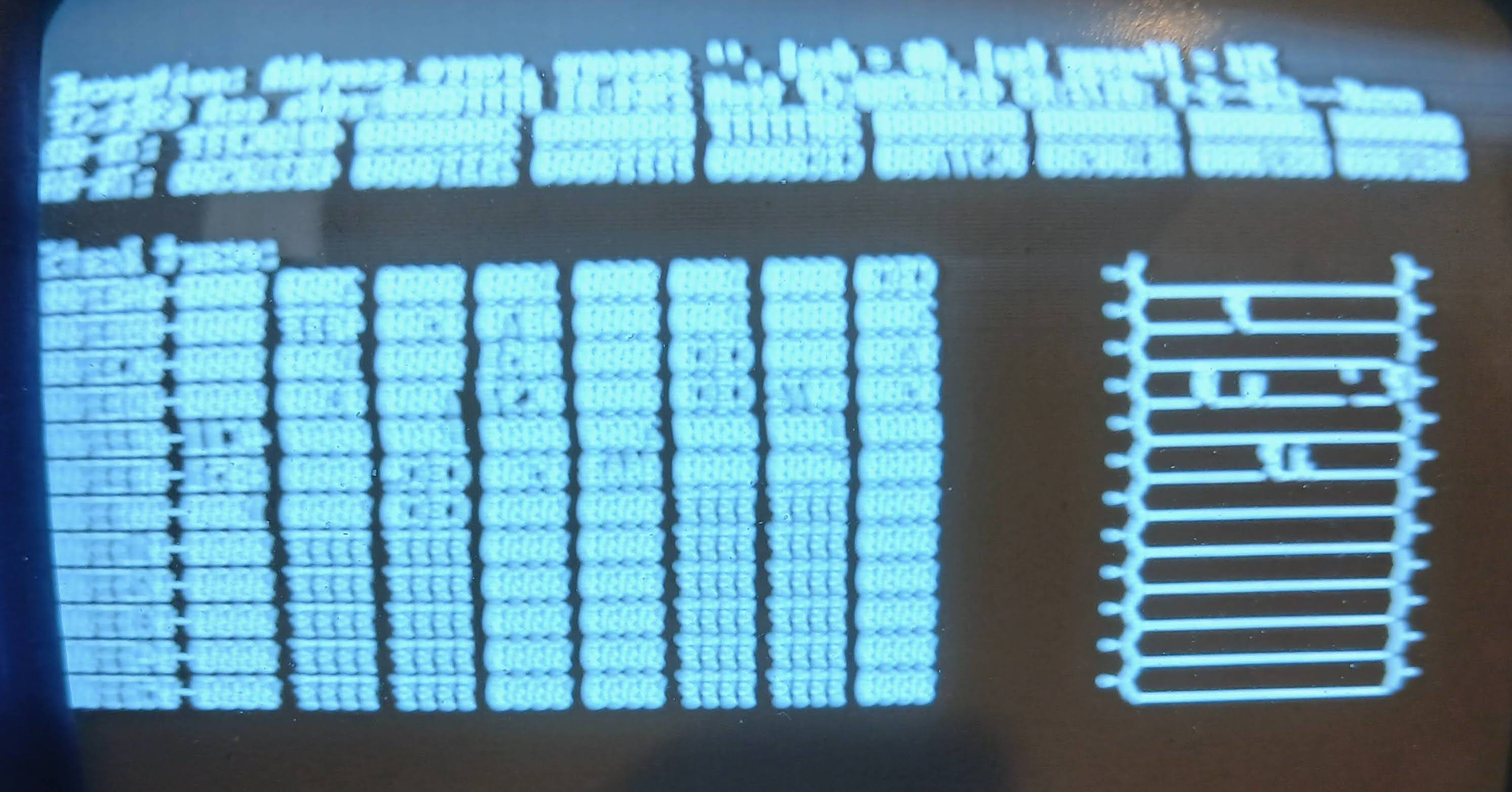

    I asked forthnutter to send the JEDEC fuse map he compiled with WinCUPL, to compare it with the one I compiled with eqn2jed.
    There was one error in the fuse map defining the green pin behaviour, but not enough to cause the complete lack of pixels on all but the right-hand column of characters.
    There were major differences in the configuration bits. WinCUPL had specified signature bits, while jed2eqn had not specified any. Also, jed2eqn had cleared fuses to ignore unused rows, which saves power. WinCUPL had left them set.
    So apart from current consumption and the minor bit error, forthnutter's GAL should have worked exactly as mine did.
    Forthnutter is using his original PAL chips and his display is working. I had tried them, without success, but that was before I swapped /CE and /OE drive signals on the Flash ROM chips. So I tried them again.
    The behaviour is not stable, but significantly better. It usually briefly displays the sign-on screen, which is very blurred and has individual letters horizontally reversed but should look something like this:
                     Applix 1616/OS V4.5a  Level 0 reset
                  Copyright (c) 1987-1991 Applix pty limited
                                 Andrew Morton
                         Compiled: 25th February 1991
                           ROM checksum: $5710FFC2
                        24K RAM disk,  32K video memory
                    0 drivers occupying $0 bytes at $6F1C0
                        System processor: 7.5 MHz 68000
    Switch 2 open: ;using SA: for console
    It then jumps to the usual  Motorola 68000 exception crash dump screen.
    Another improvement is that it doesn't keep rebuilding an exception screen over and over again.

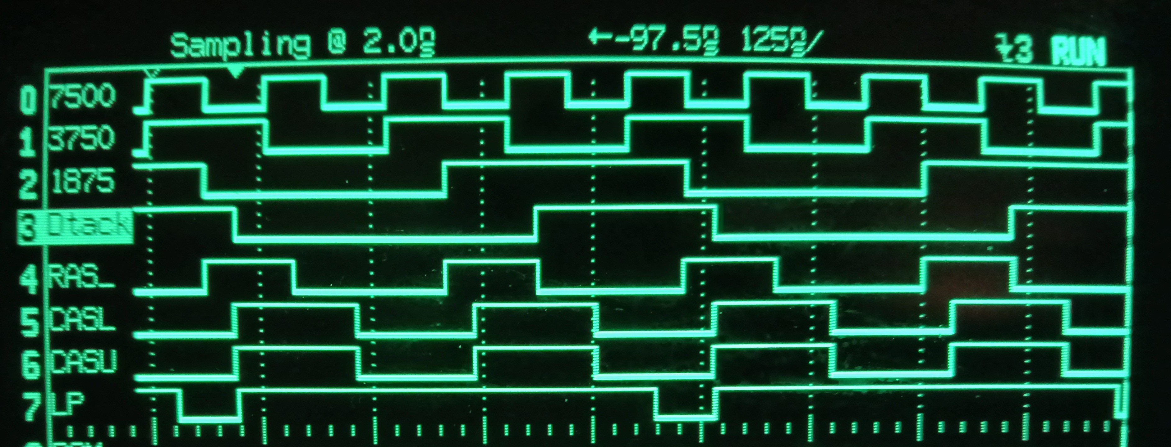

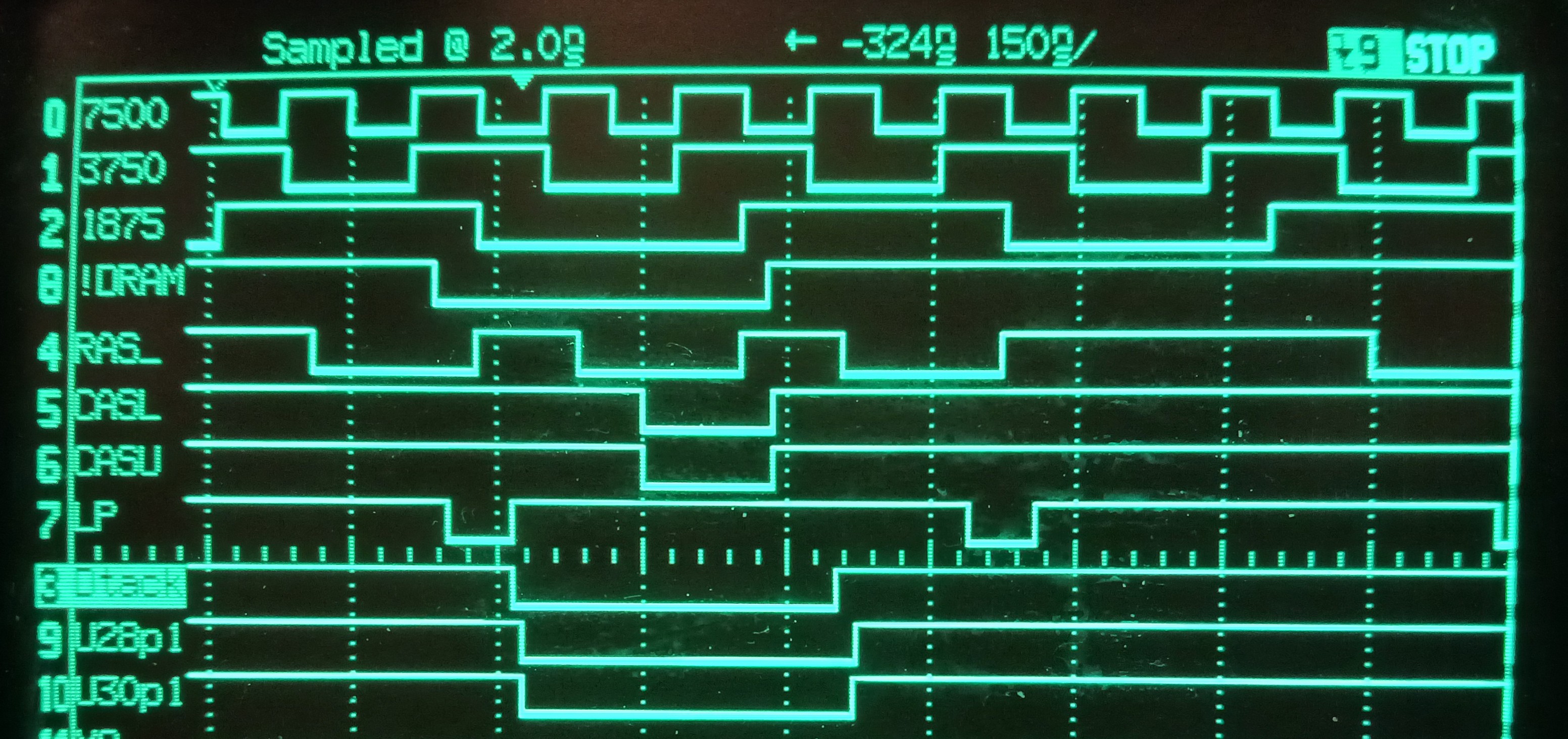

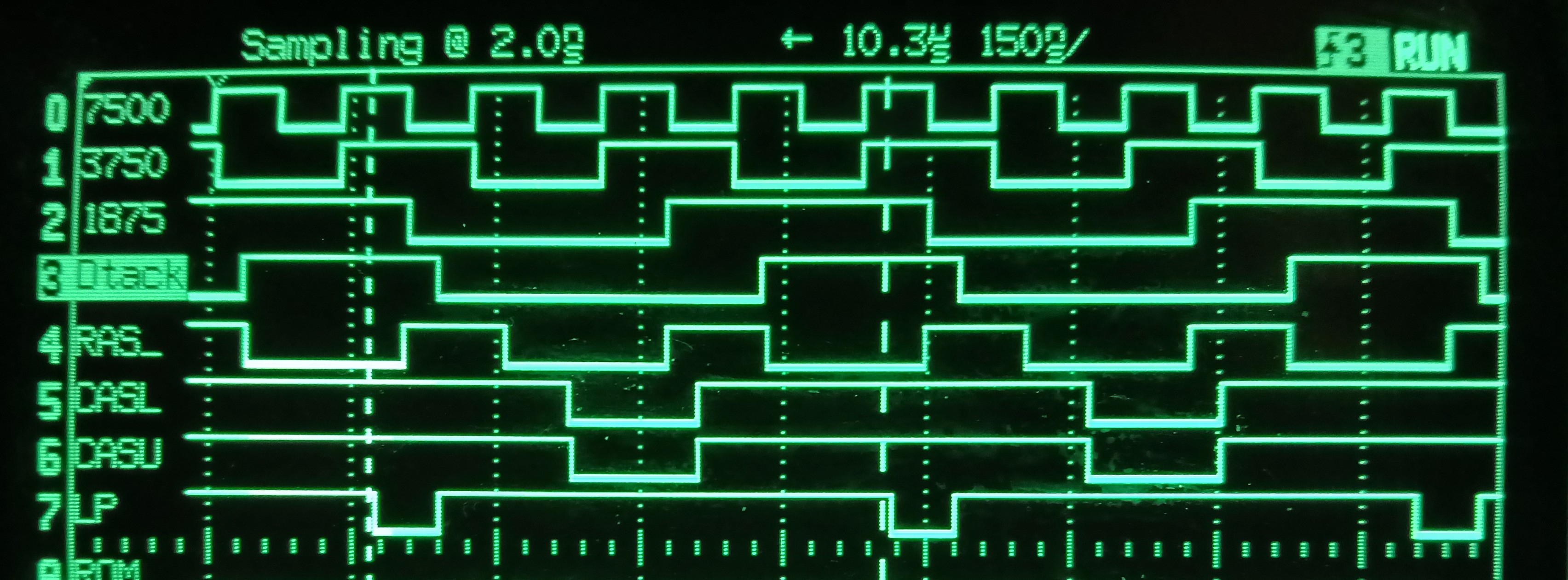

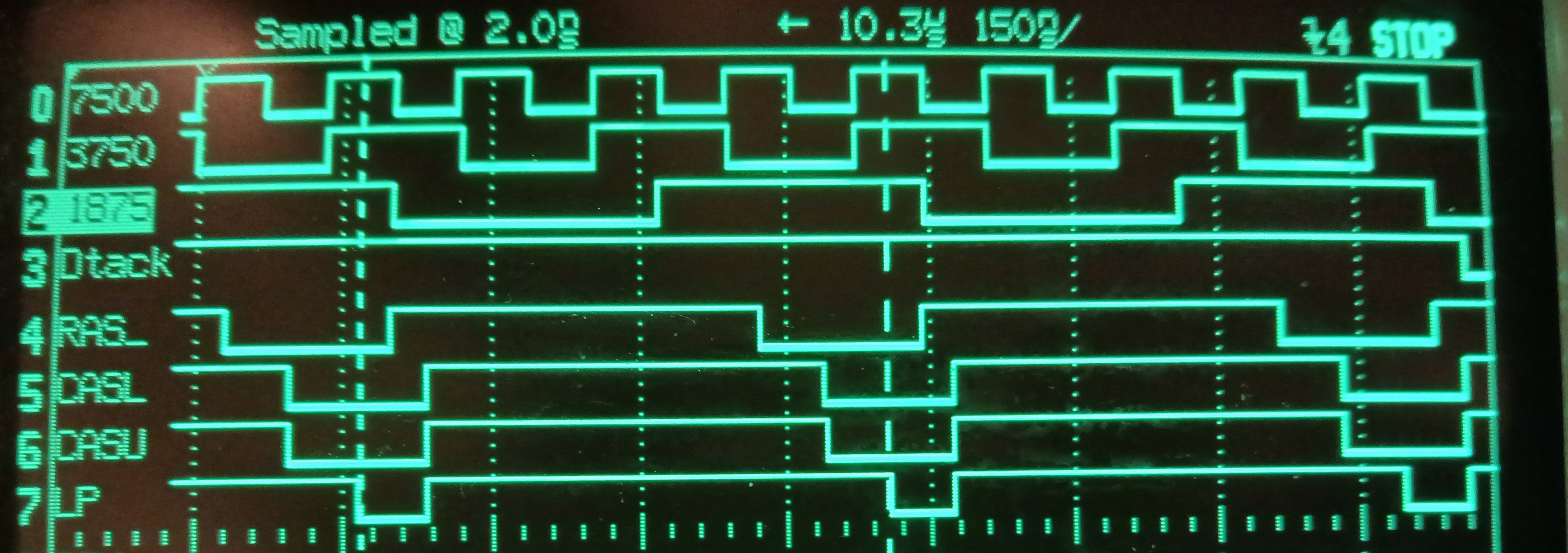

    There are times when a logic probe just won't cut it, and this is one of them.
    Time to get the big guns out, in the shape of my 500MSPS logic analyser.
    Having a look at the outputs of the timing GAL, things look as expected. The 15 MHz clock in is divided to 7.5 and 3.75 MHz. This is divided again to 1.875 MHz, slightly delayed, to be the CRTC character clock (CCLK).
    The /RAS, /CASL, /CASU and /LP signals have the right timing relationship. The image below shows the video accesses reading upper and lower bytes at the falling edge of CLCK. It is okay for /RAS to rise before /CAS, this does not end the cycle early.
    /DTACK is only used to tell the CPU that data is ready. The CRTC is synchronous and runs whether data is ready or no. So /DTACK is idle for video access.
    Video cycles only:
    Now let's set the trigger to /DTACK, which is the timing GAL telling the CPU that data are ready.
    CPU cycles:
    Here we can see CPU accesses taking place. Again this looks good, /DTACK is low during /RAS and /CAS of the CPU access.
    Both cycles:
    Here we can see both CPU and video accesses taking place. Again this looks good, /DTACK is low during /RAS and /CAS of the CPU access.

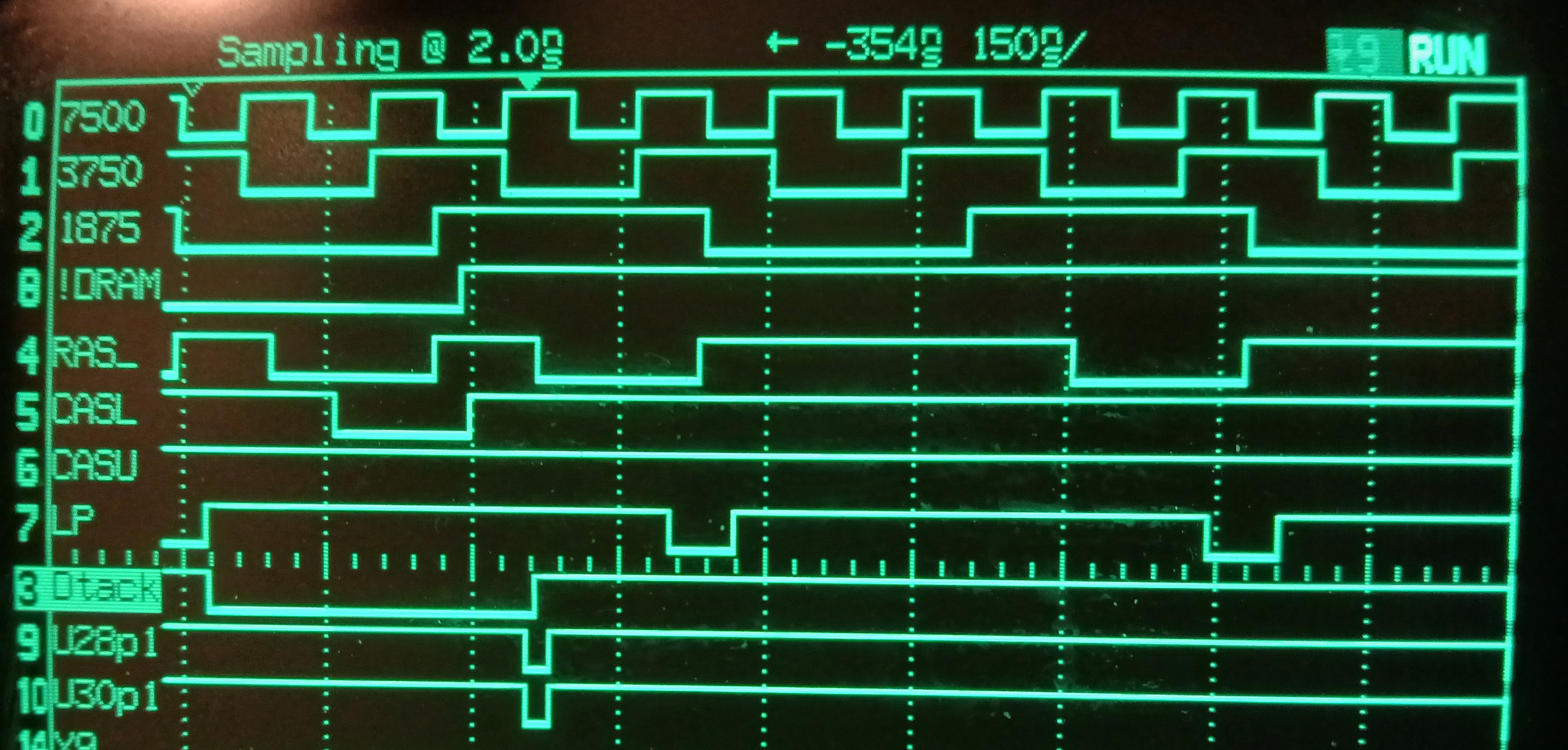

    DRAM Data Bus Enables
    Sometimes they are long, like this:
    I'd say these were normal. This looks like a CPU reading 16 bits.
    Often they are very short, like this:
    In the image above, only /CASL is asserted, so the CPU is accessing a lower byte. And writing, because /BDRE (U28 pin 1) is high. The data bit are written to the RAM while /CAS is low, so the brief /BDRE pulse should cause no conflict. I'd say these are glitches, but harmless ones.

    Decoupling seems to be very sparse. There are no 100n decouplers for the CRTC and SCC which are the most current-hungry chips, judging by their warmth. The CPU and the 6522 VIA have only one 100n cap between them. U16 and U24 have no decoupler at all.
    These caps added underneath:
    This cap added on top:
    This did not cure the problems. Usually just crashed with random garbage on screen.
    Sometimes I got what looks like a top line of garbage:
    Possibly text:
    Or several lines of text:
    I'm guessing this one is some kind of register dump. Registers on the 3rd and 4th rows, flag dump on the right of the 2nd row. Perhaps users with working machines can recognise what this screen is. AI suggested it to be a Motorola 68000 exception crash dump screen with something like this kind of text:
    Exception: Address Error      SR=$2700  PC=$00014B20
    Vector: 03  Instruction: 4E73   (Note: S=Supervisor, I-L... )
    D0-D7: 00000000 0000FFFF 00000000 00000000 0001C120 000021A4 00000000 00001000
    A0-A7: 00FF0000 00001F24 00000000 00000000 0001D1A2 00FFFFFF 0000E000 00FFFE00
    Stack Frame:
    00FFFE00: 0000 0001 4B26 0003 4E73 0000 0000 0000    [ ....K....Ns.... ]
    00FFFE10: 0000 1F24 00FF 0000 0001 C120 0000 21A4    [ ...$....... .!. ]
    00FFFE20: 0000 0000 0000 1000 0001 D1A2 00FF FFFF    [ ............... ]
    00FFFE30: 0000 E000 00FF FE00 0000 0000 0000 0000    [ ............... ]
    00FFFE40: 0000 0000 0000 0000 0000 0000 0000 0000    [ ............... ]
    00FFFE50: 0000 0000 0000 0000 0000 0000 0000 0000    [ ............... ]
    00FFFE60: 0000 0000...

  • Flash ROM issue fix
    Keith07/27/2026 at 17:37 0 comments
    When examining the piggy-back SRAM idea, I noticed the original design used this wiring:
    R/!W --> inverted --> ROM !CS
    ROMSEL --> inverted --> ROM !OE
    This was a way to reduce EPROM access time. It would be activated early on, and then take only the shorter output buffer switch-on time to provide the data when selected.
    Flash ROMs are not exactly like EPROMs, because they want the address to be stable while they are selected. If not, they internally start accessing a garbage address then try restarting when the address changes. With the original wiring, every read cycle will start an access.
    This probably explains why start-up tests that didn't involve the DRAM were not reliable. Most of the time, a test would run for seconds, but then crash.
    At this point, I could either try using a 32-pin EPROM, or try swapping the !CS and !OE wires over.
    This would ensure the address is always valid (!AS asserted), and as a bonus the !OE signal could be shared with piggy-backed SRAM chips.
    I only have 28-pin EPROM chips so I'd have to modify tracks. And if I have to do that, I might as well save a step and modify tracks to suit the Flash ROM.
    Here are the mods to be made on the underside:
    Cut tracks at the red Xs, then make the purple wire.
    This isolates the pin signal from !CE and routes it to !OE.
    Now we need to isolate the signal that goes to !OE and route it to !CE.
    Make the yellow wire to drive !CE.
    Then turn over and cut the track marked with a red X.
    Switch on, some tests running.

    All chips for minimal system in.
    Power, ground and all chips on the left of the 6522 seemed shorted when buzzed, but hi-z when resistance measured. Multimeter battery measured 2.2 volts, so changed for fresh and the buzzed-shorts went away.
    Applied power. No magic smoke. Power LED on. Current draw is 1.16 amps (CMOS CPU fitted).
    Next step: apply logic probe to check signals that should be pulsing are actually pulsing.
    Frequencies on pins 17, 18 and 19 of the timing PAL are correct.
    Frequencies on the CRTC chip:
    VSYNC (40) = 50 Hz
    HSYNC (39) = 15.625 kHz
    DE (18) = 10000 = 200 * 50 Hz
    CCLK (21) = 1.875 MHz
    DRAM /RAS (4) = 1.841 MHz
    So it looks like the system got as far as running the code in the ROM to initialise the CRTC.

    2026-07-16
    Kludged a phono socket on, fed it to a small TV.
    And here is the video:
    The startup switched are all open, selecting video with minimal RAM disk.
    If switch 4 is closed, selecting serial port, the video is not initialised as above. If the RAM is not working then it probably won't be able to call serial I/O subroutines properly.
    I'm using a 29.5 MHz oscillator so the timings are proportionally slower, and these small tellies never had great timing.
    Looks like the CRTC has been initialised, but not the video RAM. The video patterns look like DRAM start-up.
    Removing or swapping the ROM chips has the same effect, no video. So I believe the CPU is waking healthy enough to program the CRTC.

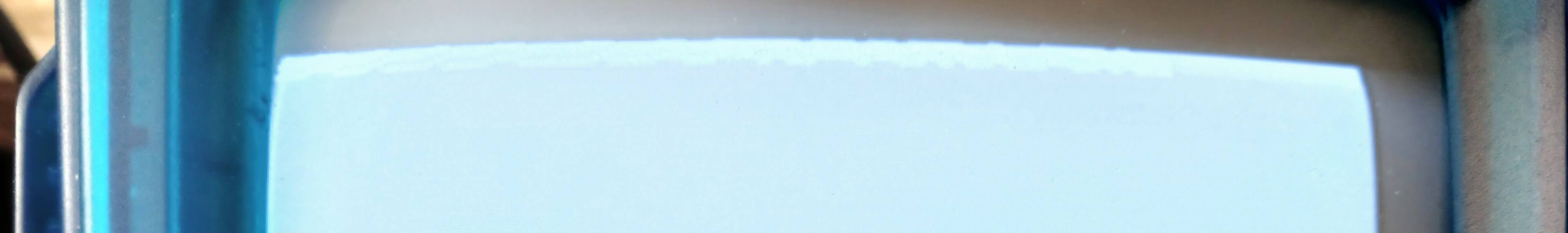

    If all RAM chips are removed, the pixels are all white. Which suggests the DRAM bits are being read and the shift registers are working.
    Removing all the RAM chips, and shorting individual data outputs to grounds should produce dark narrow vertical lines. It does for most, but not IC47, 73 and 74.
    I then notice I have 18 RAM chips, not 16. IC47 is listed as a spare, and IC74 is not listed at all so presumably this is a spare too. So that leaves IC73 suspect. If pin 14 is connected to a known-good ground, the vertical stripe appears so it is connected to the shift register. Pin 16 is not connected to ground.
    Visible bad joint corrected, but behaviour is like before. Occasionally there is flickering of the background, perhaps random writes to the background colour register.
    I also sometimes get this screen mode:

    My first though was to put some resistors in series to drop the 5V RGB signals to 0.7V and feed them into a SCART socketed TV.
    The RGBI and CSYNC drive a resistor DAC, but CSYNC also pulls down the RGBI pins a bit. No problem to a digital monitor, which still seems them as logical 1 or 0, but it does affect levels going into an analogue display.
    Computer designers never seem to be good at video circuitry.
    The connector pinout is the same as the CGA standard but I don't want a bulk old monitor around, even if I could obtain one.
    I only want to check the 1616 is alive. Composite video seems the least effort and simplest cabling.
    I'll design some decent video circuitry some other time.

Having merged and hex dumped the ROMs, I found the text:
Applix 1616/OS V4.5a, Compiled: 25th February 1991
