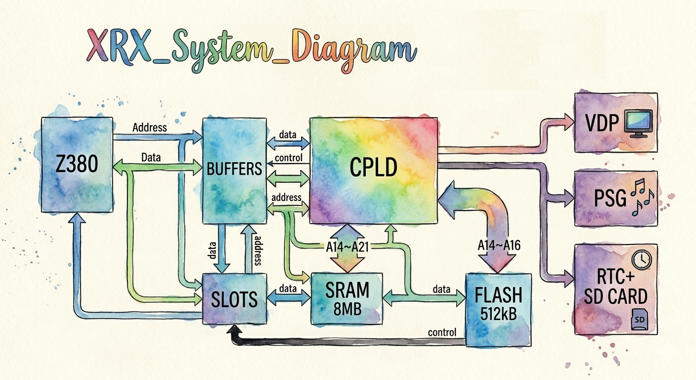

XRX - eXperimental Research X
Another homebrew computer based on the MSX standard. But it uses a Z380 microprocessor.
The goal of this project is simple: to build a machine that is as compatible as possible with the MSX standard, using as many modern components as possible, but without resorting to an FPGA.
The story behind this project is an interesting one. For various reasons (some accidental, some not), I’ve lost it three times already. From floods that swept everything away to the theft of my CD collection (along with a box of floppy disks).
But this time the board is ready and, would you believe it, it’s up and running!
My idea is to have a computer almost as if it had been made in 1994, but using components that are still being manufactured. Unfortunately, the Z380 itself went out of production a few years ago, but as I had a few, I decided to go ahead anyway...
Here are some technical details:
- Zilog Z380 microprocessor
- 14.32 MHz maximum clock speed
- 8MB fast SDRAM
- 512kB Flash memory
- V9958 Video Display Processor
- Composite and S-video output
- AY-3-8912 Programmable Sound Generator
- Mono headphones output
- 2 joystick ports
- 2 MSX-compatible primary slots
- RTC emulated
- SD-Card
- ATX compatible power connector
- mini-DTX board form-factor

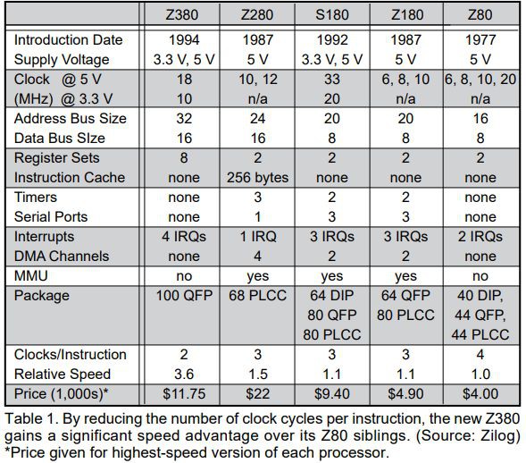

080901.pdf
Microprocessor Report - July 11, 1994
Adobe Portable Document Format - 334.08 kB - 06/13/2026 at 21:17

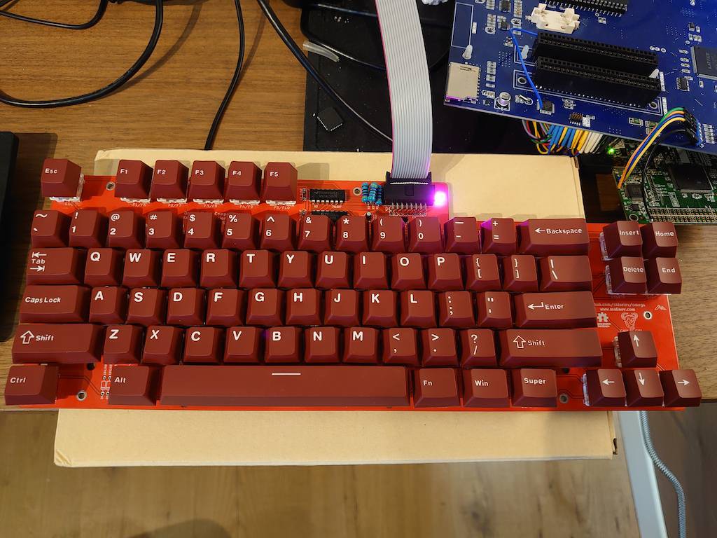

    Well, now I have a keyboard. Sort of.
    It's the same keyboard as the Omega MSX, but using some old components that I found lying around here and the keys are not Cherry ones, but the cheapest model I found. Maybe that's why they're misaligned...
    And does it work? No.
    But it's not its fault. Something is wrong with the PPI line selection signals. But this is an investigation for next weekend.

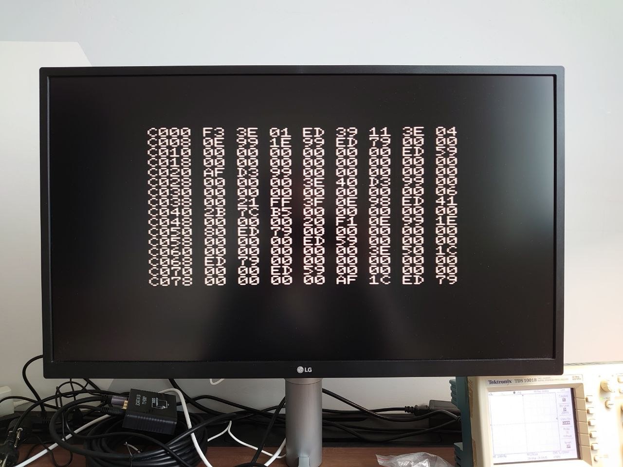

    I burned the BIOS and the sub-ROM to Flash memory and… garbage.
    And not even the kind of garbage that’s one person’s treasure. Random garbage, different with every boot.

    The code copied into RAM refused to run. It wasn’t a “spectacular failure”—it was worse. It would run, return, and politely spit out garbage. Always the *same* garbage.

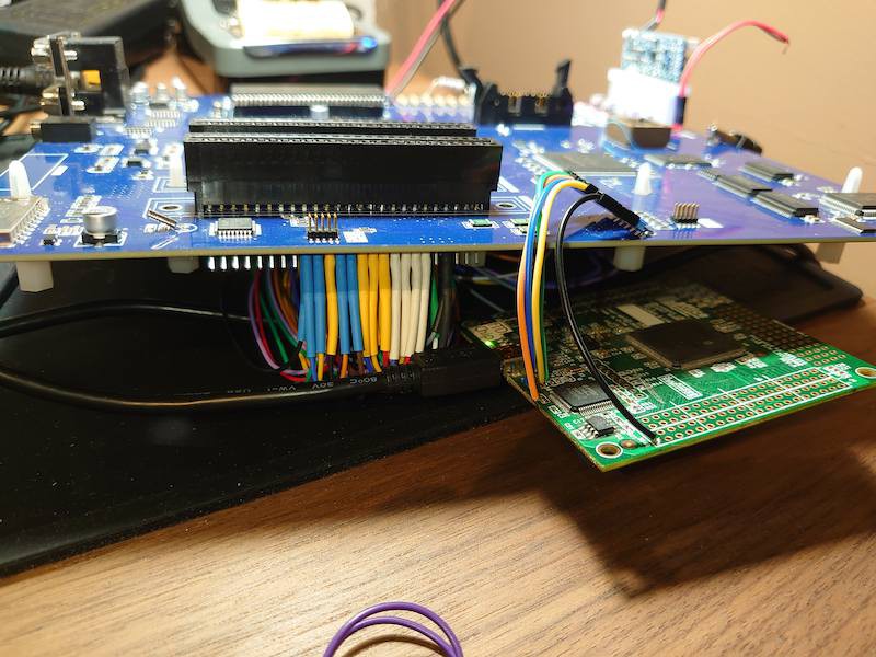

    I had to connect almost all the cables on my data analyzer. It looked great on the board; I had to solder a few terminals on the underside… but the data analyzer finally revealed what was going on. The Z380 writes individual bytes using address parity: even bytes here, odd bytes there. But when it *fetches words*—and fetching instructions from RAM is always done in words—it uses aligned addresses. My SRAM had its A0 pin connected directly to the CPU’s A0 pin, so that bytes written one way couldn’t be found the other way. Two parallel worlds—the world of bytes and the world of words—sharing a single chip and never agreeing on where things were. And here I was, thinking I’d eliminated all the bugs from the schematic.

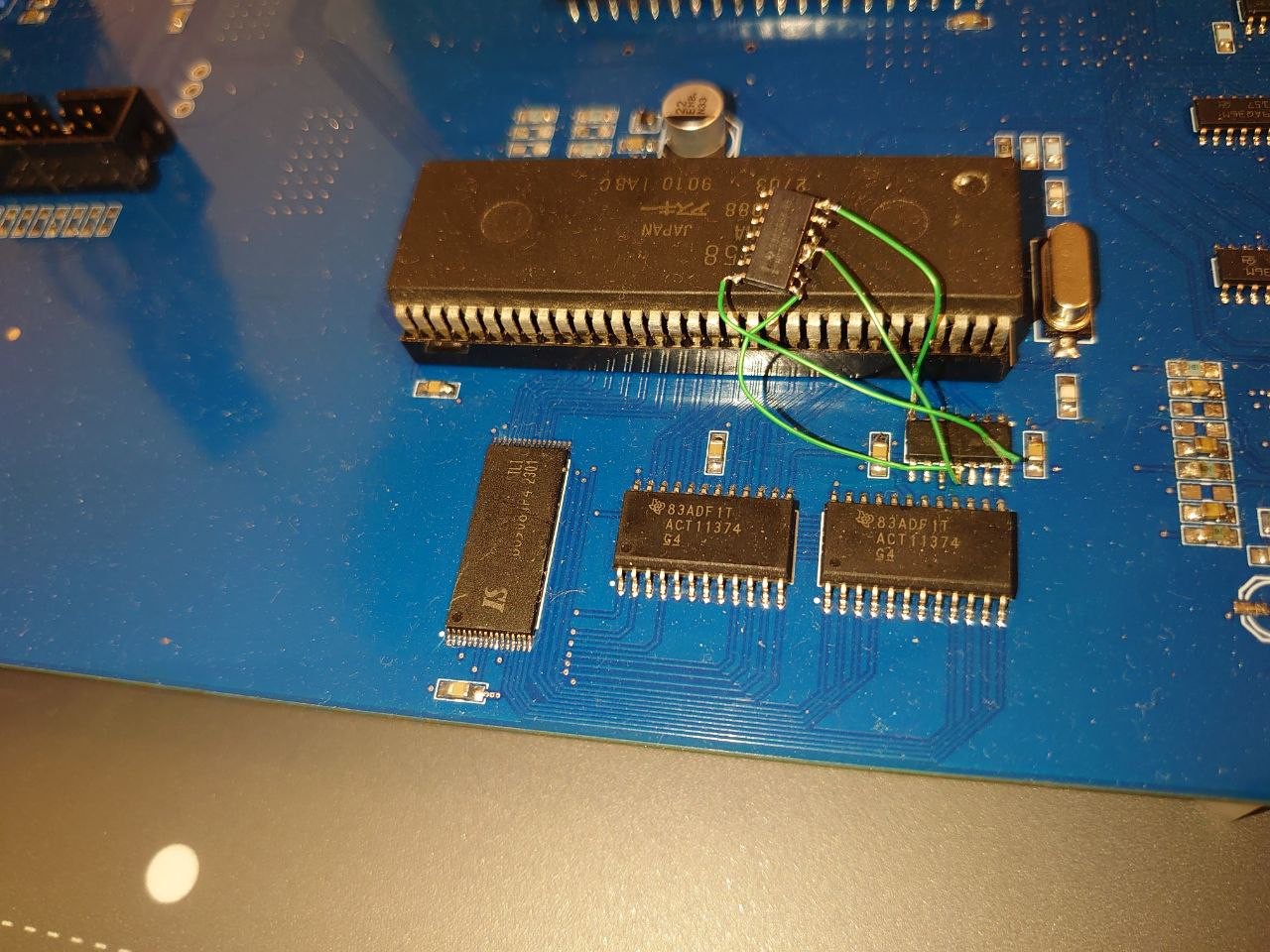

    "Quasi-gambiarra"

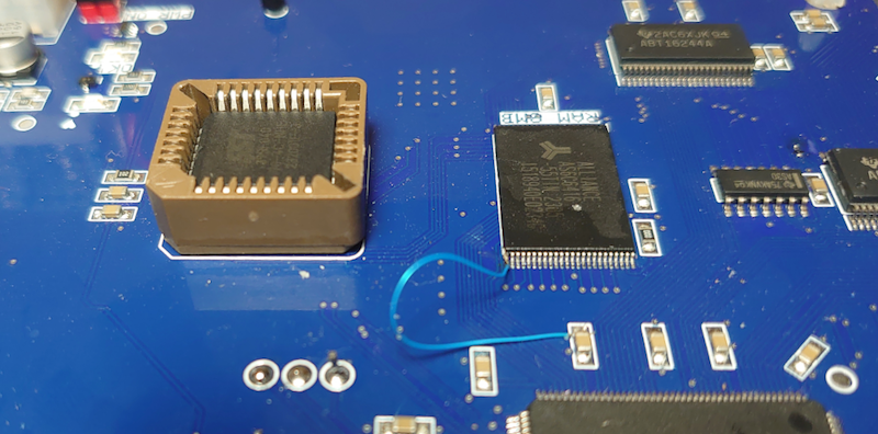

    Every byte the program wrote to an odd-numbered address simply *didn’t exist* for the instruction fetcher. The C-BIOS copies its slot-switching routine to RAM and jumps to it. You can imagine how that turned out.
    The solution? A wire. I lifted pin A0 on the SRAM (remember: 0.50mm pitch, no microscope), soldered it to ground, and let the byte enable signals do their job. In Brazil, we call this a *gambiarra*, and I’m not ashamed of it. Well, maybe a little, but it’s a temporary fix.
    "Gambiarra"
    "Gambiarra"

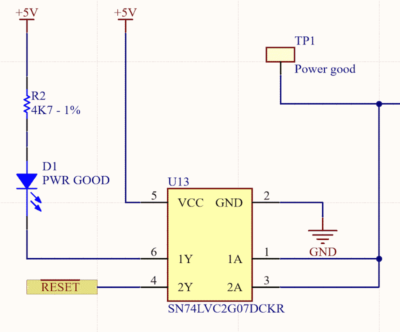

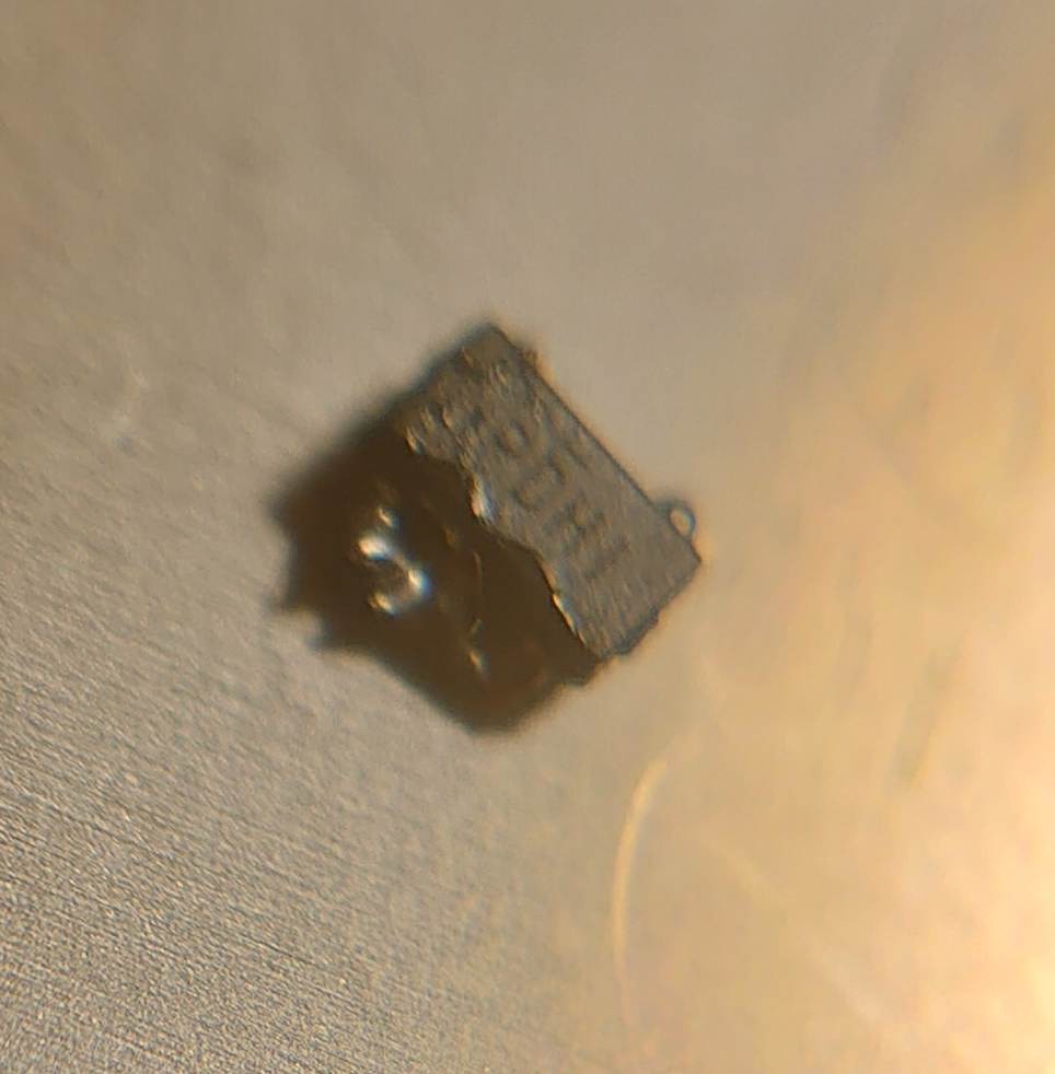

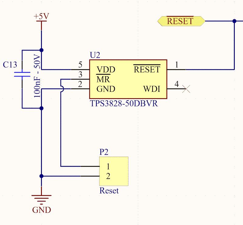

    In the XRX, I use a voltage monitor chip from Texas Instruments, which also serves as the input for the reset button. It’s the TPS3828.
    If the supply voltage drops below 4.55V (typical), the chip generates a reset signal for the circuit. In addition, during power-up, it also ensures a 200ms reset pulse.
    Reset circuit
    No watchdog for you today
    The watchdog function, although present, is not being used in this project.
    Well, it turns out that the board would randomly reboot on its own. It didn’t happen all the time, but it did happen.
    There’s another reset trigger in the circuit, coming from the power supply. The “Power Good” signal is buffered and can also trigger a reset, but the oscilloscope showed everything was normal.
    Maybe I should name this LED "Power NOT Good"
    The supply voltage also didn’t goes down 4.55V—it didn’t even come close to that. So, what could it be?
    Using the old “put your finger on it and see if it burns” technique, when I touched one of the pins on the reset switch connector, the board rebooted. A missing ground? It didn’t seem like it, but I resoldered the connector anyway.
    The problem persisted.
    I decided to replace the TPS3828, using the one from the old board. And… it worked.
    TPS3828 removed from the board
    It looks like an original chip, doesn't?
    This is something to keep in mind when producing this board… but, for now, I can continue with my work.

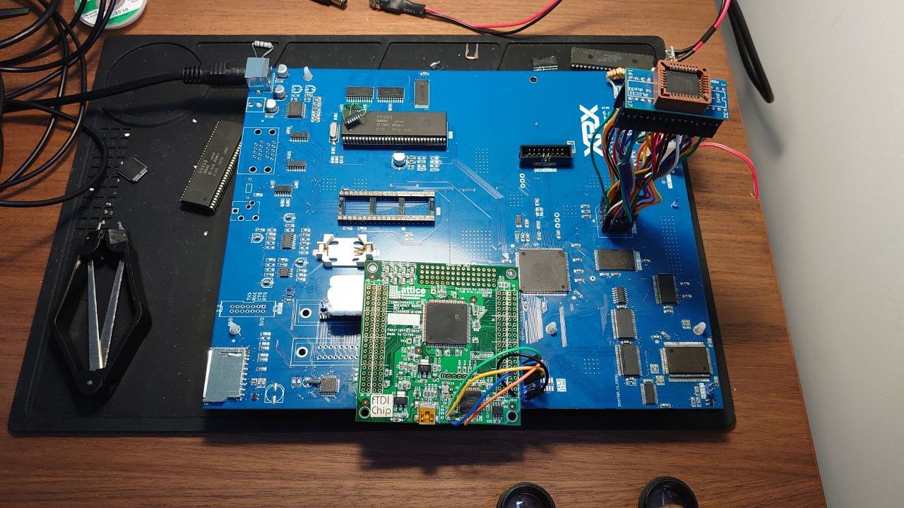

    I spent weeks—several weeks—trying to figure out what was going on.
    I wrote a very simple program that toggled a keyboard pin, and, of course, it wasn’t working. But it SHOULD have worked.
    Using a data analyzer, I monitored the address bus, the data bus, and some control pins on the Flash. And it was really impressive to see just how much more advanced the Z380 was compared to the Z80. Of course, you already know this from reading the manual, even though the manual is pretty superficial. But it’s one thing to read about it and another to *experience* it.
    Instructions executing in just a few clock cycles, the I/O bus completely separate from the memory bus, the internal (“phantom”) registers that simulate an instruction fetch cycle… it was an invigorating experience. So much so that I asked the chip’s architect for an autograph (more on that later).
    During that time, I discovered two things. The first is that I had completely messed up the pinout of the Flash memory socket.
    The second is that I had routed the SRAM data pins incorrectly.
    <<Insert happy face here>>
    This took me some time because the ROM is accessed in bytes; so to read a 16-bit value, the Z380 uses two fetch cycles. RAM, on the other hand, is accessed in 16-bit words, meaning that to read the same value, the Z380 uses only one fetch cycle.
    Since the ROM can be accessed in both slot 0 and slot 3, I spent my time looking for issues in the Verilog code for the slot selector, instead of focusing on the hardware.

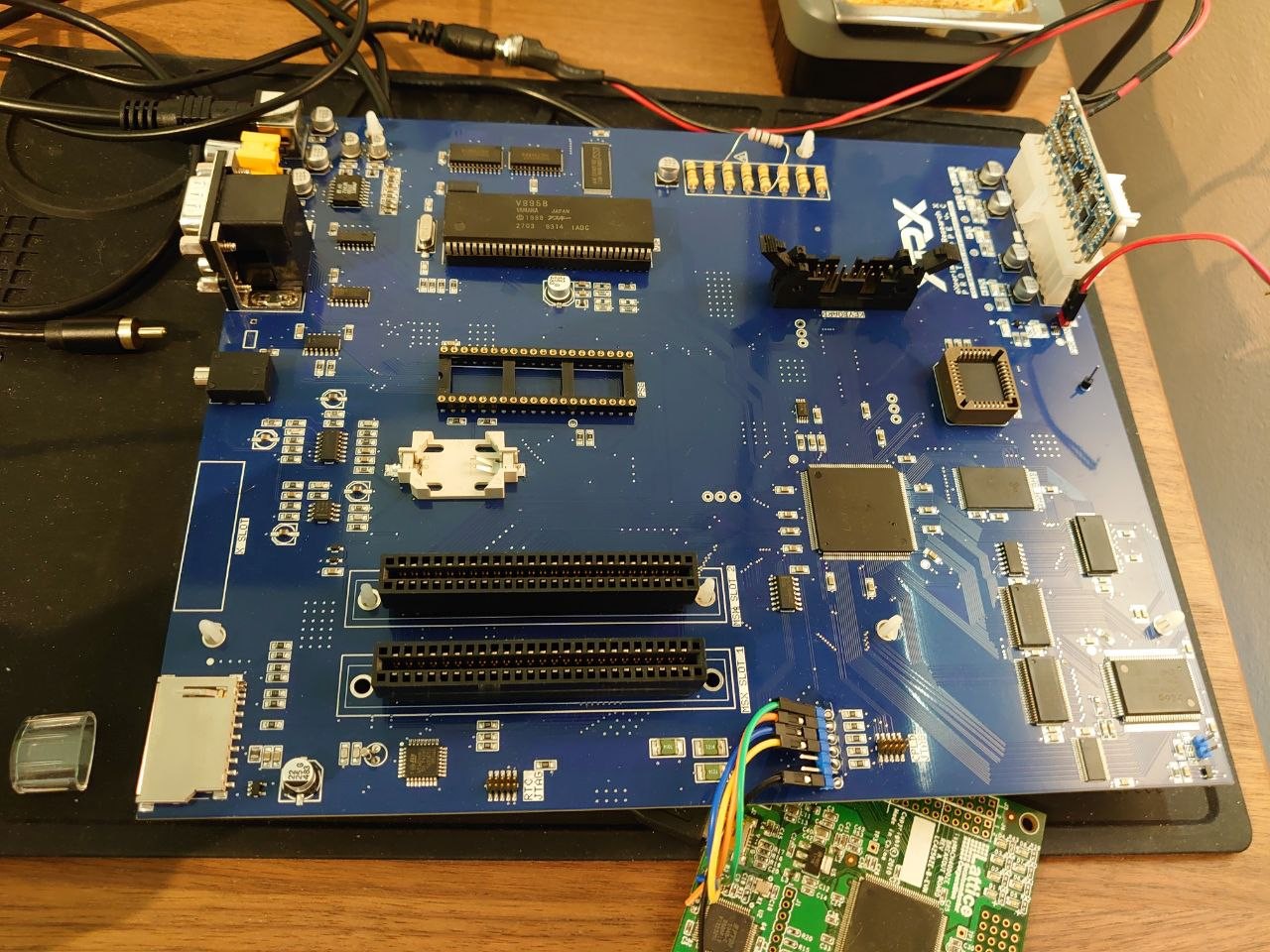

    I redesigned the board (still without the “X-Slot”), taking the opportunity to fix a few other minor slip-ups. One of them I later regretted: I had planned to include a UART, which would be implemented by the same microcontroller that would simulate the RTC. If I had kept that “feature,” my debugging sessions with the new board would have been much easier.
    Anyway, I also decided to have the board assembled by the supplier (I won’t mention the name here because they aren’t sponsoring me… but you know who I mean). For the first two versions, I soldered the components myself. But let’s face it, I’m past that age. I don’t have a microscope here, and soldering components with a 0.4mm pitch… so I took the easy way out.
    You know that column of resistors? Yeah, we haven’t talked about it yet. We will, but not today.
    That saved me A LOT of time. Instead of spending days looking for a defect that wasn’t in the Verilog code or the assembly code, but rather a smudge of solder under a CPLD pin, I was now pretty sure the hardware was right. Or rather, I was sure that the board I had in my hands was exactly the one in my CAD.
    But I was now facing two problems. While the hardware was reliable, there were still the Verilog code and the assembly code to consider. Despite the verification and simulation, the CPLD was programmed to do what I *thought* it should do, with several “shortcuts” to save a few logic gates. And since the first attempt to...

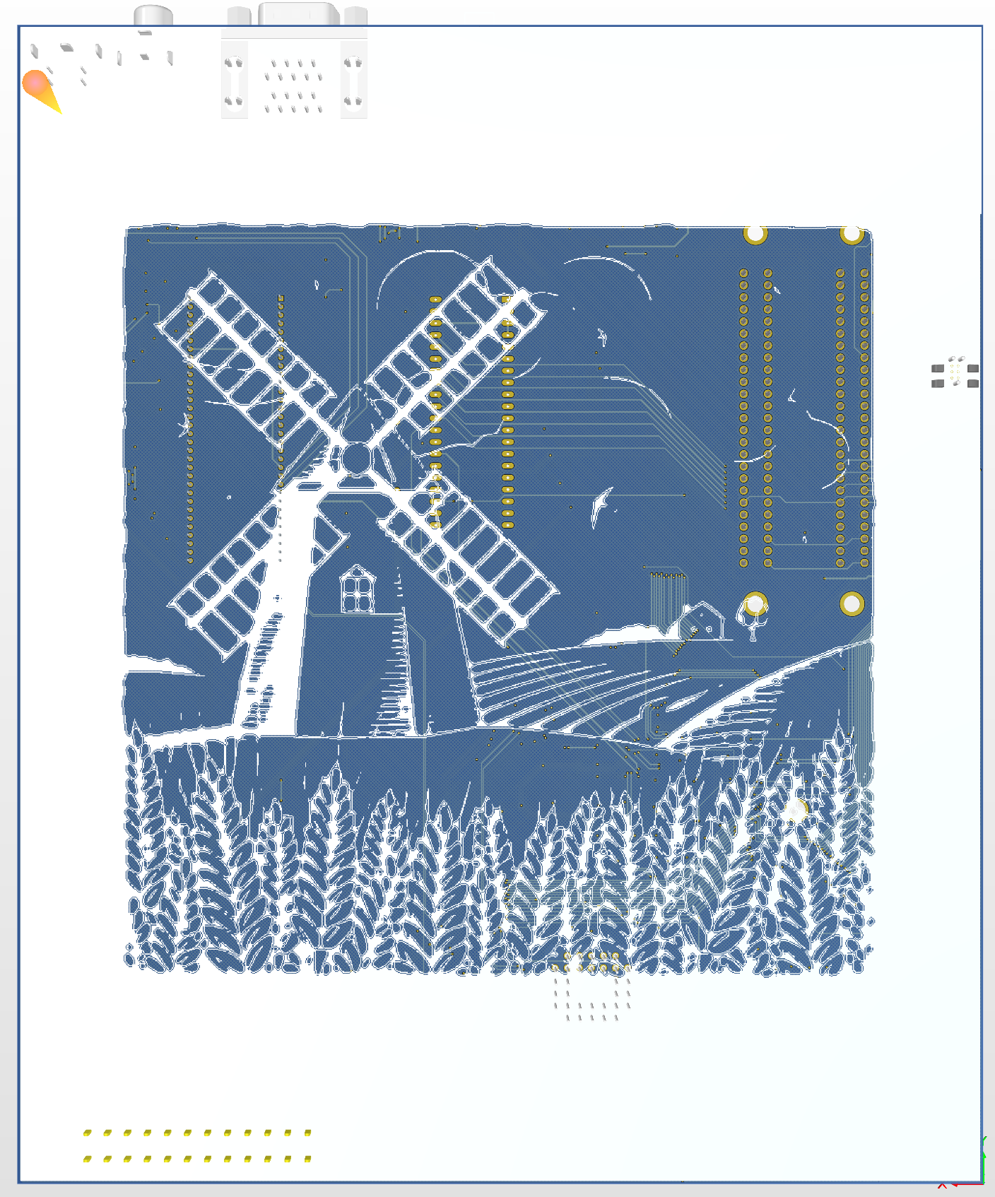

    I wanted the PCB to fit into a modern chassis, so it would have to be a standard size. ATX is too big, mini-ITX is too small. How about DTX? It’s not that common, but it would give me room to use other chips (V9990, I’m talking to you).
    But I’d have to make a choice: a VGA connector or a new slot with the Z380 signals? Both wouldn’t fit on a board that size.
    After much thought (well, not that much), I ended up deciding on the new slot (“X-Slot” is a completely innovative name, don’t you think?). A 1994 MSX *might* already have a VGA connector, but it would certainly be better to have a slot with the BUSRQ and BUSAK signals.
    So, all that was left was to choose the composite video generator chip. The Omega MSX uses the Sony CXA1645, but this component is no longer manufactured and, due to the project’s philosophy, couldn’t be used. I mean, I could have… after all, the PSG, the VDP, and the Z380 itself have already reached EOL. But in this case, there was an alternative still in production: the Analog Devices AD724 for a mere $15… :-/
    Well, that’s that. A quick look at the datasheet, everything seems fine. I can use the VDP’s CSYNC signal as a sync source… I can choose between NTSC and PAL... I can use the 3.58 MHz clock because the chip has an internal PLL… okay, everything checks out.
    “How hard can it be?”®
    It turns out there’s a small detail in the datasheet: the input signal needs to be *interlaced*. And even though the V9958 is capable of generating an interlaced video signal, I don’t believe MSX action games were designed with that in mind.
    In any case, it’s too late to change now.
    It took me a while to figure out why there was no image on the monitor, even though I was measuring a video signal with the oscilloscope. And when you’ve been poring over a problem for a long time, you end up seeing ghosts.
    After enabling interlacing generation in the VDP, things got a little better.
    But only a little.
  • The other side
    Marcellus Pereira06/14/2026 at 12:09 0 comments
  • The CPLD rabbit hole
    Marcellus Pereira06/14/2026 at 09:55 0 comments
    Well, the main idea was that this project wouldn’t use FPGAs. It’s not that I’m against hardware synthesis—I think it’s an incredible idea that makes many advanced projects technically and financially feasible. But I wanted to build this machine exactly as I envisioned it more than two decades ago.
    Even the AI thinks I wasn’t quite in my right mind when I decided to take on this project.
    However... using dozens of logic chips these days doesn’t seem like a good idea to me either. So, I settled for a middle ground: I used a CPLD as “glue logic.” The question was: which one?
    I wanted to use a CPLD that:
    0. didn’t use a BGA package.
    1. had enough logic elements. How many? I don’t know.
    2. had 5V-tolerant pins.
    3. had free development tools (they didn’t even need to be open source).
    The biggest problem, in my naive optimism, was how to know if the number of logic elements would be sufficient. Knowing that the Z380 would access the VDP at four times the speed (considering only the clock, without taking the pipeline into account), I wanted to have a FIFO implemented between the VDP and the microprocessor. How many logic elements? I don’t know. Would it be possible to do this with a CPLD instead of an FPGA? I don’t know.
    So, the easiest (and by far the most expensive) way was to choose the largest CPLD that met the requirements.
    The choice was the Lattice LC4256V. Part of the ispMACH 4000 family, it has 256 macrocells (that number seems sufficient, doesn’t it?), is powered by 3.3V, but the pins are “5V-tolerant.” In fact, it has 128 I/O pins (that number seems sufficient, doesn’t it?). Lattice provides (provided) the development tool... so, everything seemed fine. Except it wasn’t.
    To cut a long, long story short: not only was it impossible to implement the FIFO the way I wanted (though the VDP data bus is still connected directly to the CPLD), but it was also impossible to implement a memory mapper that controls more than 128kB. I know, I know... maybe it’s my lack of skill with Verilog code. But that’s how it stands for now: 8MB that the program can access linearly, or 128kB accessed via the mapper. I’ll go into more detail about the memory later.
    Well then, CPLD chosen, development tool purchased... the chip in the development kit isn’t exactly the one I’m going to use, but it’s quite similar—what could go wrong? Well, the CPLD in the development kit doesn’t have “5V-tolerant” pins.
    And to make matters worse, I couldn’t use the kit to program the CPLD on my board; I’d have to buy a tool from Lattice or try using an open-source project.
    The final decision was: to create the first version of the board using the CPLD itself (instead of pin bars I could connect to the external kit) and to make a small “hack” to the Lattice development kit so I could use it as a programmer. “How hard can it be?”®
    The CPLD seems to be the least of my troubles, doesn't it?
    After all that, Lattice decided to stop providing free licenses to schools and hobbyists. The ispLever Classic tool now costs 600 euros... for one year! What to do?
    Well, it’s time to reconnect with old friends and catch up with your old college. Maybe they still have some old computers in the digital circuits lab with a valid Lattice license. BINGO! :-)
    Without getting into the legality of the solution, I could now program the CPLD on my prototype board. And considering the cost of the board *and* the components, it would be great if I hadn’t messed anything up the very first time. It doesn’t hurt to dream, does it?
