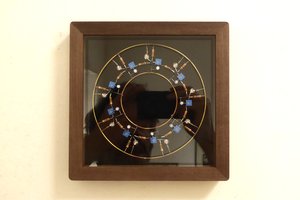

  • Light Dice
    Dr. Cockroach02/09/2022 at 20:05 15 comments
    This project can be found at https://hackaday.io/project/183942-light-dice
    The logic circuit drawing.
    Light Dice, Where Light Logic learns how to roll....
    Enhanced led display. Yes, the board is printed like that :-D
    Putting a ring oscillator, some D latches, a few Nand gates and a dice display together and using only Vactrols. A video and a circuit will be forth coming.
