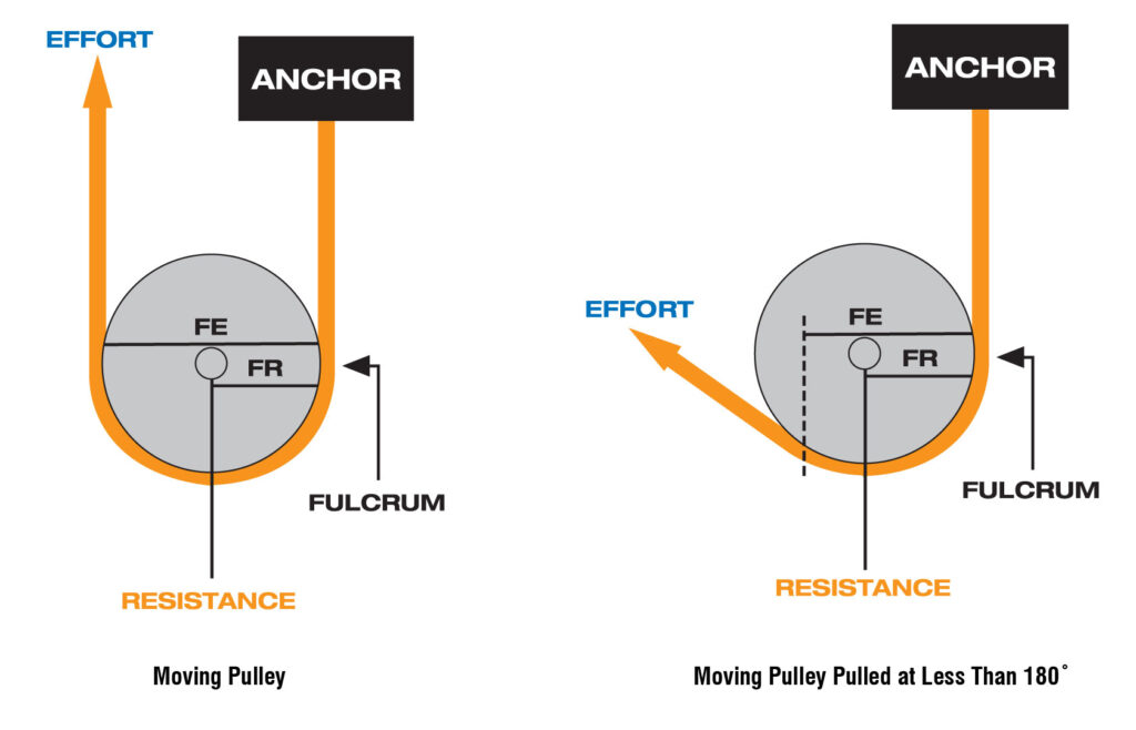

Edit³:
I totally forgot about the mechanical advantage of the pulleys/winches/hoists in the image above, but while calculating the mechanical advantage (aka putting into online calculators), I got a little bit confused with the final result.
You see, if I where to put 3000 newtons (300kg) of force in a 20 cm long lever, which would be a 40cm diameter disk/pulley/hoist, I would be able to lift 30,000 newtons (3000kg) in a shorter 2cm long lever (a 4cm diameter disk).
However, when I insert these values to a torque calculator, it gives me 600 newton meters of torque, with 30rpm, would be 1800 watts of power.
But if I put 1200 kgfcm in a kgfcm to newton meter converter, I get 120 Nm of torque, which with 30rpm, would give 300 watts of power.
Meaning that if I attached a 4cm diameter electric winch to the tip of a 20cm long lever/40cm diameter disk with a rope, I would need actually just 120Nm of torque to lift these 3000 newtons (300kg).
So, or I'm misunderstanding something and reaching to the conclusion of 300 watts of power per limb, or the torque calculator is correct.
This bugged me all day, but I forgot an essential part of the problem: the rpm through the reduction ratio.The 4cm winch drives a 40cm winch with a reduction of 10:1, so, for every 10 rotations of the small one, the bigger one would rotate 1 time.
And so, the torque would multiply 10 times also, so this means that I would still need 60 Newton Meters, not 120 and an RPM of 300, not 30 to be input on the bigger wheel using the smaller wheel.Meaning that in the entire system, there is still 1800 watts being used and transformed through the reduction ratios.
The way I was interpreting this was that I would need to input 600 newton meters on the outside of the outer winch/hoist, which such number is the output of the mechanism.

There is also this picture showing that pulleys have fulcrums and mechanical advantages.
I think I would need to make a conventional reduction mechanism, with a small input driving a bigger input slower, but stronger.

I was also watching James Bruton series on building his Iron Man exosuit, just to see if I can have any ideas on the subject.
In this video in specific, he uses a pulley mechanism that ends in a sprocket for the arm motion.
Of course, I already discarded this idea because pulleys aren't really efficient, neither are precise.
