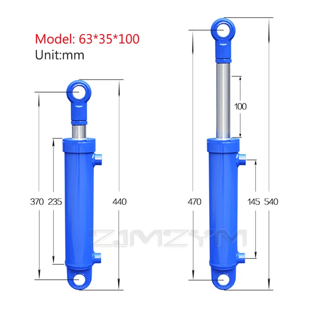

The pistons:Taking into consideration that most of pneumatic/hydraulic pistons cost around 20-50 reais (4-10 dollars), and I would need at least a dozen of those, I don't think it will be cost effective.
And so, I think I will make DIY/homemade piston cylinders for the hydraulic pump.
Initially I didn't want to make these because:
- Precision is necessary for the mechanism to work.
- It is quite labour intensive.
- The cheapest parts are in plastic, but plastic has too much friction.
- Depending on the material, I would need to use expensive tools (like welding machines).

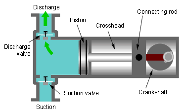

On Project Log 16 I tried to calculate a hydraulic pump using pneumatic cylinders with 16mm of bore diameter and 50mm of stroke because this was the cheapest option, but I believe I will keep the 50mm stroke simply because of the mechanical advantage.
The furthest from the axis of rotation of the crankshaft the piston's connecting rod is, the more torque one will need to make it move.
So I will try to keep this rotating closer to the axis, moving faster, but with low requirement of torque.
Both of the piston's crankshafts are rotating at same speed, but the left one is moving faster, and it has a better mechanical advantage.
One thing that I will also do to increase fluid flow.

Pistons?
Well, you will probably see this as the last part of the project log by the time I finish writing this crap, but I would like to say that this endeavor around McKibben Muscles is probably not worth it.

Normally the 5 ton rated hydraulic cylinders cost around 100 brazilian bucks, but the shipment fee is literally 900 bucks.This is a chonky boy.
Well, I tried this hydraulic cylinder calculator, inserting the values given by the seller on this hydraulic cylinder and the calculator said I would need 1.5 bar of pressure inside of it in order to apply 5 tons of force and a oil flow of 1800 liters per minute to activate it in 1 second. :|
Edit¹:
I just tried the calculator again and it is saying I would need around 157 bars :|
And normally hydraulic pumps can output 30-54 liters per minute under 1750 rpm with 14 hp for 150 bars.
I recalculated stuff, and for some reason I don't know where did I came up with 400 liters per minute, but basically, I would just need 67 liters to pump all the 5 ton hydraulic cylinders.
Again, I misscalculated again.
It is 67 liters in a third of a second under 7.5 horse power (assuming I'm not using the full 5 ton capacity).
This means I would need 4043,52 liters per minute.
This means I would neeed 74 hydraulic pumps under 7 hp each...
This means I would need a 518 hp in total, or a 100hp engine for each limb.
For perspective, here is a video with 400 hp cars:
If I just went with 67 liters per second, I would need 1320 liters per minute, which means I would need 24 pumps.
In the pipe volume calculator it said I would have 0.312 liters inside of this cylinder alone and only 18 liters per minute.
This means that I would need 22 liters to activate all the 72 cylinders and 4043,52 liters per minute to activate all of them in a third of a second...
Which is better than the McKibben muscles... Humm
The problem is that these cylinders are expensive as f*ck and heavy as f*ck aswell...
Each one of those weights 9-10 kg (720kg in total), and on top of that, I can't find any accessible here on Brazil (my country)...

Besides the cylinder calculator saying I would need whatever value, this cylinder has space for 0.100 liters of hydraulic oil.
So, 7.2 liters in total, even this value per second, I would need 420 liters per minute.Which would force me to use 200 hp to make this work. :|

And using this Cylinder Area-Pressure-Force online calculator a 5 cm² cylinder at 12000 PSI can lift 5 tons... Which is exactly the pressure inside a cheap Hydraulic jack.
Now, if a 5 ton cylinder/jack will be more efficient than a Mckibben, I don't know yet, but I'm starting to be concerned with the actual size of the McKibben muscles.
If I make them small in diameter and maintain the length, will it still shorten by 20% in length?Which raises other questions to myself, for example:
Will those cheap DIY hydraulic/pneumatic tubes even be able to withstand such outstanding pressures?The answer is no, normally the maximum value is 300 PSI.
And the hydraulic hoses that are actually for this kind of work costs thousands of Reais...
