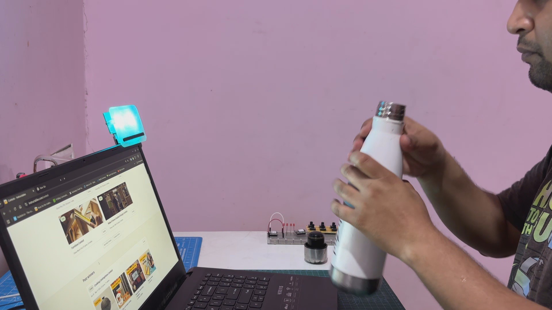

The reason for preparing this project was really serious; I frequently forget to drink water while working. This device ensures that this does not happen because I live in India, where the recorded maximum temperature was around 52°C last year, and summer is fast approaching, meaning that I must take this practice seriously.

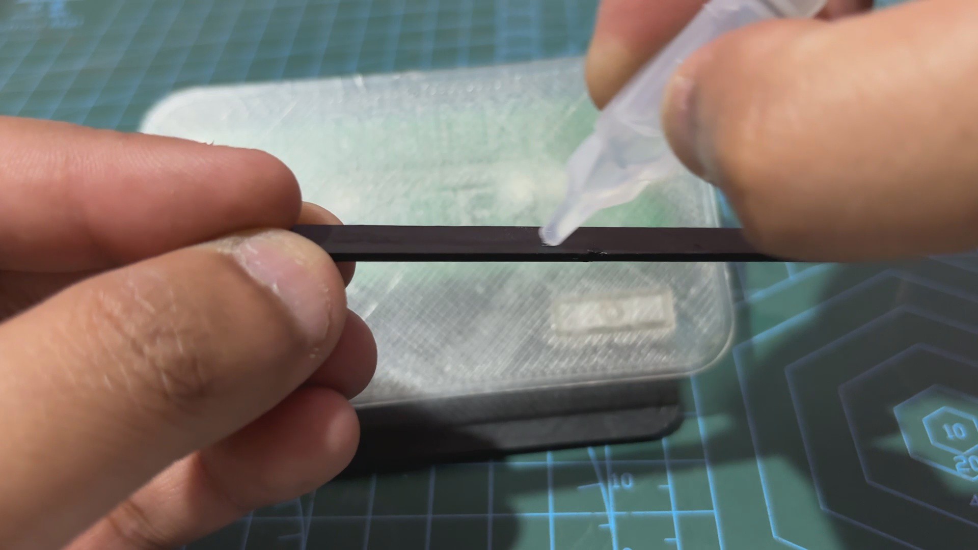

3D DESIGN
The 3D model for this project was quite straightforward; we began by creating the model for the XIAO and WS2812B LED circuit in Fusion 360 and then created a fixture and diffuser-like part that will allow us to secure the setup on top of a laptop. We accomplished this by first making a diffuser part and then connecting the RGB LED circuit to it; the RGB LED will face the diffuser's inner side. For visual emphasis, we also put the phrase Drink Water inside the Diffuser, which will be visible when the LED lights up.
For placing the device on top of the laptop, we created a second holder-like component that will be secured to the rear side of the diffuser with two M2 screws; this component will allow us to position the entire device on the laptop.
Additionally, to add a slight aesthetic...
