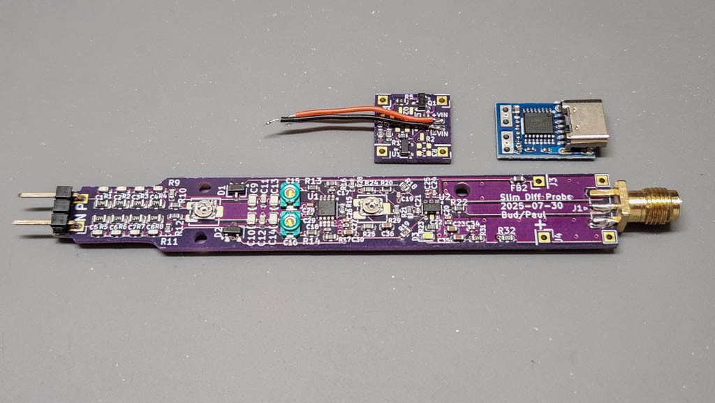

  1. A slimmer layout. Roughly 13mm x 100mm, making it less blocky and more probe-like. The longer probe will also make it easier to hold and handle while manually probing around circuits.
  2. Modular. The previous design had two incarnations — mine and Paul’s. Mine was powered by an isolated 5V wall adapter. Paul’s power was a 7.5V-12V wall adapter, which required an on-board voltage regulator on the probe. This new probe uses a basic core probe that requires 5VDC, or 15VDC isolated power, but it can be configured to accept various USB connectors and voltage ranges through the use of separate daughter boards that plug into the rear of the probe’s core PCB. Right now there are 5 daughter boards: a standard micro USB-B 5V interface,  three voltage regulators that will take 7.5V-12V (bare wires) as an input and deliver 5.3VDC to the probe, and a USB-C trigger board that provides 9V or 12V to the voltage regulator daughter board. Something for everybody. The daughter boards are small, and therefore relatively cheap, made with easy to get ubiquitous components. Beware,  the reverse polarity protection has been removed.

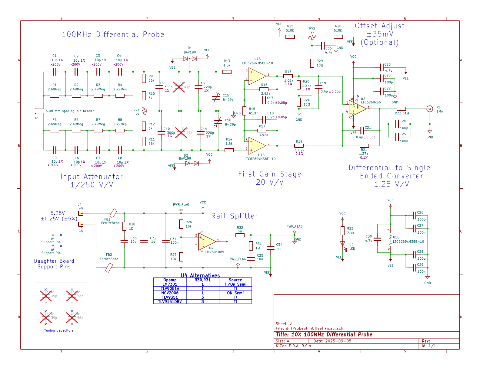

The 100MHz Probe Schematic:
No surprises here. This design was described in gory detail. See the old project.
Electrically, it is nearly identical to the previous design. C1-C4 now connect across to R1-R4 because all of the R's and C's are the same value. Paul added the 4 tuning capacitors so that they would appear on the BOM. C15-C16 were changed to a JR300 trimmer (or cheaper alternative), doubling...

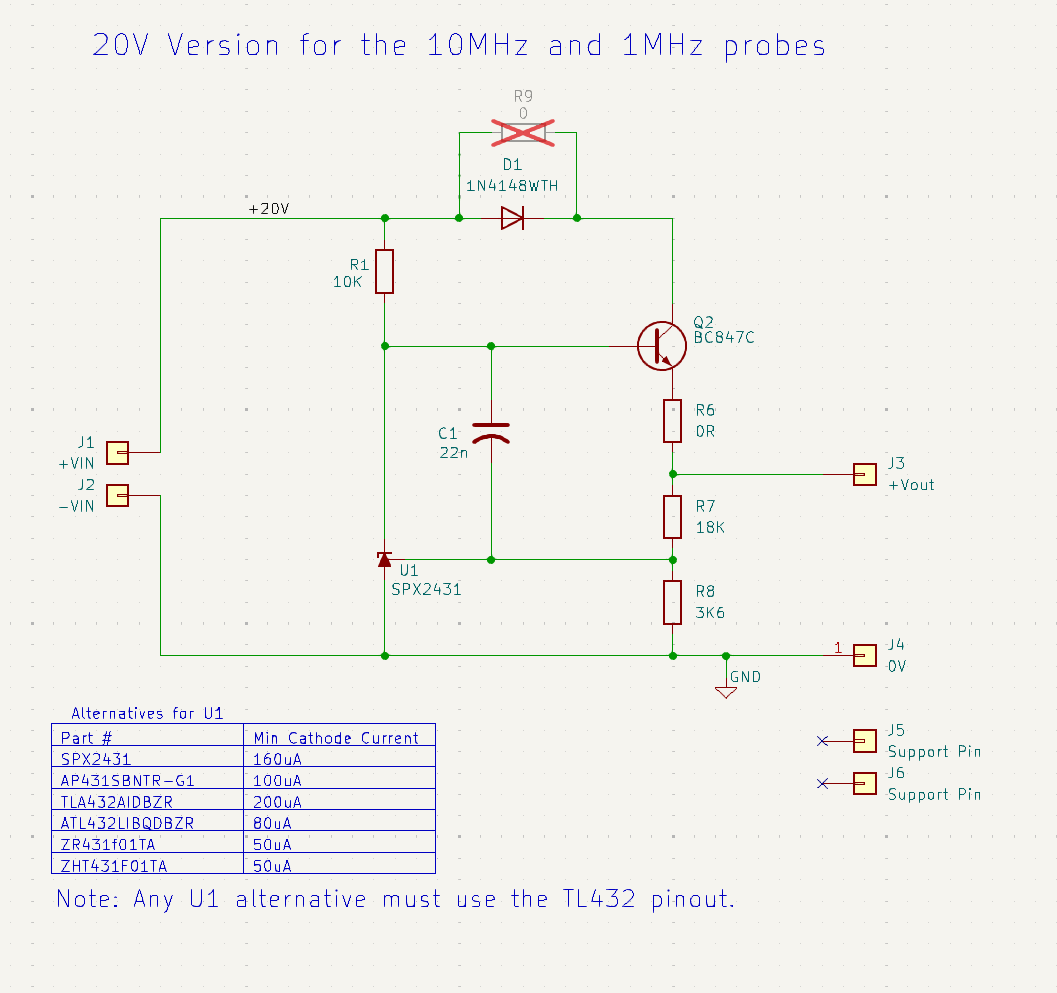

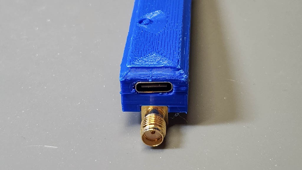

    1. Use a small (<30W) GaN USB-C power adapter. At first, I purchased these adapters from Amazon. They are ridiculously cheap. They worked for the 100MHz probe but did not deliver the required 20V for the 10MHz probe. I purchased this adapter for the 10MHz probe, which works well, and would suffice for all of the probes. Paul opted for a 100W USB-C power adapter that was more suited for laptop computers than phone charging, but even the phone chargers he tried produced too much switching noise. He also tried cheaper adapters, but settled on a 30W GaN power adapter as his final choice  -- they have the least amount of switching noise (with a higher switching frequency) that the on-board filters on the probe can eliminate.. See Paul's blog for details.
    2. There are only two trigger board voltages that make any sense, depending upon your choice of diff probe BW: 9VDC for the 100MHz probe body, and 20VDC for the 10MHz and 1MHz probe body. Choosing 12VDC will result in much higher power dissipation (and heat) with no benefit whatsoever in performance.
    3. Pair the 100MHz probe body with the buck converter daughter board and set the USB-C trigger board to output 9VDC. I think this will yield the lowest power dissipation and coolest operation of the probe. I did not see any evidence that the 2MHz switching noise of the buck converter was visible in the diff probe output. Alternatively, you could pair the probe body with the SOIC daughter board, and trigger board set to 9VDC,  if you are concerned about switching noise.

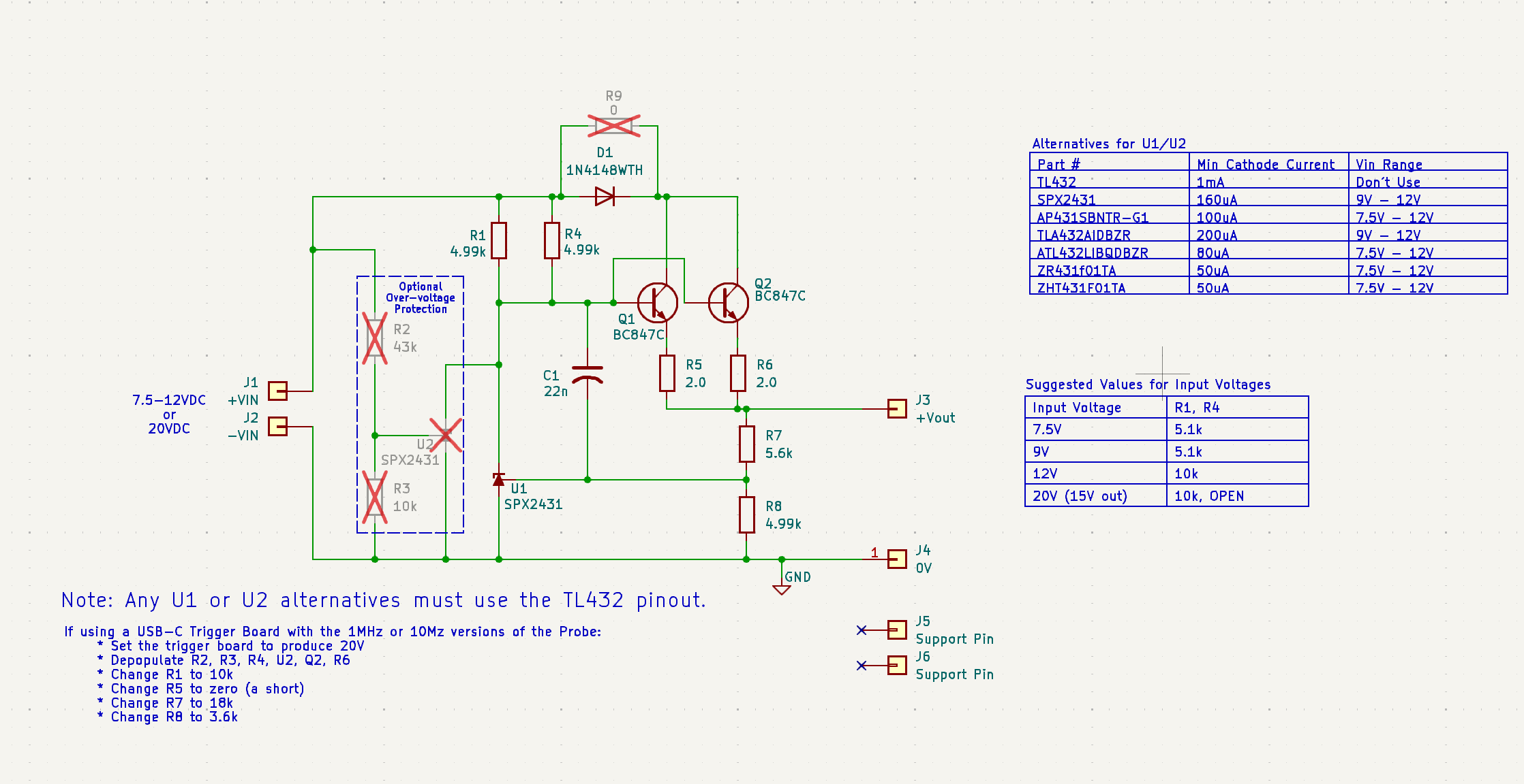

    4. Pair the 10MHz or 1MHz probe body with the depopulated version of the discrete VREG daughter board, or the SOIC8 daughter board. Both of these DBs have excellent tolerance (<0.5%, best case), line and load regulation, and low power dissipation. The depopulated discrete VREG daughter board looks like this:
      If you don't require reverse polarity protection, then substitute R9 (a 0603 short) for D1.
    5. We don't recommend using the mini USB daughter board or the SOT89 daughter board. The raw voltage provided by a generic USB power adapter may cause the offset voltage of the probe to fluctuate. I found the SOT89 XC6216 LDO to have poor line/load regulation compared to alternatives.

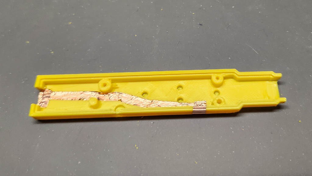

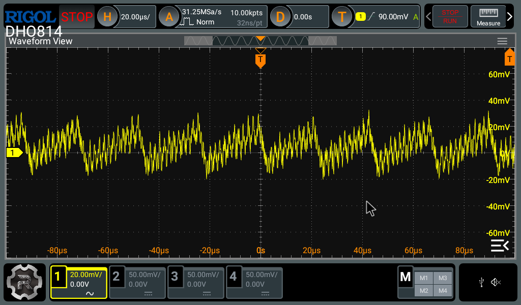

  • Shielding
    Bud Bennett • 09/18/2025 at 22:30 • 0 comments
    The probe can be used without shielding, but just laying it flat on a bench will cause the CMRR to degrade (or improve). Moving your hand anywhere near the front part of the probe will create parasitic capacitance that upsets the equilibrium of your trimmed capacitors.
    I tried several shielding scenarios before settling upon the following. Here's what doesn't work: placing copper tape inside the case -- it is too close, and will disrupt the trim settings beyond what can be compensated; placing copper tape directly upon the under side of the attenuator section of the PCB -- this is a disaster, the copper ground plane was left off this area for a very good reason (but I tried it anyway.)
    Paul used a different method to shield his probes. You can check out what he did here.
    After you've shielded the probe it will be mostly insensitive to normal handling. By "mostly" I mean that the CMRR will not be affected more than a couple mV when you manhandle the probe. Some of my probes don't show any sensitivity to handling. I did not test it further.
    Step 1. Run copper tape from the SMA connector to in front of the two capacitor trim holes, as shown.
    There are three pieces of tape in the above fuzzy photo. Use a thin strip to go from the SMA cutout, winding it way to avoid the trim holes and LED area, past the capacitor trim holes. Then put two additional pieces of tape: one to extend the coverage at the SMA cutout, and another to connect the end of the first strip to the outside of the case.
    Make sure than these pieces of copper tape are connected with reasonably low resistance. Get out your DVM and measure the resistance from the SMA cutout all the way to the end of the path. If you aren't getting less than 200Ω, then try poking a bunch of holes where the different copper tape sections intersect. You can use your sharp DVM probe tips to do this or a pin. This is REALLY IMPORTANT! If you don't have a GND connection to the shielding then it will not work properly. (Trust me on this. I originally thought that the adhesive for my copper tape was conductive -- it was not -- hence the perforation procedure.)
    Step 2. Wrap the area over the attenuator.
    I don't really need to tell you how to do this...do I? Here's a photo of the end result:
    I used strips about 10mm wide it's not very pretty, but that's not the point. It gets covered up later. Again, make sure that you have a good connection to the copper tape all the way back to the SMA housing.
    Step 3. Redo the Trims.
    You need to redo the capacitor trims, and maybe the offset trim at this point. They are easy to access. The DC CMRR trim is not accessible without punching a hole to gain access. You shouldn't really need it if you trimmed it properly previously.
    If things don't work out, then you might need to cut the two halves of the case apart and make some more serious adjustments (I did a couple of times.) You can leave the copper tape in place and just place a strip of tape to connect the two halves together -- making holes with pins or probe tips.
    (By serious adjustments I mean replacing C11/C12 with smaller capacitors to allow you to get a flat compensation.)
    Step 4. Cover It Up.
    I used 15mm black heat shrink tubing. It does the job, but I had to stretch it out a bit before slipping it over the shielding. Here's the end result (with a change in color.) I doesn't look that bad, but I'm not showing you the printing on the heat shrink on the other side.
    You could also use electrical tape. It is a bit shinier, and a bit less pretty (I tried it.)

    Feel free to ignore this and do your own thing. There is no "correct" method. Take the following as suggested procedure.
    Step 0: Drill out the holes in the case lid to allow for trimming
    I have no pics for this. Just drill out the 4 indentations in the case lid with a 2.5mm drill to allow access later.
    Step 1: Solder the PCBs and test them.
    Test all three boards, and make sure that the probe can be compensated (although this could be fixed later.) Solder the power leads that go from the daughter board you are using to the appropriate trigger board. The PCBs below are for the 10MHz probe.

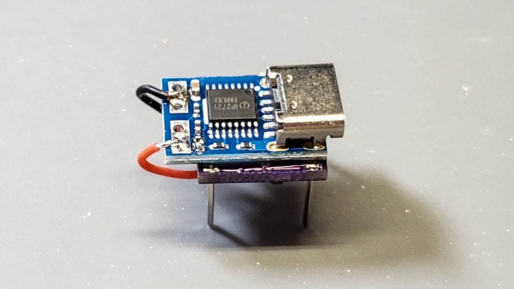

    Step 2. Solder the pins to the daughter board.
    Try to keep them as flush as possible on the top side of the board. If you have large solder bumps, remove them with solder wick.
    Step 3. Glue the trigger board on top of the daughter board and solder the power leads:
    I use a dollop of 5 minute epoxy. Make sure that the trigger board doesn't extend past the front of the daughter board. (A side note at this point. Notice that the USB-C connector extends past the trigger board edge. This will make it easier to fully seat the USB-C cable.)
    This trigger board is the shortest one that I know of at present -- it's only 10mm x 16mm. The design will accept a trigger board length up to 23mm, but you might have to change how the power leads are soldered to avoid interference with objects in the case.

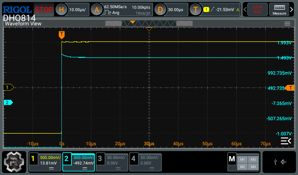

  • Proper Capacitor Types Make a Big Difference
    Bud Bennett • 09/17/2025 at 16:02 • 0 comments
    Don't make the mistake that I did.

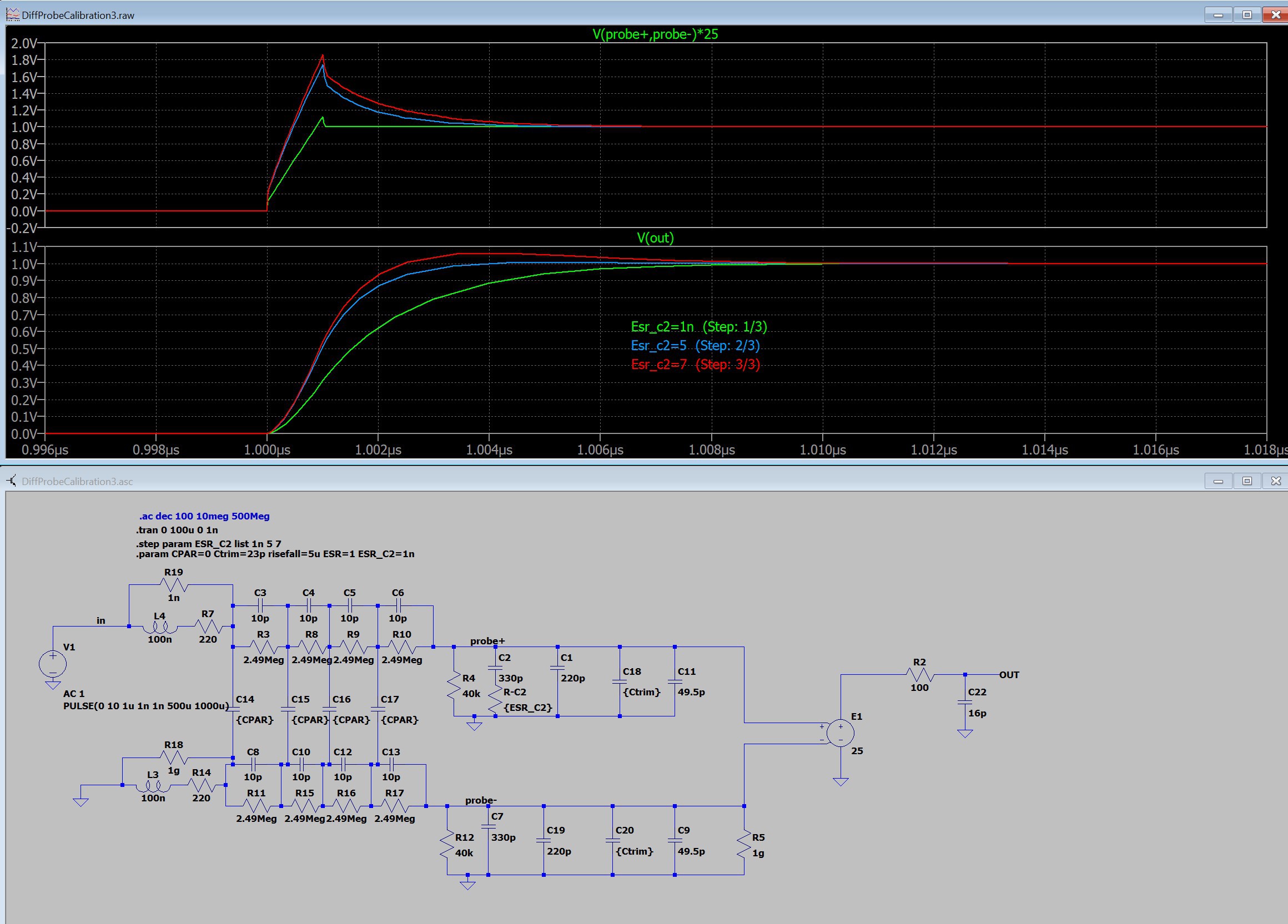

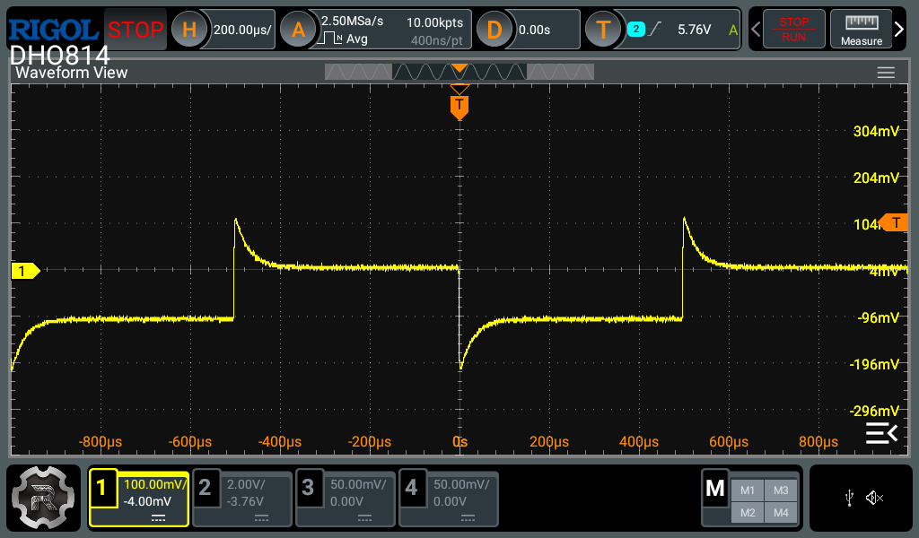

    I ran out of 220pF NP0 capacitors for the input attenuator, so I substituted with a strip of unspecified 220pF caps that had been in my inventory since I started this hobby some years ago. I think that I got them from Banggood or AliExpress -- very inexpensive -- probably claimed they were X7R or X5R grade. It was a big mistake.
    When I tried to compensate the probe there was a short spike at the leading edge of the square wave output that would not disappear by adjusting the trim capacitor. The other odd thing that I noticed was that the spike was constant amplitude and did not change when I was varying the trim capacitor. It looked like this on the scope:
    CH1 is the probe input. CH2 is the probe output. Note how short the duration of the spike is -- around 1µs time constant. The probe appears to be nicely compensated otherwise because it is pretty flat after a few microseconds. (The time constant of the attenuator is much longer than 1µs.)
    So what caused this? The constant spike size indicates that it is some resistance in the attenuator. Most probably a capacitor with significantly higher ESR (Equivalent Series Resistance.)

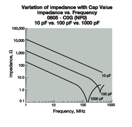

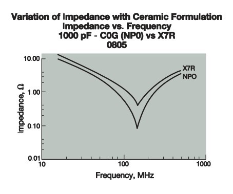

    When I was looking at capacitor datasheets I found this gem from Kyosera:
    I had always assumed that ceramic caps had very low ESR. Not true for the lower values. And Kyosera offered even more insight:
    That's a 5x poorer ESR for an X7R ceramic. I set up a simulation to see what LTSpice thought about it. All of the capacitors in the attenuator now have higher ESR to match the datasheets -- somewhere between 100mΩ and 500mΩ. With fast rise/fall edges on the applied input square wave the output shows the spike on a perfectly compensated probe.
    I put the extra ESR in series with C2. The spike gets softened by the bandwidth of the probe, but is noticeable as a 3-5% peak. SPICE also indicates that the spike will almost always be present when using extremely fast rise/fall edges.
    The takeaway from all of this is to use very good quality capacitors in the attenuator (and probably everywhere else) and slow the down the edges of the waveform used for compensation. That's why I suggest using a square wave with 100-300ns rise times because the spike won't appear and distort your measurements.

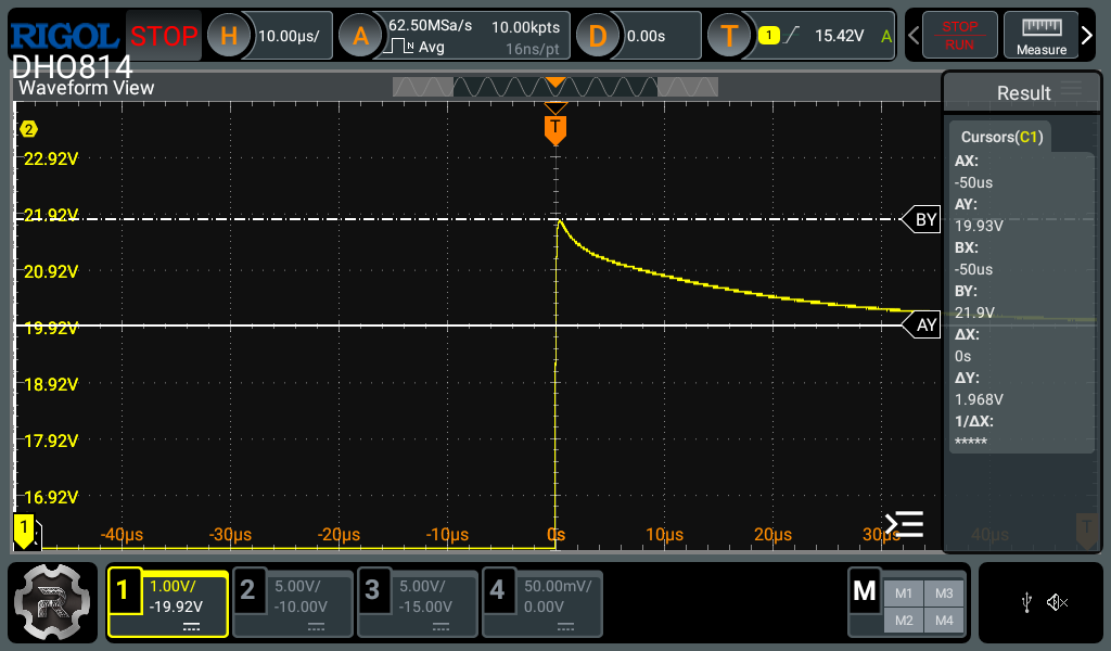

  • Calculating C11/C12 and Calibrating/Compensating The Probe
    Bud Bennett • 09/05/2025 at 23:42 • 0 comments
    At this point your 100MHz probe is done...except for placing those two last components, C11/C12. Here's what you need to do. If the probe is working then connect the inputs to a suitable square wave source with at least one reasonably fast edge -- a rise/fall time between 100ns-300ns. If it is too fast you might get artifacts from the parasitics in the attenuator. Too slow and you will not be able to determine proper values for the C11/12. I recommend the following circuit, which connects to my 3Vpp/1kHz scope calibration output.
    The two 2N3904 BJTs should be easily available, if not already in your kit. You might not need C1, depending upon what medium you use to construct the circuit. It should not be very sensitive to wiring mess ( so just use a plastic proto board.) If you drive it with the scope calibration output the rise time is nearly 300ns. If you drive it with a reasonably fast (<20ns fall time) square wave the rise time is about 150ns. If you hang a nominal 10x scope probe at the output the probe's capacitance will make the risetime slower -- so don't do that.
    It is also recommended that only the rising edge be used to compensate the diff probe. The falling edge is not constrained.
    Step Number 1 -- Calibrate the DC CMRR:
    Connect both probe inputs to your square wave source output. You should see something like this:
    Adjust RV1 until the steps are matched. You can ignore the spikes at this point. It is important to match the final voltage values. As so:
    Step Number 2 -- Calibrate DC Offset:
    Now adjust RV2 until the probe's output offset voltage is removed. If you don't trust your scope's DC levels to be accurate then just connect both of the probe's inputs to the scope's GND and use a DVM. Here's what it should look like when you are probably close enough:
    Remember the scope is multiplying the probe output by 10, so this offset reading is well below 1mV. At this level my probe output jumps around a bit, probably due to popcorn noise (1/f noise).

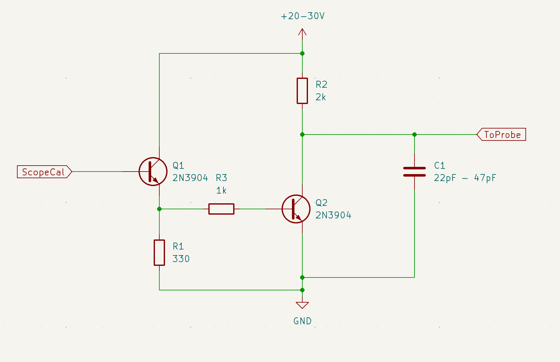

    Step Number 3 -- Calculate the Values for C11 and C12:
    Here's what a 100MHz probe produced when connected to custom calibration signal:
    Use 20Vpp for this test. Channel 1 is the diff probe output (10x) and Channel 2 is a compensated 10x passive probe connected to the same output. The peaks show that the probe's capacitive attenuator doesn't have enough capacitance in its lower leg (i.e. the AC gain is too high), and therefore the signal overshoots a bit and then settles to the value that the resistor attenuator thinks is correct. Channel 2 is just there for a sanity check (that you believe me). I have the scope measuring a swing of 19.84V on the probe output.
    Compensating the Positive Signal Path:
    You need to measure the overshoot of the square wave signal and figure out how much additional capacitance must be added to the attenuator to make the DC and AC attenuators match. (If your signal is rounded instead of peaked, then you are screwed...the 0805 capacitors are too large and one of them must be replaced with a smaller value.)
    Set the trigger for a 10V level (of course this depends upon your scope calibration square wave, or whatever square wave signal you are using now.) The more vertical sensitivity you have the better your measurements will be, but don't overload the scope input to much if you suspect it is becoming distorted. For this example, I'm using 1V/div, with signal averaging set to 32 -- your trigger needs to be rock solid with this amount of averaging.
    Adjust the trimmer capacitor, C15, to yield the maximum peak voltage. This will be the minimum capacitance that the trimmer can produce. Measure this peak value. Then adjust the trimmer capacitor to yield the minimum peak value. This is the maximum trimmer capacitance. I used a metal tool to adjust the trimmer cap. When I remove the tool the peaks relax upward. Use your best judgement as to where the minimum and maximum trim points are.

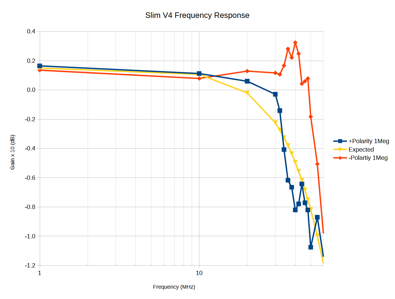

    Here are some measurement of this latest version:
    • CMRR @30Hz = -82.5dB (1.5mVpp/20Vpp)
    • CMRR @ 1MHz = -74dB (1mVpp/5Vpp)
    • CMRR @ 10MHz = -60dB (5mVpp/5Vpp)
    • CMRR @ 20MHz = -52dB (13mVpp/5Vpp)
    • CMRR @ 40MHz = -44.4dB (30mVpp/5Vpp)
    These measurement use output voltage/input common mode voltage.

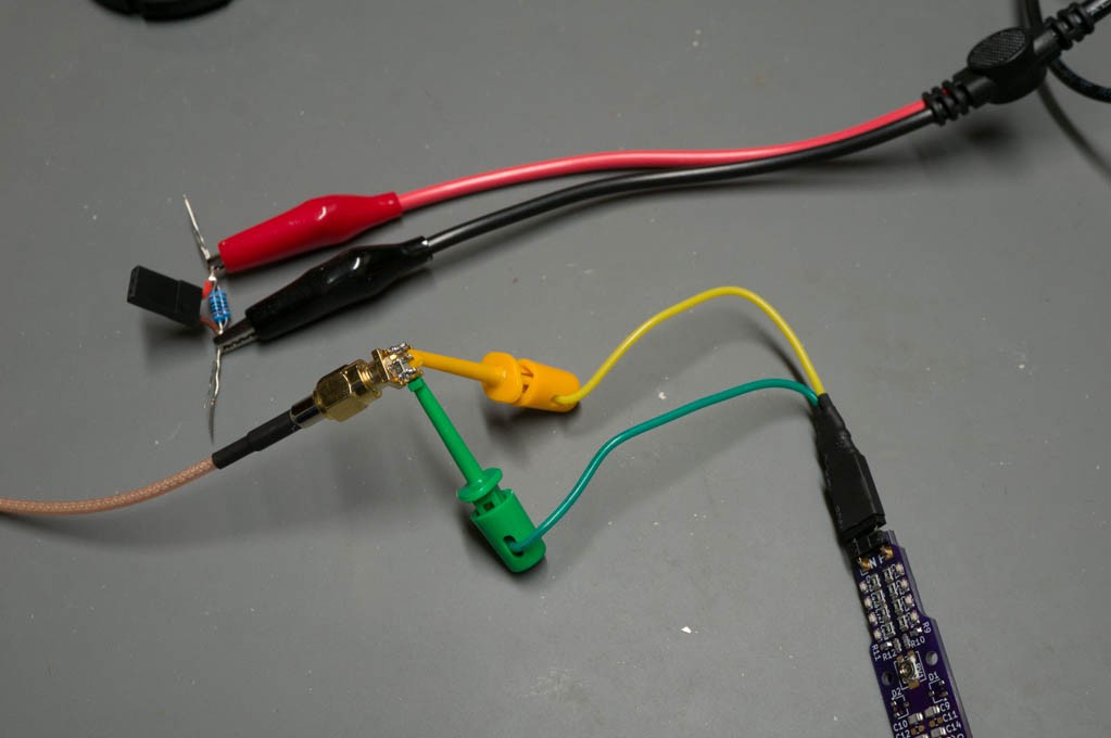

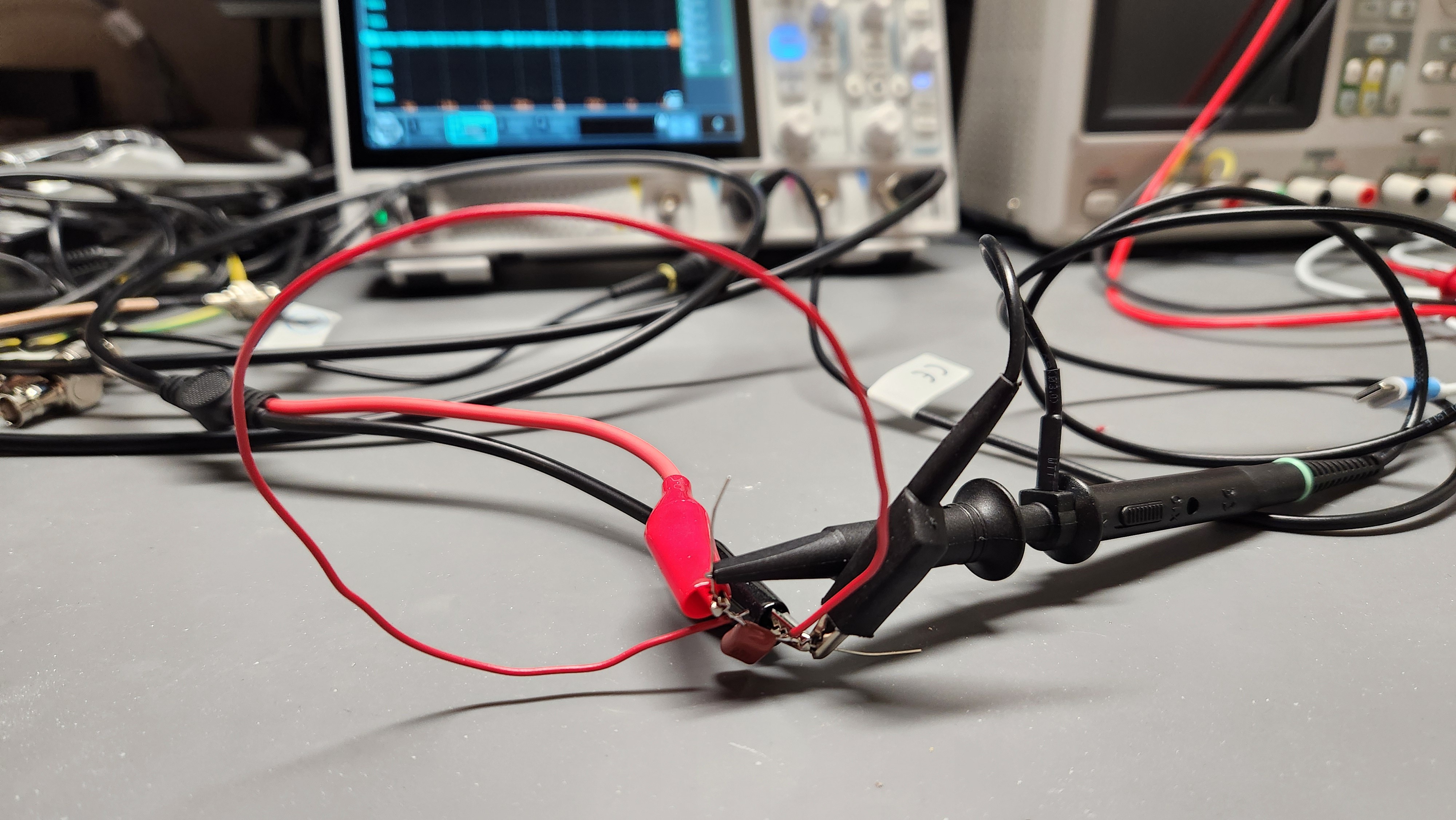

    All of the measurements are using 100mm flying leads with 220 Ohm series resistors. Here's a scope trace of the probe hooked to the scope's calibration signal:
    It is overlaid CH1 and very nearly identical (but noisier.)
    I now have a signal generator, so I can take reasonable measurements to 60MHz. I found that this is trickier than it seems. Any amount of lead inductance will change the result. After several attempts, I eventually followed Paul's approach and soldered a 51 Ohm resistor between the center contact and GND post of a spare female SMA connector as shown below:
    The leads that came with the signal generator caused some weird effects that disappeared (mostly) when I switched to the leadless version. This is what I measured with the probe connected to the 1Meg/15pF scope input with a 30cm coax pigtail.
    It's really not as bad as it appears. I plotted an ideal response in yellow for comparison -- using a 51 Ohm termination resistor at the generator output increases the gain by 0.17dB. Remember, a 1 dB drop is less than 10%. It's basically flat until 30MHz. What is odd is that the response of the positive signal path is different than the negative path. The negative path peaks slightly between 30-50MHz and the positive path dips a corresponding amount. I can't explain this, but it is not a huge effect. I suspect that most of it is reflections from an unterminated line into the scope, but the probe is designed for a 1Meg scope input. I performed similar measurements with 50 Ohm terminations at the scope input (with lower signal levels) without any significant change in the result. I also did not see any significant difference between using 100mm flying leads and a very short (~10mm) Dupont connector directly across the signal generator load.

    I covered this topic before for the old differential probe design. I need to revisit this topic because I got it wrong and need to correct it. The other log posting is here. I will be brief.
    I was reviewing a few articles on scope probe ground lead inductance when I noticed that many of them called out a 200nH inductance, which seemed too small to me, based upon my previous effort. I decided to check a couple of web-based self-inductance calculators and found that there is an order of magnitude difference between some of them.
    The calculator that I used previously, is this one. It calculates the inductance of a 100mm length of 1mm diameter wire is more than 1.5uH. If you consult this other calculator you get 105nH. WTF!
    The only way to determine which is correct is to measure it yourself. I took a 250mm length of 26 AWG solid wire, formed it into a loop with a diameter of 8cm and soldered it across a 100nF±1nF mylar capacitor.
    Calculator number 2 also has a loop inductance calculator that predicts this piece of wire should be 224nH (308nH if straight). I calculated that the LC tank should therefore have a peak at 1.06MHz. It peaked at 1.02MHz...close enough to verify that calculator number 2 has the proper mojo.
    I ran a simple simulation to pick the proper value for the series resistor to de-Q the lead inductance, if using 100mm long leads. It is somewhere between 200-250 Ohms. I picked 220 because that was the closest I had for a 1/8W leaded resistor.
    For 70nH - 160nH the output varies 0.8dB @ 100MHz. Good enough. I built as set of these leads and and I can't see any difference (to 60MHz) between the short pins and the longer leads.
    Q.E.D.

    I've finally settled on the topology (and PCB layout) below. It is amazing how many different buck regulator ICs can be used on a fixed PCB layout.
    I follow a few simple steps to select components for this design topology:
    1. Pick a suitable IC based upon performance/cost tradeoff.
    2. Pick a range of possible inductors that will be compatible with the chosen IC
    3. Set the desired output voltage with R1 and R2.
    4. Check the datasheet input/output capacitor requirements for value and voltage rating.
    5. Set the value/voltage of C1 from the datasheet.
    Sorry about the few choices for the diode. It was in my inventory so I went with it.

    The 100MHz Probe:
    When I decided to add the 10MHz and 1MHz versions I had to tweak the 100MHz probe a bit. All of the versions use the same PCB layout. The higher supply voltage on the slower versions forced me to change the larger tank bypass capacitors from 0402 size to 0603 because it is difficult to get large 0402 ceramic caps rated above 16V. Also, the input resistor string was changed from 3x3.3Meg + 62k to 4x2.49Meg using 0805 resistors (see reason below).
    The 10MHz Probe:
    Technically, not a redesign but constrained by keeping the same PCB layout as the 100MHz probe. It was difficult to find suitable opamps. They had to meet the following criteria:
    1. A dual opamp in a MSOP8 (or VSSOP8) with the same pinout as the LTC6269-10, and a single opamp in a SOT26 or SOT25 with the same pinout as the LTC6268.
    2. Supply voltage > 12V (More supply voltage yields a higher differential input signal)
    3. Gain-BW product > 20MHz - 60MHz, depending upon how gain was allocated to the first and second stages.
    4. Slew Rate > 400V/µs. (6Vpeak x 10MHz x 2π)
    5. pA input bias current (for low noise)
    6. Rail-to-rail output swing would be nice.
    7. Less expensive than the LTC6268/9 (this is not difficult).
    Needless to say this narrowed the field a bit. After loosening a few of the criteria I finally settled on the OPA2810 and OPA810, which has the following specs:
    1. Available in a VSSOP and SOT25 package.
    2. Max supply voltage 24V
    3. GBW = 70MHz
    4. Slew Rate = 192V/µs
    5. 2pA input bias current typical
    6. Rail-to-rail in/out.
    7. Less than $5.00 for the OPA2810, and around $3.50 for the OPA810.
    I settled on a 15V supply voltage, which would yield an output swing of 14Vpp with the rail-rail output. Since the gain is set at 1/10 V/V the differential input voltage swing is set at 140Vpp. The higher supply voltage also means that less input attenuation would be required and still meet the common mode range needed, so I decreased the attenuation from 1/250 V/V to 1/100V/V.
    I also thought, mistakenly, that reducing the resistance of the attenuator from 10MegΩ to 5MegΩ would reduce the Johnson thermal noise. This increased the input capacitors from 10pF to 20pF to keep the same crossover frequency.
    With a GBW of 70MHz the OPA2810 won't have a -3dB BW with a gain above 5 or 6. I set the gain at 5, which makes the second stage gain an easy 2. You want to have the first gain stage as high as possible to suppress input referred noise from the later stages. You also want to have the last stage set the bandwidth of the probe. The max CM voltage x attenuation + max single-ended input voltage x attenuation x first stage gain must be less than 7.25V:  353V/100 + 70V/100 * 3 = 5.63V. The gain of 3 (instead of 5) is because the input is single-ended and has a common mode component to it. If the input signal was differential the max output swing drops to 5.28V.
    I had to give up having full bandwidth with a 70Vpeak input swing. The slew rate of the last stage will only allow a 3Vpeak sinusoid without hitting the slew rate limit.
    The datasheet suggests keeping the feedback resistors below 2k to avoid degrading the noise performance of the opamp. The max power dissipation of an 0603 resistor is usually less than 0.1W. A quick check on the feedback resistor max dissipation in the second stage = 10.9mW, no problem there. A fat finger check of the total power dissipation of the probe -- 4mA x 3ma/opamp + 3mA (for LED + rail splitter) is less than 250mW. It should be pretty cool.
    The bypass caps were changed in accordance with those suggested by the datasheet. This forced a change to the large 2.2μF and 4.7μF capacitors -- changing the footprint to 0603 to make it easier to get them rated for 25V or 35V. (And this in turn caused the update to the 100MHz PCB layout.)
    uh..oh...
