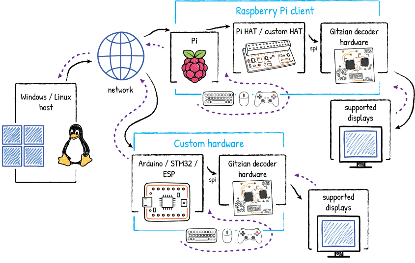

These two diagrams show the main hardware paths: a normal Windows / Linux host setup and an alternative local Raspberry Pi setup.
A Windows or Linux machine renders the desktop, viewport, or application output. The stream goes over the network to the Gitzian endpoint.
On the endpoint side, a Raspberry Pi can run the Gitzian client. The Pi talks to the Gitzian decoder through the Pi HAT or a custom HAT. The decoder then drives one of the supported displays.
The same decoder path can also be used with custom hardware. Instead of the Raspberry Pi client, an Arduino / STM32 / ESP-style board or another embedded controller can feed the decoder over SPI.
This is the useful split: host and transport on one side, decoder and display output on the other side.

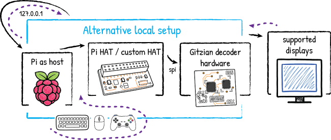

Alternative local Raspberry Pi setup
The Raspberry Pi can also act as the local host. In this setup, the stream does not need to come from another computer on the network.
The Pi renders locally and connects to its own Gitzian client through 127.0.0.1. The rest of the hardware path stays the same: Pi HAT or custom HAT, SPI link, Gitzian decoder hardware, then the supported display.
This setup is useful for compact standalone builds, demos, cyberdeck-style devices, local dashboards, and experiments where one Raspberry Pi should provide both the application side and the display endpoint side.

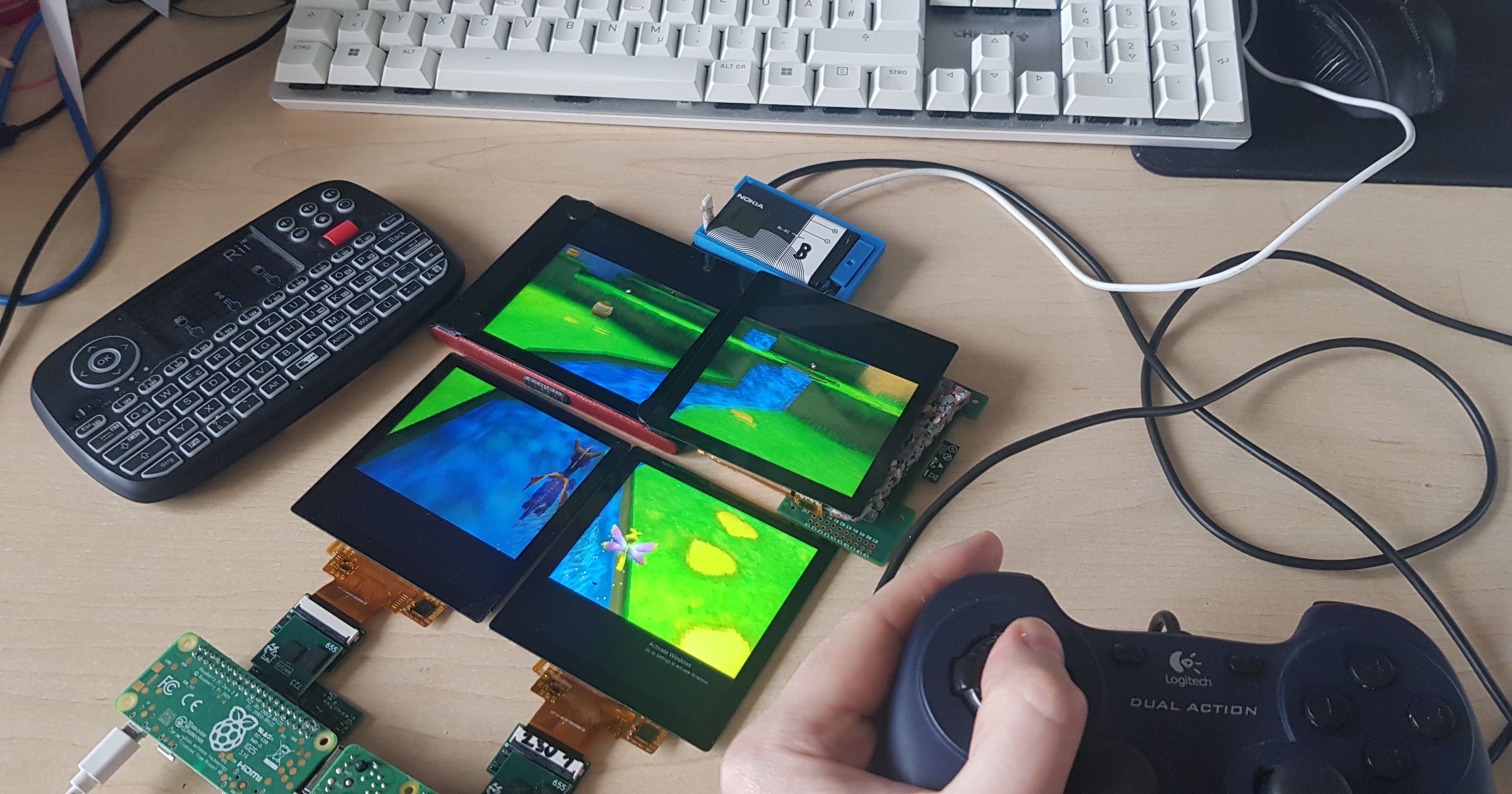

  • 4Screen Square Full HD
    gitzi • 09/20/2026 at 07:34 • 0 comments
    This is Full-HD in square version (1440x1440=1920*1080) I had to try this, I think it is kinda funny - Does it make sense? I don't know, I don't have a use case, but I wonder If I can double to 4K, that would be f* hilarious.

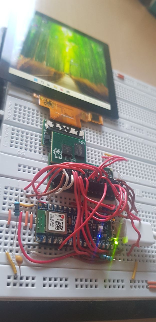

  • Arduino Nano ESP32 low-latency Wi-Fi display
    gitzi • 07/04/2026 at 15:23 • 0 comments
    Trying to make things smaller and smaller without sacrificing too much frame rate. Tested my Raspi HAT with Arduino Nano. It streams flawlessly. Raspi Wifi throughput is of course higher but this is still impressive imo.
    This little u-blox Wi-Fi module is absolutely enough to transport the encoded stream to my decoder. I will measure power consumption and realistic bandwidth compared to the Raspberry Pi soon.
    I will also add the code and wiring instructions to the manuals here and my website soon.

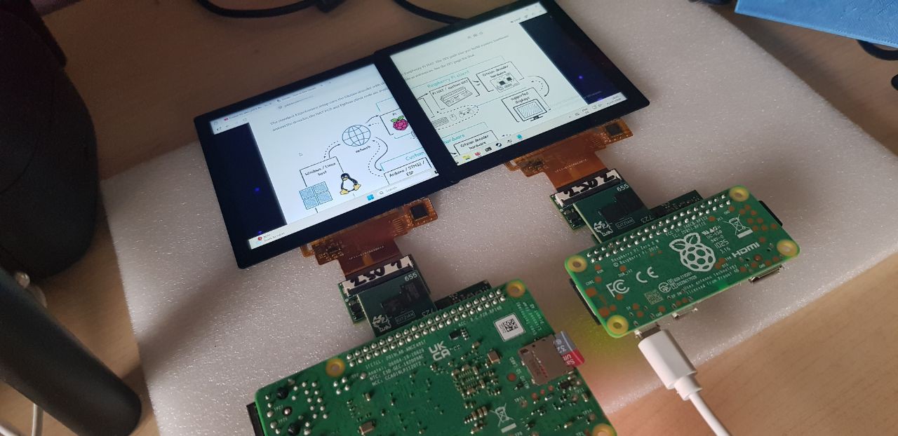

  • Multi-Screen Setup Experiments
    gitzi • 07/01/2026 at 08:20 • 0 comments
    I wonder how far I can push screen extending with my Nvidia GTX 1050 Ti. These screens total 1440×720 pixels. GTA V was running, but at much lower settings than when using only one screen.
