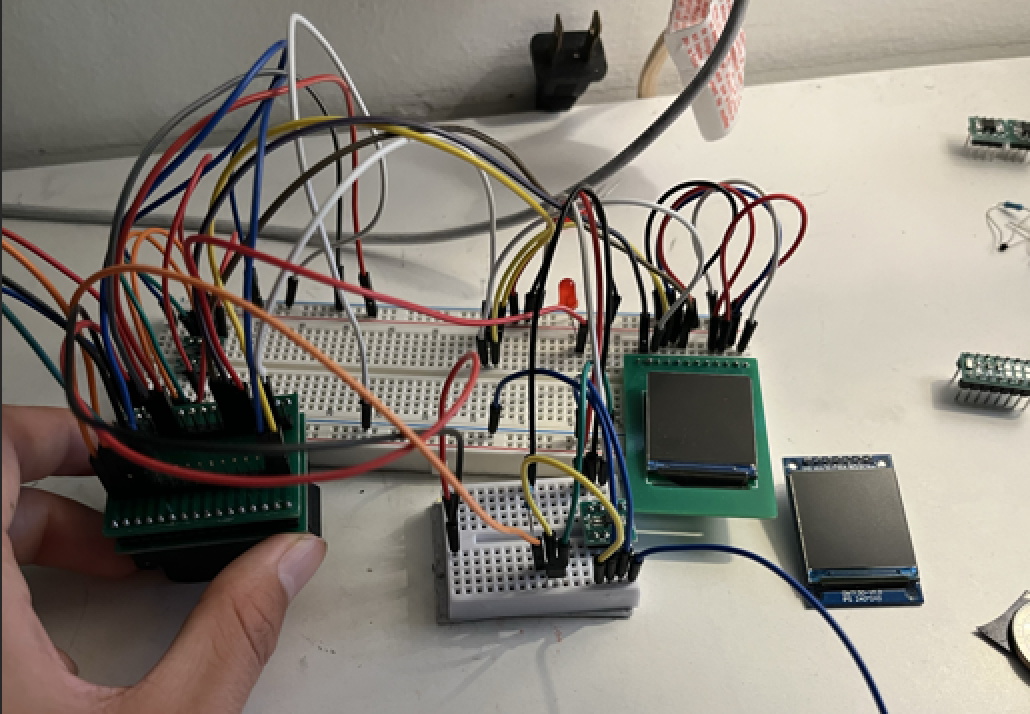

The first step in designing the hardware was for me to research components and select the ones that I thought would be sufficient. I wanted this project to run on 3.3V and draw as little current as possible, so I selected components that could meet these requirements.
Next, I began testing the schematic. I wanted to use a breadboard so that I could easily connect and disconnect pins as I encountered errors. However, all of the components I was using were SMD, so connecting them to a breadboard would only be possible with a breakout board for each IC. So, I designed a PCB for each SMD device using JLCPCB. Below are the breakout boards for the ST7789 (display) and the DS1302ZM RTC (real-time clock).

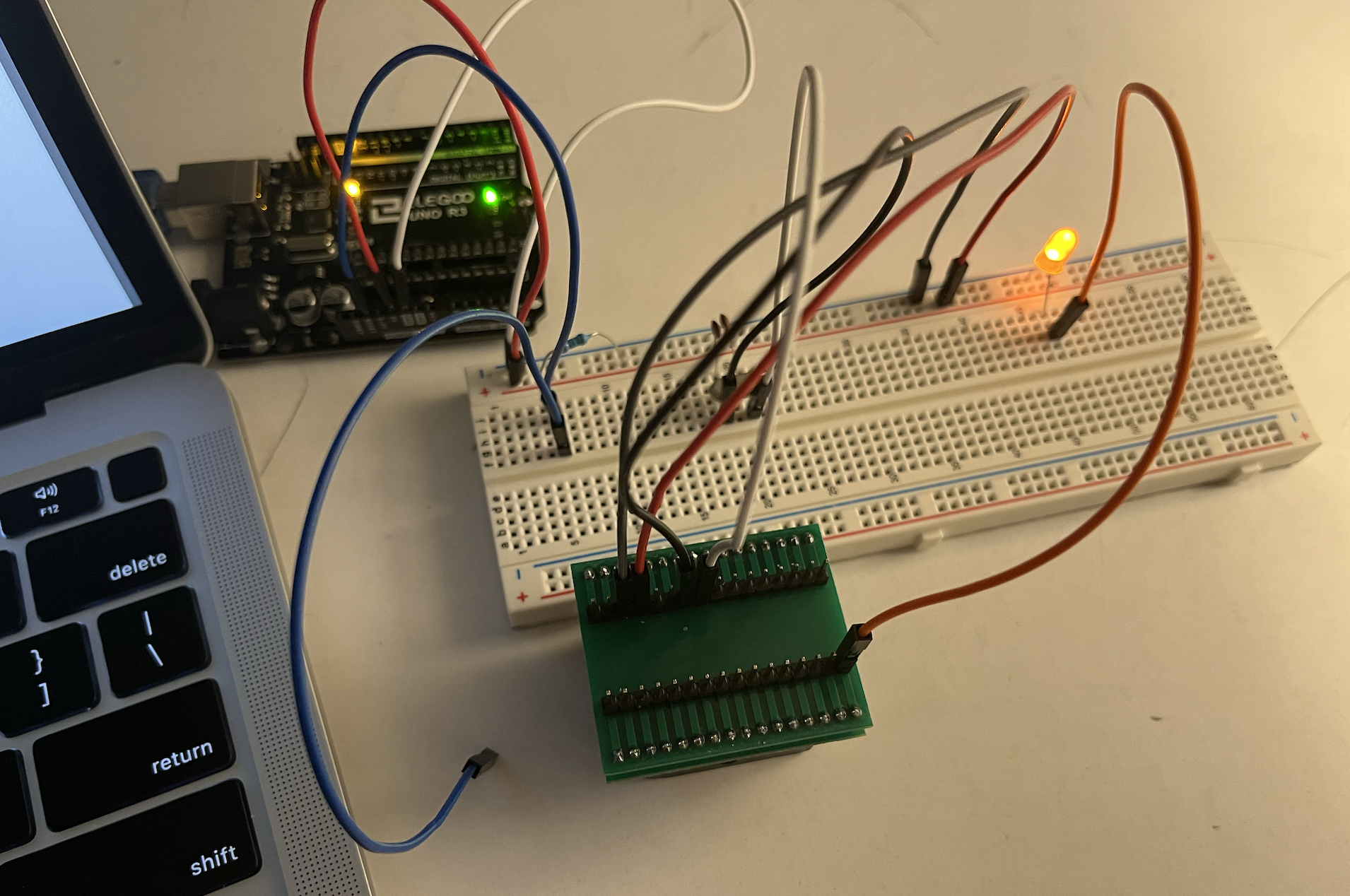

Once I had each component connected on the breadboard, I was able to begin programming the main microcontroller (ATmega328P-AU). To do this, I connected my laptop to an Arduino Uno to send binary code to the ATmega328P.

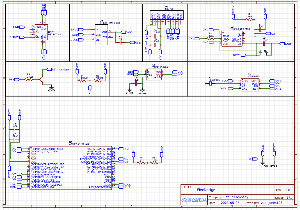

3. Final Schematic:

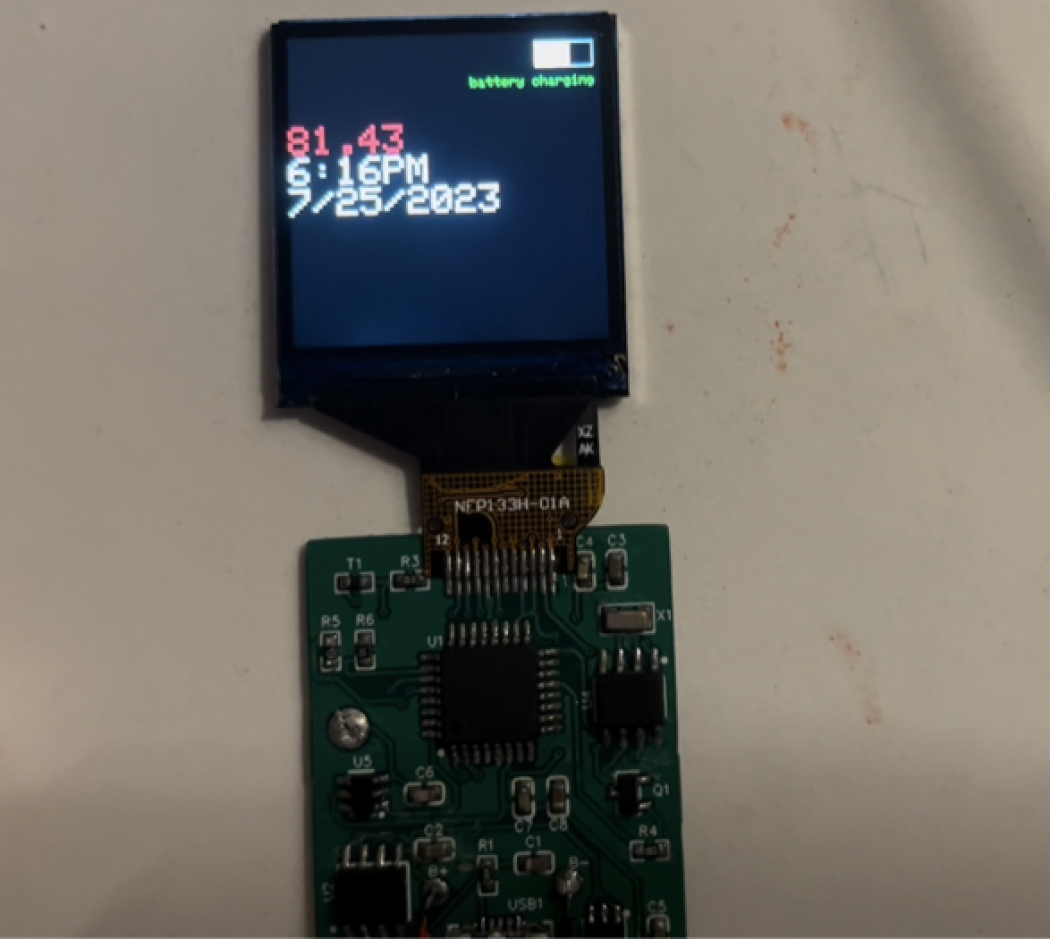

After I had verified that all of the software and hardware were working correctly, I could get started on making the PCB for the watch. To do this, I first had to make a schematic with EasyEDA. The schematic shows how everything is to be connected in the final version of the watch and serves as a guide for designing the PCB.
When designing the PCB, I had to ensure that each device would operate with minimal noise from the outside environment. This meant I had to carefully route signals apart from each other, as well as place decoupling capacitors between the VCC and GND pins of each device. Once this was complete, I was able to order the PCB and assemble the final version of the watch.
To solder everything to the PCB, I used a cheap soldering iron from Amazon, standard lead solder, and some liquid flux.
Smartwatch Schematic Summary
Main Controller
ATmega328P-AU (U1):
Acts as the central microcontroller.
Interfaces with peripherals (RTC, display, sensor, etc.).
Provides GPIO, I²C, SPI, ADC, and serial communication.
Power Supply & Battery Management
USB Input (USB1, Micro-USB): Used for charging and programming.
TP4056 (U2): Lithium...
