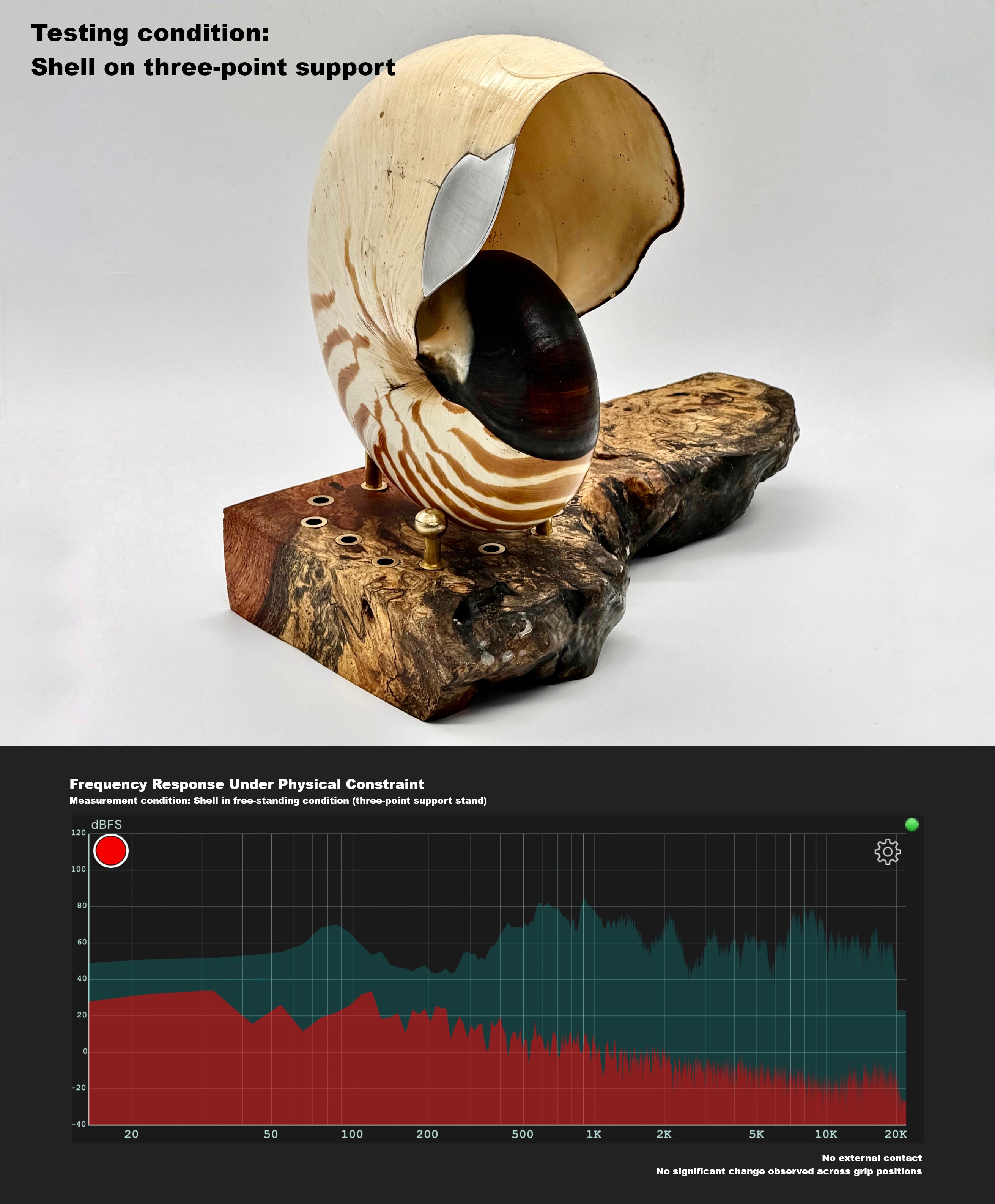

  • Log #5: Why the Stand Changes Everything
    hide-key • 01/03/2026 at 20:18 • 2 comments
    After observing that direct hand contact (H2) produced little change, while aperture blocking (H3) produced a strong effect, attention turned to the role of support conditions.
    When the shell was placed on the custom minimal-contact stand (three-point support), a distinct change appeared in the low-frequency region. Compared to hand-held conditions, the measured spectrum showed a clear increase in energy around approximately 50-100 Hz. This low-frequency emphasis was repeatable and consistent.
    This result was initially counterintuitive. Human hands introduce large contact areas and soft damping, yet produced minimal effect. In contrast, the stand introduces only three small, rigid contact points—yet significantly altered the vibrational behavior.
    The key difference lies not in contact area, but in mechanical impedance and constraint.
    The stand constrains global motion modes of the shell, particularly those involving low-frequency, whole-body movement. By partially fixing translational and rotational degrees of freedom, the stand allows certain vibrational modes to store and release energy more efficiently instead of being dissipated.
    In contrast, hand contact applies distributed, lossy damping that absorbs energy locally without strongly constraining global modes.
    In other words, the stand does not “dampen” the shell—it reshapes its boundary conditions.
    This explains why the shell appears robust to touch (H2) but sensitive to support geometry. This observation reframes the shell not as a simple resonator, but as a structure whose behavior is dominated by boundary conditions at a system level.

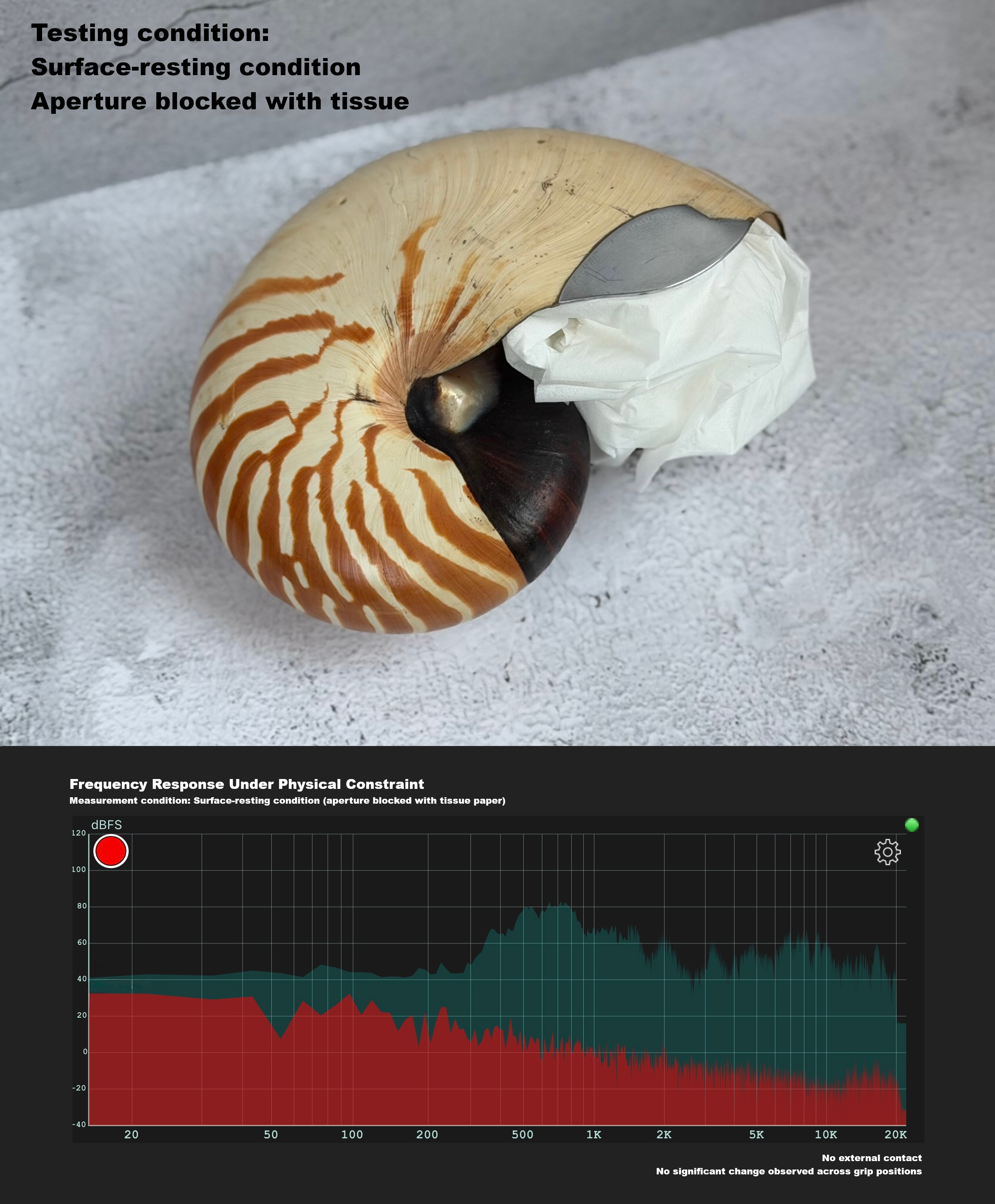

  • Log #4: Aperture Blocking (H3 Condition)
    hide-key • 01/03/2026 at 20:17 • 0 comments
    After confirming that direct hand contact (H2) produced minimal change, a contrasting condition was tested.
    In this condition (H3), the shell itself was left untouched, but the aperture (living chamber opening) was partially filled with soft tissue paper.
    This modification did not alter the exciter mounting, input signal, or external support condition. Only the internal acoustic boundary at the aperture was changed.
    Unlike the H2 condition, the effect was immediately audible.
    The sound became noticeably muffled, with reduced clarity and diminished high-frequency content. Measured frequency response also showed clear deviation from the reference profile, particularly in the mid-to-high frequency range.
    This contrast was important. While extensive external contact with the shell body produced little change, a relatively small modification at the aperture strongly affected the acoustic output.
    This suggests that the aperture plays a dominant role in acoustic radiation and pressure release, whereas the shell body primarily functions as a vibration-distributing structure rather than a simple radiating surface.
    Again, no claim is made about biological intent. However, the asymmetric sensitivity between external damping (H2) and aperture modification (H3) highlights a functional separation between structural vibration and acoustic coupling.

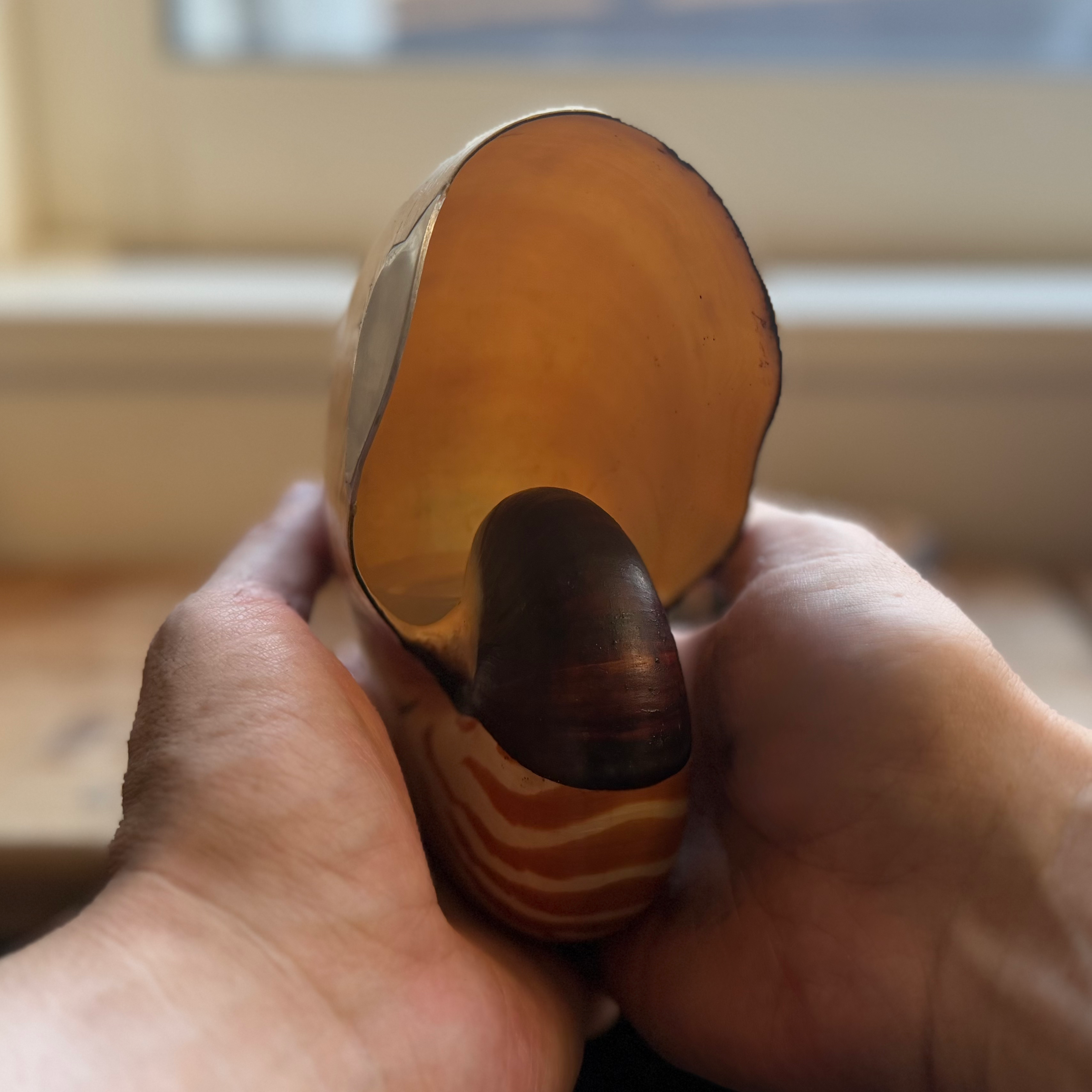

    With the reference condition established, the next comparison focused on direct human contact with the shell.
    In this condition (H2), the shell was held firmly by hand while the exciter continued operating under the same input signal and mounting configuration.
    Three grip positions were tested:
    * Inner whorl region
    * Middle shell region
    * Outer shell region
    In all cases, the shell was actively supported and gripped by the hand, introducing substantial mechanical contact and expected damping.
    Contrary to typical expectations, the measured frequency response showed no major deviation from the reference profile. Low-frequency behavior, midrange structure, and overall spectral shape remained largely unchanged.
    Subjectively, no clear reduction in loudness or tactile vibration intensity was perceived by ear or hand.
    This result was unexpected. Human tissue usually provides strong damping, particularly in lightweight resonant structures. In many comparable systems, hand contact significantly suppresses vibration and alters tonal balance.
    The consistency of the response across multiple grip locations suggests that the shell’s global vibrational behavior is not dominated by local boundary conditions at the point of contact.
    At this stage, the observation is documented without asserting causality. However, it strengthens the hypothesis that the Nautilus shell distributes vibrational energy in a highly non-local manner.

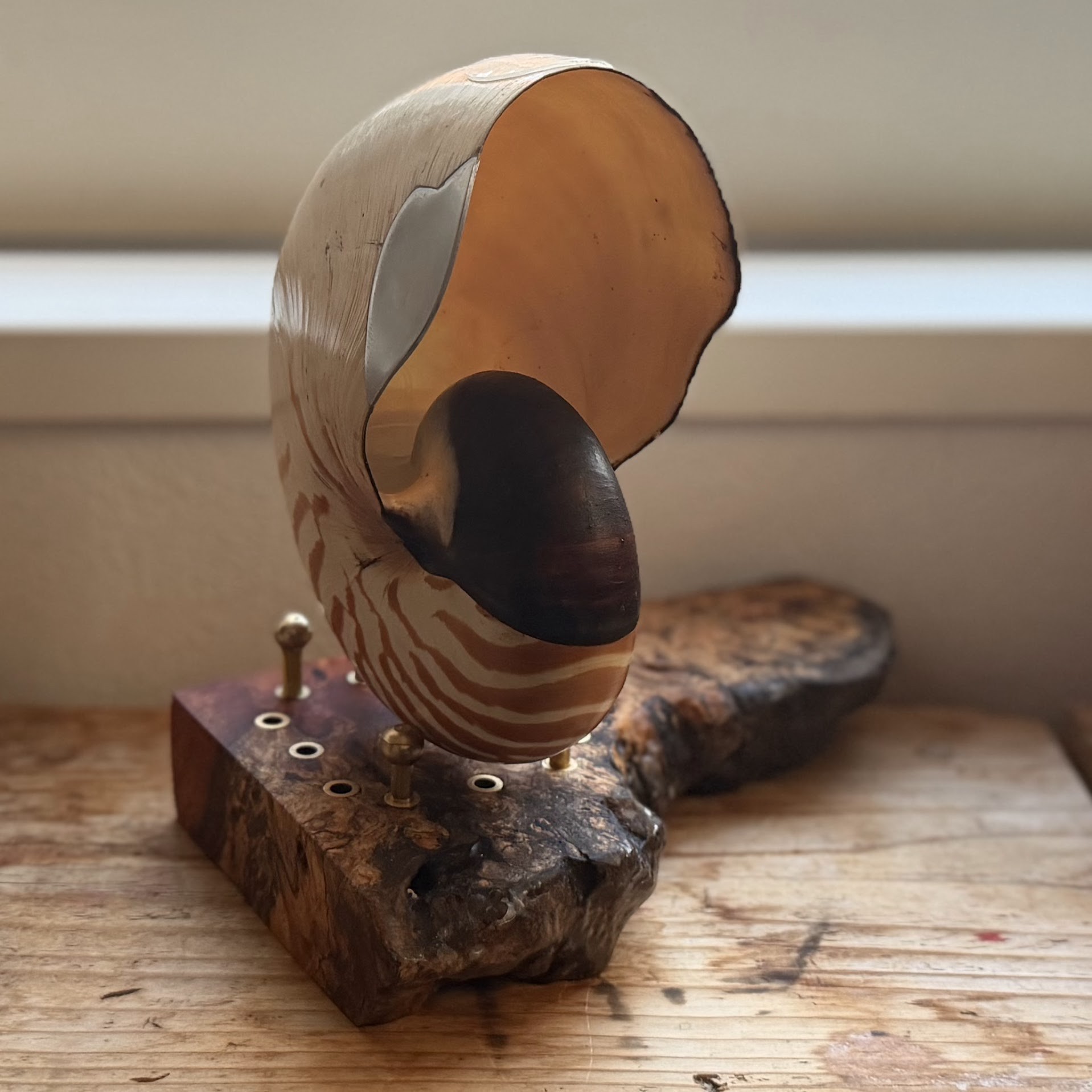

    This log documents the measurement setup and reference conditions used in the following observations.
    Note: In the first part of the video, the exciter itself is intentionally damped by direct finger contact.
    This is shown only as a reference to demonstrate that the system still behaves like a normal exciter-driven object at the drive point.
    The remainder of the video and all following observations focus on the behavior of the shell itself under different contact conditions.
    Following the unexpected robustness observed during hand-held listening tests, I decided to introduce simple, repeatable measurements to establish reference conditions. The goal was not precision acoustics, but consistency: to compare relative changes under different physical constraints using the same setup.
    Measurements were performed using a smartphone-based spectrum analyzer app (Sonic Tools SVM), capturing frequency response trends rather than absolute sound pressure values.
    The exciter position was kept fixed throughout all tests. Only the external boundary conditions of the shell were varied.

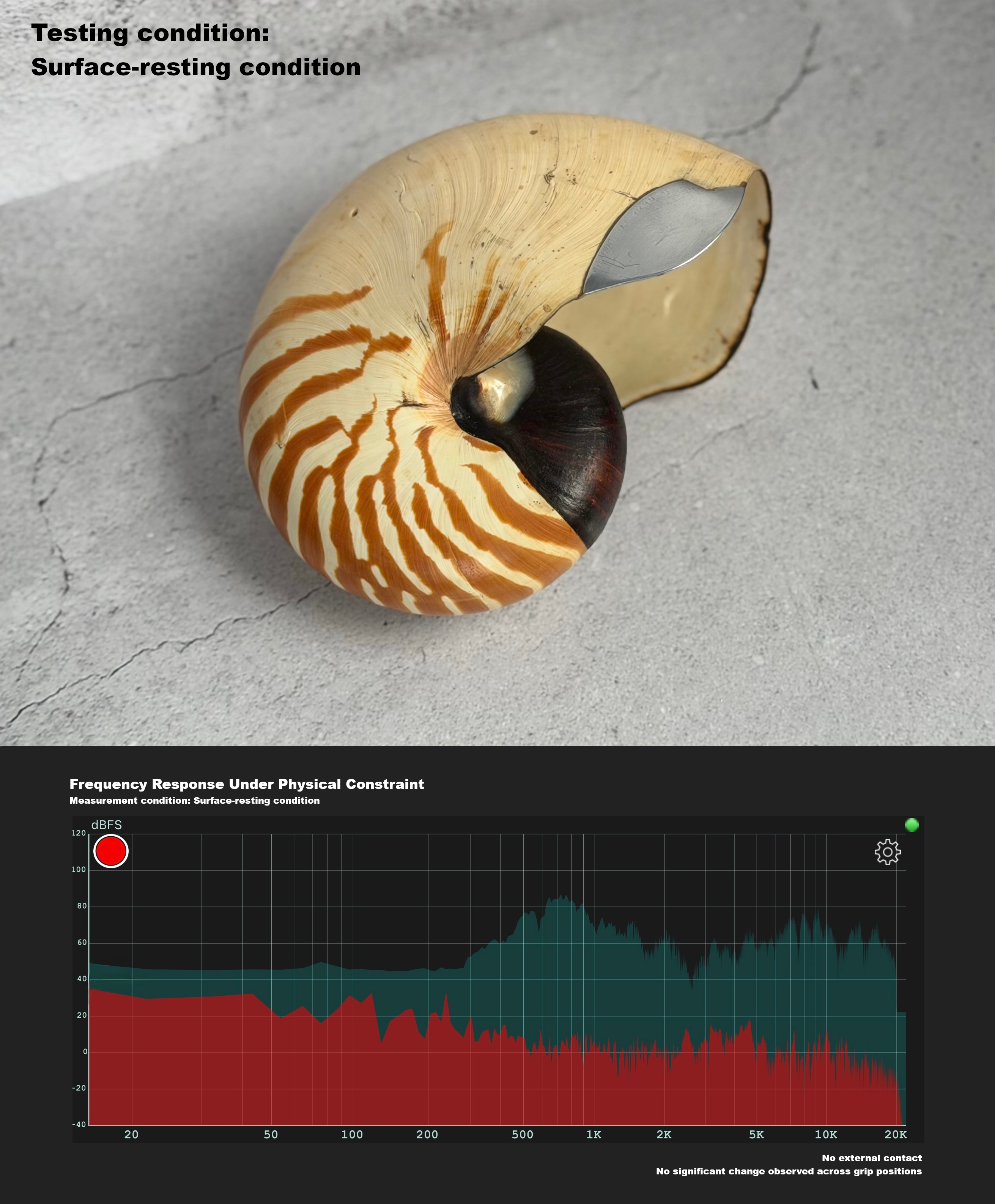

    A reference condition was first defined:
    Reference: Near Free-standing Condition

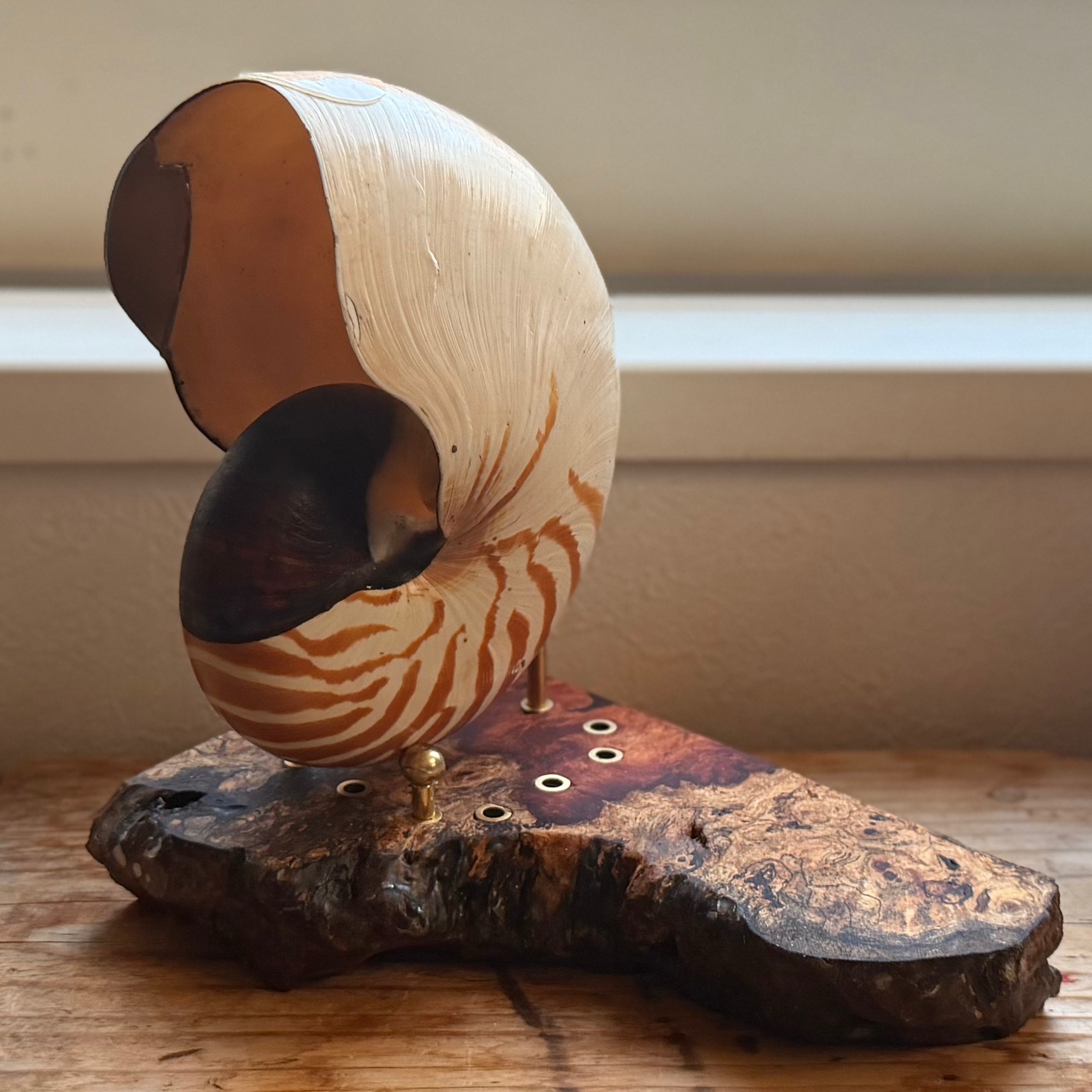

    The shell was supported by a custom-made minimal contact stand (three-point support), designed to approximate a free-standing state while remaining physically stable.
    This reference revealed a distinct low-frequency emphasis (approximately 50-100 Hz), forming a baseline profile for comparison.
    Subsequent measurements intentionally avoided changing input signal level, exciter mounting, or shell orientation, focusing solely on how external interaction affected the vibrational behavior.
    At this stage, the measurements serve as qualitative evidence supporting the initial listening observations, not as laboratory-grade acoustic data.
  • Log #1: The Unexpected Observation
    hide-key • 01/03/2026 at 20:06 • 0 comments
    Full build details are available on Instructables.
    Context: A Shift From Building to Observation
    This project began as a hands-on maker experiment: building a haptic speaker using a Nautilus shell.
    During early testing, however, the focus shifted. Unexpected acoustic and vibrational behaviors emerged that could not be explained by conventional speaker design alone.
    At that point, the project transitioned from a simple build log into an observational and analytical exploration.
    — Observation —
    This project began as a deliberately low-expectation experiment: to see what kind of “cheap sound” could be produced by attaching an exciter to a real Nautilus shell.
    During early listening tests, however, an unexpected behavior became apparent.
    When the shell was held by hand—regardless of where it was touched or gripped (inner whorl, middle region, or outer shell)—there was no clearly audible change in sound pressure, tonal balance, or perceived vibration intensity.
    This was surprising. In most small speakers or resonant objects, direct hand contact strongly damps vibration, altering both loudness and frequency response. Human tissue typically acts as a strong mechanical absorber.
    Yet in this case, even firm gripping did not produce an obvious acoustic change by ear.
    This observation was repeated multiple times and was consistent enough to raise a question:
    Why does the Nautilus shell appear unusually insensitive to external damping by touch?
    At this stage, no claim is made about optimality or biological intent. This log simply documents an observation that contradicts common expectations in small-scale vibration systems and motivated further measurement and comparison tests.
