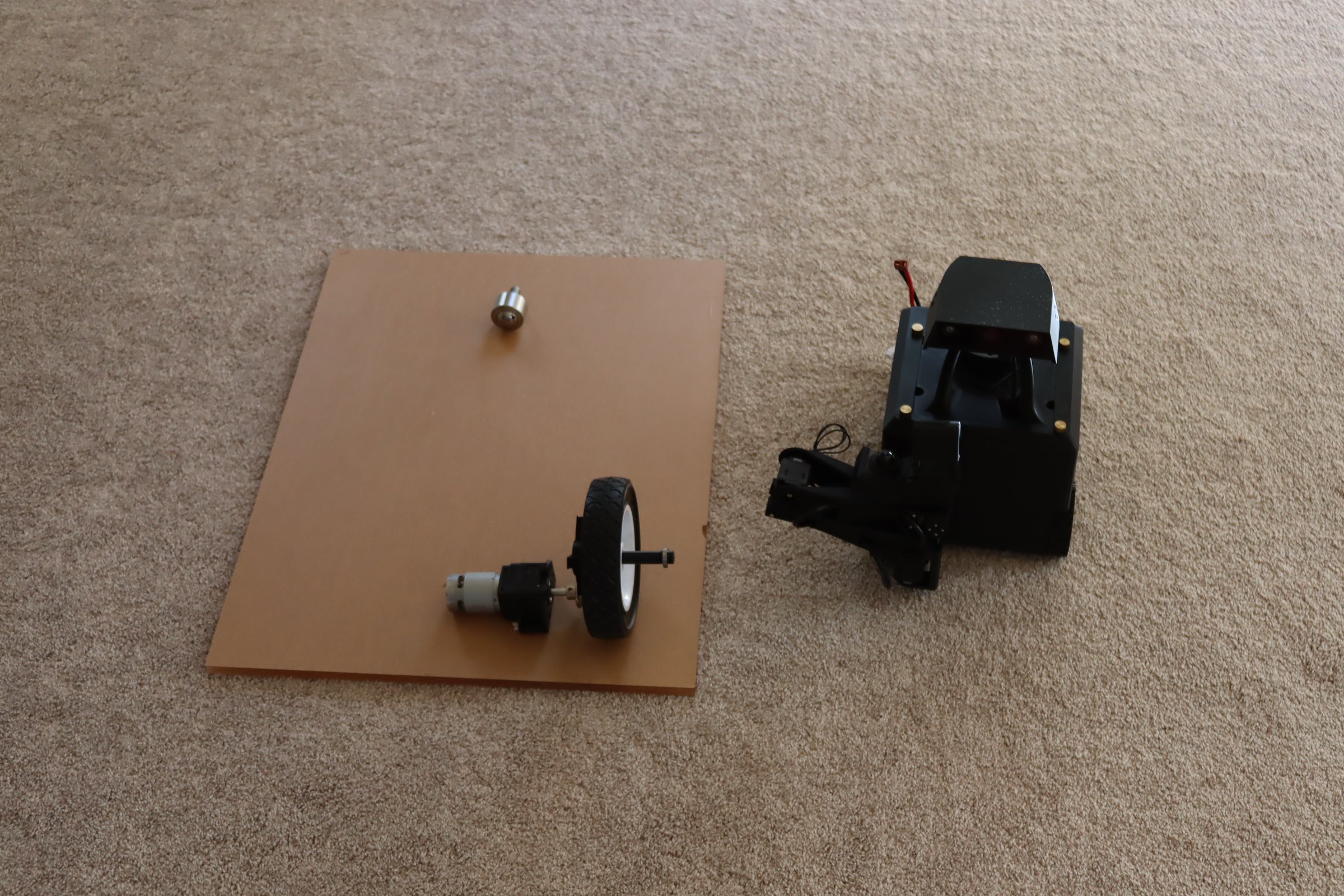

February 19, 2026. Zeno finds the trashcan, then turns around to find me. The goal--Zeno to come to me on command, grasp trash in its gripper then deposit the trash in a can--is coming along. I just added a second Huskylens camera that detects the color of the trashcan and goes to it. Now (Feb. 28), Zeno can grab and hold a piece of trash.

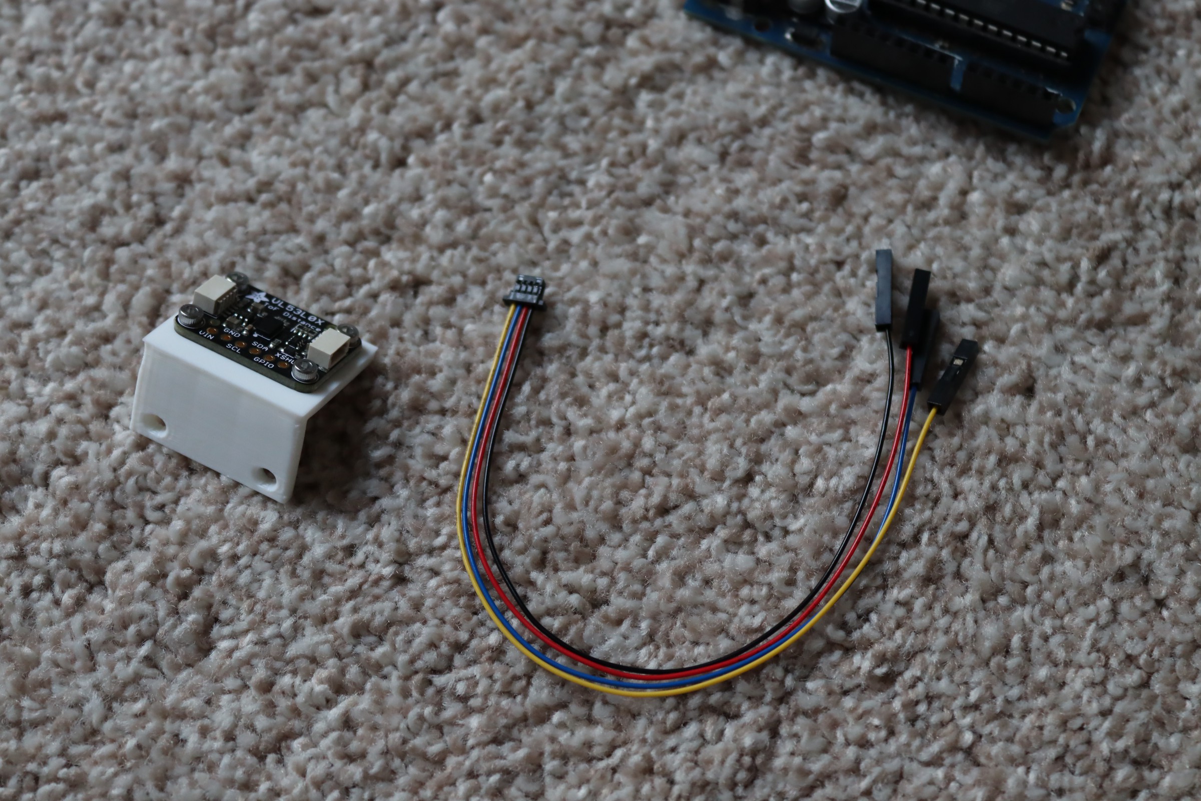

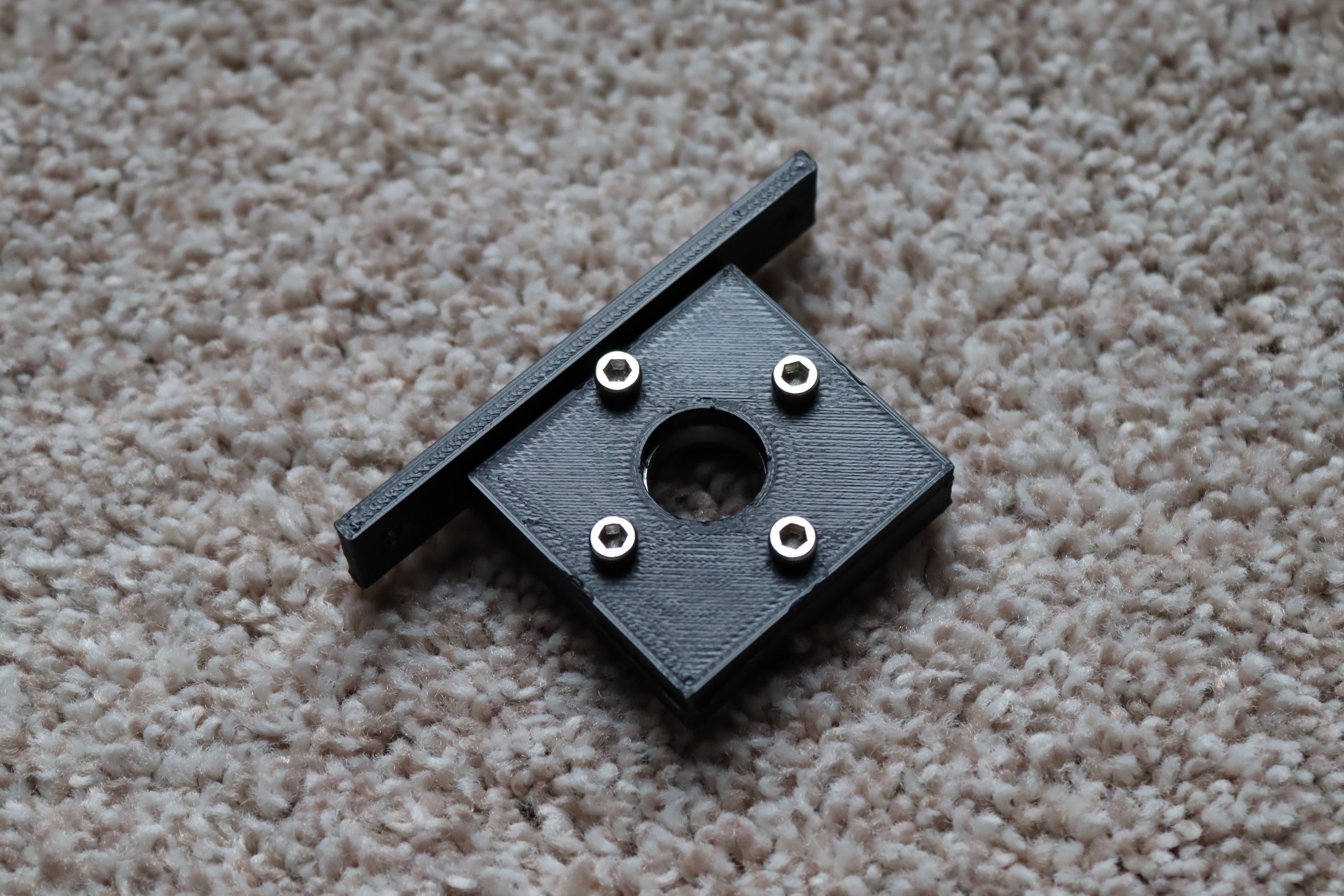

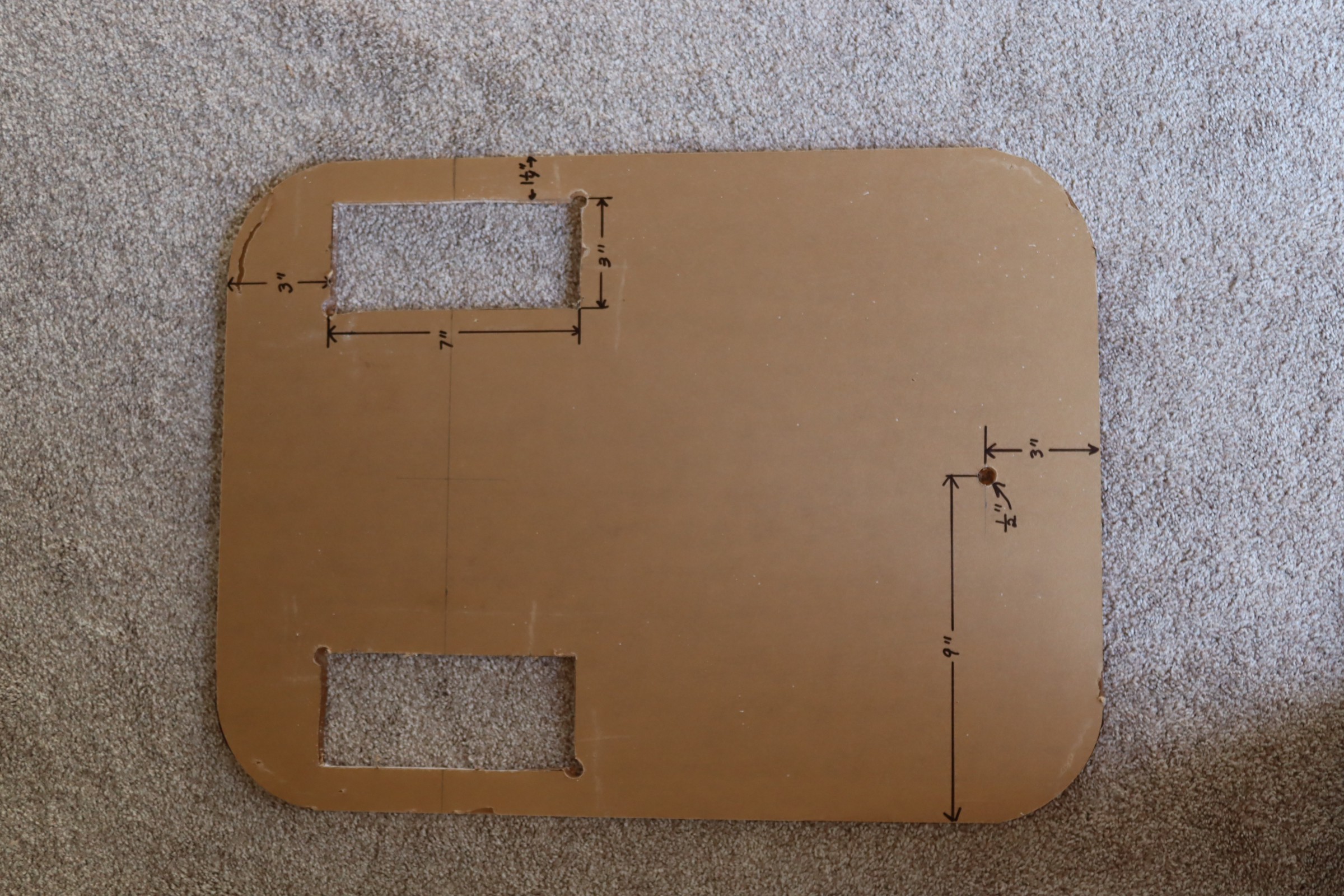

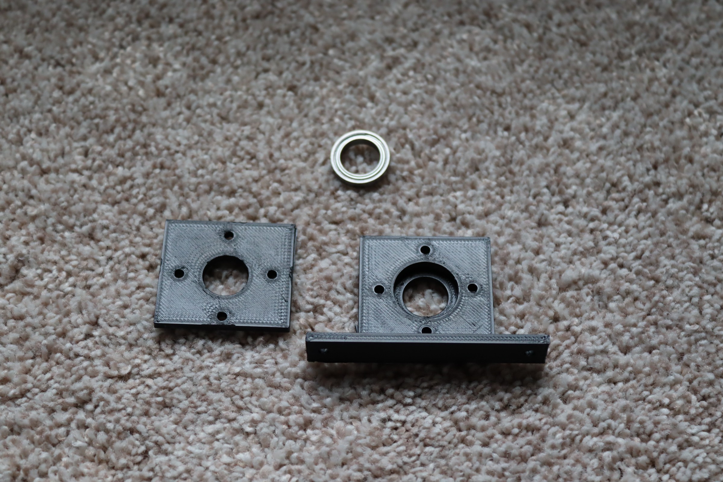

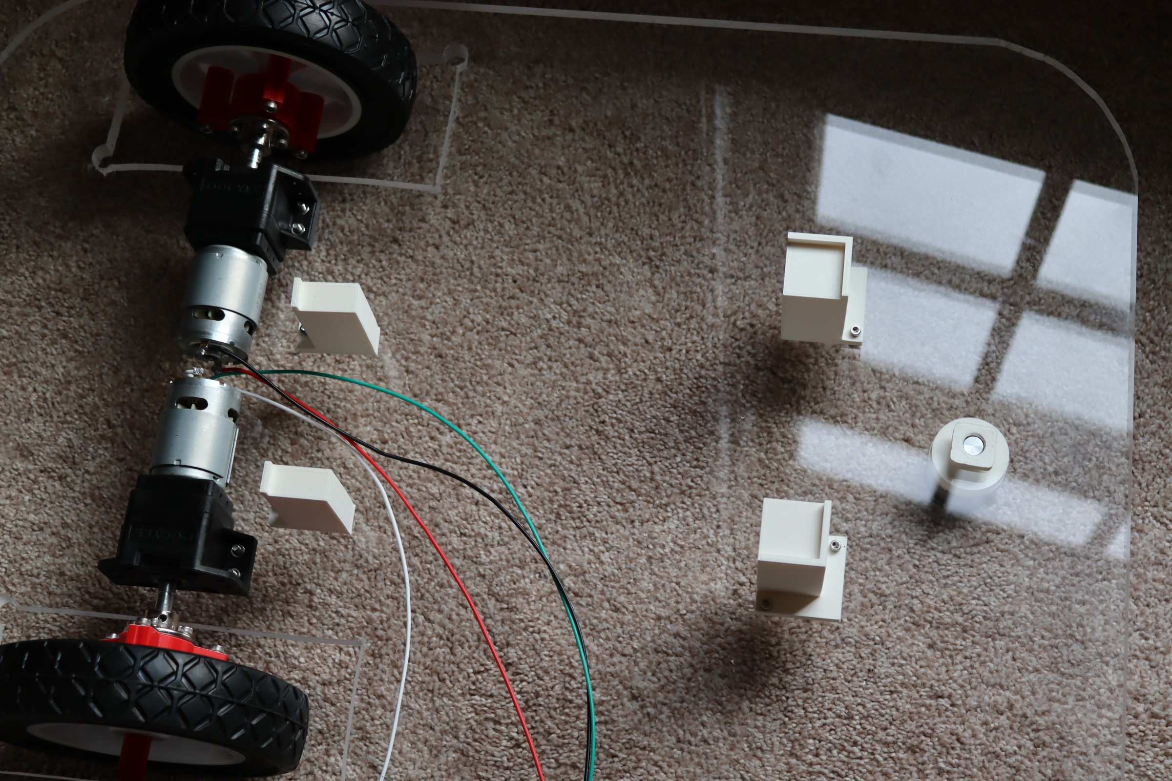

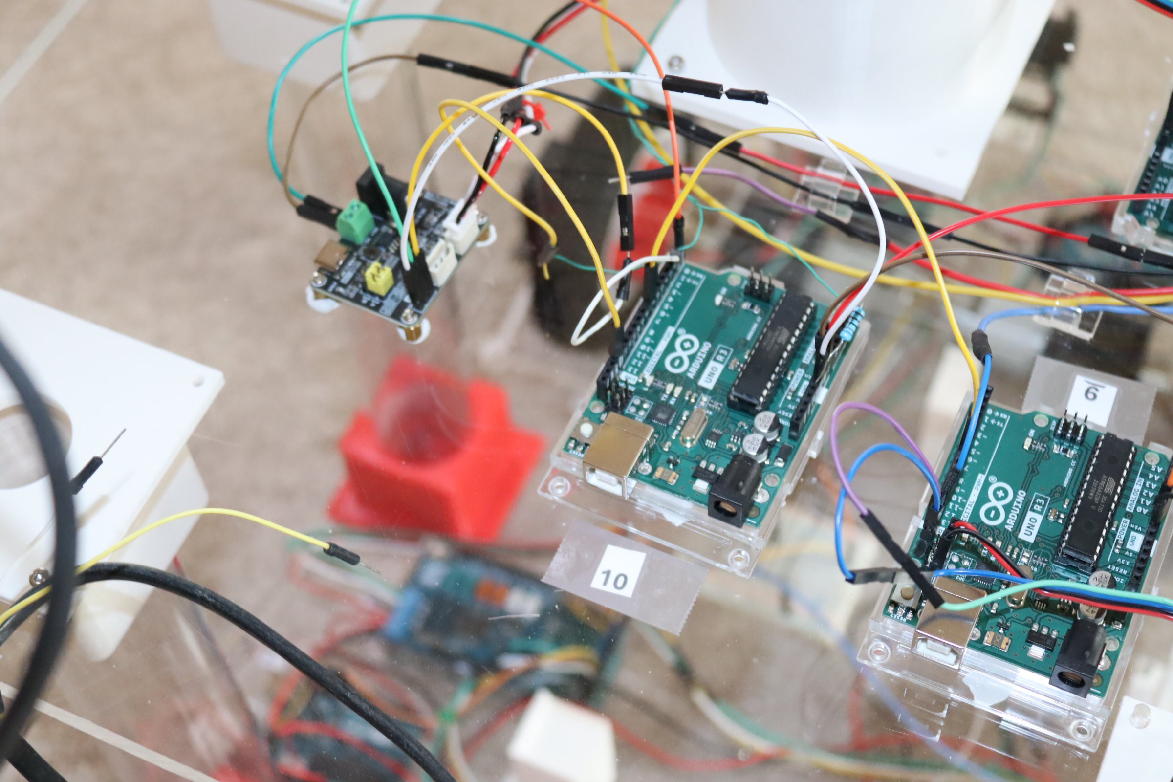

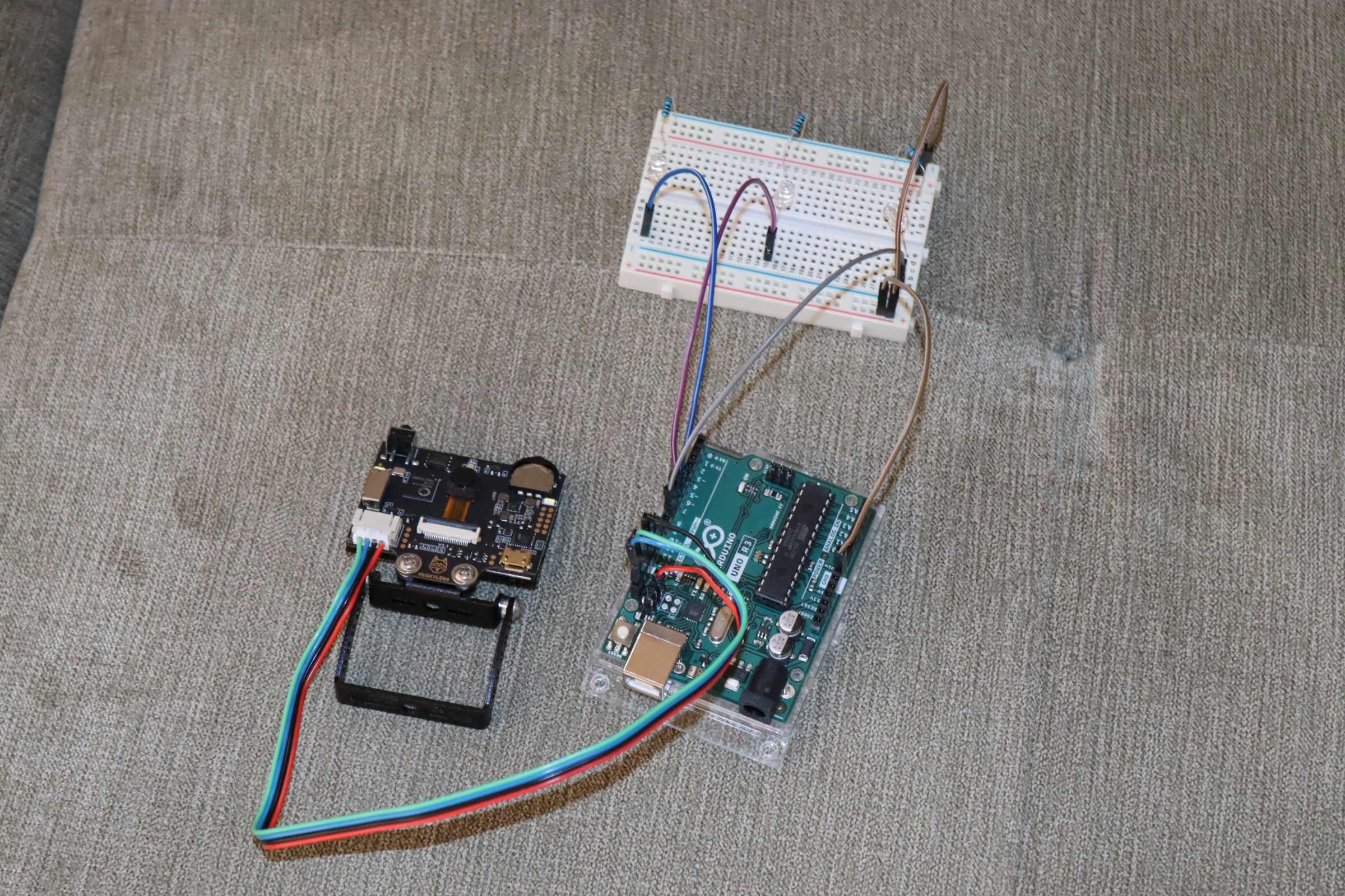

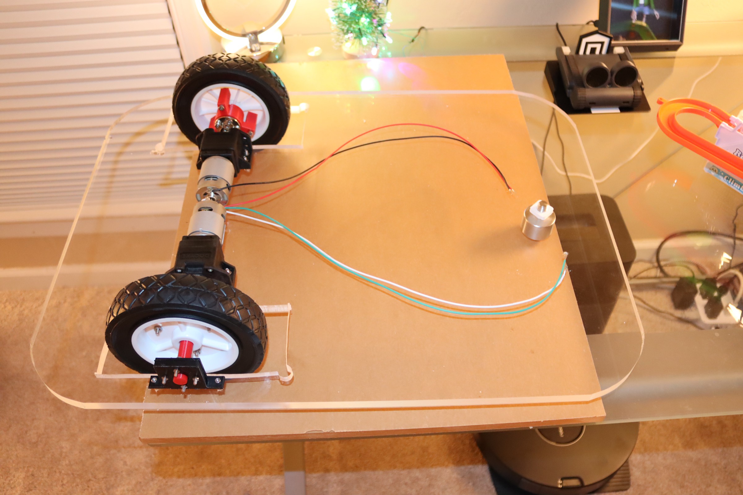

Zeno is my first attempt at a robot strong enough to actually do things. I've taken a "one Arduino per function" approach and I currently have six Arduinos in use (a mega with a motor shield for the drive motors, four Unos (one for each distance sensor) and one Uno to connect the Huskylens (vision) to the motor control. I'll need one for the gripper, one for the gripper camera/arm, one for the gripper distance detector and one for the voice recognition module. That will put me at ten Arduinos. This makes it easy to troubleshoot, but it does require the larger robot body and power supply.
AI, which uses a lot of computing power--often in the cloud, provides great speech recognition/voice interaction and visual perception. A Huskylens and a speech recognition module provides limited voice control and limited visual recognition--but that's less than fifty dollars and it's local.
