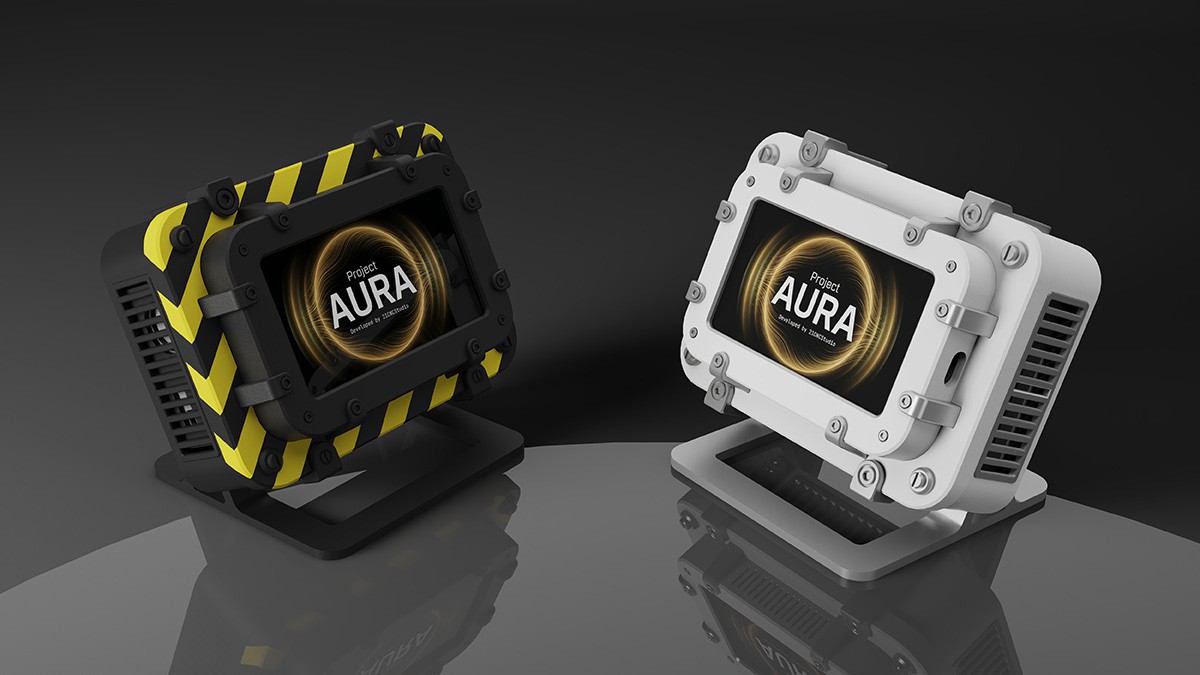

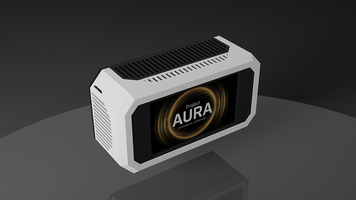

Project Aura takes a different approach: you build it yourself, the firmware is fully open source, and all data stays inside your local network.

Hardware: No Compromises
Main Controller
Waveshare ESP32-S3-Touch-LCD-4.3 — An all-in-one board featuring:
- Dual-core ESP32-S3 processor
- 16MB Flash memory
- Gorgeous 4.3" IPS capacitive touchscreen (800×480)
- The visual quality difference from cheap displays is like comparing an old TV to a modern tablet
The Sensor Suite
Sensirion SEN66 (Switzerland) — The heart of the system. This single module replaces an entire laboratory:
- PM1, PM2.5, PM4, PM10 (full particulate spectrum)
- CO₂, VOC, NOx (air freshness and chemical pollution)
- Temperature & Humidity
Sensirion SFA30 (optional) — Direct formaldehyde measurement. If you've done renovations or bought new furniture, this sensor reveals the invisible danger.
Adafruit Pressure Sensors — Support for DPS310, BMP580, or BMP581. The device auto-detects which sensor is installed and starts plotting pressure trends.
Adafruit PCF8523 RTC — Real-time clock with battery backup. Aura remembers the exact time even when powered off or working offline. When connected to WiFi, time syncs automatically every 6 hours.
