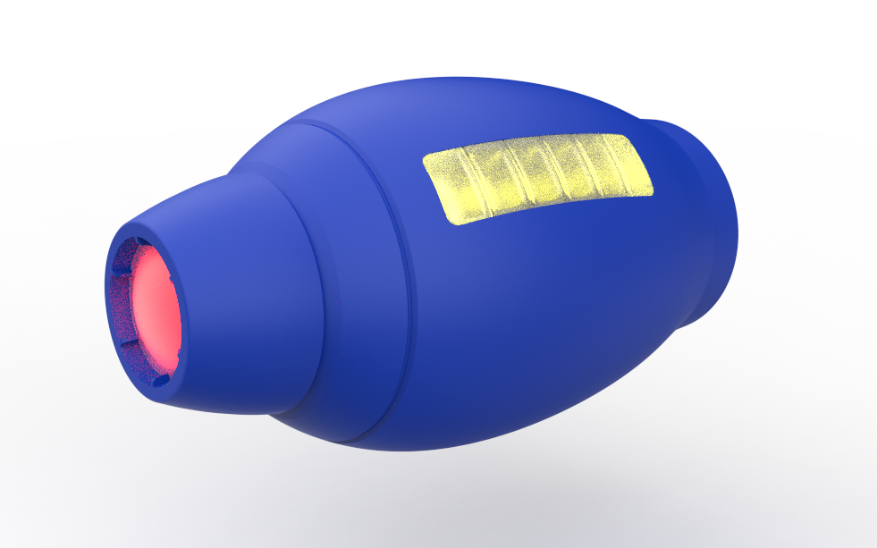

DESIGN

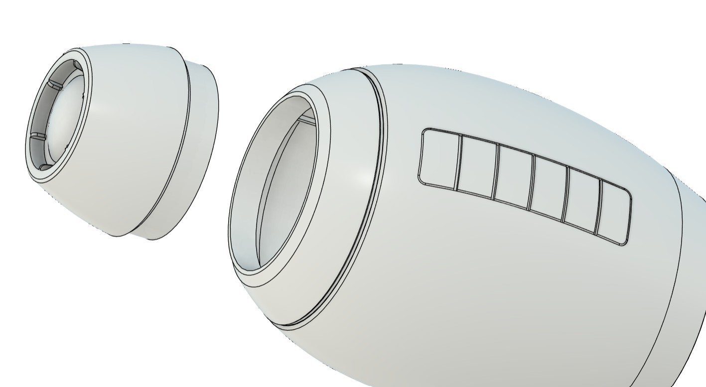

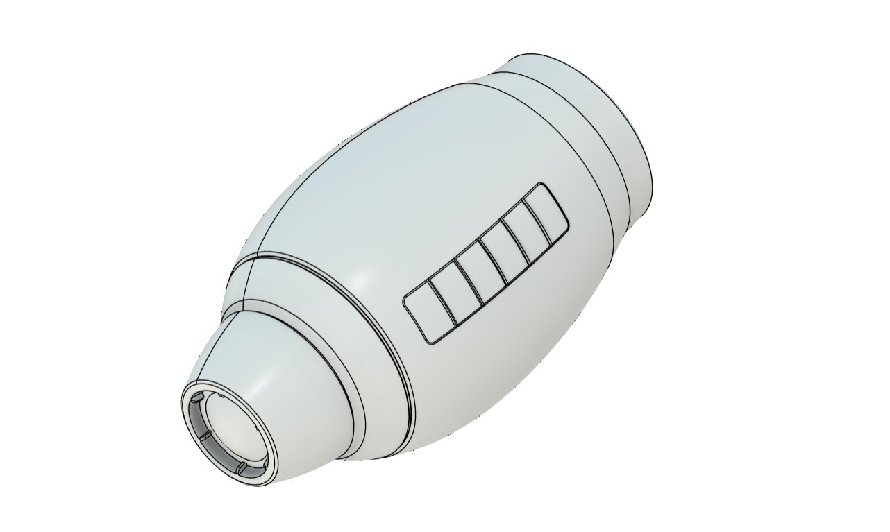

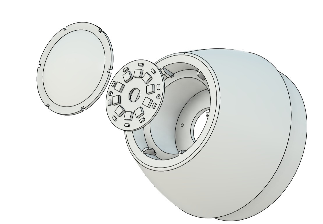

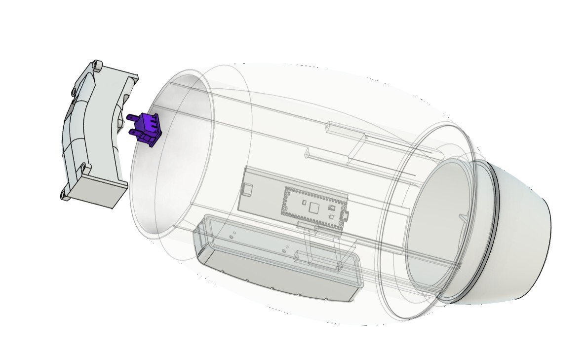

We start the 3D model-making process by first getting a reference image of the Rock Buster from the internet. We import the image into Fusion 360 through the canvas option, then use the calibration function to set the length of the whole gauntlet to 330 mm.
The whole gauntlet is symmetrical, so we can easily make this using the revolve function. To do this, we trace the outline of the gauntlet and then use the revolve function to make a solid gauntlet body.
For the engineering process, we first divide the body into three main sections. The front part is the blaster section, the middle body is a hollow part in which we add the handle grip that is used to hold the whole gauntlet, and inside this section we also add the main control circuit. The third part is the back section, which contains a cushion that supports our arm.

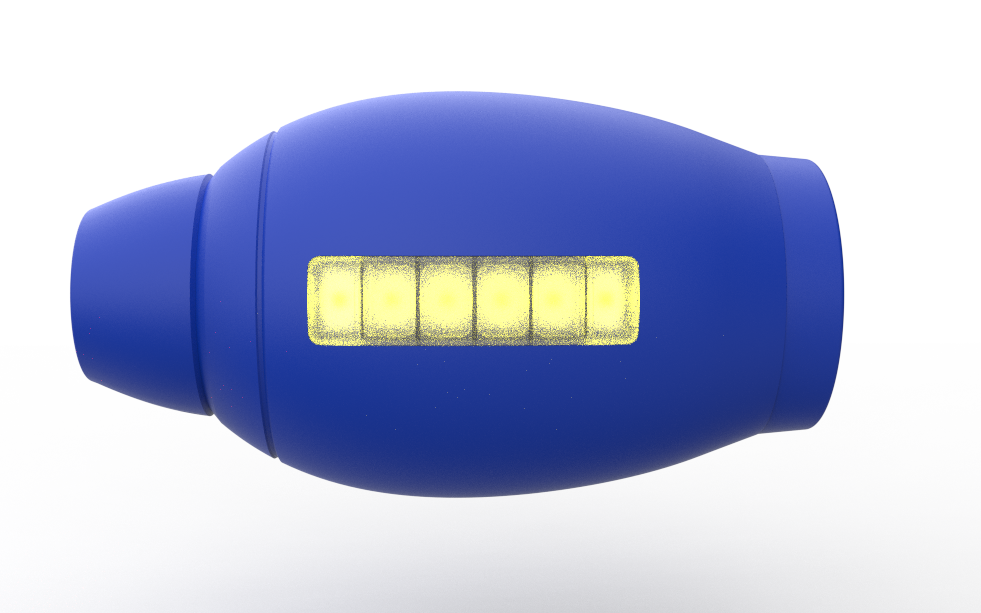

The middle body, or main body, on the left side contains a replica of the yellow power bar. This part is basically a slot...

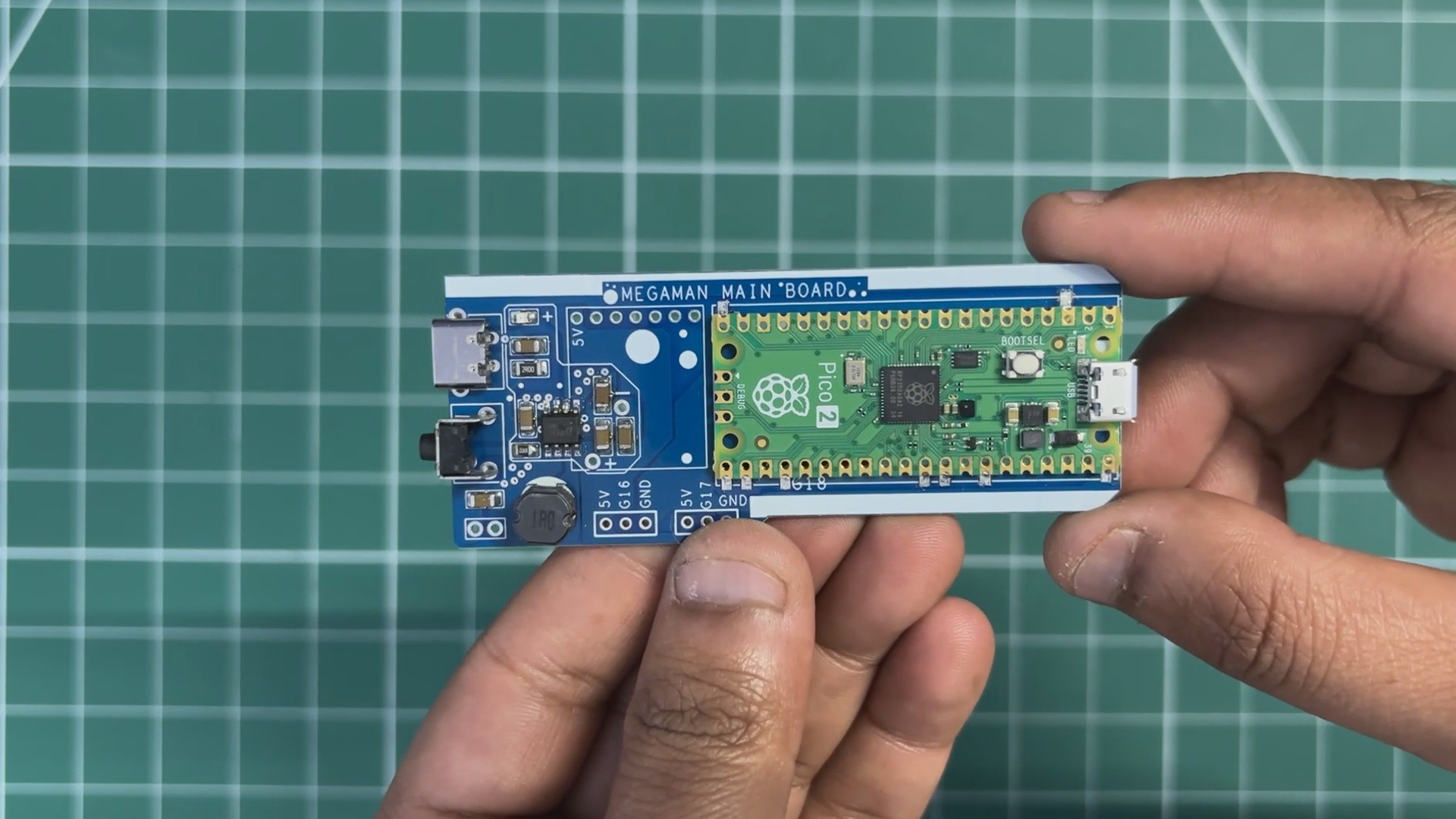

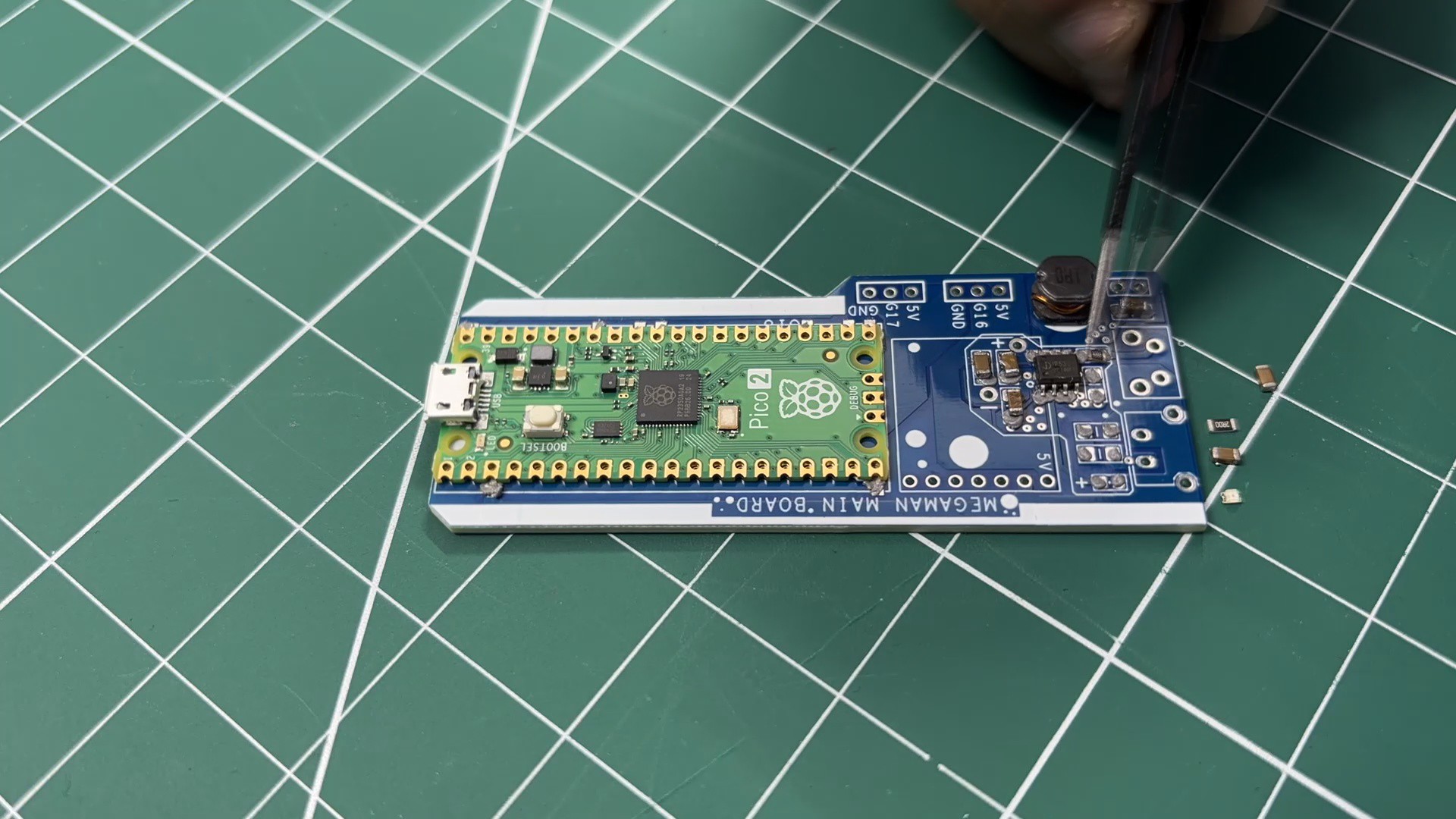

    PCB ASSEMBLY PROCESS- MAIN CIRCUIT

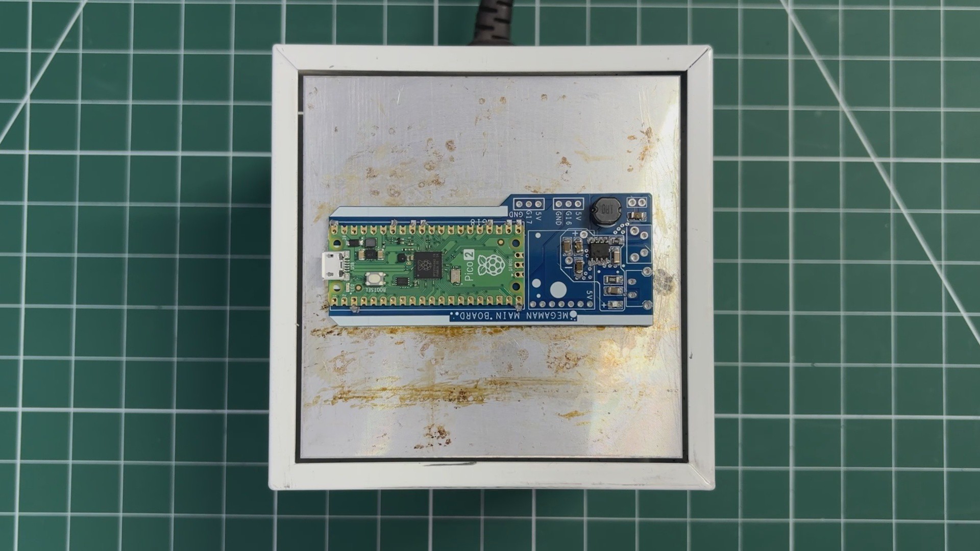

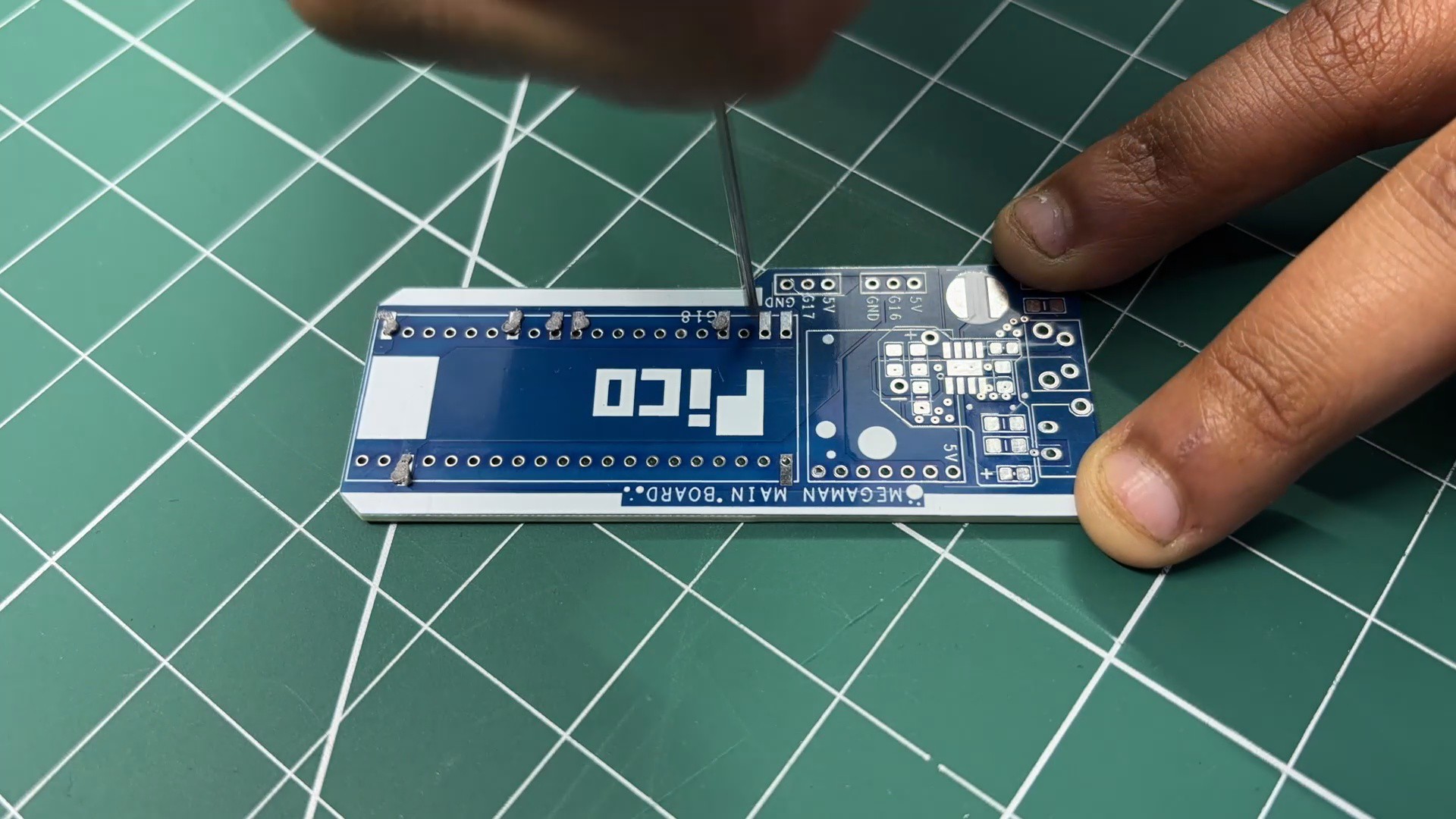

    • We begin the main board assembly process by first adding solder paste to each component pad using a solder paste dispensing syringe. We are using SnPb 63/37 solder paste here, which has a melting temperature of 200°C.
    • Next, we pick and place the Raspberry Pi Pico in its location over the footprint, followed by all the SMD components.
    • The whole circuit is then placed on a reflow hot plate, which heats the PCB from below up to the solder paste melting temperature. When the PCB reaches 200°C, the solder paste melts and all components are secured in their locations.
    • Next, we add the Type-C port in its location, followed by the vertical push button.
    • The board is then flipped over, and the leads of the Type-C port and push button are secured using solder.

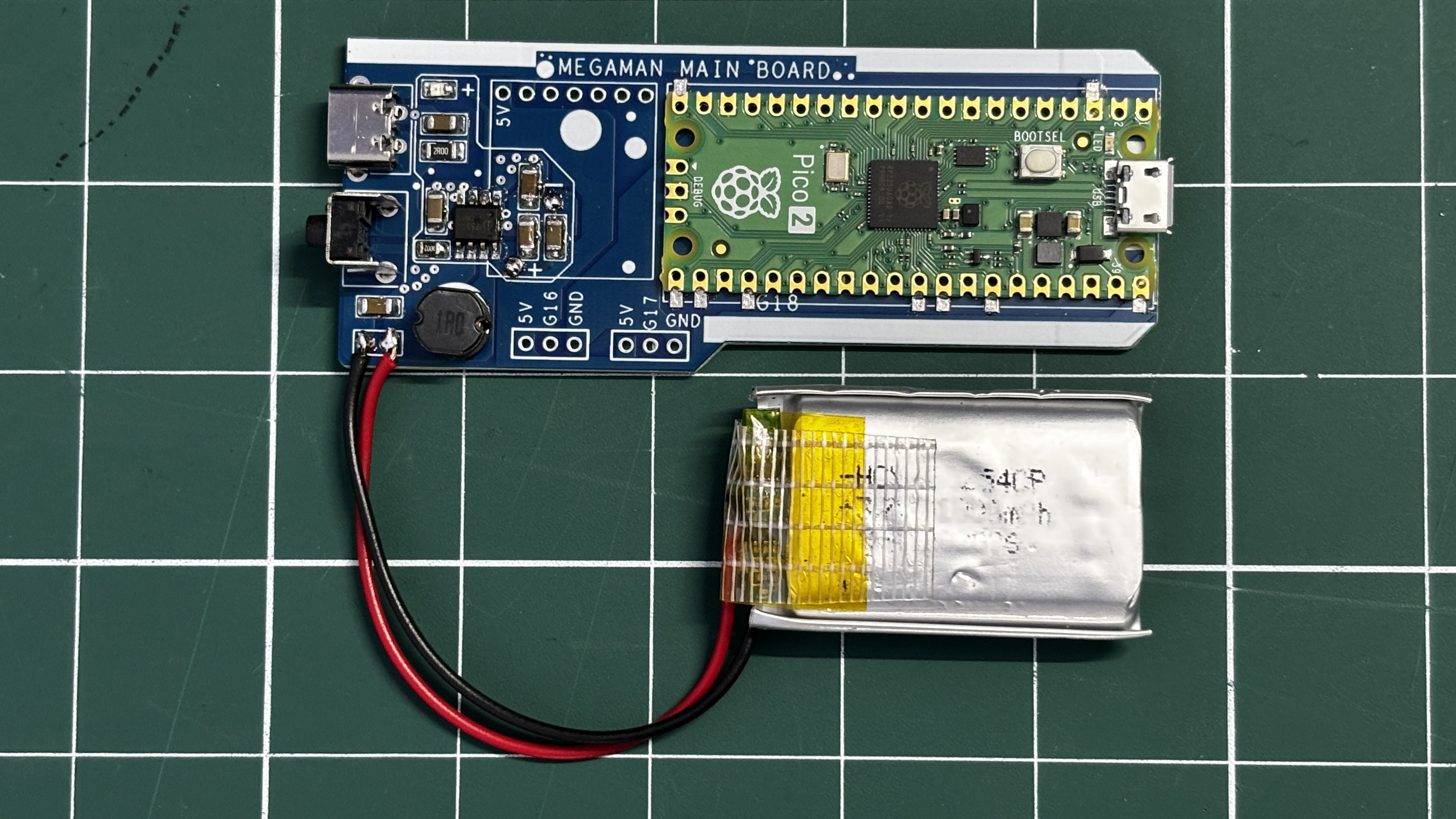

    POWER SOURCE TEST
    For the power source of this project, a 3.7 V, 1000 mAh lithium-polymer (Li-Po) cell is used. The positive terminal of the battery is connected to the B+ terminal on the main board, while the negative terminal is connected to B−.
    A vertical push button is used as the power switch. When the button is pressed, the circuit powers on.

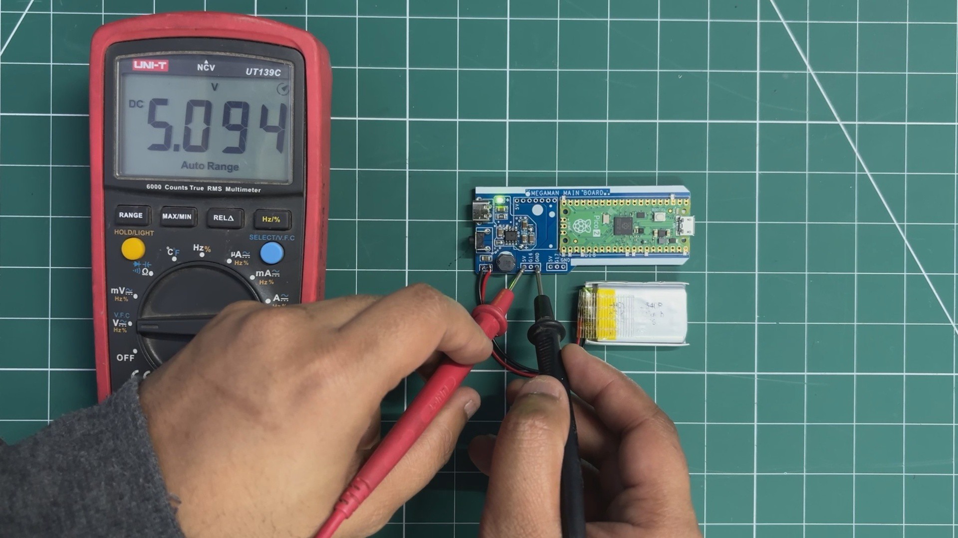

    To verify proper operation, a multimeter is used to measure the voltage across the 5 V and GND pins on the main board. A stable reading of 5 V confirms that the power circuit is functioning correctly and the setup is ready for operation.

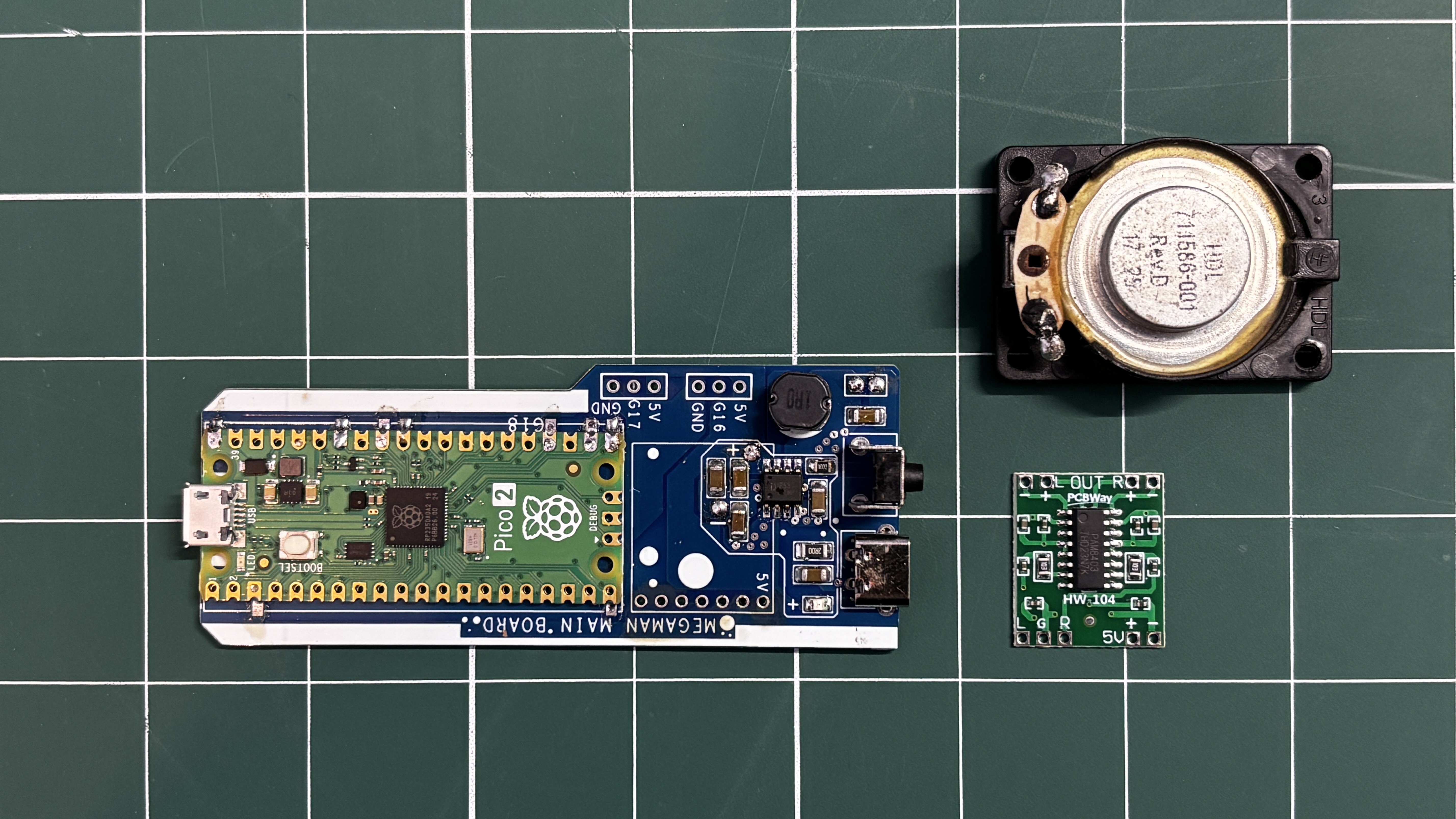

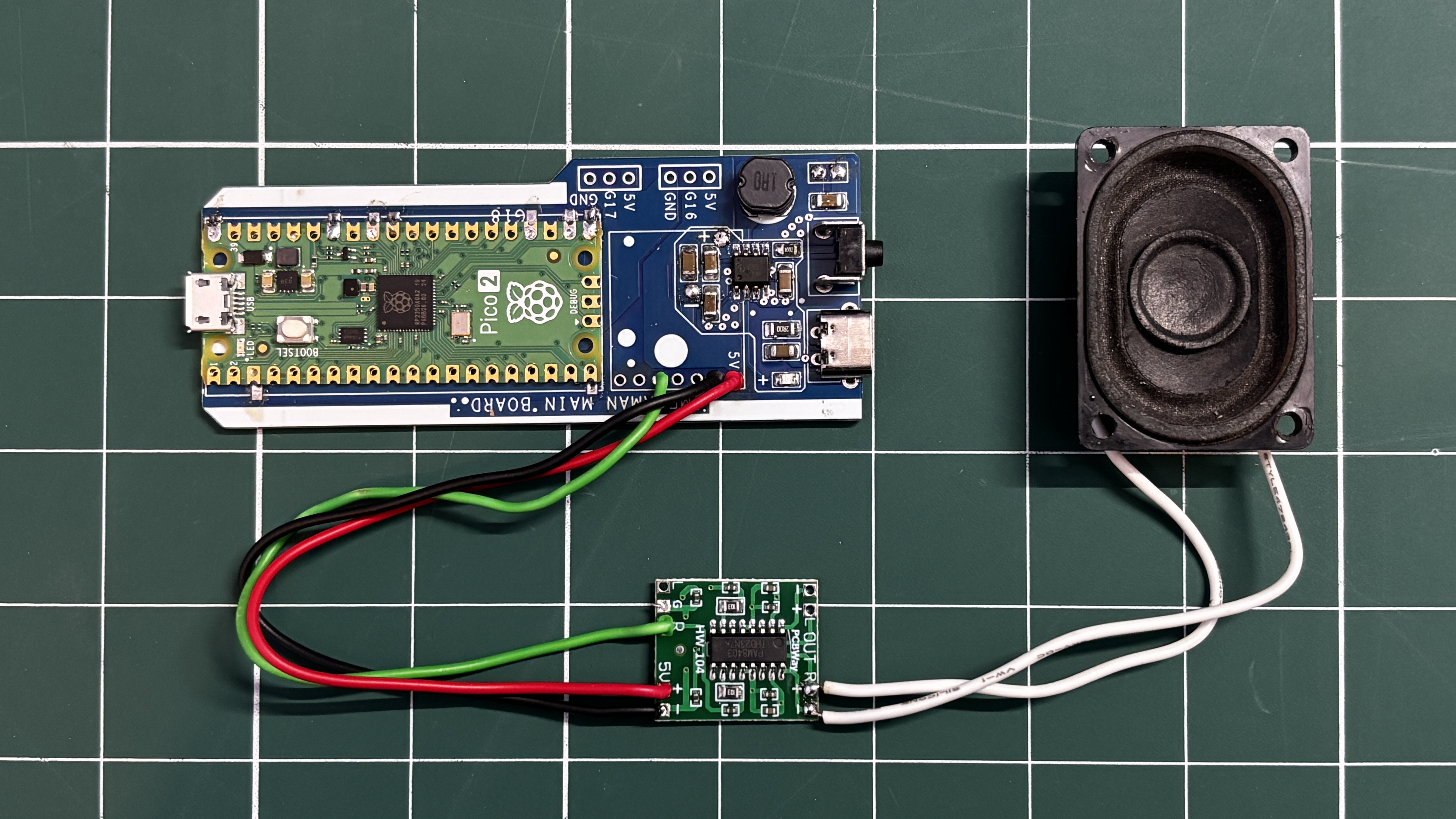

    MAIN BOARD AUDIO MODULE ASSEMBLY & DEMO
    A speaker cannot be connected directly to the Raspberry Pi Pico’s GPIO pins for practical audio output. While it may work electrically, the sound level is extremely low and not suitable for a wearable prop. To solve this, an external audio amplifier is required to boost the Pico’s audio signal.
    For this project, I used the PAM8403 audio amplifier module. The PAM8403 is a compact Class-D amplifier capable of driving small speakers efficiently.
    The wiring was done as follows:
    • PAM8403 R input to GPIO26 of the Raspberry Pi Pico
    • PAM8403 GND to GND
    • PAM8403 5V to 5V output from the custom power circuit

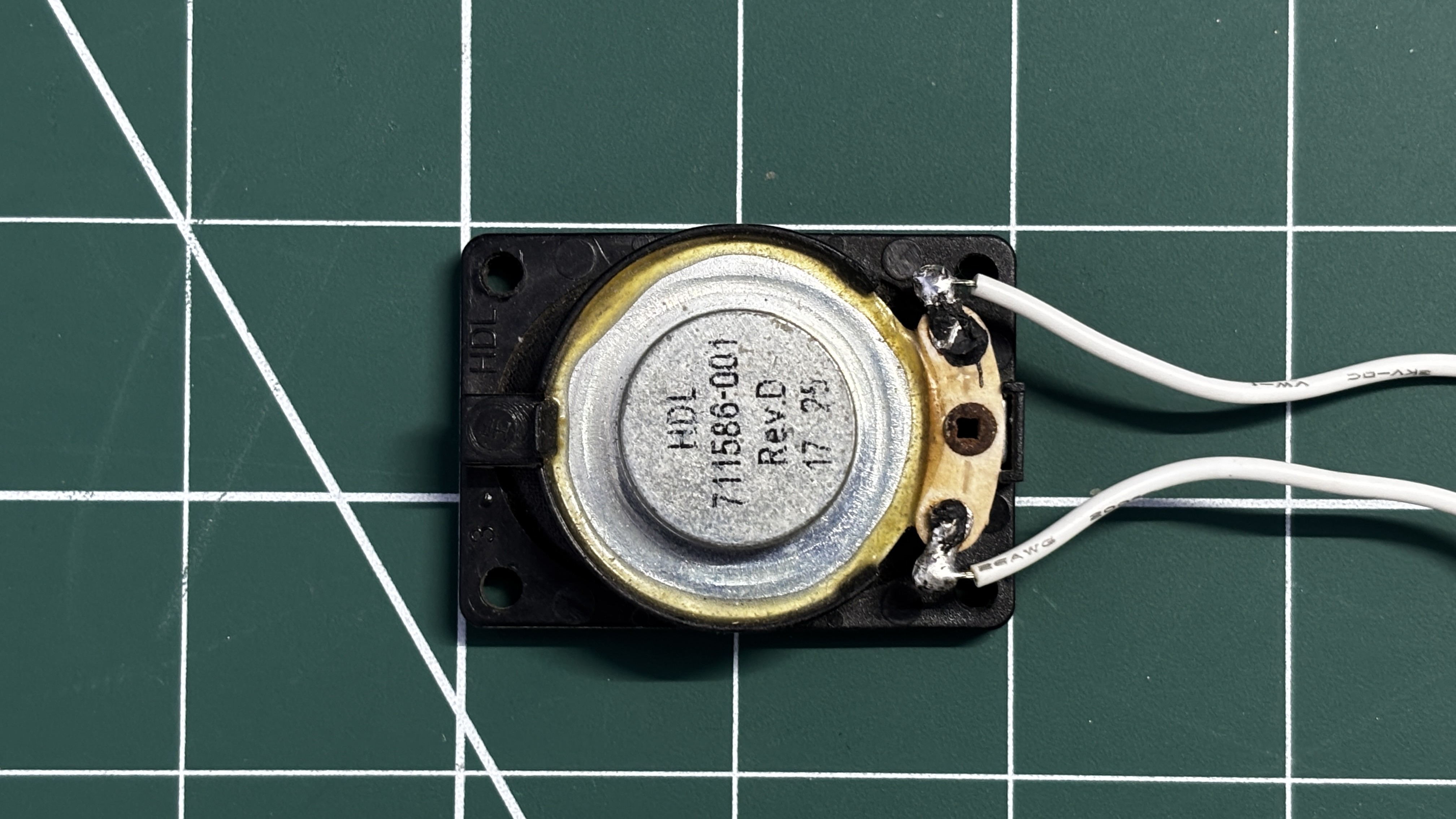

    For the speaker, I used an 8-ohm, 2-watt speaker salvaged from an old laptop. The speaker was connected to the R output terminals of the PAM8403 amplifier board.
    After completing the wiring, a simple test sketch was uploaded to the Pico.
    The speaker successfully produced a stable beep for a few seconds, turned off, and then repeated the sequence in a loop. This confirmed that the amplifier and speaker setup were working perfectly.
