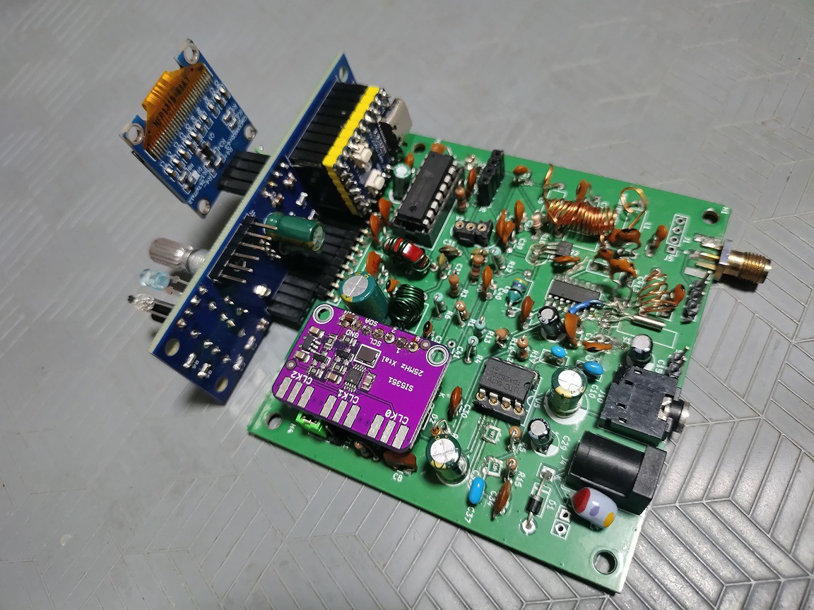

This design addresses these issues by:
Using a 21.4 MHz IF to increase image separation
Implementing a 3-pole Chebyshev band-pass filter at the RF front-end
Using TA2003 as the first mixer stage for low-noise analog processing
Employing Si4732 as the DSP-based main receiver
Controlling frequency via Si5351A + Arduino for flexible tuning and memory channels

RF Front-End Design
A key aspect of this receiver is the RF front-end.
Unlike simple low-pass filtering, a band-pass filter is essential to suppress both:
Strong FM broadcast signals below the band
Image frequencies above the band
The implemented 3-pole Chebyshev filter provides:
Passband: 118–137 MHz
Image rejection: ~20 dB at ~160 MHz
This enables effective suppression of unwanted signals without requiring band switching or complex tracking filters.
Measurement
The RF filter was measured using a nanoVNA.
Passband (118–137 MHz): low insertion loss
Image frequency (~160 MHz): ~20 dB attenuation
These results confirm that the front-end design effectively suppresses out-of-band interference.

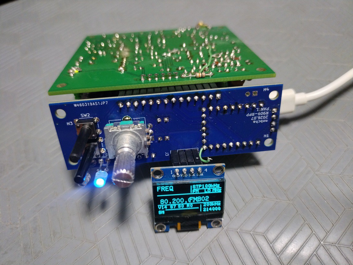

  • R909 Airband Receiver Gets a Raspberry Pi Pico CPU
    nobcha08/22/2026 at 11:27 0 comments
    I reused the Raspberry Pi Pico board originally designed for my R909-tester project as the CPU board for my R909-DSP airband receiver.
    The existing receiver firmware required only minor modifications, and the receiver is now working.
    The R909-DSP project is my ongoing DIY development of an airband receiver.
    {PHOTO}
    For the R909-tester, I designed a PCB using a **Raspberry Pi Pico Zero module from Waveshare**. I made a mistake when placing the I2C connector for the OLED, so the first PCB was not assembled as intended.
    https://hackaday.io/project/206070-r909-tester-a-modular-rp2040-zero-instrument/log/249589-r909-tester-pcb-is-ready-but-found-a-bug-during-assembly
    Instead of throwing it away, I decided to reuse it as an experimental CPU board for the R909-DSP.
    I ported the existing R909-DSP receiver sketch to the Pico.
    It now works with the existing TA2003 + Si5351A + Si4732 RF front-end.

  • Log#2 UI / Control Specification
    nobcha05/18/2026 at 10:51 0 comments
    A compact receiver requires a simple but consistent user interface.
    All parameters are updated immediately when adjusted, eliminating the need for an explicit ‘apply’ operation.
    Frequency tuning resolution is defined by a dedicated step mode.
    EEPROM storage is used only to restore parameters after power cycling.
    The interface separates real-time control from persistence, keeping operation simple while maintaining flexibility.
