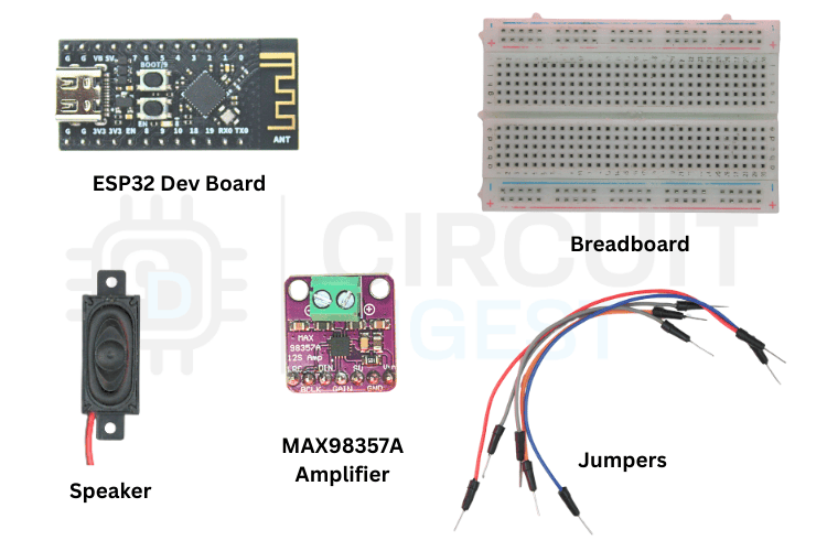

🧩 What You Need
The components needed for ESP32 C3 Text to Speech using AI
| Component | Purpose |
| ESP32-C3 Dev Board | Main controller (Wi-Fi + GPIOs) |
| MAX98357A I2S Amplifier | Digital audio driver |
| Speaker (4Ω or 8Ω) | Plays the audio |
| Breadboard + jumper wires | Prototyping |
| USB Cable | Power & programming |
This setup uses the I2S digital audio interface, which lets the ESP32 transmit streamed audio directly to the amplifier.

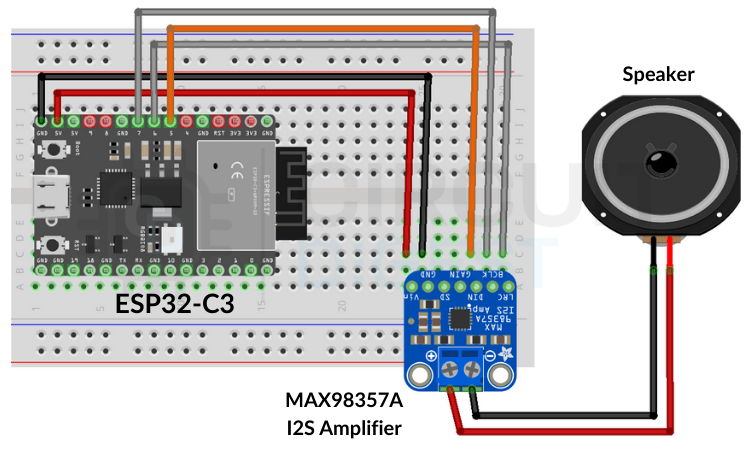

🔌 Wiring
Connect the ESP32-C3 to the MAX98357A amplifier:
| ESP32-C3 Pin | MAX98357A Pin | Signal |
| GPIO07 | BCLK | Bit clock |
| GPIO06 | LRC | Left/Right clock |
| GPIO05 | DIN | Audio data |
| 5 V | VIN | Power |
| GND | GND | Ground |
Double-check wiring to avoid shorts before powering up.

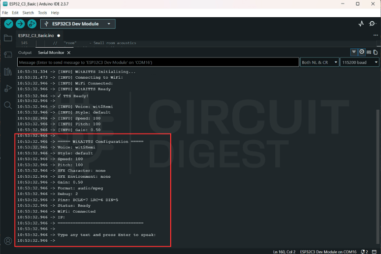

Upload the sketch.
Open Serial Monitor (115200 baud).
Type a sentence and press Enter.
Your ESP32 starts streaming and playing the AI voice audio.
