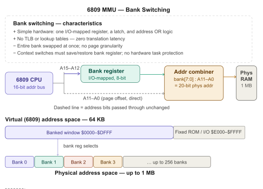

  • MMU design
    roelof4a day ago 0 comments
    The presence of a Memory Management Unit is a requirement for multi-tasking operating system such as OS-9 and UniFLEX both of which have many features from UNIX.
    Before diving into the details of the CS09 MMU I though it might be good to give an overview of the 3 main approaches to create extra address space (not necessarily MMU)
    1. Bank switching:

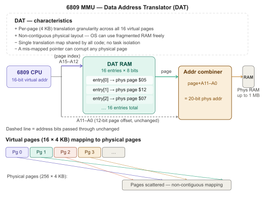

    2. Data Address Translation:
    3. DAT + task selector:

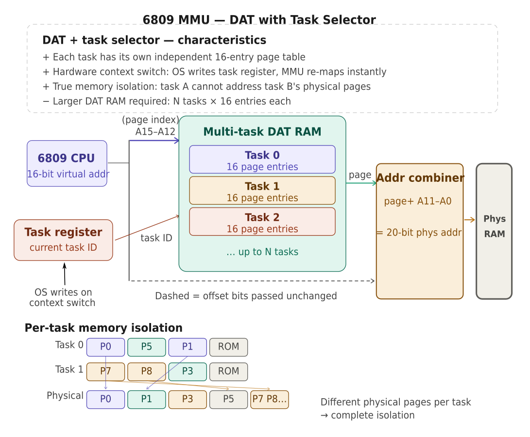

    The DAT + task selector gives most flexibility how to structure memory larger than 64kbyte and allows quick switching of the memory mapping of individual tasks without rewriting the DAT RAM.
    Often the task register is a physical register (latch) in real implementations which the CPU will update when there is a switching of tasks. The CMS9639 took this concept one step further and introduced a small 4x8bit memory to replace the task register. This allowed 4 sets of task registers that would form:
    - System task (task 0)
    - User task
    - DMA source task
    - DMA destination task
    Switching between these is automatic and done in the logic chip. So whenever a software or hardware interrupt occurs the System task will be selected and so on.

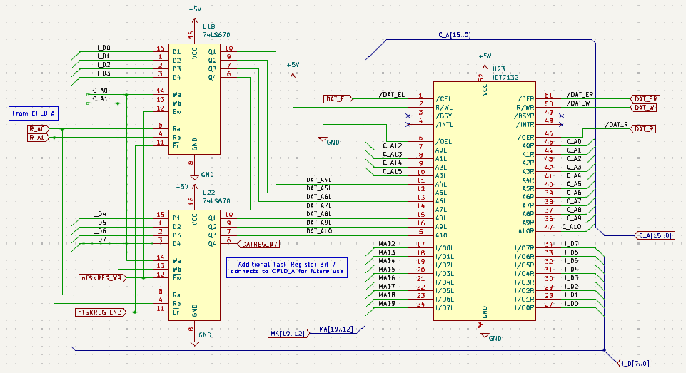

    Below a snippet from the CS09 CPU schematic showing the chosen implementation:
    Rather than using a standard 2kbyte RAM memory like the CMS9639, I have followed the approach by Kees Schoenmakers and used a dual-port memory chip (IDT7132). These are fast (35ns) and do away with extra tri-state buffers that are needed for normal memory when switching from MMU use to writing its contents. Here the righthand side of the dual-port memory provides access to its contents (I_D is the internal databus, C_A the CPU address bus). The left side takes CPU address lines A12..15 and the output from the small memory chips and outputs the MMU addresses MA12..MA19 which together with C_A0..11 will form the external address bus.
    A set of pullup resistors on MA12..MA19 defines the external bus address before the dual-port RAM has its contents defined and taken out of tri-state. Currently the most significant bit (DATREG7) is not used and connected to the logic chip. In future this could be used to introduce memory write protection.
    Motorola did, in fact, develop a MMU chip - the MC6829 - that provides 2kbyte pages. This chip was not long in production and not many copies are around. Unfortunately, the delay in outputting the translated address lines was significant which made operation at 2MHz next to impossible. I know only one commerical machine that used the MC6829, the Positron 9000 (https://binarydinosaurs.co.uk/Museum/Positron/).

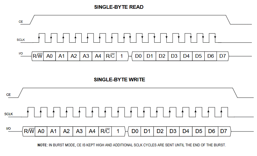

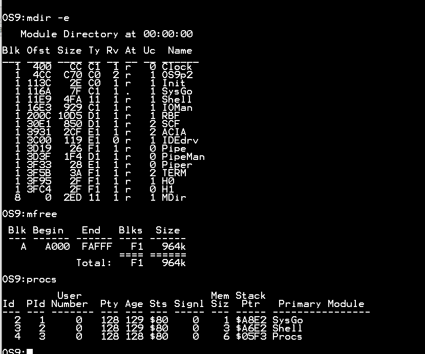

  • Realtime Clock
    roelof45 days ago 0 comments
    OS-9 uses a 100Hz oscillator driven signal to keep track of time. As mentioned this signal is connected through the PIA (MC68B21/HD63B21) and generates interrupts every 10ms. Upon calling the 'setime' command the PIA is initialised and valid time information becomes available to the system. Often the setime call is included in the 'startup' file which is automatically run at boot time.
    Because there is a battery backed Realtime Clock (DS1302) available there is no need to manually enter date and time information (once the Realtime Clock is setup) every time the system boots.
    In order to include the reading of the Realtime Clock at boot time changes are made to the Clock module and the setime command. Before discussing these changes it would be good to discuss the Realtime Clock itself and how it is interfaced to the CPU.
    Unfortunately the use of the same Realtime clock chip (MSM5832) as used on the CMS9639 was not an option since this obsolete chip is difficult to source. Since there was little board space available it was decided to go for a chip with a small footprint and a serial interface. The DS1302 provides date, time and a small number of non-volatile RAM locations. Its interface is bespoke and shown below.
    There are only three pins for exchanging data. A ChipEnable selects the device and data (IO) is shifted in/out using a SerialCLocK. Only the IO pin is bidirectional.
    Originally I hooked the DS1302 to a couple of unused PIA lines and implemented a software interface to read/write date & time information. That resulted in quite a bit of code (provided) and since there was some space left over in the CPLD chip, it was decided to create a bespoke interface using a Verilog module.
    For fun I tried to use one of the AI agents to write a module for me. This turned into a disappointing result that didn't work because the agent misinterpreted the asymmetry between reading & writing and was unable to generate the right code even when this issue was pointed out.  After testing about ten versions I gave up :(
    Thinking someone would have tackled this already I searched online and found a github repository (link in the code) that implemented burst reading/writing (many registers in one go without transmitting the address info for every register). I modified this code to include single register read/write which I needed to change the trickle charge settings. This code is provided in the file section. I will discuss the detailed instantiation of this module within the top level Verilog code in the near future. Since the actual code is rather large I will try to do this in sections.
    From a software perspective this interface takes 8 memory locations ($FFB0..$FFB7) that provide date&time and command/status register ($FFB7). In the command register the user selects the type of operation (burst read/write or single register read/write). The status register shows when the serial interface is busy/ready with any operation.

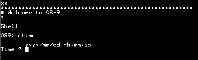

    With this interface tested it was decided to modify the 'year 2000 compliant version' (source available online: y2k upgrade) of the setime command (setime edition version 12) slightly to add an option (-s) to read the Realtime clock date & time information and copy this to the OS-9 time rather than typing it in. Setting of the Realtime Clock is done automatically if the 'setime' command is provided with user date&time information in the usual way (i.e. both OS-9 system time and Realtime Clock are set).
    By adding 'setime -s' in the startup file the copying of the date&time info is automatic. The space between setime and -s is optional and 's' can be 'S'.
    In the modified Clock module care is taken that the Realtime Clock is present and not in a 'halted' state before initialising.
    At this point no use is made of the DS1302 RAM memory but the provided Verilog module and interface is fully prepared for it simply by reading/writing to different addresses within the DS1302 use can...

  • OS9 Clock Module
    roelof404/02/2026 at 12:00 0 comments
    The OS9 Clock module is an interesting one. In the OS9 hierachy diagram it sits together with Init at the same level as the OS9 kernel (OS9p1 & OS9p2).
    The Clock module takes care of initialising the clock which is a 100Hz oscillator driven signal which, in our case, is connected to the onboard MC6821 (PIA). The PIA also provides a TimerEnable signal which is used to stop the 100Hz clock if it is logical '1'.
    Also the Clock module provides seconds,minutes, hours, etc. registration based on the 'ticks' coming in from the 100Hz clock. This is done through generating interrupts by the PIA.
    There is no direct start of the clock by the operating system. In fact the F$Time system call is only available when the Clock module is called using the Setime command which also starts the Clock.
    Below a snippet showing how the PIA is setup and the clock is started by setting the TimerEnable signal low '0'. By default the TimerEnable is '1' due to a pullup resistor.

  • OS-9 DMA disk driver details
    roelof403/26/2026 at 10:37 0 comments
    As mentioned I use an IDE (PATA) type interface to connect to storage devices like hard disks or Compact Flash cards. There are several adapters for CompactFlash cards that plug into IDE connectors to make that easy.
    Currently the Boot loader module that resides in EPROM reads the disk using Programmed Input/Ouput or in other words data is transferred not using DMA but simply by programmatically reading byte for byte. This allows the code to be very compact and since that is the only task running has little downside.
    The IDEdrv RBF driver is using DMA to quickly load sectors of data to memory. Since we are using burst DMA (during which the processor is HALTed) no other task is running. However, there is a significant delay between issuing a read sector by DMA command and the onset of the DMA transfer. The delay depends on the drive used. For the CompactFlash card that I use (Scandisk Ultra II) this delay is 0.28ms much longer than the actual DMA transfer of 256bytes (which is several tens of microseconds). Currently the driver simply polls the DataReady bit during these 0.28ms then the CPU is HALTed once data is ready. So no interrupts are involved at this stage.
    It would be better to issue the read sector command go to sleep so other tasks can run and use an interrupt when done. But it is a bit more complicated than that. Because the DMA controller needs to be setup before the transfer we can't do this at the time of issuing the read sector command. That is because the same DMA controller is used for other tasks (such as moving data between tasks by OS-9 system calls). So one would have to issue the sector read command without setting up the DMA registers, go to sleep and wake up when data is ready as signalled by the IDE disk. Then load the DMA registers and acknowledge the DMA transfer. That way there is no clash between DMA users and other tasks can use the 0.28ms of waiting for data from the disk for useful operations.
    Although IDE devices have a dedicated Interrupt request line, this line is toggled only at the end of the DMA transfer which is not what we want because the driver will release the CPU directly after the DMA transfer. In our case we would like an interrupt signal directly before the IDE disk is ready to do the DMA transfer so we can quickly upload the DMA registers and allow the transfer to happen. Plan is to use the DMA request signal to trigger the interrupt request and toggle the DMA acknowledge line to the IDE disk once the DMA registers are loaded and the DMA is armed. Just like the CPU board, the IDE interface is built around a complex logic circuit and details of signalling can be adjusted easily through changes in the verilog code.
    Details of putting read/write disk to sleep and how to wake them up are described in the OS-9 programmers manual (pages 6-15 and 6-16) and the interrupt service routine on page 6-19. I have revision H (January 1984) of the manual.
    I had a look around to see how legacy drivers handle this and unfortuately I haven't found many such disk drivers around. There is the GIMIX G68 driver but that is centred on doing 'cycle stealing' DMA as far as I can see. It does show how the Sleep and Busy and Wakeup signalling is done. It also introduces a system variable that indicates if the DMA device is 'in use' or 'free'.
    For those interested in the code I have attached the source code for the Boot module and the current IDEdrv RBF device driver (still working out how to setup the CodeBerg repository ...).
