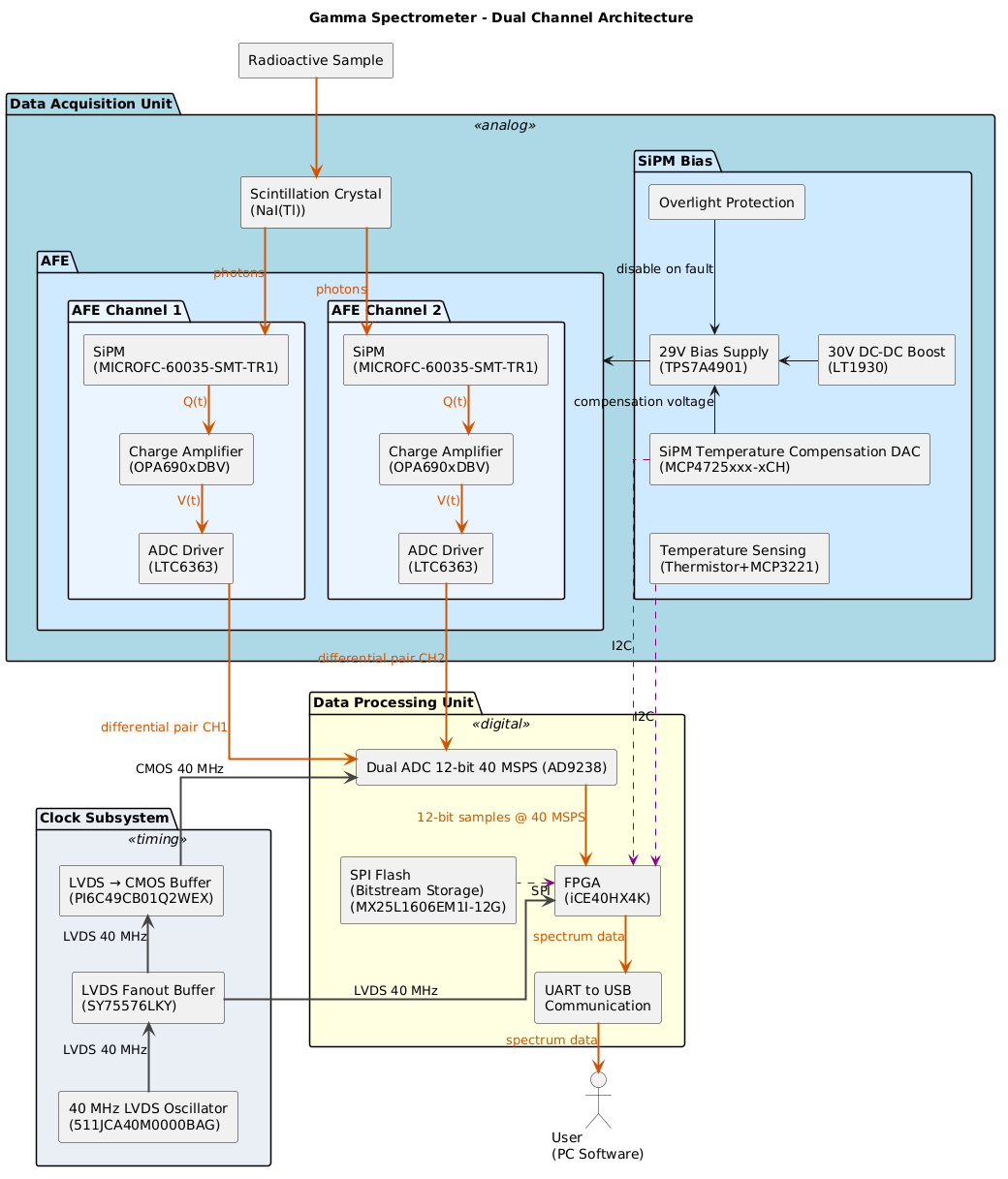

Hardware
Architecture Overview
The hardware consists of four main parts:

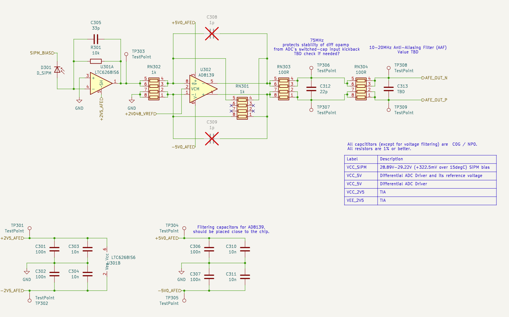

Analog Processing
Handles low-level currents produced by the sensor (typically 1uA - 1mA pulses, 10mV - 1V after amplification):
  • NaI(Tl) Scintillator Crystal - Converts gamma rays into visible light pulses through scintillation
  • Silicon Photomultiplier: MICROFC-60035-SMT-TR1 SiPM - Converts light pulses from the scintillator crystal into electrical current pulses
  • Amplifier: OPA690 - can be configured either as a charge amplifier or as a transimpedance amplifier (TIA), depending on the selected feedback network. In the current design, the amplifier is configured as a charge amplifier.
    • Charge Amplifier Configuration. In this mode, the amplifier integrates the input current pulse generated by the SiPM and converts the total collected charge into a proportional output voltage. The output voltage is defined by the feedback capacitor: This can also be expressed as: Where: The total charge generated by the Silicon Photomultiplier (SiPM). The feedback capacitance of the integrator or transimpedance stage. The time-dependent input current pulse from the detector.
    • Transimpedance Amplifier (TIA) Configuration. In this configuration, the output voltage is proportional to instantaneous input current: Where: The feedback resistor that determines the gain of the transimpedance stage. The instantaneous input current flowing from the sensor into the amplifier.
  • Differential ADC Driver: AD8139 - Converts the single-ended amplifier output into a differential signal suitable for the ADC input. It also sets the required common-mode voltage (1.5 V) needed by ADC.
  • Bias Supply - Provides a stable and filtered 29 V bias voltage for the SiPM. The bias voltage is adjustable to compensate for temperature-dependent gain variation of the SiPM.
Note: Analog pulse shaping and peak detection are not used - raw signal is digitized directly and processed in FPGA.
Digital processing
Performs high-speed sampling and real-time pulse analysis:
  • ADC: AD9238 - 2-channel, 12-bit, 40 MSPS sampling rate. ch channel produces 480 Mbps (60 MB/s), resulting in 960 Mbps (120 MB/s) total sample data rate.
  • FPGA: iCE40HX4K - Real-time digital pulse processing (trapezoidal filtering, peak detection, histogram generation)
  • SPI Flash: MX25L1606EM1I-12G - Stores FPGA configuration bitstream
  • SPI Port - External header for FPGA programming
  • UART to USB Converter: CH340X - Communication interface to PC.

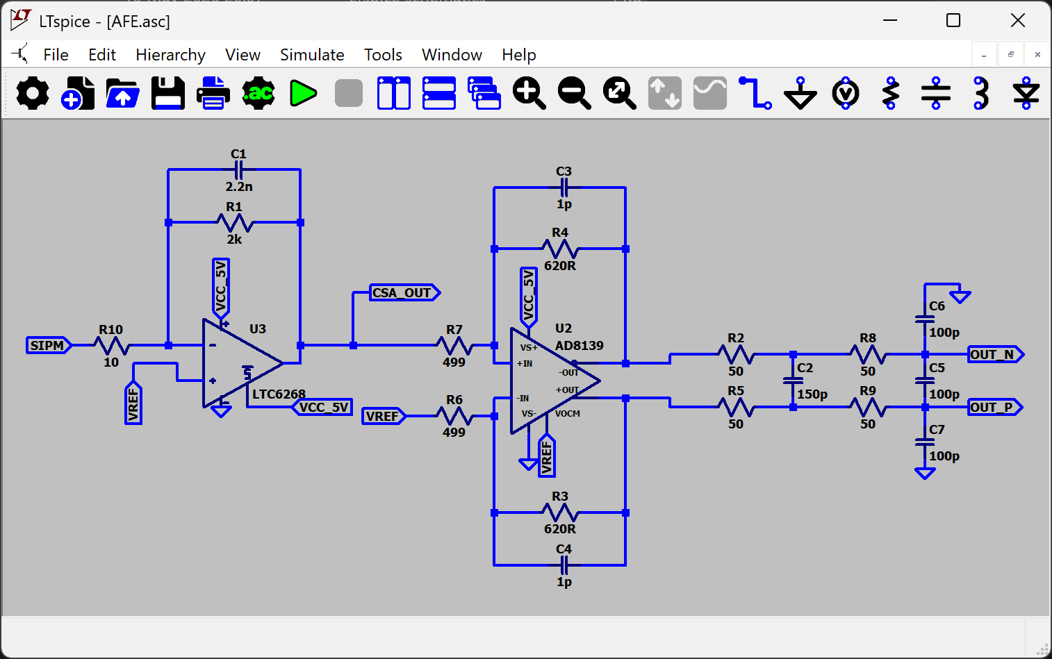

    I'm testing the model of my analog frontend against requirements in LTspice, and in this post, I will share an LTspice hack I came up with for the problems below:
    • There are many configuration analysis models in LTspice that I need. If I kept everything in one file, I would need to comment/uncomment what I need for each simulation. This is annoying.
    • Depending on the tests, I need different models of the SiPM. Again, I could connect/disconnect what I need, but this is annoying and error-prone.
    • If I split these into different LTspice simulations and then change the analog frontend (for example, a resistor value), I need to manually update every single file to keep them coherent.
    The solution is to create a symbol for the part under test (the analog frontend) and reuse it in all my LTspice test benches. Since the symbol lives in two files (.asy and .sub), they just need to be regenerated from the main analog frontend model, and then all test models can use them.
    It looks simple and reasonable, but it didn't work well in LTspice at first..
    I made the tutorial below for myself and others on how to do it
    Step 1: pure model (.asc file)
    We create the model of the component under test (as an .asc file) without:
    • Any power sources
    • Any sensors
    • Any LTspice directives
    Just a pure circuit with no external components.
    Add labels to its inputs, outputs, and power nodes (GND doesn't need one). Anything that needs to be connected in the test bench models must be labeled; otherwise, those nets won't be visible in the subcircuit.

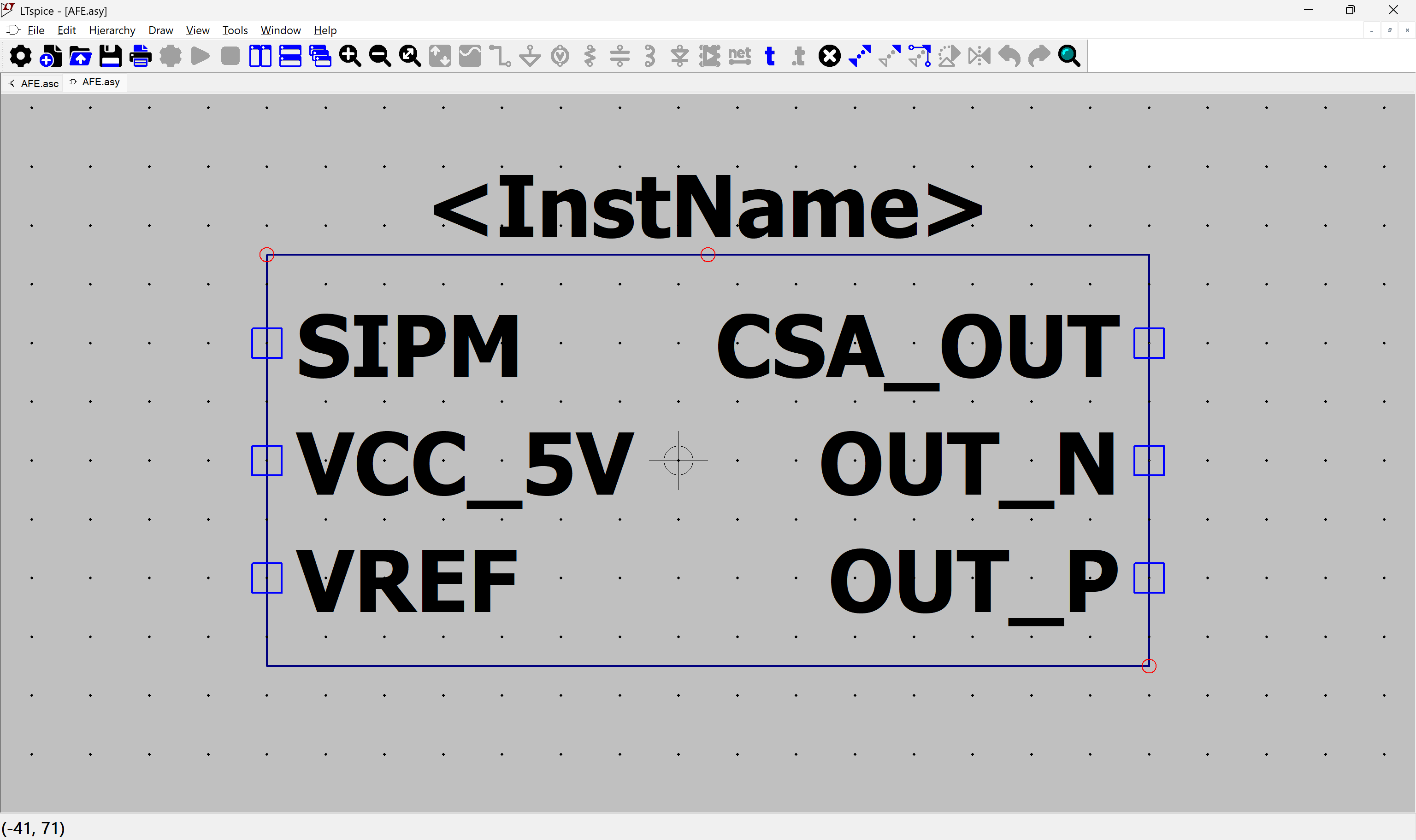

    Step 2: symbol of the model (.asy file)
    Now we create the .asy file (representing how the component looks on the schematic and defining its pin names and numbers):
    Click "Hierarchy" -> "Create a New Symbol from this Schematic", and click Yes.
    Now we have our symbol. Note that it is filled with a background color (grey).

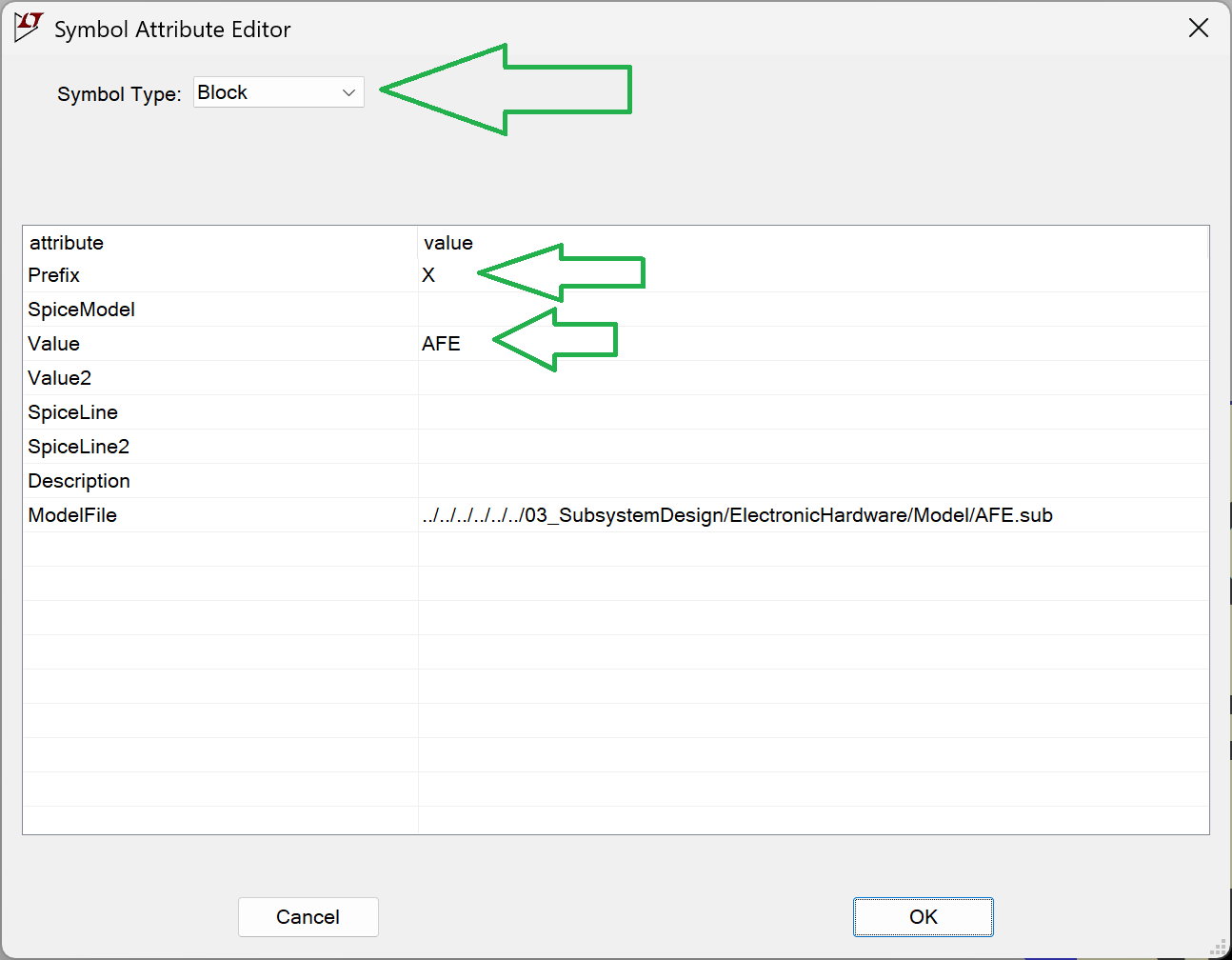

    Go to "Attributes" -> "Edit Attributes".
    The Prefix must be "X". This is important because it tells LTspice to treat the component as a subcircuit (otherwise, it won't work).
    .asy file of the tested model should be in the same folder as its .asc file.

    The SiPM sensor I originally planned to use (MICROFC-60035-SMT-TR1) has 3.4nF internal capacitance, which is huge. Normally, to compensate for this in a transimpedance amplifier (TIA), a capacitor is connected between the inverting input and the output. Since the capacitance is so large, the circuit will effectively behave more like a charge amplifier rather than a true transimpedance amplifier.
    I think this may be a problem because a charge amplifier, by its nature, integrates the input signal. If we simplify the math: integrals are slow, derivatives are fast. There are gamma spectrometers with charge amplifier as first stage so the design is not wrong however. The pulses will be slower and wider, so the device will have lower time resolution. In that case, using a fast ADC and FPGA might be overkill, also fast ADC are expensive.
    My idea is to switch from the AD9226 (65 MSPS, single channel) to the AD9238 (pin-compatible variants: 20/40/65 MSPS, dual channel). I plan to use the 40 MSPS version for now and switch to a higher sampling rate later if needed. This already saves roughly 20 euros.
    Since the ADC has two channels, I could use two smaller SiPMs (3×3 mm) with two analog front-ends. Two channels require twice as many op-amps, so the savings form choosing different ADC are eaten, but I still think this is a better solution because:
    • The sensor capacitance is roughly x5 lower.
    • Having two channels gives the opportunity to perform some digital processing in the FPGA (I don’t have idea about digital processing yet, but I will look into it later).
    The downside is that the total sensor area will be twice smaller: 6x6 mm vs. two 3x3 mm sensors.
    In the image below, you can see how one channel currently looks. It includes a TIA and a differential amplifier. Due to the ADC change, the element values will change, but the general idea will remain the same I think.
