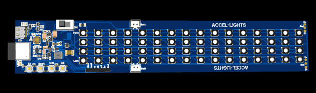

I was always somewhat disappointed with the commercial inline skate wheels, with built in LEDs that light up dimly as you roll around, due to practical constraints. So I figured I this was a fun personal problem to tackle as a project. Which then turned into a fun excuse to learn EasyEDA, then test JLCPCBs board assembly services for a prototype.
I thought about the project, then came away with a list of initial requirements I wanted to incorporate into the design. First, I wanted to integrate the lights to the skate frames and keep the profile low. I also wanted to add a built in rechargeable battery. I purchased some frames that had a flat profile so I could mount the the prototype board and LED strips. I then measured the width of the skate frames and put some thought into the layout to make the prototype mountable to either side with thermal adhesive tape. I also planned to add a 3D printed translucent outer shell to act as a light diffuser and environmental protection (dust, debris, water, etc.). I added an On/Off switch to save power. I added some push buttons so I could make changes to the patterns without needing to take out my phone.
I later decided that the light patterns should react to my movements using an accelerometer. Each stride should trigger a pattern. I hope to trigger different patterns for skating styles (dancing, wizard, slalom). Using the various changes in directional acceleration as input will take some fine tuning.

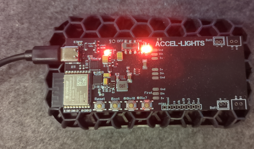

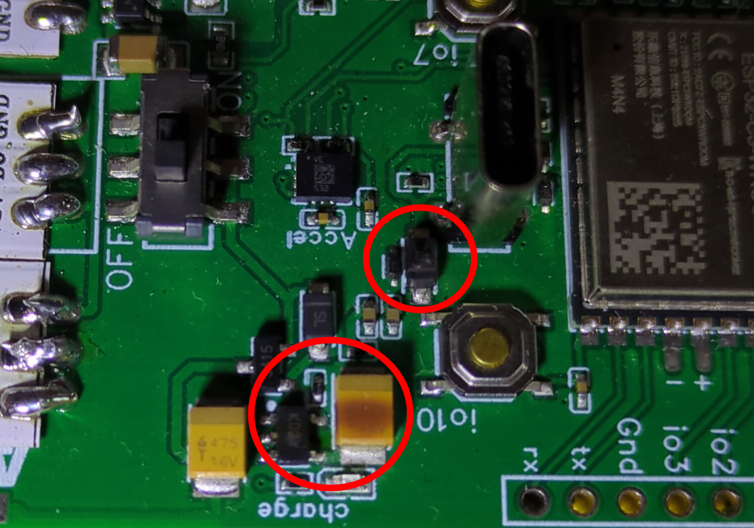

  • USB PD and Magic Smoke released
    M • 07/18/2026 at 23:15 • 0 comments
    Took a bit of a break on this project to catch up on some other neglected tasks. I'm back to making some changes because I managed to release the magic smoke on one of the prototypes when I borrowed a friends USB PD3.0 power supply to charge it. A few seconds later and there was the familiar smell and eventual smoke coming from the components.
    I managed to burn the MicroChip MCP73831T-2ATI/OT charge controller, a tantalum capacitor and a schottky diode. I had made the assumption that the power supply would safely do its thing and limit itself to 5v. Not entirely sure the exact cause, but I did add 5.1kΩ to the CC pins on the USB type C port, but clearly more power than the passive charge controller could handle was delivered. I'll have to verify the resistors on the working board match what I specified.
    My board is clearly not ready to handle being plugged into the newer power delivery chargers. So I'll have to do some research on what to update for the next revision.

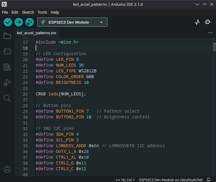

  • coding reactive LED patterns
    M • 05/05/2026 at 01:21 • 0 comments
    I'm at the point where I want to test what kind of patterns could look good on the skates. I have two basic patterns in mind that I've seen used in other projects, that just need to be adapted for a smaller LED array and to favor the Y axis to detect forward and reverse acceleration.
    I was initially going to hunt around for existing code in github repos to understand how they accomplished it, but decided to try to describe what I had in mind to a coding agent (OpenCode + GTP5.1 Codex). I first described the array and how the LEDs were numbered. I then described how to use thresholds of acceleration for the patterns. Then I did my best to described the patterns I had seen in the past. Surprisingly the agent was able to update my arduino test code which had all the pin assignments already defined. The output passed the build process. I loaded the code onto the first prototype with anticipation...
    It worked first try! I rolled the frame forward and backwards across my desk and the first pattern looked like what i expected. I then pressed one of the button to change to the second patter. Repeated the movement and while not exactly what wanted, it was pretty close.
    I know putting this code together would have taken me days, if not weeks with my meager embedded coding skills. Getting this project to a functional state just got a lot easier. I'm looking forward to exploring new possibilities with the help of an LLM.

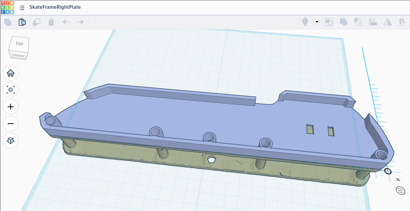

  • Modeling a Faceplate
    M • 05/02/2026 at 06:41 • 0 comments
    I took a shot at quickly modeling a faceplate using TinkerCAD using the 3D scan as a reference. I hadn't used it for some time, so I was pleasantly surprised to find that they incorporated a new sketch tool. This allowed me to roughly outline the side of the frame and extrude it. I added some holes and gaps to account for the switch and usb port. I now had a basic face plate to print.
    The library didn't have any slots, so I'll probably split this model in two parts so I can print it on my 3D printer. I'll post some pictures of the first face plate mounted to the frame. I just plan to use some double sided tape. Eventually I'll make someting that attaches more firmly with clips or something.

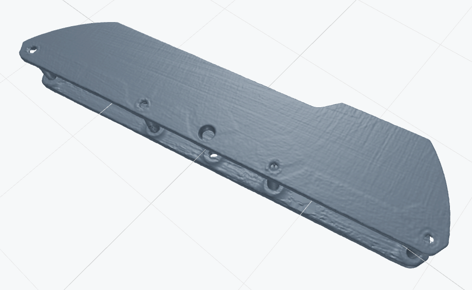

  • Frame Scan
    M • 04/30/2026 at 20:27 • 0 comments
    I am planning to add an external face plate to the skate frames. It would attach to the outside of the frame and be removable. Its primary purpose is be a light diffuser for the RGB LEDs, but also protect the electronics from dirt and debris. My tolerances on the initial working prototype will be kind of loose, as I really just want to get out and skate with them to see how they'll hold up to some mild abuse.
    I was initially going to take some photos from above, adjust for lens skew, and outline the shape in Inkscape. So I could then extrude it in CAD and print a first iteration.
    Fortunately for me, I attended a local 3D print meetup and met someone who was showing off his 3D printed scanning table that he was using with his Creality RaptorX scanner. I hadn't considered 3D scanning, since my past experiences with scan quality were poor. I thought the reflective metal surface and anodization on the aluminum skate frames would be too much of challenge. But apparently these newer scanners are much better, as the scan quality was quite good and dimensionally accurate. It took a little effort to line up the point clouds from two separate scans and remove the noise, but the STL the software output was very good.
    I decimated the model a bit further in MeshLab so I could import it into TinkerCAD that has a file size limit.
    Since the dimensions of the frame are a bit larger than my 3D printers bed, I'm planning to go to my local library to print it. Most of the libraries in my area now have a Bambu Carbon X1 printers, so the print will fit on the large build plate diagonally, allowing me to print it as a single solid piece.

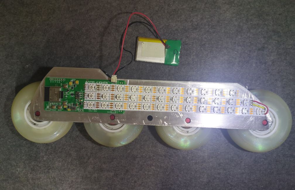

  • Right Frame Assembled for Testing
    M • 04/25/2026 at 05:25 • 0 comments

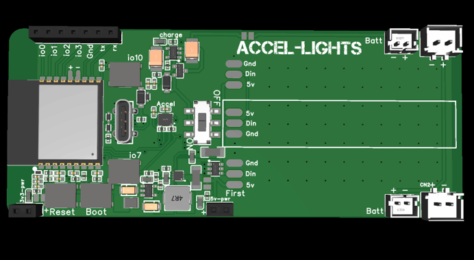

    Here is the board assembled and adhered to the skate frame.The battery pack lives in the gap between most boots mount points. I forgot to add thermal reliefs to the ground pads for the LED strips when I changed the layout of the board. I was also impatient and adhered the PCB to the frame with some thermal tape. So I had a hard time soldering the ground pads... hopefully there aren't any major cold solder joints that will break when I subject this to vibrations on the asphalt.
    Fortunately everything else is still working. It remains low profile. So now I just need to 3D print a translucent cover to act as a light diffuser and dust/debris protection. I'll eventually add a conformal coating, but I expect to need to make changes as I test this.
