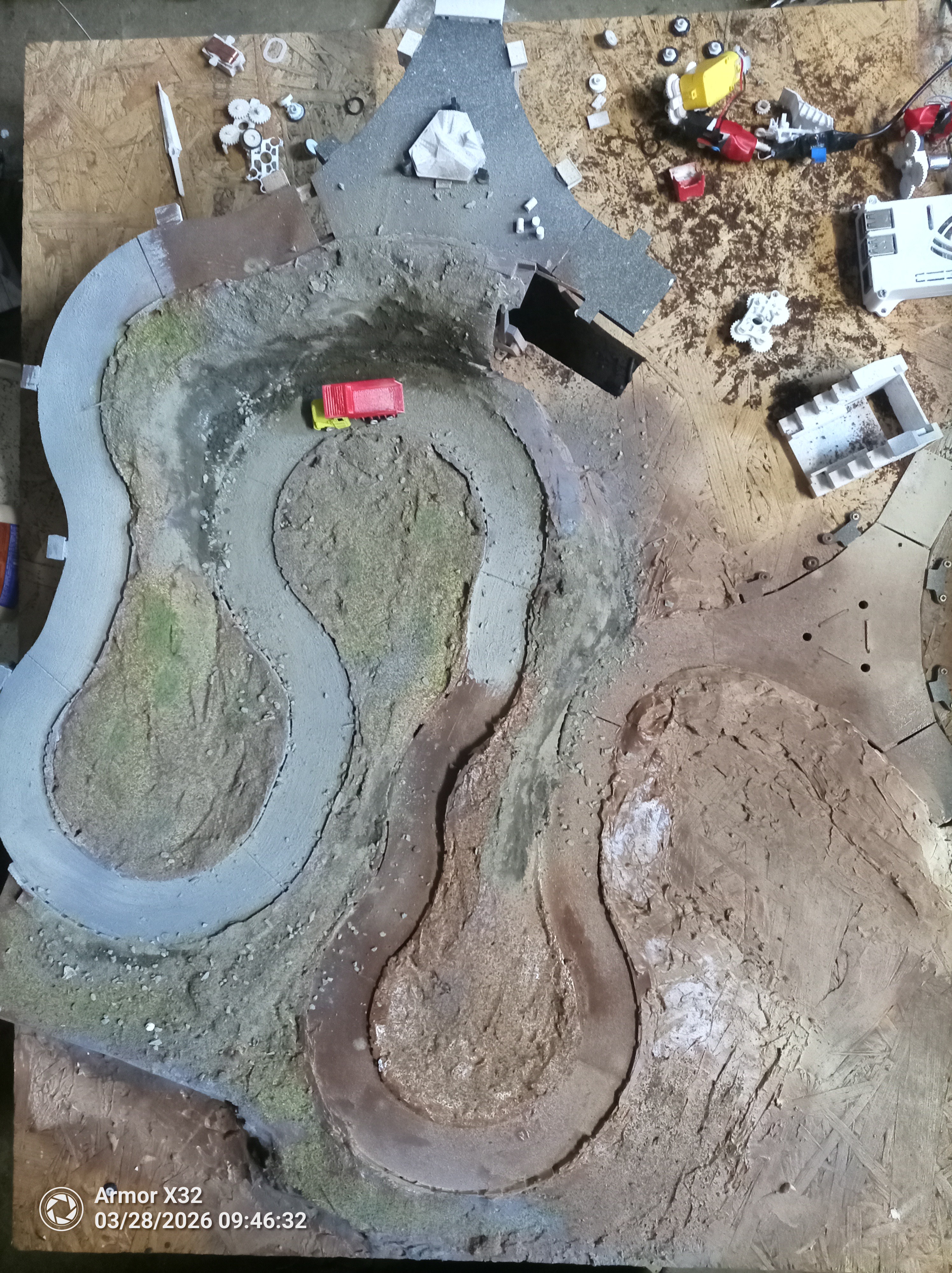

Test Polygon
Quarry — approximately two meters of road, switchbacks, Y junction. Purpose: verification of mechanics, electronics, control software and materials before building the full layout. Terrain is 3D printed.
Current state: manual control via buttons (FWD, BWD, STOP) and potentiometer for speed.
Target: three carriages in fully automatic operation overnight without intervention.

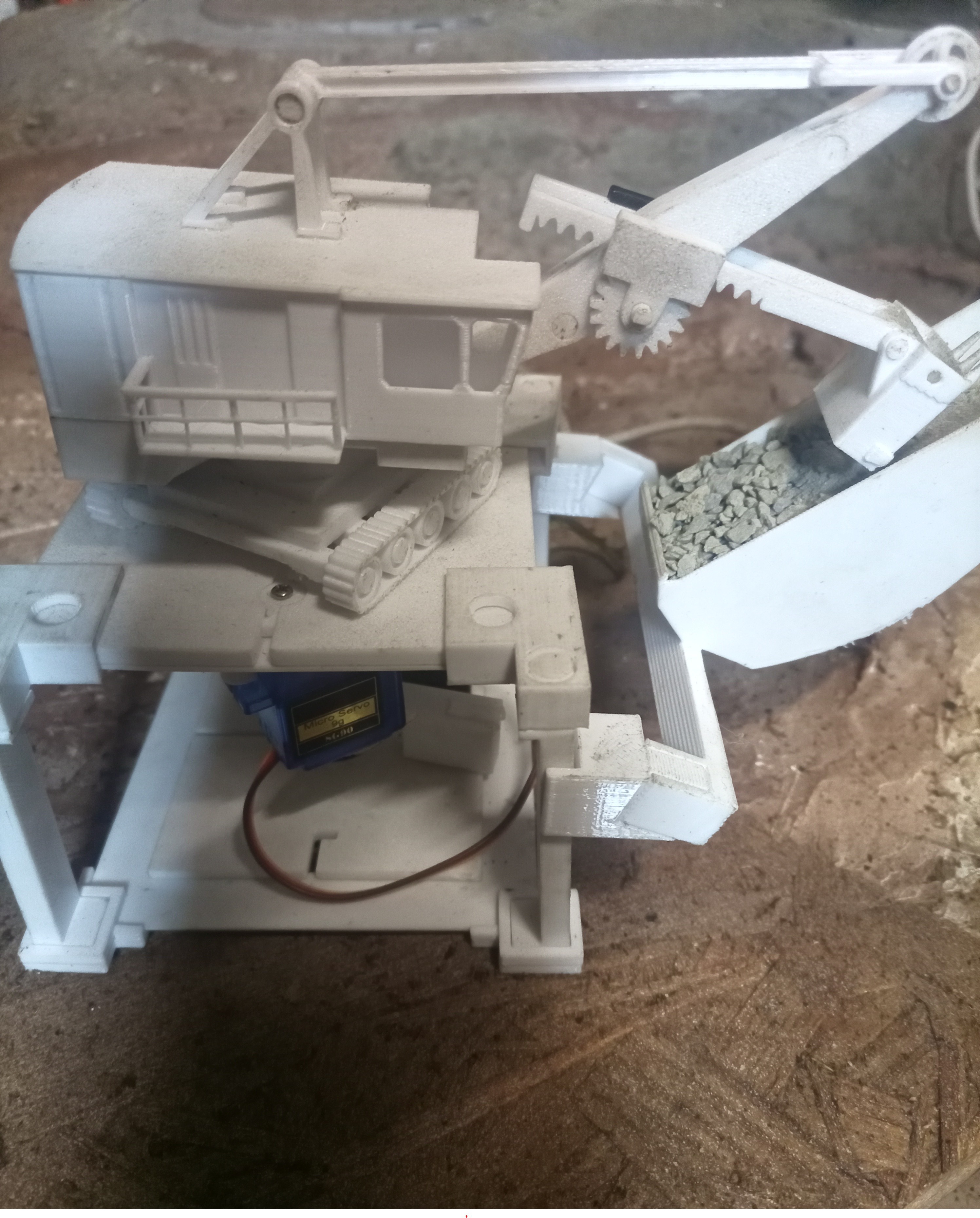

    The excavator can now load real crushed stone, ideally in the 2–4 mm fraction, and this brings me to something I probably have not explained clearly enough yet — the transport system behind the whole project.
    At the beginning, this was supposed to be a much smaller idea: a way to move away from classic DCC-style control and use modern ESP-based control instead. Over time, the project grew far beyond that. The current goal is no longer just “control a vehicle”. It is becoming a complete model transport system for railways, road vehicles, trams, buses and industrial transport sets.
    The first full test scenario is a quarry.
    In this quarry setup, real material is loaded by an excavator. The cable shovel is now working in a simplified form, while a diesel-hydraulic excavator is still under development. After loading, the material is transported to a dump point, where the amount can be weighed. From there, the material can either be exported further or, in the test quarry version, returned back under the excavators as a closed physical cycle.

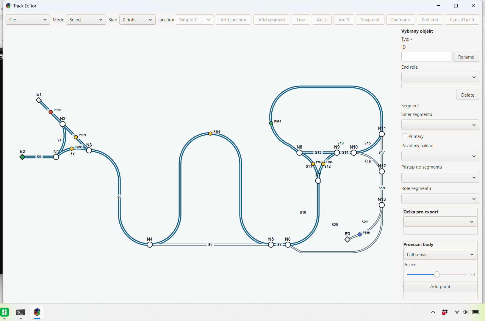

    Track Editor
    The Track Editor is a custom program for designing the track. It is not just a drawing tool, but a generator for both the physical and logical form of the system.
    The editor works with track pieces from which the final route is assembled. Each segment can contain geometry, direction rules, traffic rules, allowed load state, and connections to other parts of the track. The track is therefore both a physical object and a graph for the control software.
    Unlike normal layout drawing, it is not enough to simply connect lines. In this system, every part also has a mechanical meaning. A vehicle cannot magically turn around in place, a long vehicle may not be able to pass through every junction, and some sections may only be allowed for empty or loaded vehicles.
    For that reason, the editor does not only describe the visual shape of the route, but also the rules that will later be used by the control applications.
    STL generation
    STL generation already works in the editor. The program can create physical 3D-printable parts from the designed route.
    This is one of the most important parts of the whole project. The track is not created by manually drawing every part separately, but as an output from the editor. The same design is therefore used both for printing and for traffic control.
    The editor can work with physical segments, split them into printable parts, and prepare STL files. This makes it possible to design a route, generate the parts, print them, and use the same data in the Control Monitor.
    This approach greatly reduces manual work and, more importantly, reduces the risk that the physical and software versions of the track will start to drift apart.

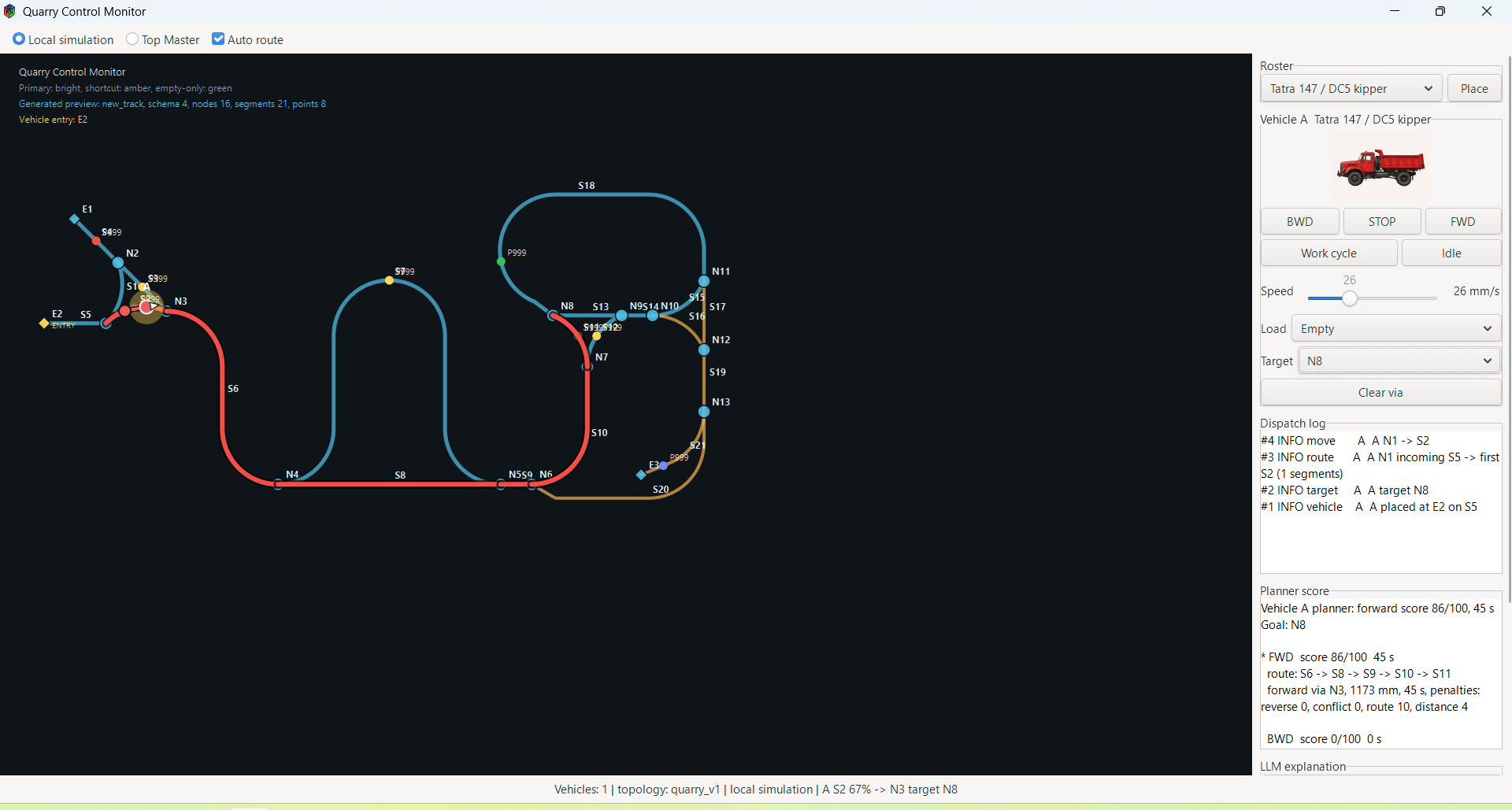

    Control Monitor
    The Control Monitor is the second part of the system. It is a separate C/GTK application that loads the data generated by the editor and uses it for simulation, visualization, and debugging of traffic.
    The editor creates the track.
    The Control Monitor operates it.
    The monitor can display the track topology, vehicles, planned routes, occupied and reserved segments, the dispatch log, planner score, and other information. It can simulate vehicle movement without real hardware and verify whether the route logic matches what was designed in the editor.

    I've added a PC application to the system, written in C (GTK3 + Cairo, compiled in MSYS2 for Windows). The goal was to get realtime visualization of the vehicle position on the track, without depending on any proprietary tool.
    What the application does:
    It renders the quarry track from 200 control points, which are refined at runtime into 800 interpolated points for a smoother curve. The vehicle is displayed as an arrow with smooth rotation based on the tangent to the track. The arrow color indicates the mode — blue for manual control, cyan for automatic, orange during safety stop, red in the local simulator.
    Communication with the top master (ESP32) runs over HTTP — the ESP provides a /data endpoint with JSON payload (position, speed, direction, hall states, safety stop). The application fetches data in a separate thread via libcurl with a 2s timeout, so the GUI doesn't freeze when the ESP doesn't respond.
    Hall sensors and track behavior:
    There are five hall sensors placed along the track, between the end points and the middle. Both the application and the low master evaluate hall state themselves — meaning they detect changes in the magnetic field, not its absolute level. This matters because each hall has a slightly different polarity depending on how it was mounted. Instead of looking for a common level, the system simply watches for transitions. On top of that there's debouncing in a time window, so short transient spikes are ignored and only a stable change is propagated to the system.
    Basic vehicle behavior is built on top of the hall sensors. When the vehicle reaches one of the end halls, safety stop kicks in — the vehicle halts and the system waits for user intervention. When the user presses a direction button after 5 seconds, safety stop is released.
    Local simulator:
    The biggest added value is the local mode. Flipping a switch disconnects the application from the ESP and the vehicle is controlled by FWD/BWD/STOP buttons plus a throttle slider. This let me tune the visualization, end-of-track detection, arrow rotation and overall UX without having to wire up the ESP and run the hardware. Nice side effect — when the ESP is running and WiFi drops, the application doesn't crash and keeps the last known state, or you can switch to manual testing.
    End-of-track rotation:
    I was solving a topological issue — the track is visually a one-way line, but physically the vehicle reverses. Instead of the arrow just flipping back and forth along the same line (nonsense), I implemented a state machine: the vehicle reaches the end, stops for 2s, then smoothly rotates 180° over 3s, and waits for another user input. This way the visualization behaves the way an observer intuitively expects.

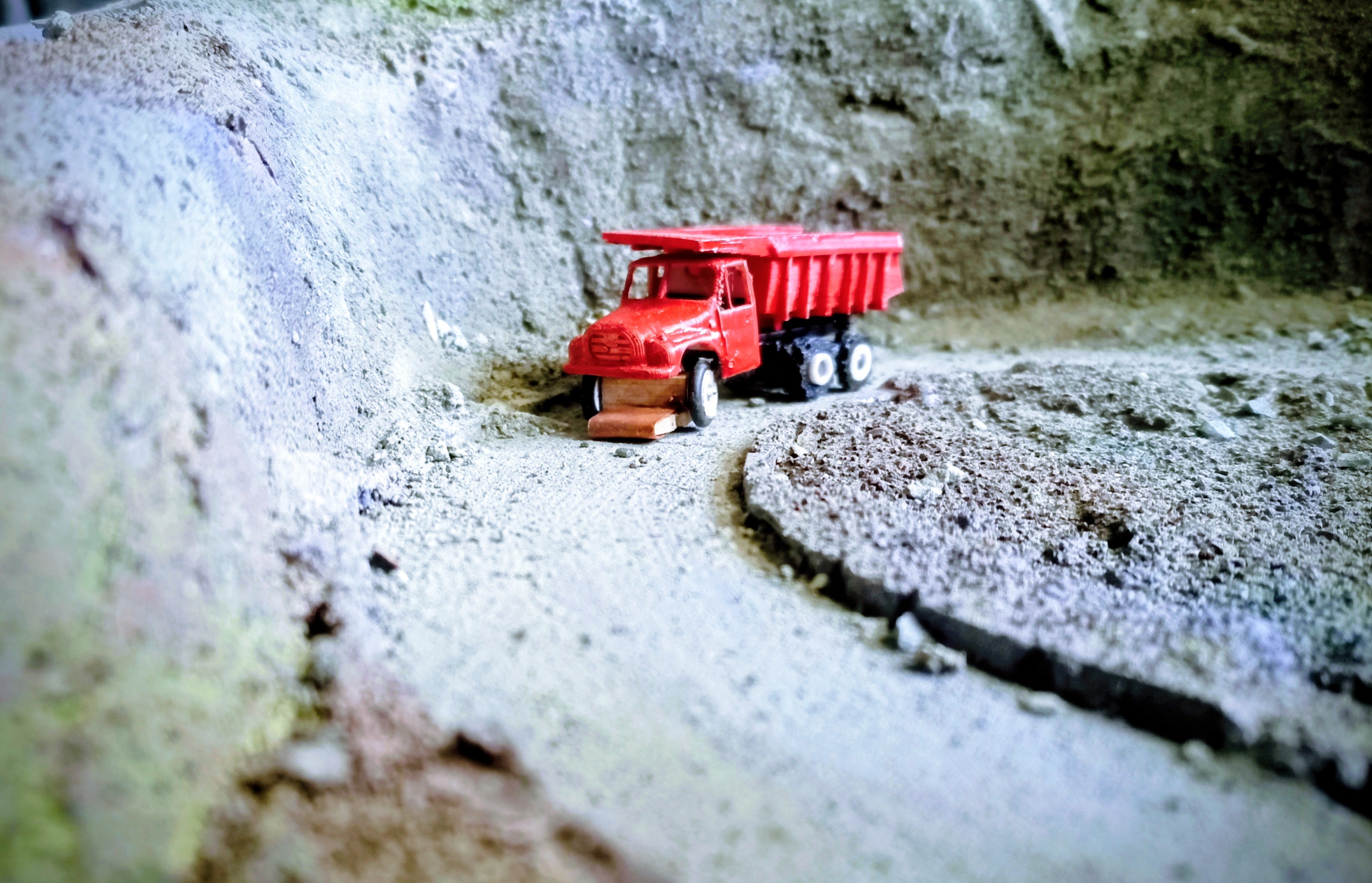

  • Karosa ŠM11 test
    Olda04/07/2026 at 15:54 0 comments
    First test drive — bus on magnetic track
    Test drive of a bus on the magnetic track in the quarry test polygon. The purpose was to verify curve clearance with an extended chassis. This is the first long chassis on this track, so the key question was whether it would fit through the switchbacks at all. Manual control.
    The bus has an issue with the front axle lifting the chassis in curves — currently unsolved due to the constraints of TT scale, but it´s in progress :)
