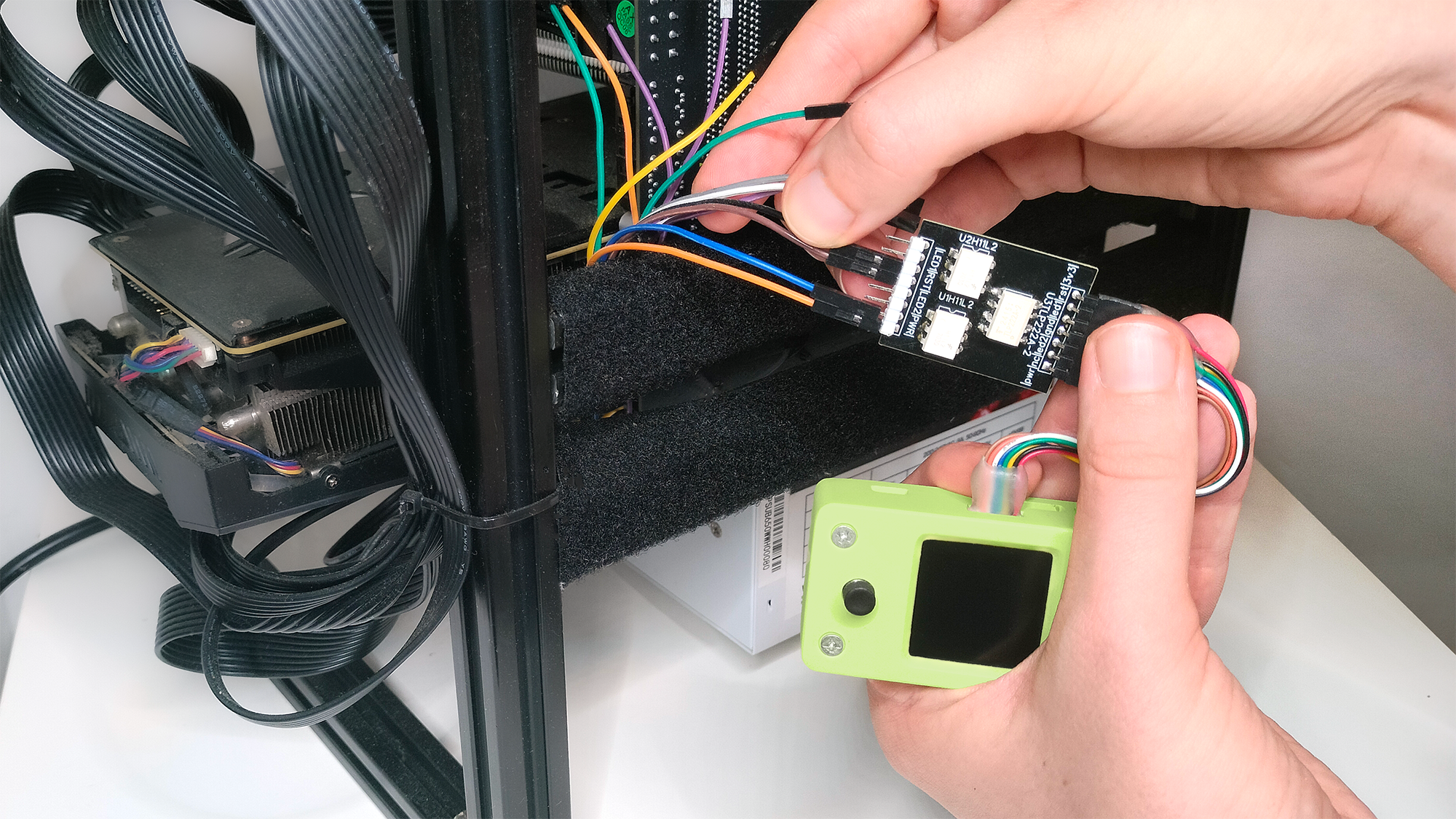

Hardware Power Management Module
Proper bare-metal administration is impossible without independent power control that works regardless of the host's state. That is why I designed a dedicated expansion module for direct management at the physical level.
The module gives me absolute control over the machine:
  • Hardware Power & Reset: The module connects (via an 8-pin GPIO header) directly to the front-panel jumper connections of the motherboard. This allows me to perform graceful shutdowns, hard resets, or cold boots bypassing the operating system entirely. This is...

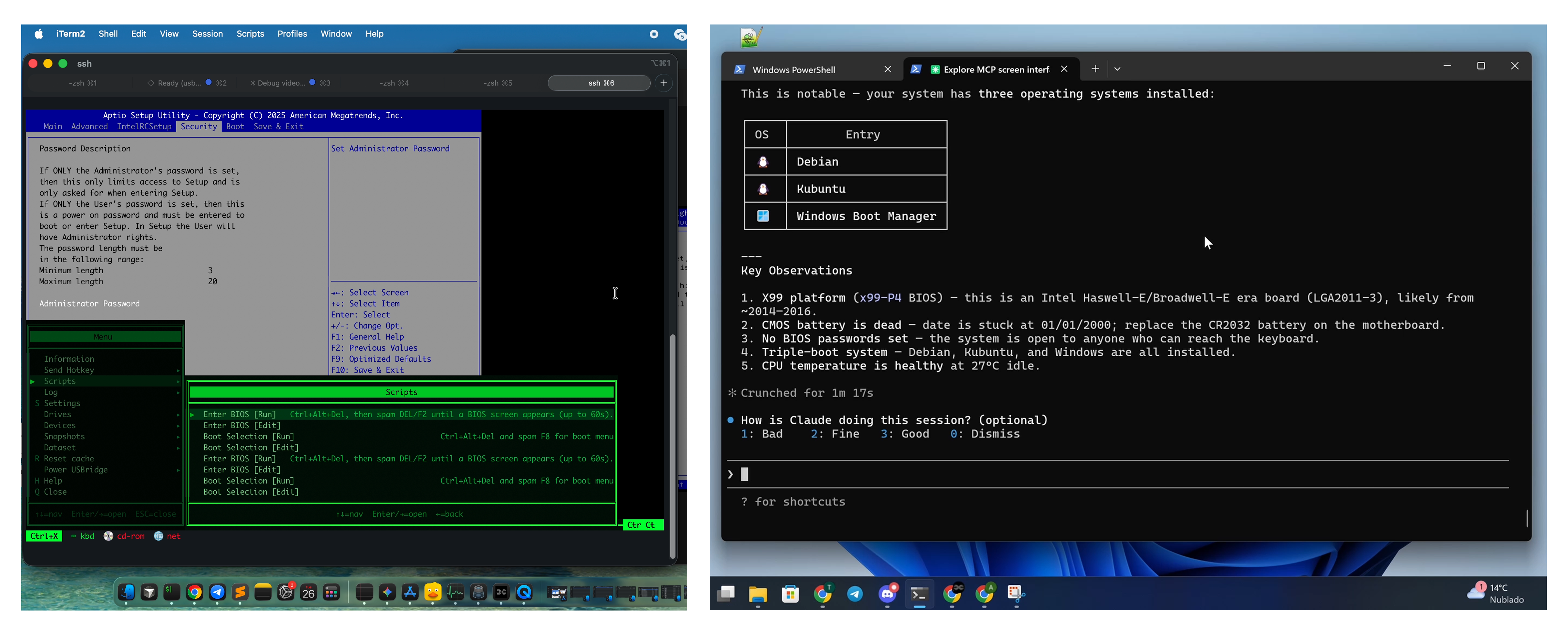

  • Feeding Text-Mode BIOS into Claude AI via SSH (Automation & Analytics)
    Amir05/17/2026 at 11:02 0 comments
    We decided to feed the digitized BIOS text directly into the Claude AI system to see how well the LLM model can analyze hardware configurations, detect anomalies, and assist with troubleshooting.
    The Setup & Workflow:
    • Host Connection: The USBridge captures the video output from the target machine (even during early boot/BIOS stage).
    • On-Device OCR: The KVM processes the video frames and converts the BIOS interface into a lightweight text stream.
    • SSH Streaming: The text is rendered inside a standard terminal window over SSH.
    • AI Integration: The digitized BIOS output is passed to Claude. As you can see in the video, the LLM perfectly parses the text layout, identifies the menu structure, and can provide real-time recommendations or even generate configuration scripts based on the active screen.
    Traditional IP-KVMs just send heavy, compressed video pixels. You can't grep a pixel, and you certainly can't easily feed a video stream of a BIOS error into an automation script. By converting the BIOS into text, USBridge makes the lowest level of PC architecture completely machine-readable. Imagine automated OS provisioning that can read BIOS errors, or AI co-pilots that can configure your motherboard settings remotely when a server crashes.
    Check out the video demo below to see Claude in action analyzing the KVM text stream!
