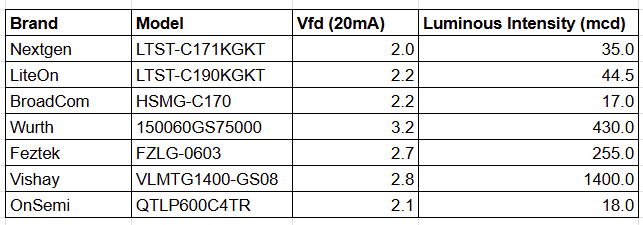

Here is a comparison for forward voltage and luminosity (mcd) at 20mA for an 0603 green LED that might be used for indicators, note the variance in forward voltage and the amount of light produced.  There are also variations between different components from the same manufacturer!  So picking 10mA isn't always a good option for designing indicators.

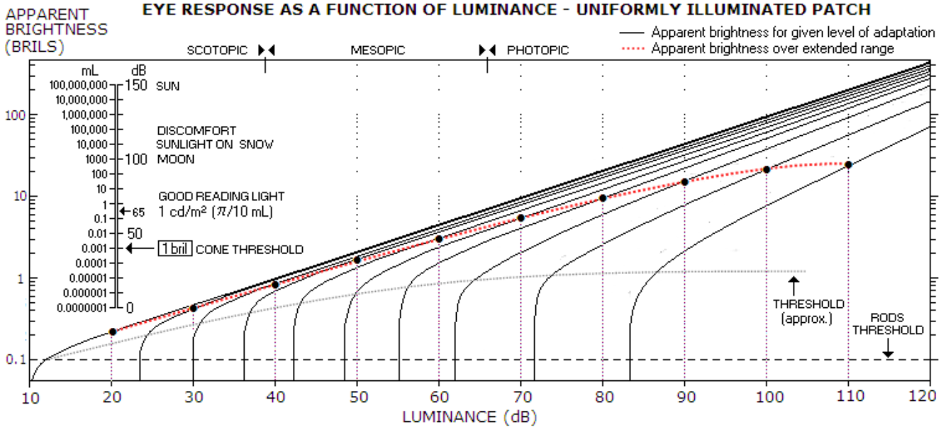

Our eyes have a logarithmic response to light.
Source: https://www.telescope-optics.net/eye_intensity_response.htm

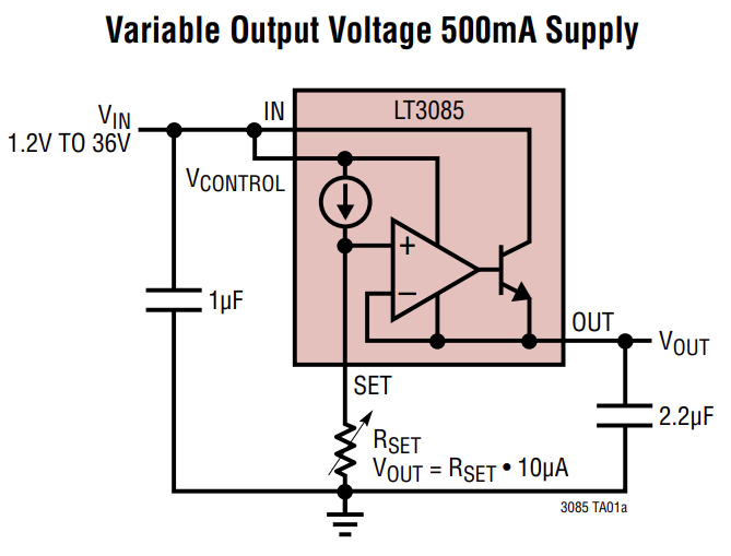

The original circuit was designed built around the Analog Devices LT3085 (diagram below) to provide the constant current dimming circuit.  It worked well but was expensive and since it's integrated, limited to what can be done with it.
So I designed my own constant current dimming circuit.

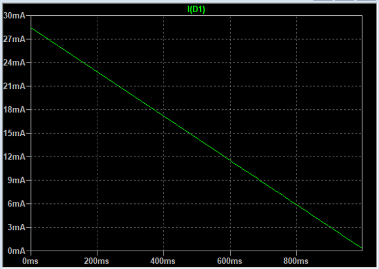

The curve is linear for the entire throw of the dimming potentiometer.
To simulate the changing resistance in LTSpice.  Place a formula like this in the RESISTANCE field:    R=100k-(100k*time)

Ken Yap wrote 05/03/2026 at 21:01 • point
It's interesting that you picked the green LEDs for your example. You'll find that you actually have two types of green LEDs in your table. The Wurth, Feztek and Vishay green LEDs have a different material which is more efficient and the forward voltage is around 3V compared to the 2+V of the others. They cost more and the colour is usually described as emerald.
Charlie Kim wrote 05/05/2026 at 13:53 • point
That's a great point! You run into the same issues with other colors.  I'm not a semiconductor designer, GaAsP RED LEDs have different qualities than GaAlAs RED LEDs.  Usually we just filter by red LED and read datasheets when we look for one.  Where this device comes in handy is to just for setting luminosity for LEDs (brightness or power conservation).
