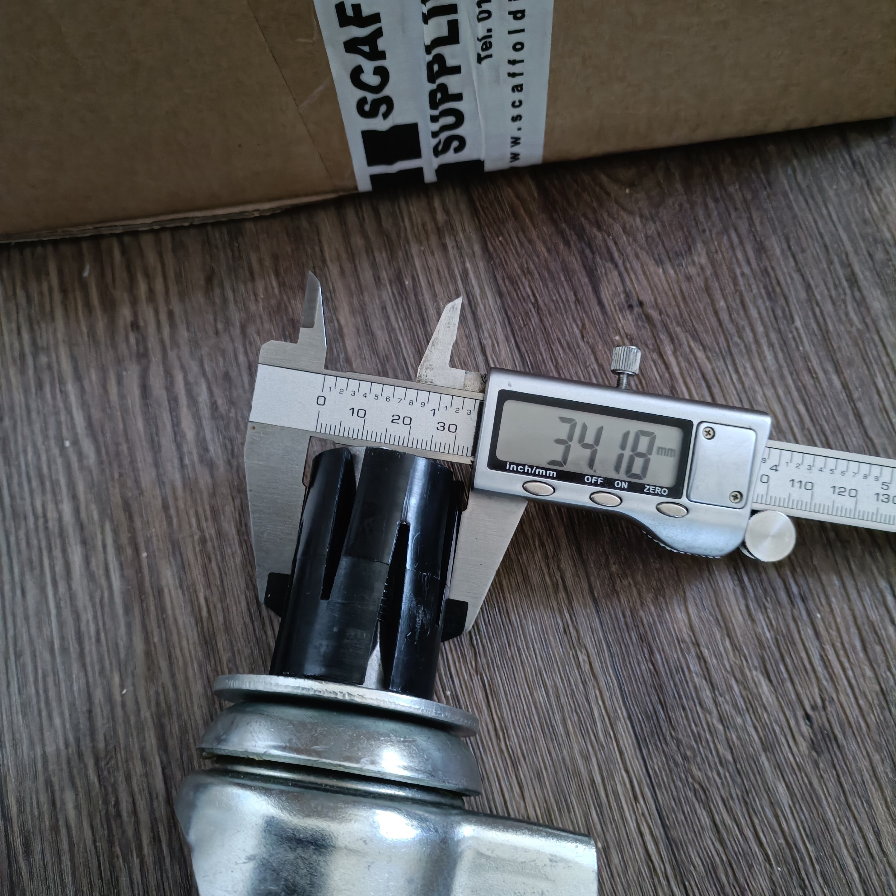

    The first thing that arrived were the 100mm wheels, which curiously seemed to have an expander that ranged from 30.7mm to 35.0mm before the expander itself hit the large washer. The test tubing I still had from SecSavr Sublime [gd0036] was a 36.2mm inner diameter. This expander couldn't be for 33mm tubing as the internal diameter of those should be around 27mm.
    I called Scaffolding Supplies and we organised a video call and everything was as expected after some troubleshooting, using an 8mm allen key to tighten the fitting, but it's not ideal as only the top of the expander continues to expand past 35mm. Thus, I plan to get a thick washer (or stack a bunch of normal ones) and put it between the large washer and that little grey wedge part you should be able to see peeking through the black expander.

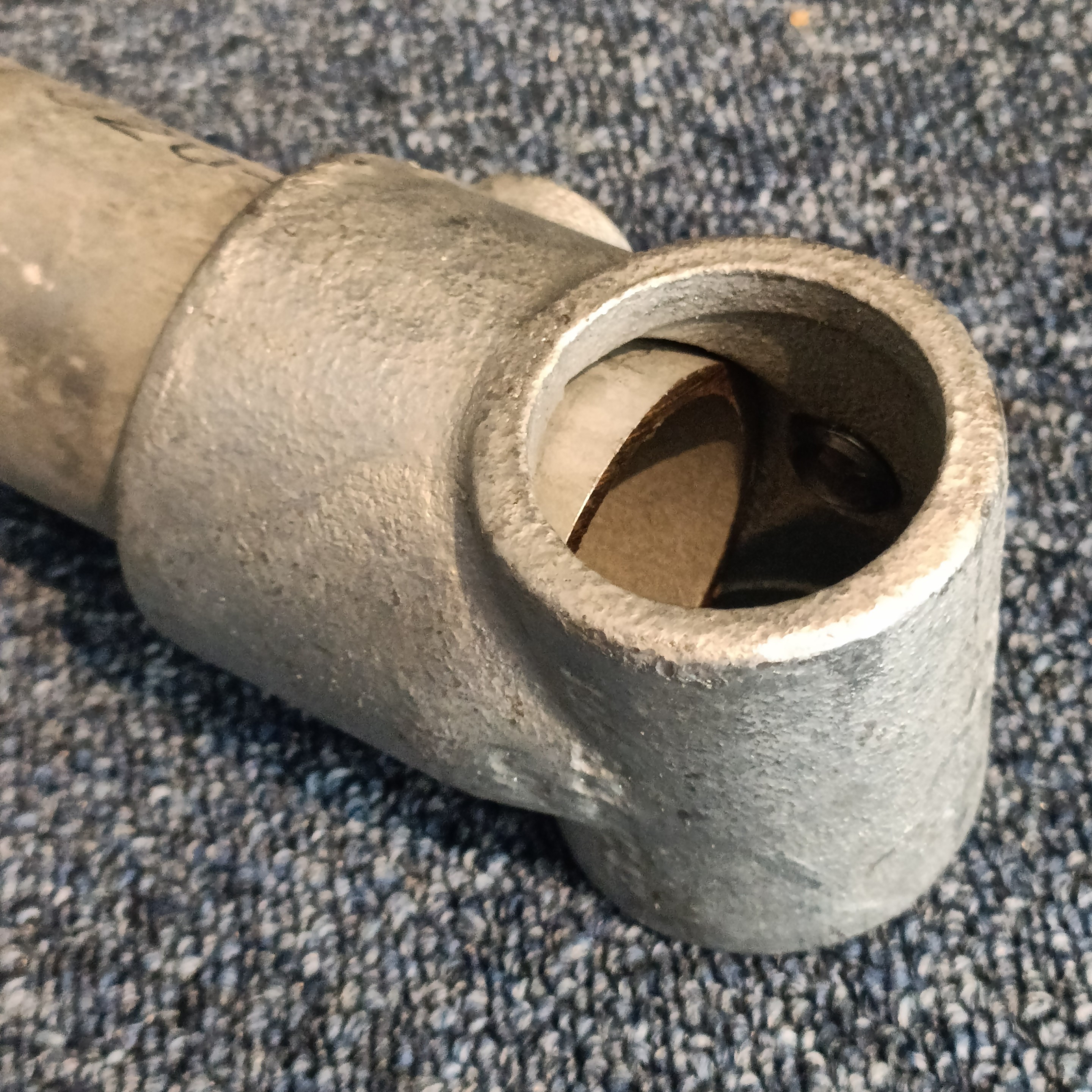

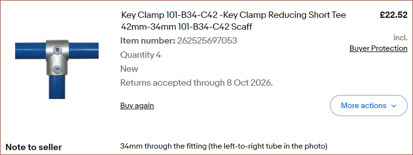

    The next part is the reducing tee that I found cheaper on ebay. I asked which type of reducing tee they sold and they replied that they can do both and I just need to message them about it, so I did that and wrote a note when in the checkout.

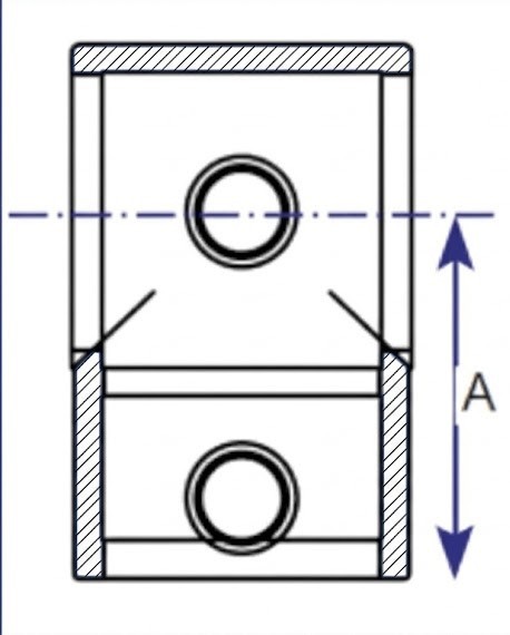

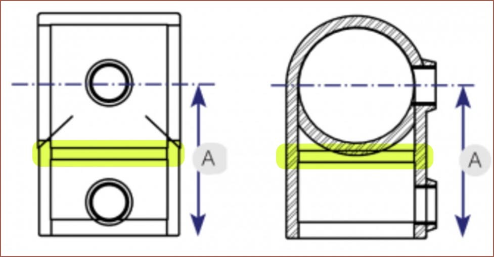

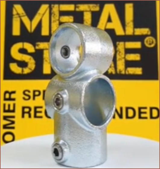

    Other than saving money, the reason I got them was to find out how far the 42mm tube goes into the fitting. As you can see, the 42mm tube would be stopped by the 34mm tube beforehand.
    I believe it's this diagram of the normal 101 short tee (and similar clamps) because the drawings include the slightly embossed internal rings, but only applied a hash to one of the views (and even then, the U part of the circle wouldn't be hashed if one was to take a cross section). Thus I was thinking that the ring highlighted was a wall that stopped the tube. Below is the hashing I would expect from the left view:

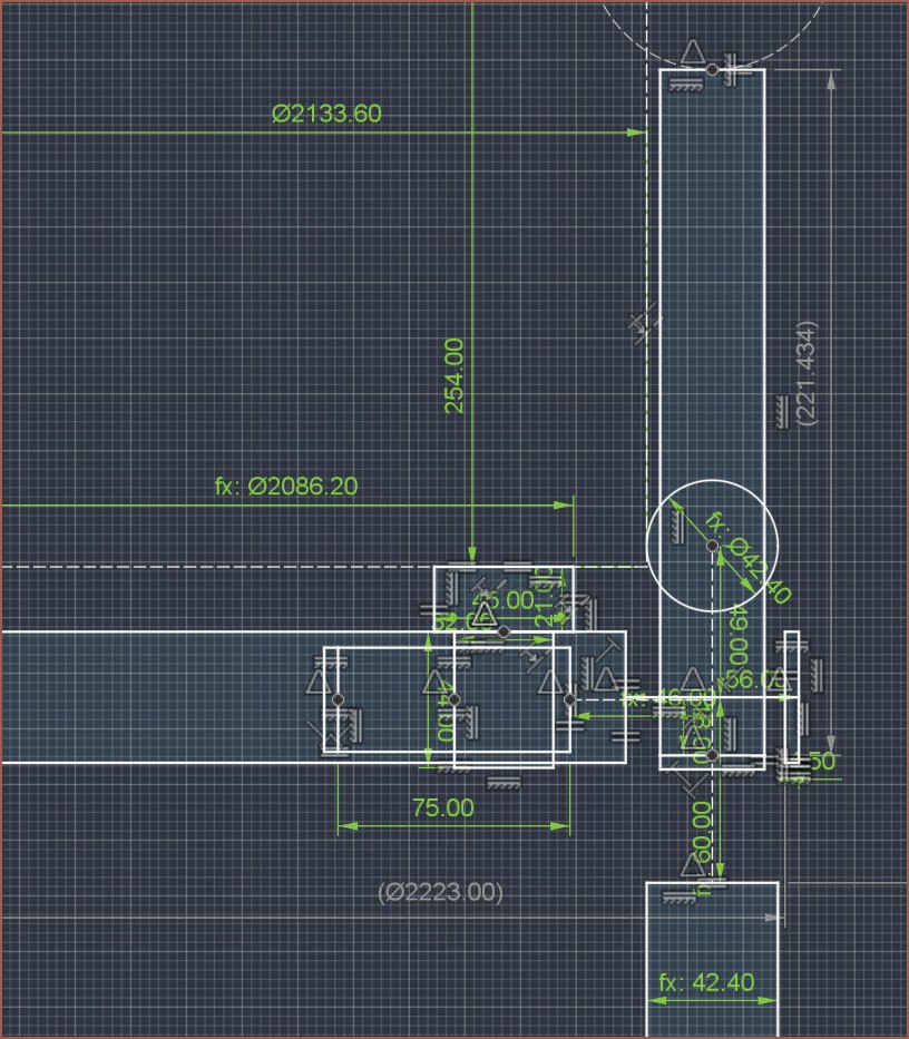

  • [M] Updated Sketch
    kelvinA • 09/12/2026 at 14:51 • 0 comments

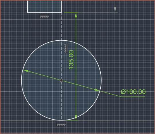

    Most recently, I've added the 100mm wheel to the sketch:
    Before this, I simplified the design by replacing the Three Way Outlet with a Combination Socket:
    This eliminates the need of a 34mm beam on each end of the bed, as well as a few short 42mm tubes.

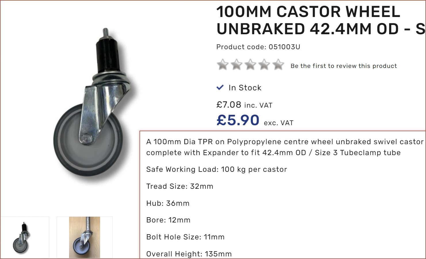

    The whole project kinda got put on ice when I realised that almost all my other furniture has castor wheels, which makes them barely an inconvenience to move. My set of drawers is the only thing that doesn't and even minor adjustments are a struggle. The server cabinets I bought didn't come with them and I very quickly decided to buy and install them, so it's likely in my best interest to integrate them into the bed frame design.
    After quite a bit of searching and comparing websites, this one was the lowest cost for 4 wheels, priced at £40 inclusive of VAT and shipping. Whilst being the cheapest, they also have the highest per-wheel loading capacity of 100kg, where the lowest I've seen are 70kg. I've never applied the brakes on any wheeled furniture so I will just get 4 plain wheels.

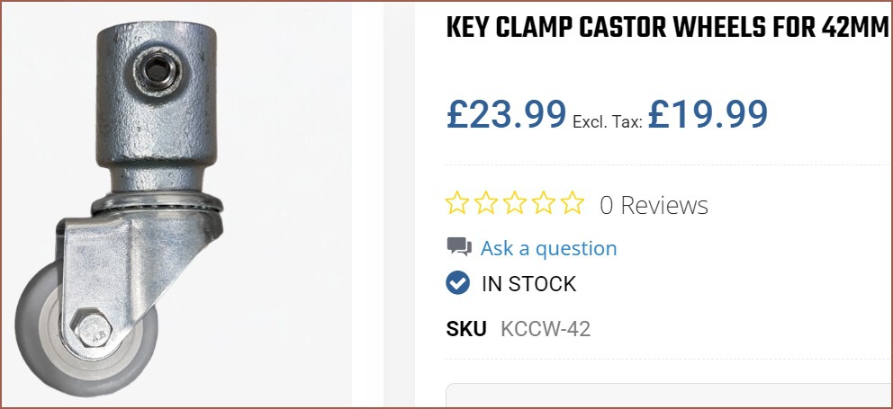

    Notable Mention
    Looking at reviews and the description, this one was designed to simplify the installation down to tightening a single allen key grubscrew, for a convenience fee. Thus I assume that, for the first type, the wheel has to be unscrewed, then the expander has to be screwed into the tube, and finally the wheel rescrewed.

    It took a bit of effort to rework the frame to use a Three Way Outlet instead of a Three Way Through to be able to shave off the 7 cm I needed, in part due to Fusion sketch solving issues I had to track down and resolve. There is a minimum 100mm tube cutting length, so that's why there's a vertical 75mm and horizontal 50mm tube instead of them being shorter.
    The price of the frame increases by around £12, now £549, but the mattress savings can entirely pay for a new monitor and still have hundreds of pounds left over.
