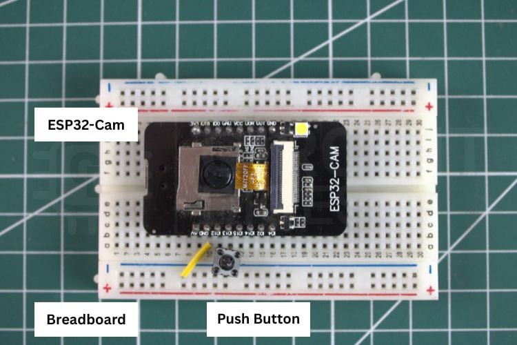

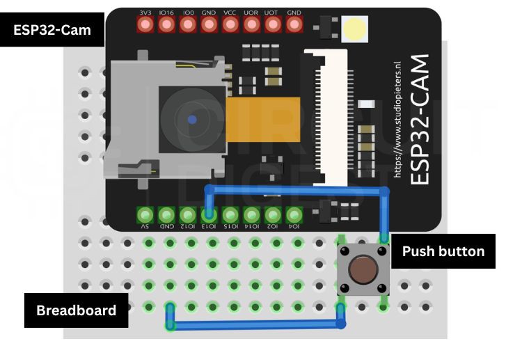

Hardware Used
  • ESP32-CAM module
  • FTDI USB-to-Serial programmer
  • Jumper wires
  • Micro USB cable
  • 5V power supply
  • Breadboard (optional)

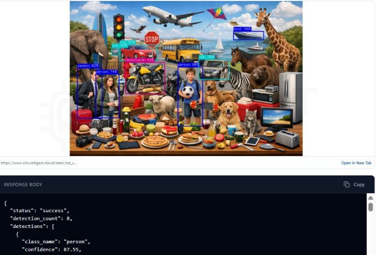

The ESP32-CAM initializes the camera and connects to a Wi-Fi network. Whenever an image is captured, it is compressed and transmitted securely to the cloud inference server.
The cloud service processes the image using an object detection model and returns information such as:
  • Detected object names
  • Confidence scores
  • Bounding box coordinates
The ESP32 receives the response and displays the results through the Serial Monitor. The same information can also be integrated into dashboards, automation systems, or IoT applications.
