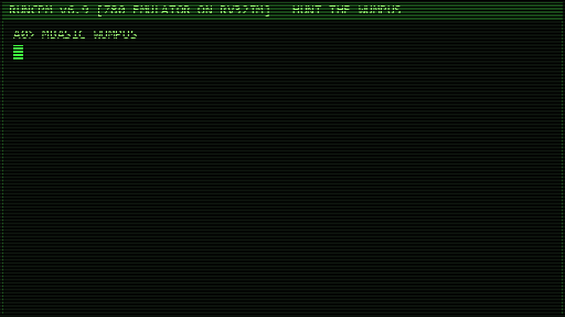

  • RunCPM Prompt Support
    M_Jagadeesh97 • an hour ago • 0 comments
    The RunCPM prompt with DIR, ASM, DDT and MBASIC.

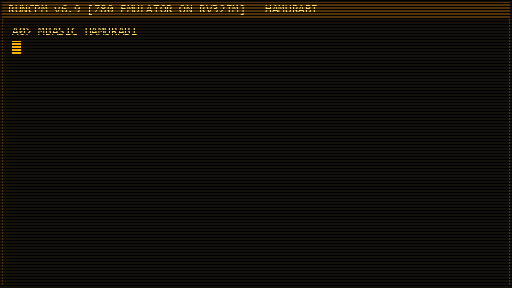

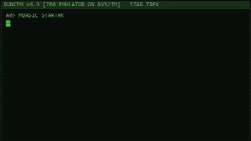

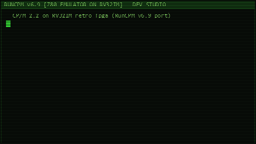

    The console runs original CP/M 2.2 software, including Microsoft BASIC-80, through a port of RunCPM to bare metal. The Z80 decoder supplies the register file, a 64 KB virtual address space, and the zero page vectors at 0x0000 for warm boot and 0x0005 for the BDOS entry.
    Standard RunCPM expects a hosted POSIX filesystem to expose its virtual drives. There is none here, so the disk is packed ahead of time: a script scans a directory, converts filenames into 11-byte CP/M form with 8.3 space padding, and writes the disk blob that goes into the asset container. The BDOS translation layer traps the calls and routes them:
    • Console output, functions 1, 2, 6 and 9, goes to the hardware UART and to a four-line by sixteen-character virtual terminal rendered into the 64x32 framebuffer with a 4x6 bitmap font, which is what makes the phosphor-green screen in the capture above possible on a monochrome display.
    • File access, functions 14, 15, 16, 20 and 21, reads the in-memory RAM disk arena. Writes update it in place, so file changes persist for the session.
    • AUTOEXEC.TXT is synthesized into the RAM disk at boot so the internal CCP can auto-launch a title such as MBASIC STARTRK without a human typing at the prompt.
    One bug is worth recording in full, because its symptom was a hang rather than an error.
    Files larger than 16 KB are split across CP/M extents. The record offset was being computed from the record field alone, so at record 128 the address wrapped back to the start of the file and the read looped forever. The correct linear offset uses both fields:
    offset = ((fcb->ex * 128) + fcb->cr) * 128
    MBASIC.COM is 24 KB, so this hit on the first program that mattered. A naive implementation does not crash; it spins, which costs an afternoon before the penny drops.
    ESC during blocking console input needed its own path for the same reason the launcher did. The character input loop polls the hardware key register every 22 ms and unwinds to the launcher on keycode 27, so a CP/M program that blocks on input can still be exited with one key, and the console does not have to be rebooted to escape a text adventure.
    Speed: at 50 MHz with SDRAM access latencies, the Z80 interpreter runs at roughly a 2 to 4 MHz equivalent, which is the range of the machines that ran this software originally. Star Trek, Hamurabi and Lunar Lander are period-appropriate at that speed rather than merely tolerable.
    Star Trek (1971)
    Hamurabi (1968)
    Hunt the Wumpus
    Porting this was the most retrocomputing part of the project so far: original 8080-era binaries, unmodified, running on a RISC-V core I designed, with the disk image packed at build time and the console rendered into a 64x32 framebuffer.

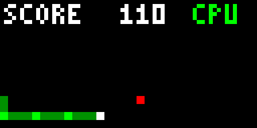

    Both displays live: Snake on the host viewer and on the OLED.
    Viewing games on a laptop screen proved the console worked, but a console needs its own display. The DE0-Nano was expanded with a 0.96-inch 128x64 monochrome I2C OLED on the GPIO header, driven by an RTL master rather than by the CPU, and two bugs followed that are worth writing down in full because each looked like a different problem than it was.
    The wiring is four pins. VCC to JP1 pin 29, ground to pin 12, SCL to GPIO_0[2] which is FPGA pin A3, and SDA to GPIO_0[4] which is FPGA pin B4. Weak pull-ups were enabled on both I2C pins in the Quartus settings file to complement the 4.7 kOhm resistors on the breakout, and the controller drives both lines open drain: it never drives the bus high, only low or high-Z, and lets the pull-ups bring the line up.
    Bug 1: random static across 7 of 8 screen rows.
    The display powered up with turquoise noise and black dots, and once a game started only a narrow 8-pixel band at the top updated. The driver had been written assuming the SSD1306 horizontal addressing mode, where streaming 1,024 continuous data bytes wraps from column 127 of page 0 to column 0 of page 1 and advances through all eight pages.
    The module on the bench was an SH1106 class controller. That part does not implement horizontal addressing or the column and page range commands; it is permanently in page addressing mode. A 1,024-byte burst therefore wrote 128 bytes to page 0, wrapped to the start of page 0 and repeated eight times. Pages 1 through 7 never received anything and stayed in their power-on state, which is why the failure looked like a dead region rather than a protocol mismatch.
    The fix streams page by page. For every frame the state machine iterates all eight pages: set the page address with 0xB0 | page, reset the column with 0x00 and 0x10, then stream 128 data bytes.

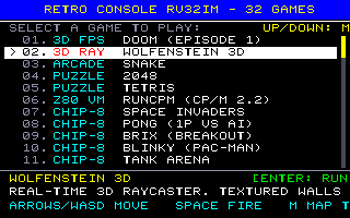

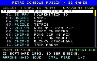

    The launcher: 32 titles, categories, selection cursor.
    The board ran DOOM, and only DOOM. Switching games meant restarting the upload script, transferring the image over serial and waiting, so the machine was a demo rather than a console. This log is what changed, and it is the point where the project becomes a console.
    The catalog is 32 titles in three runtime categories:
    • Native and 3D, 7 titles: DOOM Episode 1, a Wolfenstein-style raycaster, Minesweeper, Flappy Bird, Snake, 2048, Tetris.
    • CP/M 2.2, 6 titles: Star Trek, Ladder, Hamurabi, Lunar Lander, Hunt the Wumpus, and a RunCPM prompt with DIR, ASM, DDT and MBASIC.
    • Chip-8, 19 titles: Space Invaders, Pong, Brix, Tank, Blitz, Missile Defense, UFO, Cave, Lunar Descent, Airplane, Connect 4, Tic-Tac-Toe, 15 Puzzle, Logic Puzzle, Merlin, Hidden Pairs, Blinky, Maze, Wipeoff.
    All of it is one firmware image: 158.6 KB of code plus a 5.11 MB asset blob, uploaded in about 57 seconds. The blob is a single aligned container with a header, a ROM table, the CP/M virtual disk, the DOOM IWAD and the Chip-8 ROMs, built by one script so that adding a game never means hand-editing offsets.
    The first problem was memory. Consolidating several runtimes into one binary created layout conflicts immediately: DOOM assumed the heap could grow above .bss, which overwrote the regions where ROMs and CP/M images lived. The linker script now binds every section to a fixed boundary on the 32 MB SDRAM:
    0x00000000 - 0x00027FFF   158.6 KB  firmware (.text, .rodata, .data, .bss)
    0x00028000 - 0x00C27FFF     12 MB   dynamic heap
    0x00C28000 - 0x00CA7FFF    512 KB   execution stack
    0x00CA8000 - 0x014A7FFF      8 MB   asset window (menu.blob, 5.11 MB used)
    0x014A8000 - 0x01FEFFFF   11.3 MB   unallocated
    0x01FF0000 - 0x01FFFFFF     64 KB   framebuffer SDRAM backing
    and ends with a build-time guard that replaces the 64 MB simulation boundary:
    ASSERT(_wad_end < 0x02000000, "Firmware and assets exceed 32 MB SDRAM window")
    That assert is the direct descendant of the paste-over bug from log 3. A layout mistake now fails the build instead of surfacing as missing assets halfway through an upload.
    The second problem was getting back. Once a game started, the only way to the menu was pressing the board's reset button, which cleared the SDRAM controller and forced a 57-second re-upload before a different game could be played. Bare-metal RISC-V has no process model, so a game loop deep inside its own call stack cannot be unwound with ordinary returns.
    The solution is a freestanding setjmp and longjmp in games/common/crt0.S. The jump buffer is 14 words, 56 bytes: the return address, the stack pointer and the twelve saved registers.
    setjmp:
        sw ra,  0(a0)
        sw sp,  4(a0)
        sw s0,  8(a0)
        sw s11, 52(a0)
        li a0, 0
        ret
    The launcher establishes the jump target before dispatching, so any game can return by calling longjmp with the same buffer:
    g_in_game = 1;
    if (setjmp(menu_jmp_buf) == 0) {
        launch_game(sel);
    g_in_game = 0;
    key_flush();
    draw_menu(sel, top);
    Re-entrancy needed its own pass. Entering DOOM, leaving with ESC and selecting DOOM again crashed with heap corruption, because the zone allocator retained stale allocation pointers from the previous run. Now doom_main resets its zone on every entry, resets static player state, and flushes the key register before drawing the first frame. ESC is disabled inside DOOM's own menu so the key means the same thing across all 32 titles.
    The result is that ESC returns to the launcher from any game in well under a second, with no reset and no re-upload. Combined with the launcher, this is what makes the machine a console rather than a set of demos: switch from DOOM to a CP/M adventure to a Chip-8 game and back, on a device that fits in one hand.
