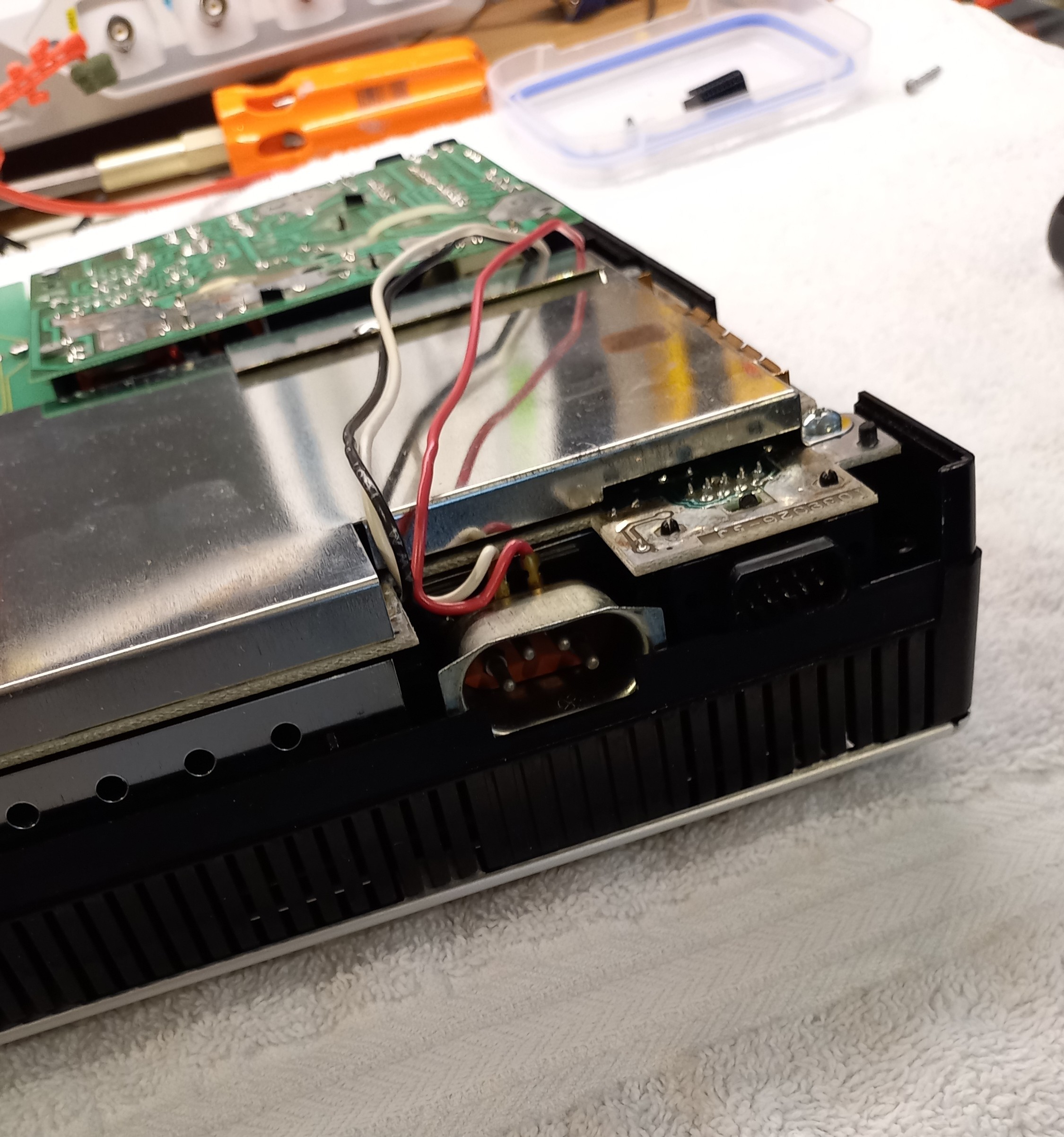

Below is a shot of the internals where AC power comes into the stock machine from the standard brick:
I obviously did not want to reuse that connector, because someone in the future might come along and plug a standard TI brick in there. It would probably not work and/or start a fire.

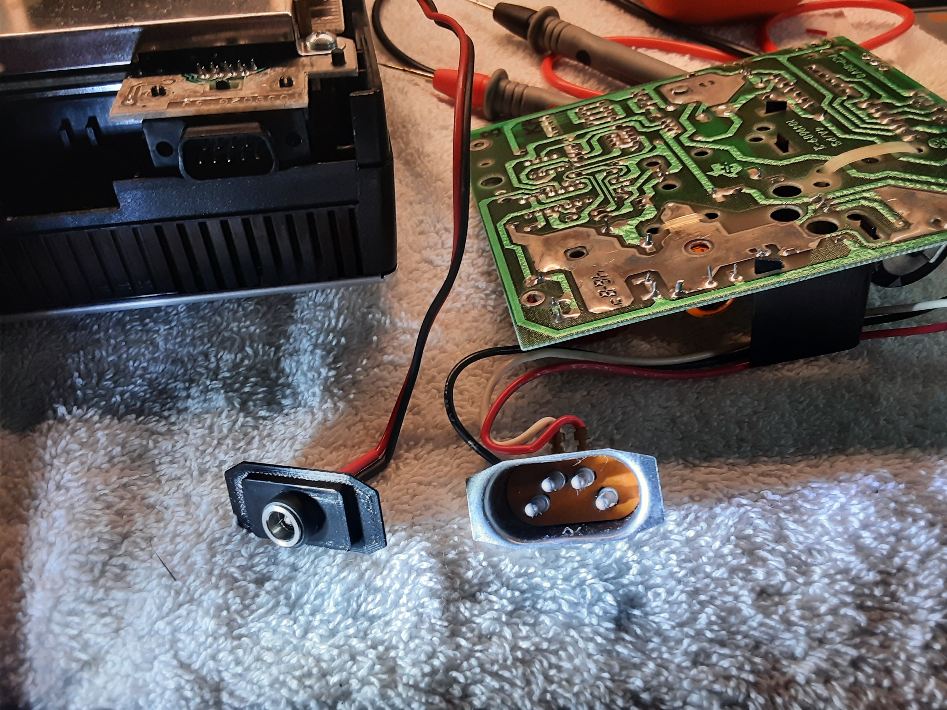

The solution I came up with was the design and 3D print a plate/bracket for a barrel jack sized correctly for my laptop supply. I did find another maker out there with a version of this, but it was not a good fit. This is the result, new on the left, original on the right:

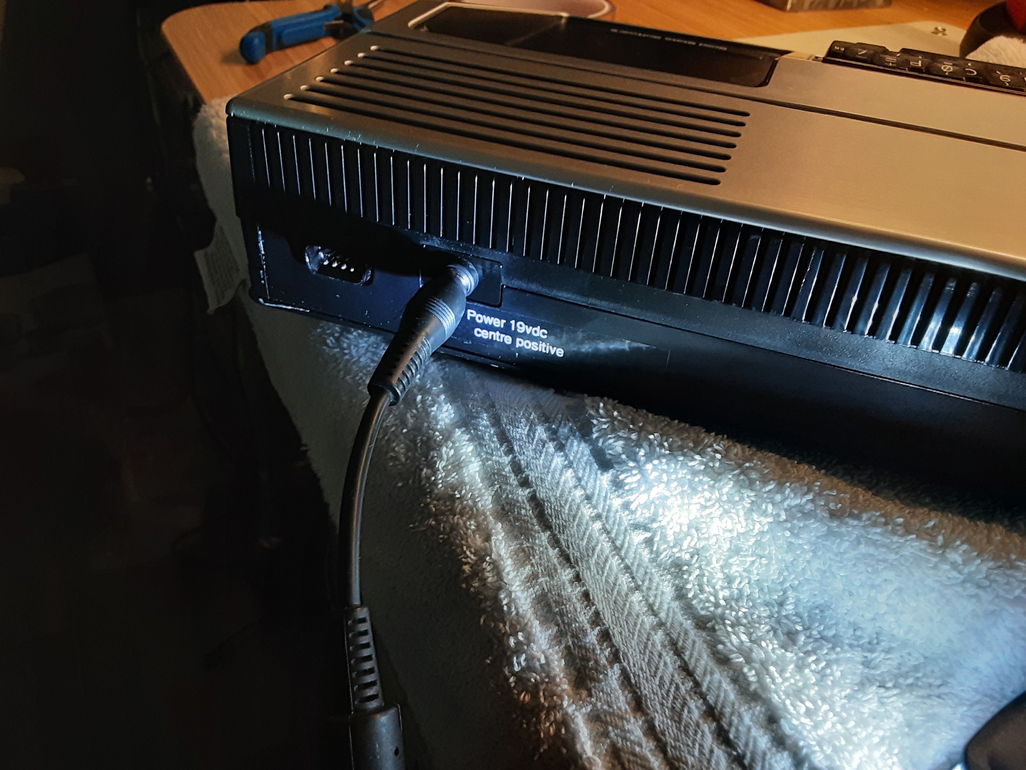

This is how it looks with the case all buttoned up:

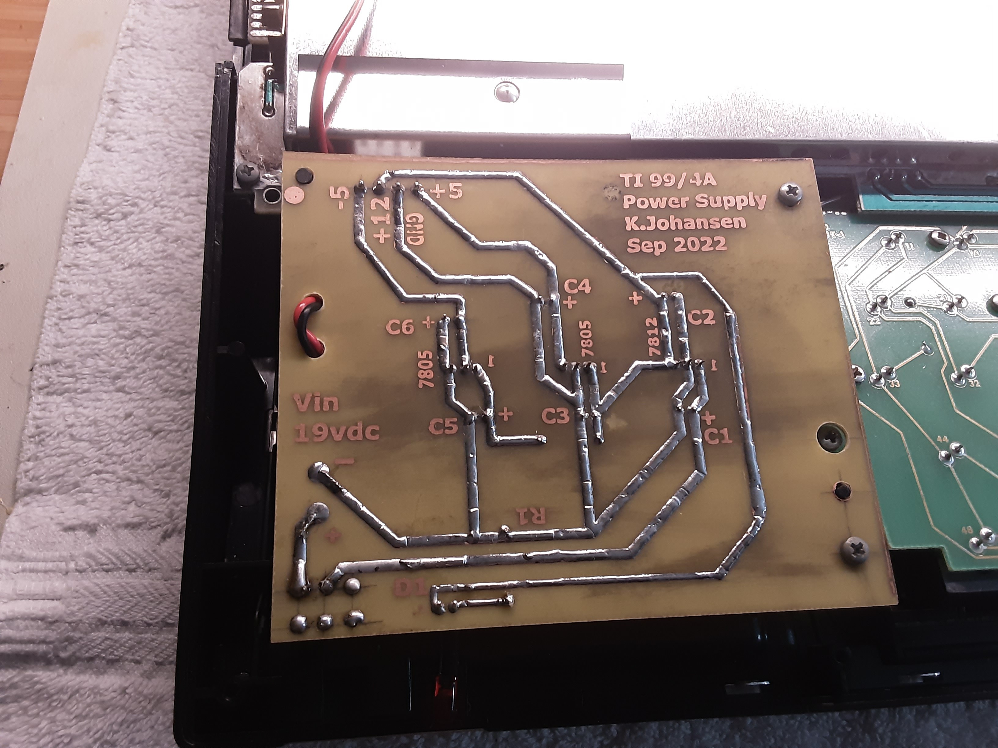

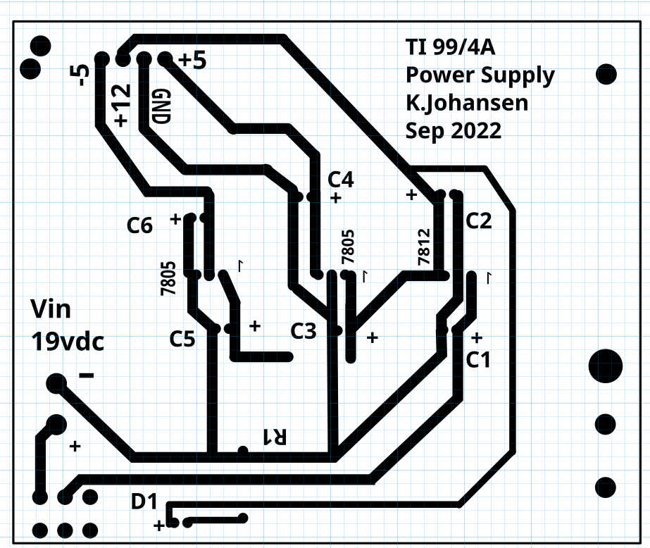

4 hours ago • 0 commentsThe circuit I would use to build the power supply was pretty simple, and would be easy to implement with a single-sided board. Given that, and the fact I had the materials left from previous projects, I tried and eventually succeeded in creating a single-sided layout on a copper-clad board.

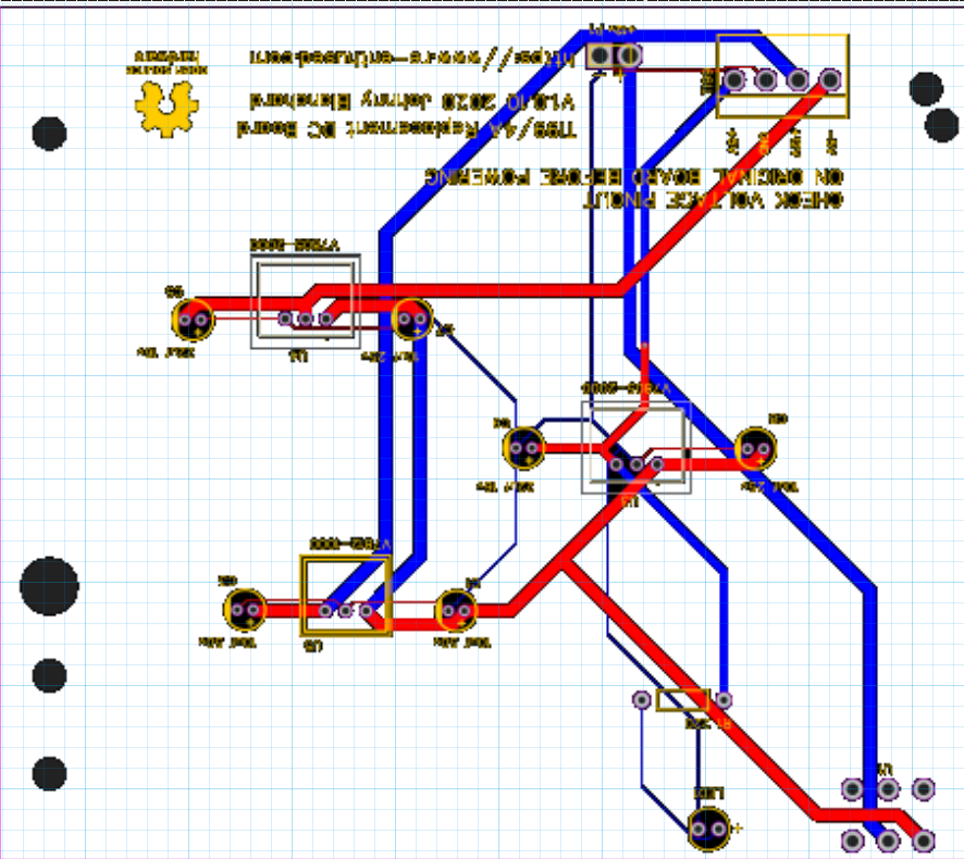

I used Inkscape to draw the board. Inkscape is useful for this, as it will accurately maintain and produce output with the correct dimensions. Below is the artwork in its final version:
I used the glossy paper/laser printer method to create the mask. You use a household clothes iron to transfer the laser toner onto the board, then use ferric chloride etchant to remove the excess copper.
This took a number of tries, as the ironing method sometimes leaves gaps where they shouldn't be. It eventually worked.

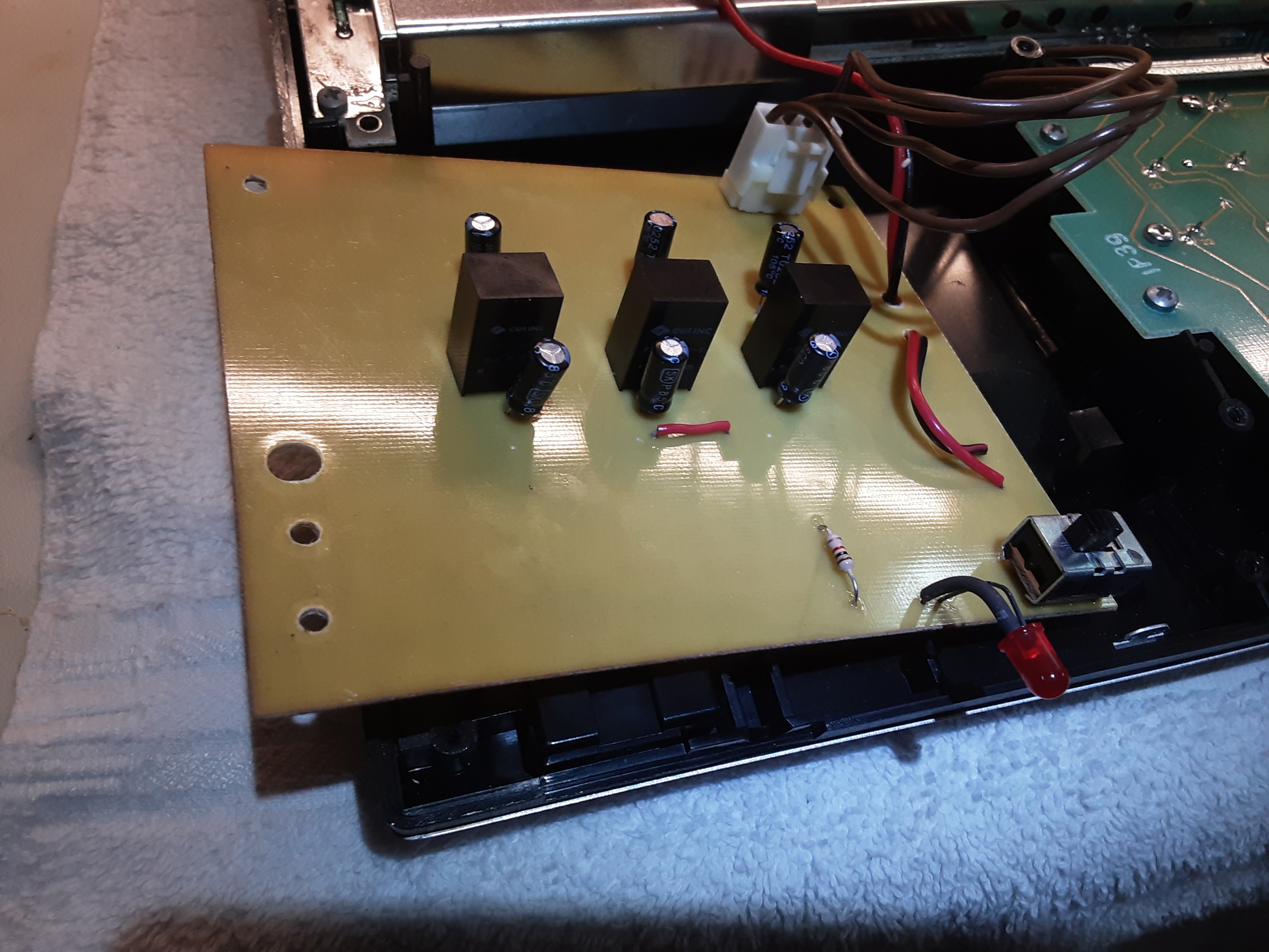

Below is the resulting board, plugged in for testing. As mentioned, the header on the top right and the switch and LED on the bottom right were scavenged from the original PCB.
I added lots of solder onto the traces just to boost the current-carrying capacity. Plus, it was a fun and relaxing activity.

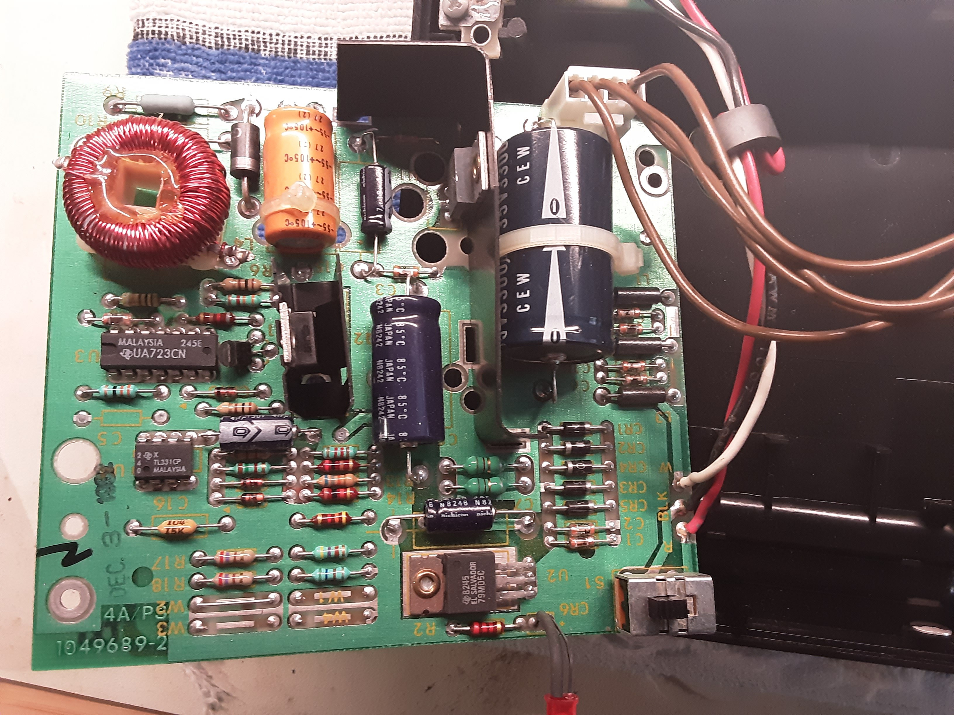

4 hours ago • 0 commentsBelow is a shot of the original Power Supply board in question.
It brings AC voltages into the machine, rectifies and regulates it to deliver +5v, +12v and -5v to the motherboard. A lot going on here, and no point in trying to replicate it. As long as the replacement delivers the right voltages, with enough current capacity.

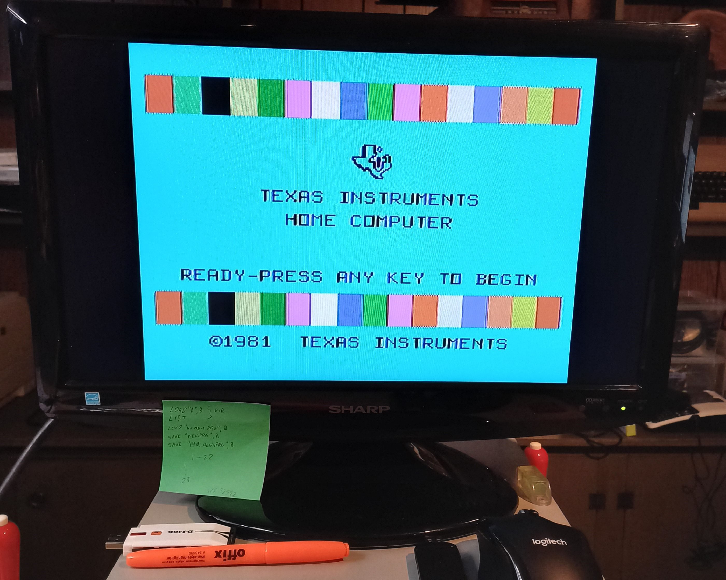

5 hours ago • 0 commentsWould this computer even boot?

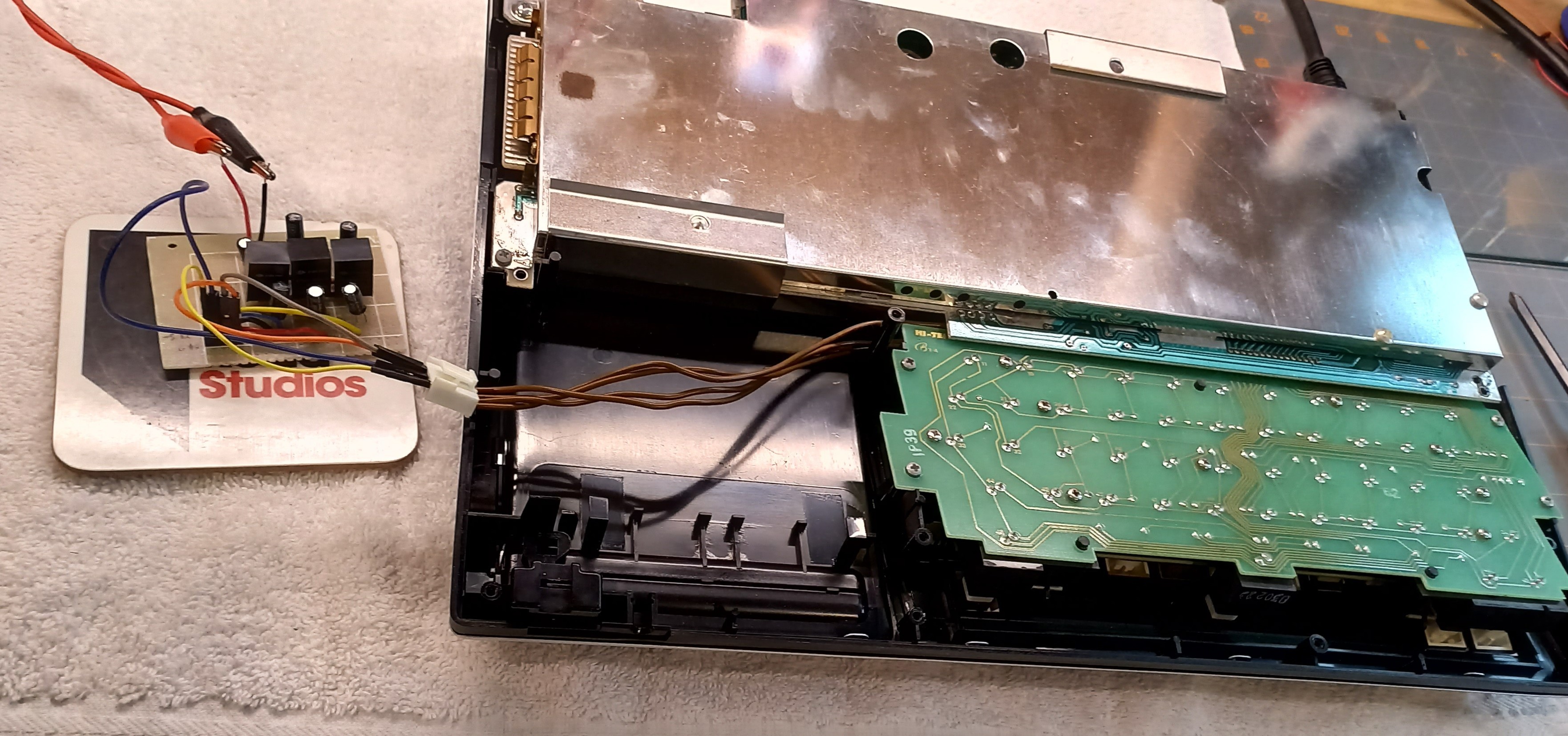

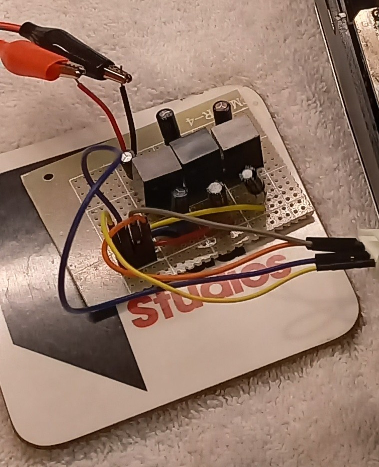

Taking what others had done before me, I went with a series of modular buck converters to derive the +12v, +5v and -5v supplies expected by the machine.
I installed them on a small protoboard, jumpered into the TI's power header, and sure enough, I had a working machine. Yay!

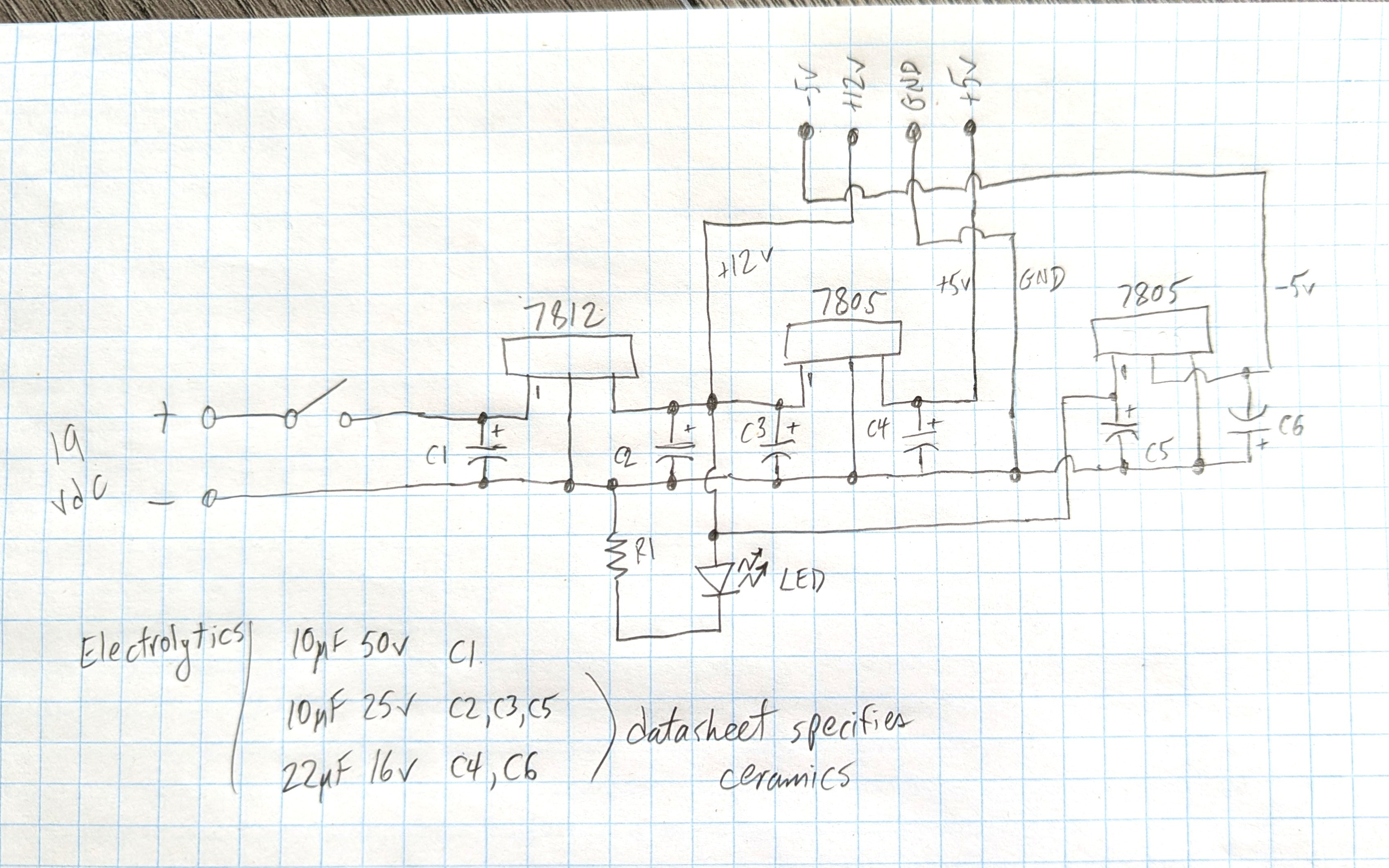

The datasheets for these devices specify ceramics, but I went with electrolytics for some reason. I guess I'm used to working with linear regulators which usually get electrolytics on the inputs and outputs.
Below is the schematic:
