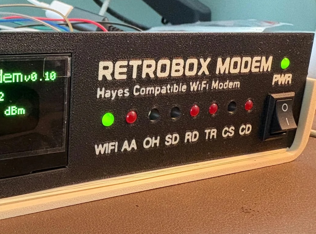

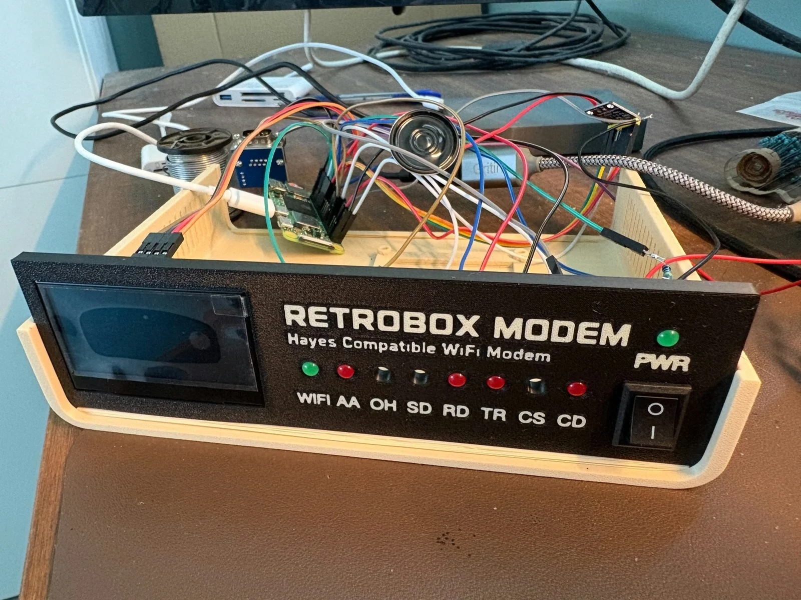

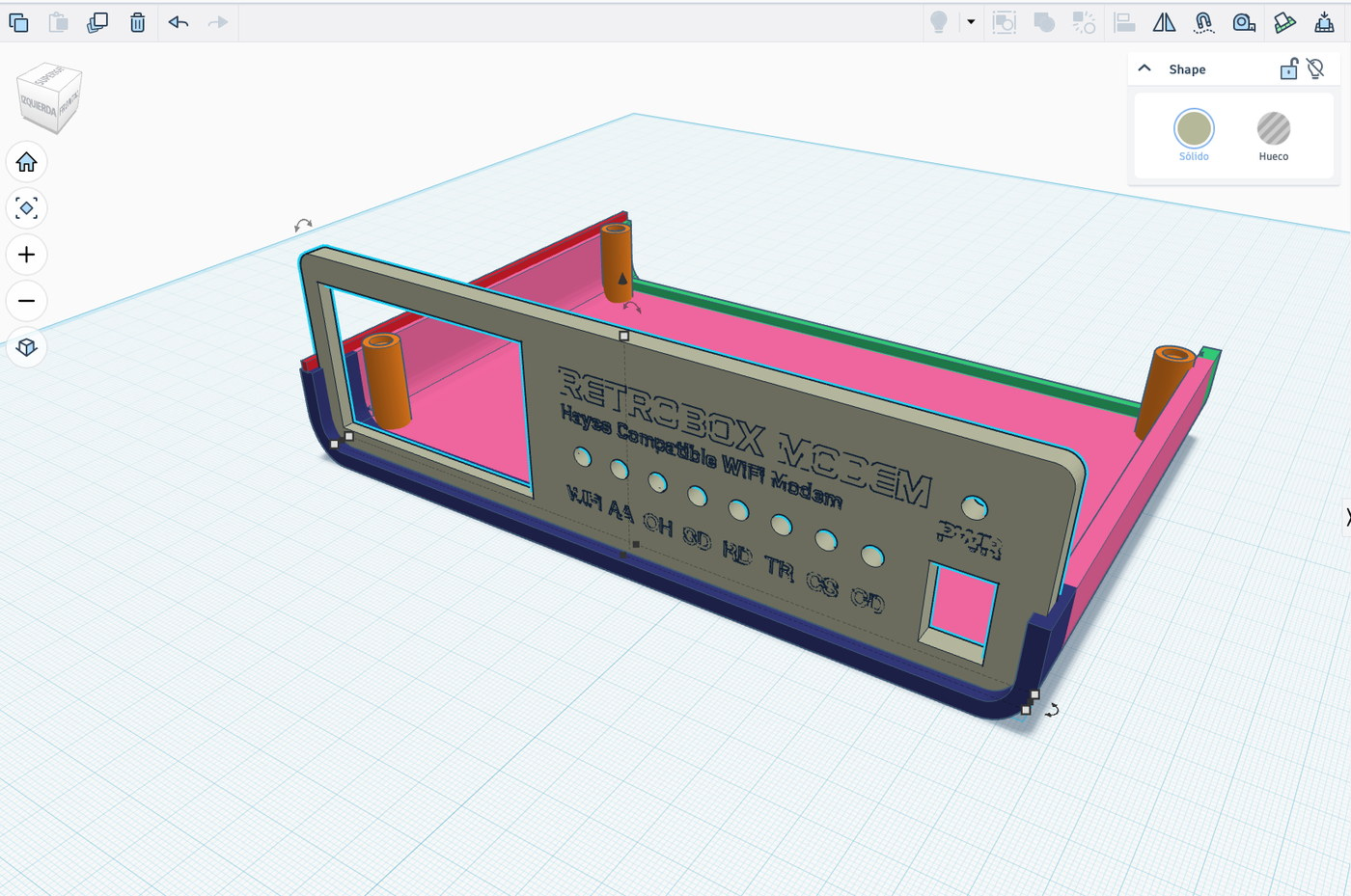

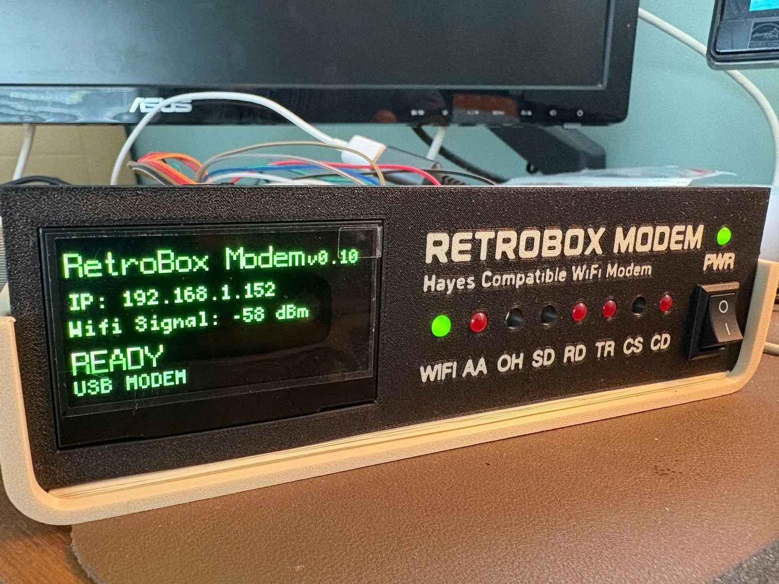

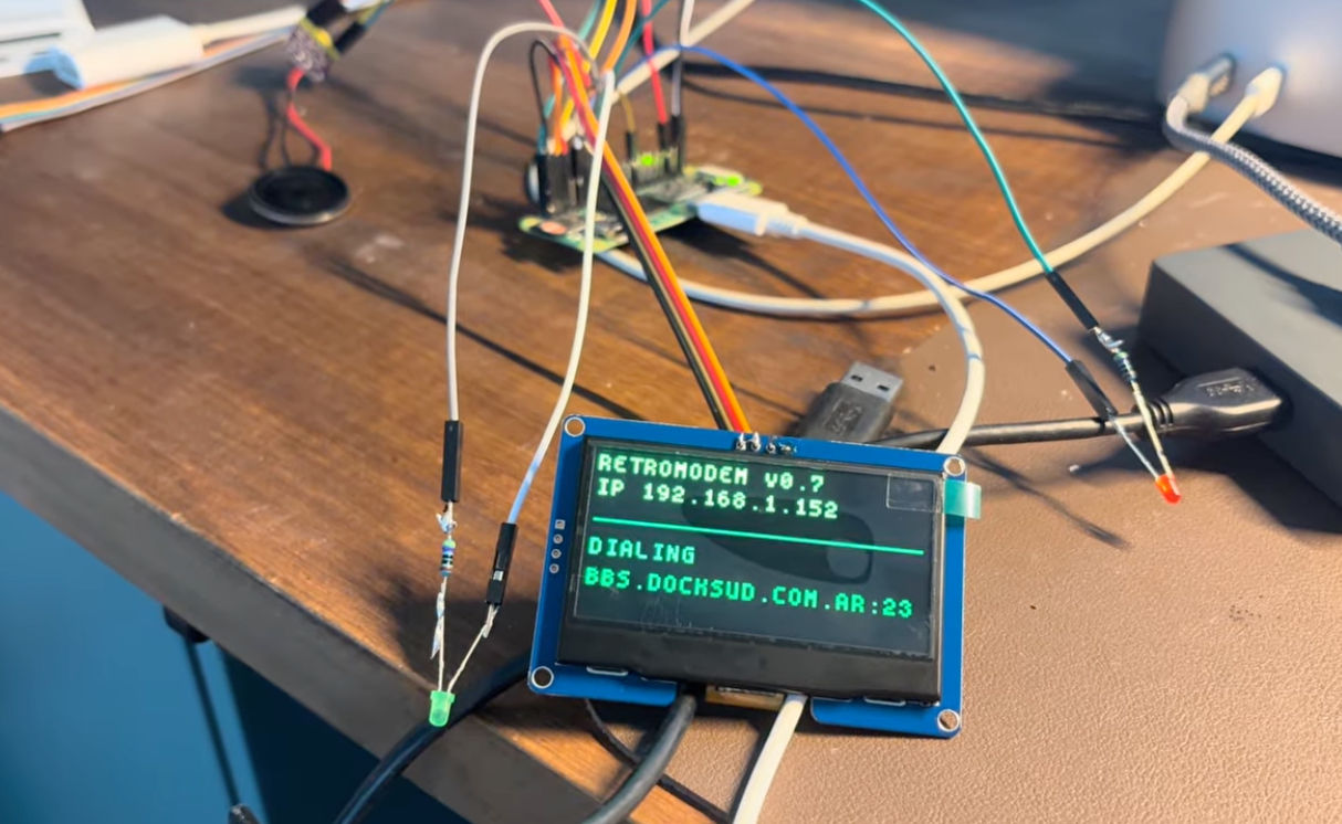

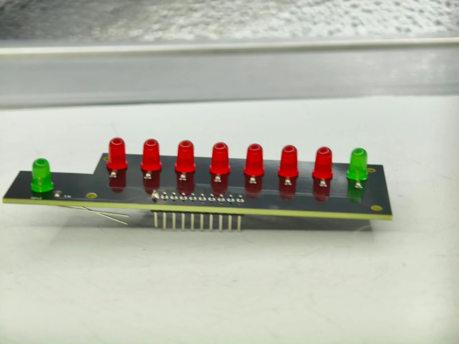

RetroBox Modem
A Hayes-compatible WiFi modem for vintage and modern computers, with real BBS connections, AT commands and classic modem sounds.
RetroBox Modem is a Raspberry Pi Zero 2 W–based Hayes-compatible WiFi modem designed to work with both vintage and modern computers. It accepts classic AT commands, connects to real BBSs over WiFi, and recreates the feel of a traditional modem with OLED status, LEDs, connection-speed profiles and modem sounds.
On vintage systems it can be used through serial interfaces, while modern computers can connect over USB. The prototype is working and the project is still evolving.
RetroBox Modem
RetroBox Modem is a project I started while researching and writing BBS Before the Web, a book about the history of Bulletin Board Systems, modems and the online world that existed before the Web.
Part of the reason for writing the book was surprisingly personal. My children had grown up with the Internet simply being there, and I realised how difficult it was to explain what it felt like when connecting two computers meant dialing a telephone number, listening to a modem negotiate and waiting for a CONNECT message to appear.
While researching that history, I eventually decided that writing about the experience wasn't enough.
I wanted to rebuild part of it.
That became RetroBox Modem.
What is RetroBox?
RetroBox is a Hayes-compatible WiFi modem for both vintage and modern computers, built around a Raspberry Pi Zero 2 W.
A computer communicates with RetroBox much as it would have communicated with a traditional modem:
AT
OK
ATD...
CONNECT
The computer does not need to understand WiFi, TCP or Telnet. RetroBox handles that side of the connection and presents a familiar modem-like interface to the machine.
Vintage computers can connect through an appropriate serial interface, while modern computers can use USB serial.
The result is that the same device can be used from machines separated by several decades.
More than a WiFi-to-serial adapter
There are already excellent ways of connecting old computers to modern networks.
RetroBox has a slightly different goal.
I wanted it to feel like a modem.
That means reproducing many of the details that were part of the experience:
  • Hayes-style AT commands
  • dialing and connection sequences
  • modem result codes such as CONNECT and NO CARRIER
  • escape sequence +++
  • return online with ATO
  • modem status LEDs
  • OLED connection information
  • dialing and handshake audio
  • configurable connection-speed profiles
  • persistent configuration
  • BBS favorites and recent connections
The front panel follows the language of classic external modems, with indicators for:
WIFI AA OH SD RD TR CS CD
and a separate power indicator.
The hardware
The current prototype is based on:
  • Raspberry Pi Zero 2 W
  • 128×64 OLED display
  • I2S audio amplifier
  • internal speaker
  • status LEDs
  • physical power switch
  • USB serial interface
  • serial connectivity for vintage machines
  • custom 3D-printed enclosure and front panel
The enclosure has gone through many iterations while I worked on tolerances, OLED positioning, LED alignment, lettering and assembly.
The current case is designed to resemble the external modems and peripherals that would not have looked out of place beside a computer in the 1980s or 1990s.
Modem personalities and speed
RetroBox can emulate the experience of several generations of dial-up modem.
The current firmware includes modem profiles ranging from V.22bis through V.90, while a separate pacing system controls how quickly data is actually delivered to the terminal.
That distinction lets me experiment with something I find particularly interesting: how different speeds felt.
For example, the same BBS can be experienced with data paced at:
300 bps
1200 bps
2400 bps
9600 bps
14400 bps
28800 bps
33600 bps
56000 bps
At 300 baud, you can actually watch the terminal appear line by line.
At the faster settings, the experience changes completely.
This has also become a useful way of demonstrating just how enormous the perceived difference between modem generations really was.
The sound matters
One of the surprisingly difficult parts of RetroBox has been the audio.
Anyone who used dial-up modems regularly remembers that the handshake was not just noise. Different standards, chipsets and generations of modem had recognisable characteristics.
RetroBox currently reproduces dialing, carrier and handshake sounds, but this part of the project is still actively being refined.
My goal is not simply to play a generic "modem sound". I want the sound profiles to become...
  • 1 × Raspberry Pi Zero 2 W Main controller. Runs the Hayes-compatible modem firmware, WiFi networking and BBS connections.
  • 1 × OLED – 128×64 Displays modem status, IP address, WiFi signal and connection information.
  • 1 × I2S audio amplifier Drives the internal speaker for dialing, handshake and modem sounds.
  • 1 × Small speaker Reproduces dialing tones, carrier and modem handshake audio.
  • 1 × Status LEDs PCB Front-panel indicators for WIFI, AA, OH, SD, RD, TR, CS and CD.
View all 9 components
  • Building the RetroBox Modem prototype
    Xavi Paz • 6 hours ago • 0 comments
    RetroBox Modem is still under active development, so these instructions describe the current working architecture rather than a finalized production design. Some components, mounting details and interfaces may change as the project evolves.
    1. Prepare the main controller
    RetroBox is built around a small Linux-capable single-board computer with WiFi connectivity.
    The controller handles the Hayes command interpreter, network connections, OLED interface, status LEDs, modem audio and serial communication with the host computer.
    For modern computers, the system can expose a USB serial interface directly.
    2. Connect the OLED display
    A small monochrome OLED display is connected to the controller and used to show useful modem information such as:
    • IP address
    • WiFi signal
    • current modem state
    • connection status
    • dialing and online information
    The display allows RetroBox to provide useful feedback independently of the computer connected to it.
    3. Add the modem audio hardware
    A digital audio output stage and small internal speaker reproduce the sounds associated with dialing and modem negotiation.
    The firmware handles dialing tones, carrier sounds and handshake sequences for different modem personalities.
    Audio is one of the areas still under active development, as the goal is to make the different connection profiles sound as authentic as possible rather than simply playing one generic modem recording.
    4. Wire the front-panel indicators
    The front panel follows the style of traditional external modems and includes the following indicators:
    WIFI AA OH SD RD TR CS CD
    A separate PWR indicator shows that the modem is powered.
    The firmware controls the LEDs according to WiFi state, connection status, serial activity and modem operation.
    5. Add modern and vintage serial connectivity
    Modern computers can communicate with RetroBox through USB serial.
    Vintage computers can use a traditional RS-232 connection through a serial level-conversion stage.
    This allows an older machine to communicate with RetroBox in the same way it would communicate with a conventional external modem.
    The basic architecture is:
    Computer → Serial / USB → RetroBox → WiFi → TCP/Telnet → BBS
    The computer only sees the modem interface. WiFi and network communication are handled internally by RetroBox.
    6. Install the firmware
    The RetroBox firmware implements the Hayes-compatible command layer, network handling, modem states, display interface, LEDs, sounds and configuration system.
    Once the firmware is running, opening a serial terminal and typing:
    AT
    should return:
    OK
    A BBS can then be dialed using:
    ATDhostname:port
    RetroBox establishes the network connection internally and returns the appropriate modem result code to the host computer.
    Other supported modem-style functions include escape sequences, returning online, persistent configuration, favorites and connection history.
    7. Print and assemble the enclosure
    RetroBox uses a custom 3D-printed enclosure designed to resemble the external modems and peripherals commonly found beside computers during the dial-up era.
    The enclosure consists of a cream-colored body and a contrasting front panel with integrated lettering.
    The design has gone through multiple physical revisions to refine:
    • OLED positioning
    • LED alignment
    • switch fit
    • PCB mounting
    • connector placement
    • internal clearances
    • ventilation
    • lettering and two-color printing
    Because the hardware is still evolving, some internal mounting points and dimensions may change between prototype revisions.
    8. Test the modem
    Connect RetroBox to a terminal program and verify the Hayes command interface:
    AT
    OK
    Then dial a BBS:
    ATDhostname:port
    RetroBox handles the network connection internally and returns:
    CONNECT
    From that point, the computer communicates with the remote BBS through the RetroBox Modem.
    Different modem personalities and data-pacing settings can then be used to experiment with the experience of different dial-up speeds.
    Prototype note...
  • Connecting modern & vintage hardware
    Xavi Paz • 6 hours ago • 0 comments
    RetroBox is designed to work with both modern and vintage computers, but the physical connection is different depending on the machine.
    Modern systems can use USB serial directly, which makes development and testing straightforward.
    Older computers usually expect a real serial interface, so RetroBox also supports RS-232 through a MAX3232 level converter. That allows the modem to present proper serial voltage levels to vintage hardware without changing the way the computer expects to communicate.
    The basic idea is deliberately simple:
    Vintage computer → RS-232 → RetroBox → WiFi → BBS
    The computer only sees a Hayes-style modem. It sends AT commands, dials a destination and receives familiar result codes such as CONNECT and NO CARRIER. Everything involving WiFi, TCP and Telnet happens inside RetroBox.
    I have already tested working prototypes with 486 and Pentium-era PCs, and the same firmware can also be used from modern computers over USB.
    One of the next areas I am continuing to refine is compatibility with more vintage platforms and serial adapters, while keeping the modem itself as universal as possible.
  • Recreating the dial-up experience
    Xavi Paz • 6 hours ago • 0 comments
    Getting a computer connected to a BBS over WiFi is relatively easy.
    Making that connection feel like a modem is much harder.
    RetroBox is not intended to be just a transparent serial-to-WiFi bridge. A large part of the project is about recreating the little behaviors that made dial-up modems recognizable: dialing, handshakes, result codes, carrier states, LEDs, delays and sound.
    The firmware currently includes several modem personalities, from V.22bis through V.90, together with a separate pacing system that controls how quickly data is delivered to the terminal.
    This allows the same BBS to be experienced at very different speeds. One of my favorite tests is connecting to the same system first at 300 bps pacing and then again at 56K. The difference is dramatic, even when the destination is exactly the same.
    Audio has turned out to be one of the hardest parts of the project. Different modem standards did not all sound the same, and simply playing a generic “dial-up sound” is not enough if the goal is to make the experience believable.
    I am still refining the handshake and carrier audio and experimenting with how closely the sound should follow the selected modem personality and data speed.
    The front-panel LEDs are also part of that experience. WIFI, AA, OH, SD, RD, TR, CS and CD provide visible feedback while the OLED shows the current state, network information and connection details.
    This part of RetroBox is still evolving, but it is probably the part I enjoy working on the most.
  • Designing and 3D printing the enclosure
    Xavi Paz • 6 hours ago • 0 comments
    The enclosure has taken almost as much iteration as the electronics.
    I wanted RetroBox to look like a piece of hardware that could plausibly have sat next to a computer in the 1980s or 1990s, rather than simply putting the electronics inside a generic project box.
    The case is 3D printed and has gone through many revisions while I adjusted the OLED position, LED alignment, front-panel lettering, PCB mounts, switch fit, internal clearances and ventilation.
    Small changes turned out to matter a lot. LED holes were adjusted repeatedly to get the right fit and depth, the PCB mounting posts were refined so the LEDs sit correctly against the front panel, and the OLED opening and position were changed several times before everything lined up properly.
    The front panel is printed in two colors, with a black face and cream lettering, while the enclosure uses a warm beige/cream inspired by vintage computer hardware.
    Most of the recent prototypes have been printed on a Bambu Lab A1 using a 0.4 mm nozzle and a 0.16 mm layer height. The lettering is printed as an inlay rather than painted afterward.
    One of the advantages of 3D printing this enclosure is that the mechanical design can evolve together with the electronics. When a connector, PCB position or internal component changes, I can modify the case and test another physical revision immediately.
    At this point the enclosure is very close to the shape I originally had in mind, although I am still refining small tolerances and internal mounting details.
  • From idea to working prototype
    Xavi Paz • 6 hours ago • 0 comments
    RetroBox Modem started as an experiment: could a modern single-board computer behave enough like a traditional Hayes modem that both old and new computers could use it naturally?
    The first goal was simple: open a serial terminal, type AT, receive OK, and then use ATD to connect to a real BBS.
    Once that worked, the project quickly grew. I added WiFi networking, TCP/Telnet handling, an OLED display, status LEDs, modem result codes, favorites, persistent configuration and audio.
    The first successful BBS connection was the point where RetroBox stopped feeling like a software experiment and started feeling like a modem.
    There is still a lot to refine, but the core idea is now working: a computer talks Hayes, RetroBox handles the modern network underneath, and the user gets something that feels much closer to the dial-up experience.
View all 5 project logs
