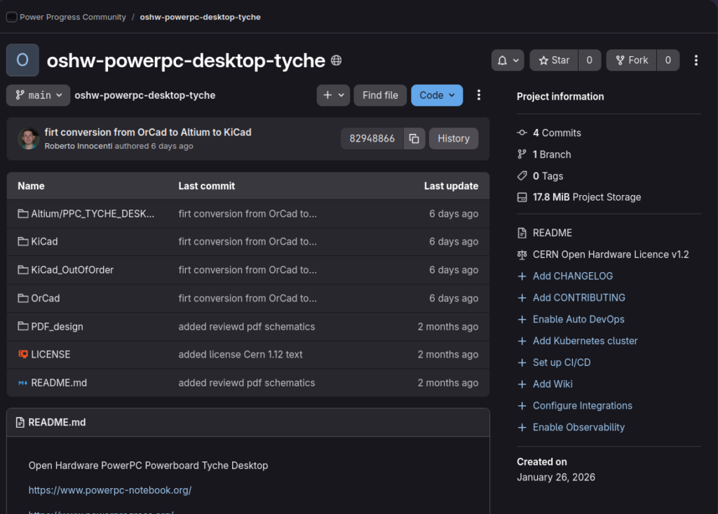

    Roberto Innocenti04/30/2026 at 21:08 0 comments
    On the 24th of April 2026 we published on our GitLab repository https://gitlab.com/power-progress-community/oshw-powerpc-desktop-tyche/-/tree/main/KiCad?ref_type=heads the OrCad schematics source, converted to Altium and then imported into KiCad, thanks to our association members.
    GitLab Powerboard Tyche Kicad sources conversion
    As KiCad cannot yet import OrCad schematics, this is a 2-hop OrCad→Altium→KiCad flow.
    The KiCad pages are out of order. There are two KiCad directories in this repository: one exactly as imported from Altium (KiCad_outOfOrder), and another where our volunteers attempted to change the page numbers to match the filenames, but they did not reorder in the sheet page listing — they are still in the same random-looking order. We are investigating how to fix this at some point, as the file with “01” in the filename should come first, since it contains the table of contents, in order for everything to line up correctly. Other than the ordering issue, it looks reasonable.
    Kicad source Powerboard Tyche Desktop
    If you would like to help check the quality of the conversion to KiCad and potentially work to improve it, please contact us.

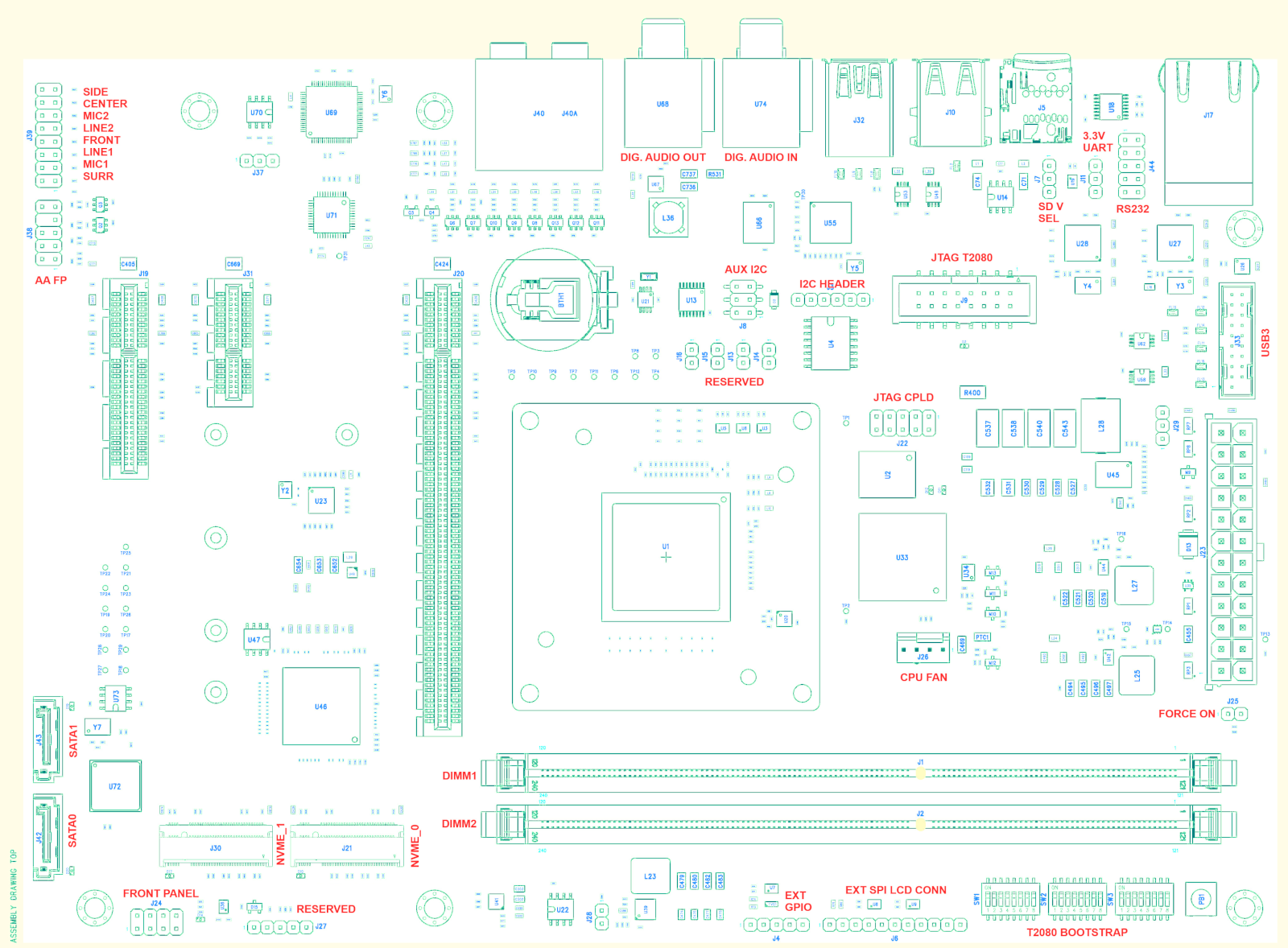

  • We are ready for prototype production!
    Roberto Innocenti03/28/2026 at 18:35 0 comments
    The PCB design is finally complete, and we are officially ready for prototype production.
    However, before taking the big step, we need to balance the PCB design costs:
    • 3,050 euros at the end of April;
    • 3,050 euros at the end of May;
    To produce the first five prototypes, we need a total of around 9,000 euros. Until we have the cash flow to make this commitment with the manufacturer, we will not sign the contract to go into production.
    Schematics are already published in pdf format on our gitlab repository
    Why aren’t we publishing the PCB design yet?
    We will only be able to publish the open-source design after paying the design costs and only when prototype production is underway. This is for two fundamental reasons:
    1. Before paying, we do not own the rights to the source files.
    2. The source files will only be considered final after physically testing the prototypes.
    Furthermore, our manufacturer ACube Systems can only afford to produce the Desktop board for the first time if no one else beats them to the market. After all the hard work done to make this dream a reality, it is our duty to protect them.

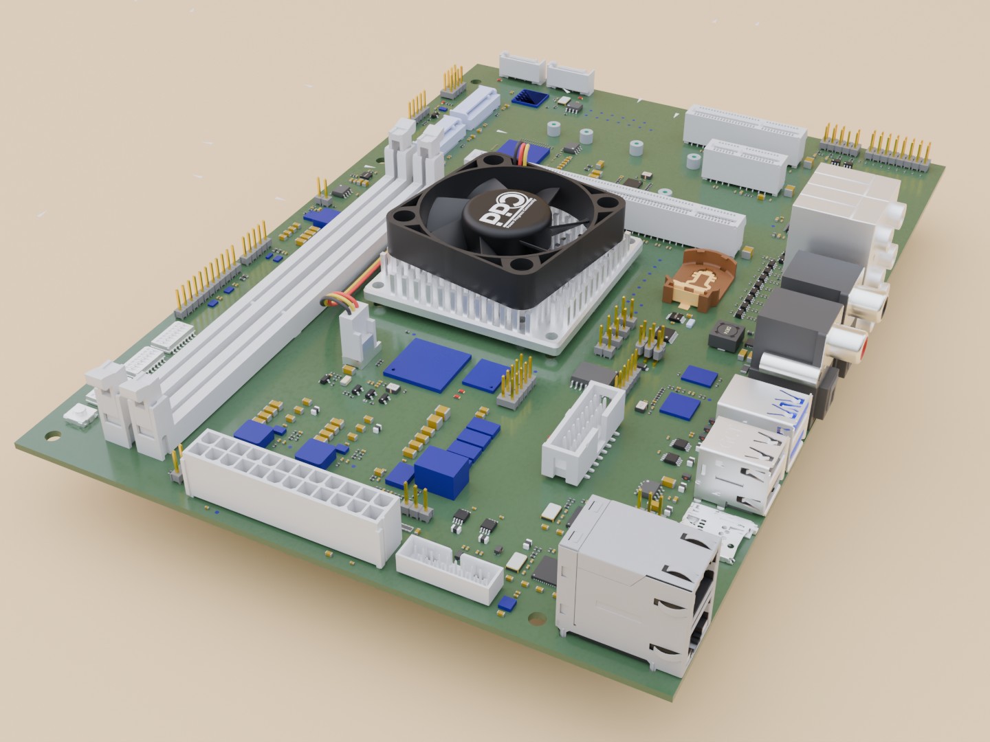

    Desktop board specifications
    Our Desktop board is a Micro ATX measuring 244 mm in height and 172 mm in width. When it comes to audio, we didn’t hold back: it features optical digital audio inputs and outputs, 6 analog RCA connectors for 7.1 surround sound, and separate ground connections for the analog and digital sections to ensure maximum sound clarity.

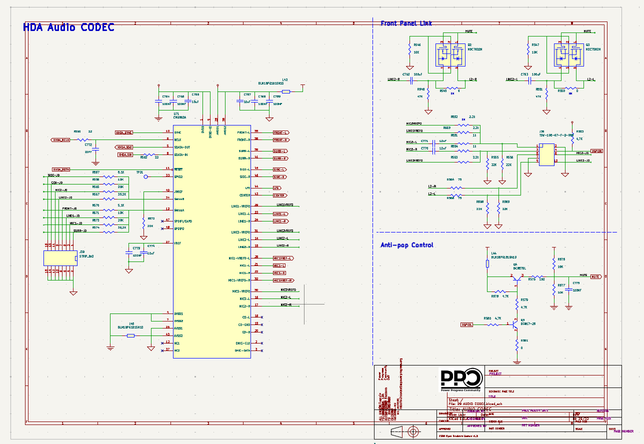

  • Schematics reviewed and published!
    Roberto Innocenti02/04/2026 at 23:55 0 comments
    We have known each other for several years now, working together with supporters who have backed us through the long process of creating notebook prototypes. Over the last eight months, we have focused on developing a desktop version largely redesigned to be immediately functional.
    As promised, the sources for our desktop board have been reviewed by NXP. They suggested a few changes, which we have implemented. The review process cost us an additional €850, but it was worth it: we have improved our schematics and PCB design just in time for the prototypes.
    Great news: NXP confirmed we can publish the schematics with an Open Hardware License! We have already uploaded the PDF version to GitLab. and in our Hackaday.io project file space.
    GitLab Repository Powerboard Tyche Desktop Schematics
    However, before publishing the raw source files, we need to convert them from the proprietary OrCAD format to KiCad to ensure everyone can use them. We need collaborators to help us bridge this gap.

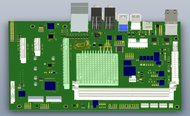

  • First PCB Desktop Layout!
    Roberto Innocenti12/25/2025 at 21:36 0 comments
    Today we publish here ( above) an export from PCB design of our PowerPC Desktop motherboard (based on processor NXP T2080) , you can see the motherboard top view with components and connectors, it reflect the progress on pcb design, that is going fast. Before the end of January will be completed !! In January should be defined the costs and timing for the production of the prototypes.
    • The dispositions of components on the board are not final.
    • As requested by our association members there are 4 holes 30-42-60-80 for the left M.2 connector.
    • The two Ethernet are one on top of the other.
    • There is even a digital audio output.
    • There are 3 PCIE connectors: 16x, 4x Open ( with space for 8x and 16x), 1x

    Powerboard Tyche Notebook – MXM video card slot and 2 RAM slot
    Our notebook motherboard design fits in an already produced notebook shell and uses a PowerPC processor that can keep up with modern mid-end boards, even though its production started in 2012: a true testament of a good design.

  • Schematics of the Powerboard Tyche Desktop version Completed! Soon starting the PCB design
    Roberto Innocenti10/30/2025 at 23:17 0 comments
    We now have the complete electronic source design for our new desktop design in our hands!
    This week, ACube Systems and some volunteers from our association will review the design. We expect the manufacturer to start setting up the PCB layout for the new Powerboard Tyche Desktop on October 20th. This is part of our strategy to focus on creating a stable, functional desktop version of the core computing platform by the end of 2025.
    The PCB design phase (Phase 2) will begin shortly after the schematics and Bill of Materials (BOM) are sent to the manufacturer. We anticipate that this step will allow the manufacturer to provide us with an estimate of the cost and timeline for the PCB layout design. This cost and timing estimate will then be shared with the community “just in time.”

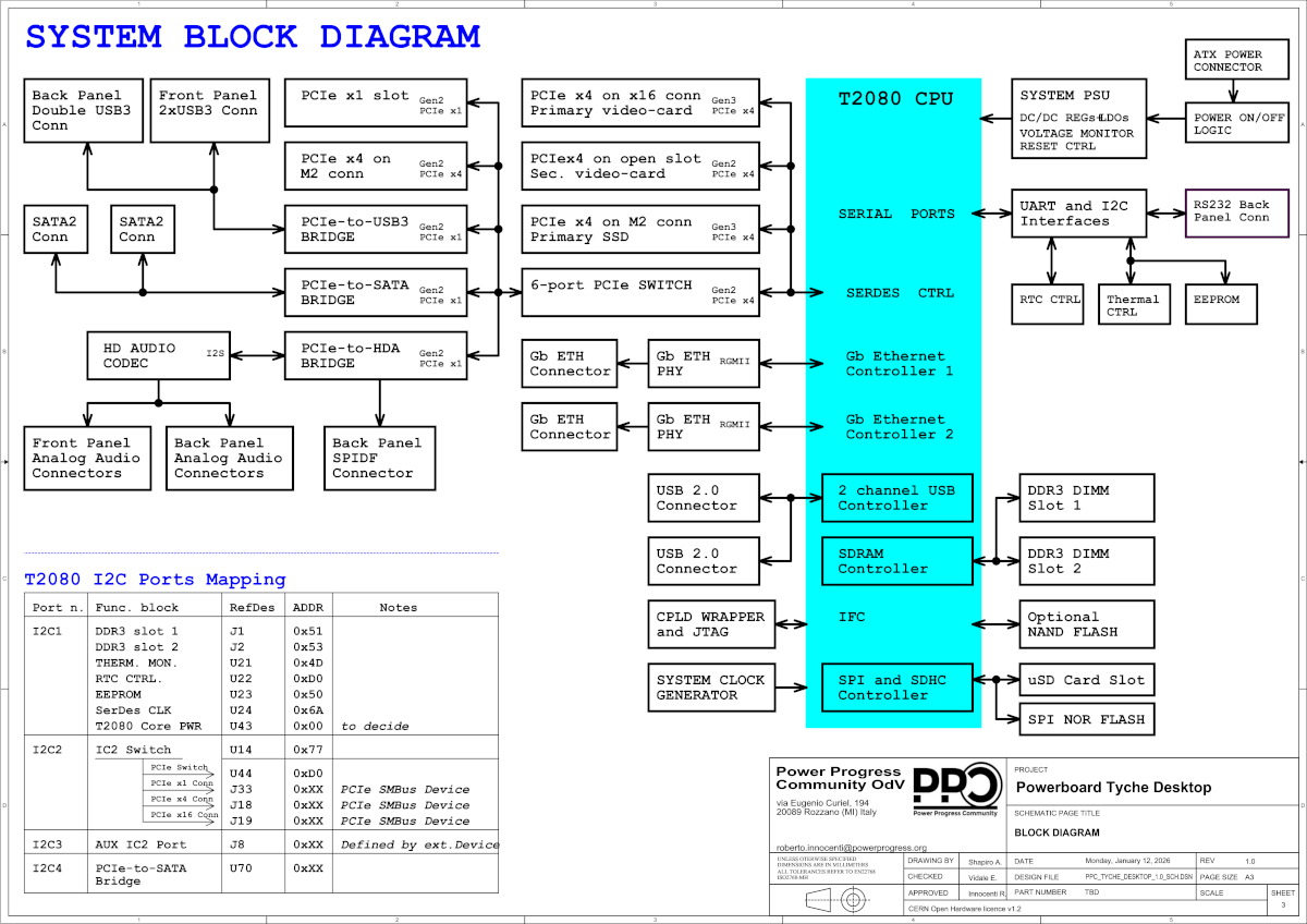

    Technical Components and NXP Review
    We have verified that the availability of SATA2/3 controllers is poor, and the chip Lattice Silicon Image SiI3132 chip that we selected is no exception. We decided to include it in our desktop board to ensure backward compatibility with SATA devices, such as DVD and HDD.
    We do not use the on-chip T2080 SATA2 controller because we prefer to use the T2080’s three x4 PCIe Gen3 configuration to optimize the speed of video cards and storage controllers. This configuration cannot coexist with the on-chip SATA2. In any case, the best performance is possible thanks to our M2 motherboard interfaces.
    In our board design, we have an SPI connection for an external LCD, which can be used as a secondary screen or for debugging and diagnostics. It is also useful when setting up u-boot and when no video card is connected to the board.
    Our board design includes GPIO connectors that can be used to connect other devices that don’t use USB, SPI, or PCIe buses.
    Our desktop design is derived from our old notebook design and the original NXP T2080 RDB (Release F) design. We are integrating many components specified in the reference board, including critical monitoring hardware.
    This includes the OnSemi ADT7481ARMZ thermal monitor, which has been upgraded to the OnSemi NCT72. The ADT7481 is used as the thermal monitor or temperature sensor on the original NXP T2080 reference design board. On that board, the ADT7481 (designated U34) is usually connected via the I2C_1 bus with the address 0x40. The T2080 processor itself contains a temperature diode designed to be used with system temperature monitoring devices, such as the Analog Devices ADT7461A. This similar part is mentioned in the documentation for the T1042 chip, which highlights the standard use of such monitoring.
    Designers have changed other components from the original T2080 RDB design and our notebook design due to the availability of new compatible models, such as the N25Q512A13 FLASH SPI, which is substituted for the EvKit Micron MT25QL512A due to its limited availability.
    Due to the changes in components, we will need to modify the VHDL code of the CPLD chip when we have the prototypes in our hands. Therefore, we must take into account the additional cost of this task.
